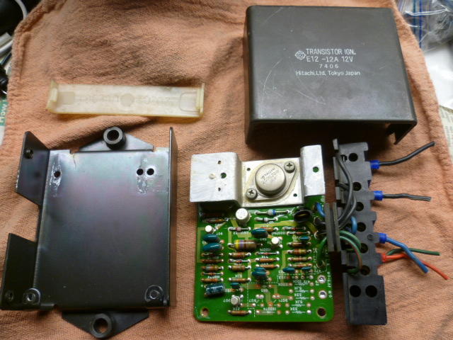

yep, that's the same as mine. I got and aftermarket unit of ebay for 50$ IIRC, pulled my OE off to test it, left the aftermarket unit in place so I carry the hitachi as a spare. The aftermarket unit seemed to have fewer parts IIRC. I can see several electros in there that prob should be checked at least of not just shot gun replaced. I can't believe the engineers ever expected this kind of long term life.
