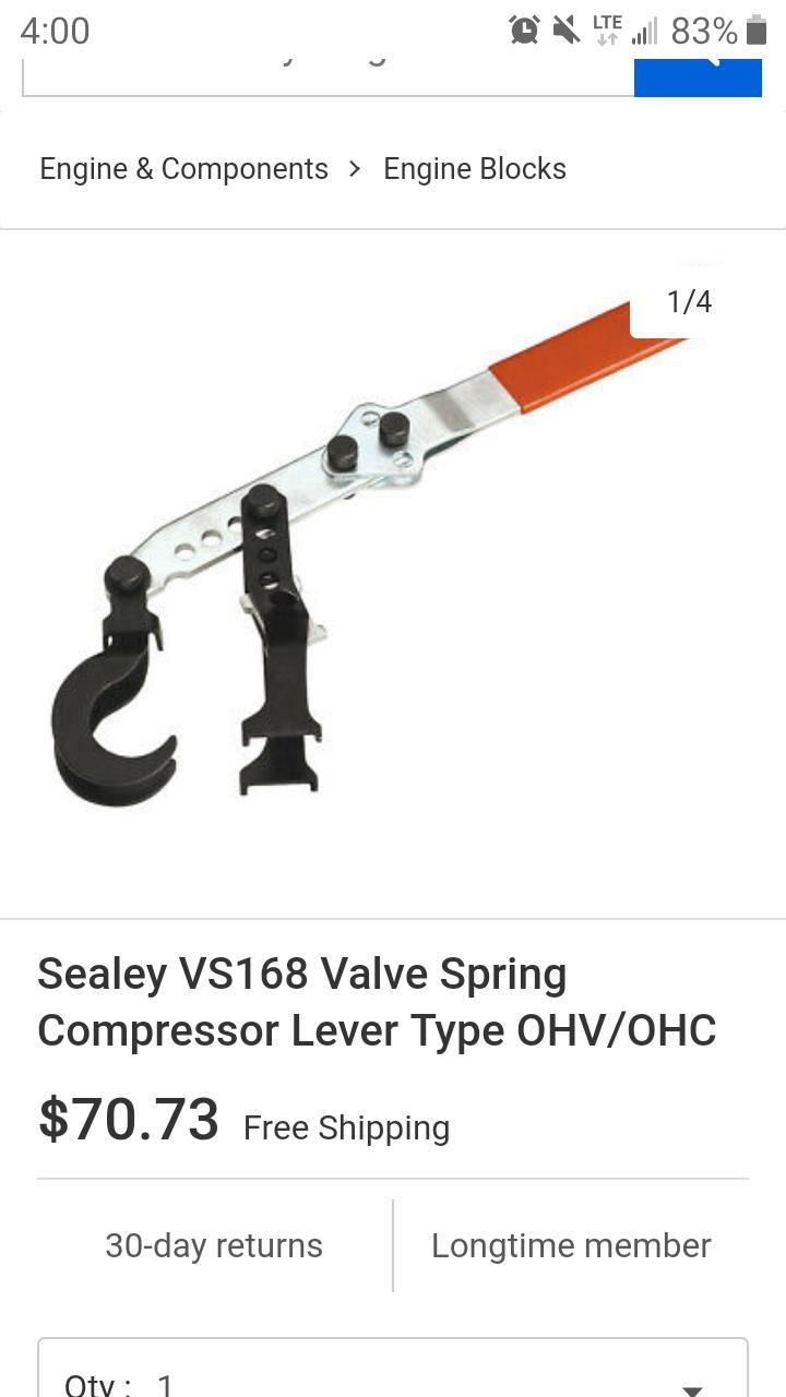

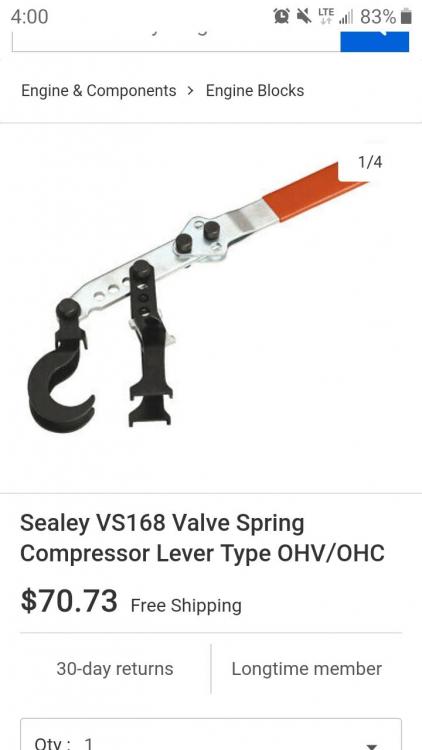

Schneider cam installed here. Is there anyway i can replace the valve seal in that cyl without talking the head off?
