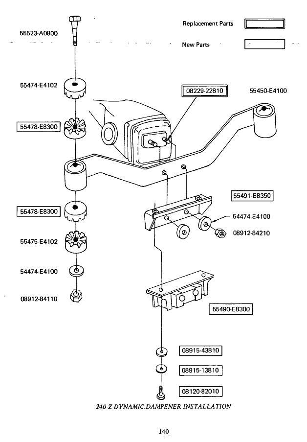

This snip-out from the 75 280Z FSM provides some insights into what zKars is talking about.  The step at the bottom of the tapered-shank bolt limits the amount of crush/preload applied to the wavy washers...

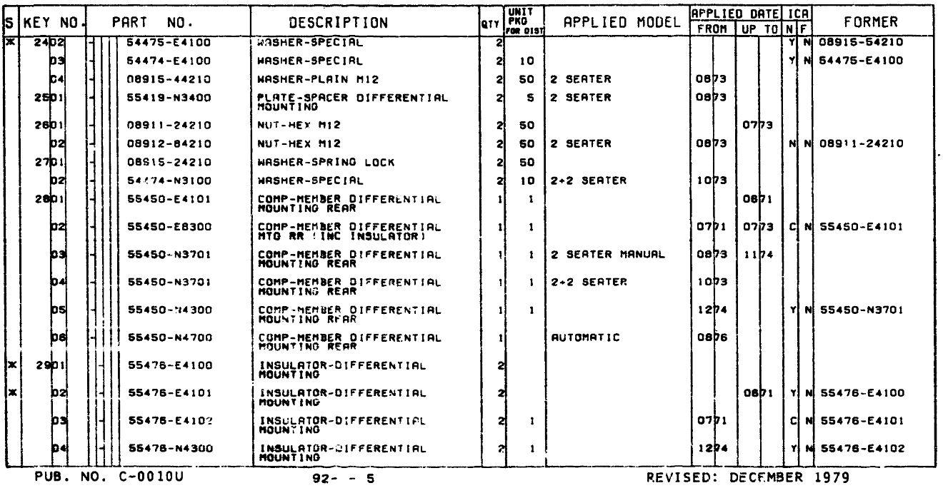

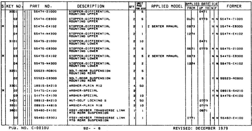

I find the mustache bar bushing and washer subject quite interesting. The changes that happen over the 1970 to 1973 model years are not very well documented. There are multiple part number for both the bushing and the washers, the later wavy washer part number 55474-N4300 was not introduced until 12/74. The picture in the parts book does not depict this very well. I think the early thin serrated was P/N 55474-21000, only one per side was used, above the bushing.
From Service bulletin TS71-18 it looks like the first wavy washer set up was a two piece arrangement using P/N's 55478-E8300 and 55475-E4102, two of each on both left and right sides.

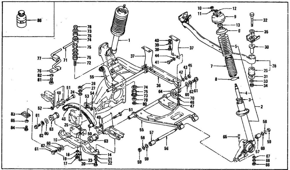

As has been pointed out by others, the moustache bar isn't really part of the rear suspension.  It's function is to provide a fixed/flexible rear mounting system for the differential.  None of the (primary) suspension loads feed through the differential.  See diagram below for more understanding.  That said, Steve may find this distinction irrelevant to his overall policy of keeping away from  parts that he feels may have high potential for liability issues.  I guess we'll have to wait to see whether he responds.

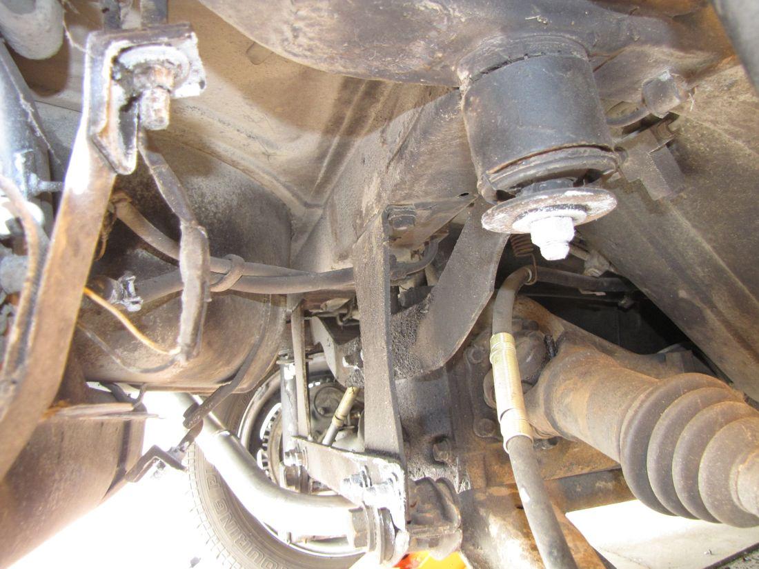

Here is a picture of the early set up,  thanks @Mikes Z car. Note that the bushing presses into the bottom of the mustache bar. The bottom of the bushing has a flange that is rubber coated and does not have a top flange. There is washer with serrated rubber at the top and a plain steel washer at the bottom.
TS71-18 describes a cobbled-up fix that Nissan came up with to address complaints from owners about powertrain noise in Z's with automatic transmissions.  It largely consisted of hanging a big-arse weight off the back to the diff casing.  It also doubled up on the number of wavy rubber washers at each of the 4 places where these are located.  It's interesting to note that the 'teeth' of the new, add-on washers appear to have been designed to interlock with those of the original washers.  That would have really stiffened things up.
Although I haven't checked the parts manual, I doubt whether this dealership service kit ever made it into actual production.  Nissan probably found a more elegant way to solve the problem with the auto-trans Z's (different final drive ratio, maybe?)
