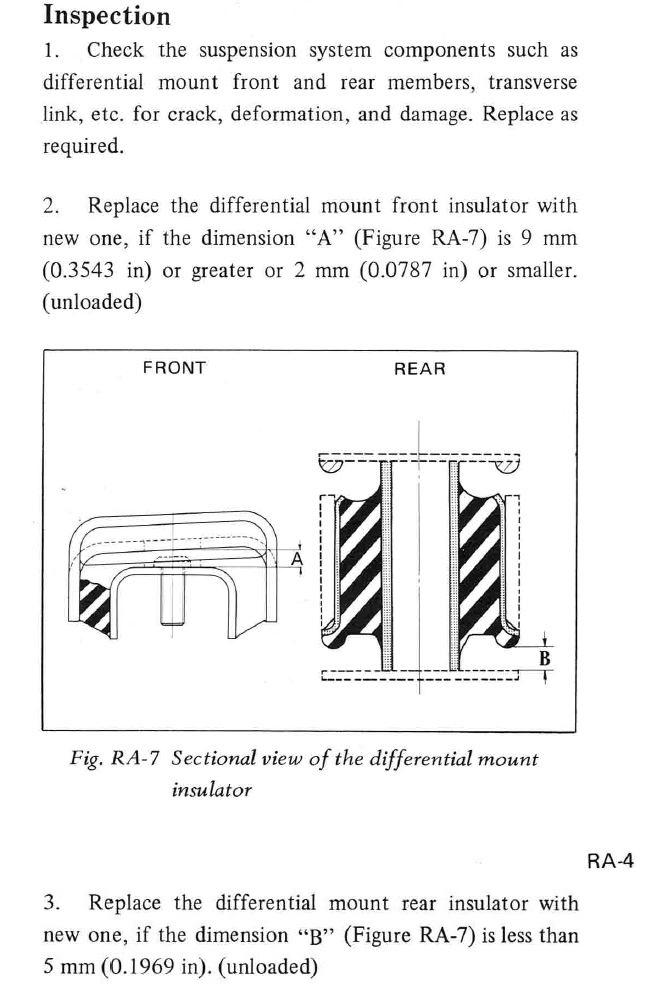

Here is a snip from my 1970 FSM that shows the rubber washer on top and rubber on the bottom face of the bushing flange with a steel only washer on the bottom.  I looks to me like originally the washers were only meant to contact when the rubber in the bushing was starting to fail, see the note about the 5mm dimension.  In 2005 I had my mustache bar bushings replaced and new washers installed.  It only had one rubber serrated washer of the early type on top and one steel washer on the bottom. In 2005 I was able to get a new early top washer from Nissan.
