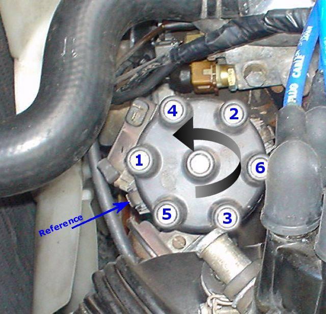

Hi! So ive been having an issue getting my 1977 280z to start. I have spark, compression, and have been running fuel manually with an extra battery and test leads on the fuel pump. I think it sounds like the engines firing, but it just doesnt wanna turn over. Any suggestions?

Make sure the firing order is right.
