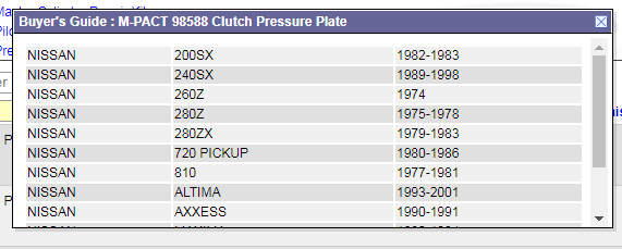

The collar needs to match the height (thickness) of the pressure plate.  With aftermarket parts you can't really define by 240Z, 280Z, Zx, 2+2, etc.
https://www.rockauto.com/en/catalog/nissan,1976,280z,2.8l+l6,1209226,transmission-manual,clutch+pressure+plate,1988

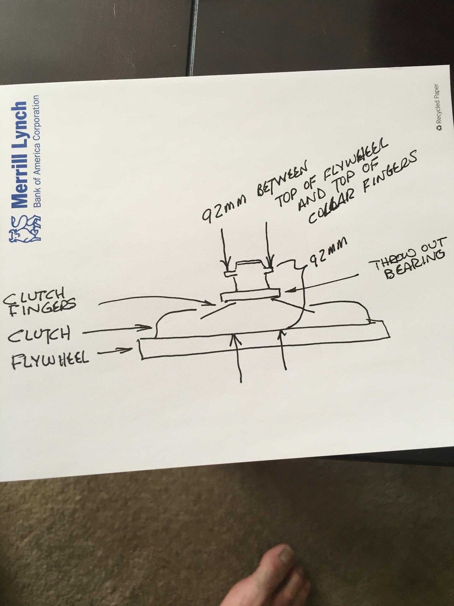

Hey guys, Why are we talking about replacing the clutch. His problem is the clutch does not disengage properly. If it was slipping, then I would suspect the clutch.

I posted the position of the clutcgh fork in relaxed and depressed positions. I can't remember of the top of my head and I'm not really closeby to civilisation atm. Ill try to find them. That would confirm the correct travel and the collar is correct or not.
I would be doing these checks first before taking any steps to remove the transmission.
Ok, I found the other thread.
Edited by EuroDat
Found other thread
