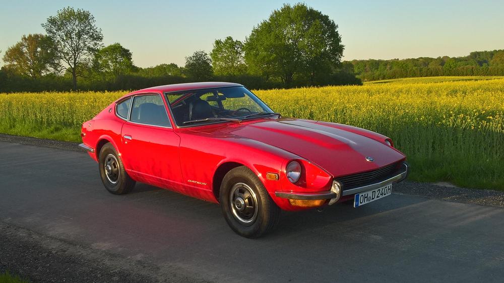

Hi, what a great car.
Have the same , Color in-  and outside from 02.1971. It is original , just missing the original engine .?
90% first paint  and drove ist over 3500 miles this year.
So keep it as it is and have a lot of fun with the Z.

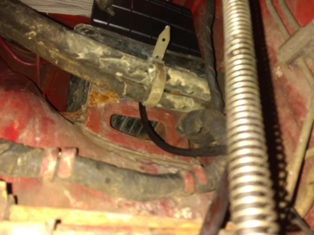

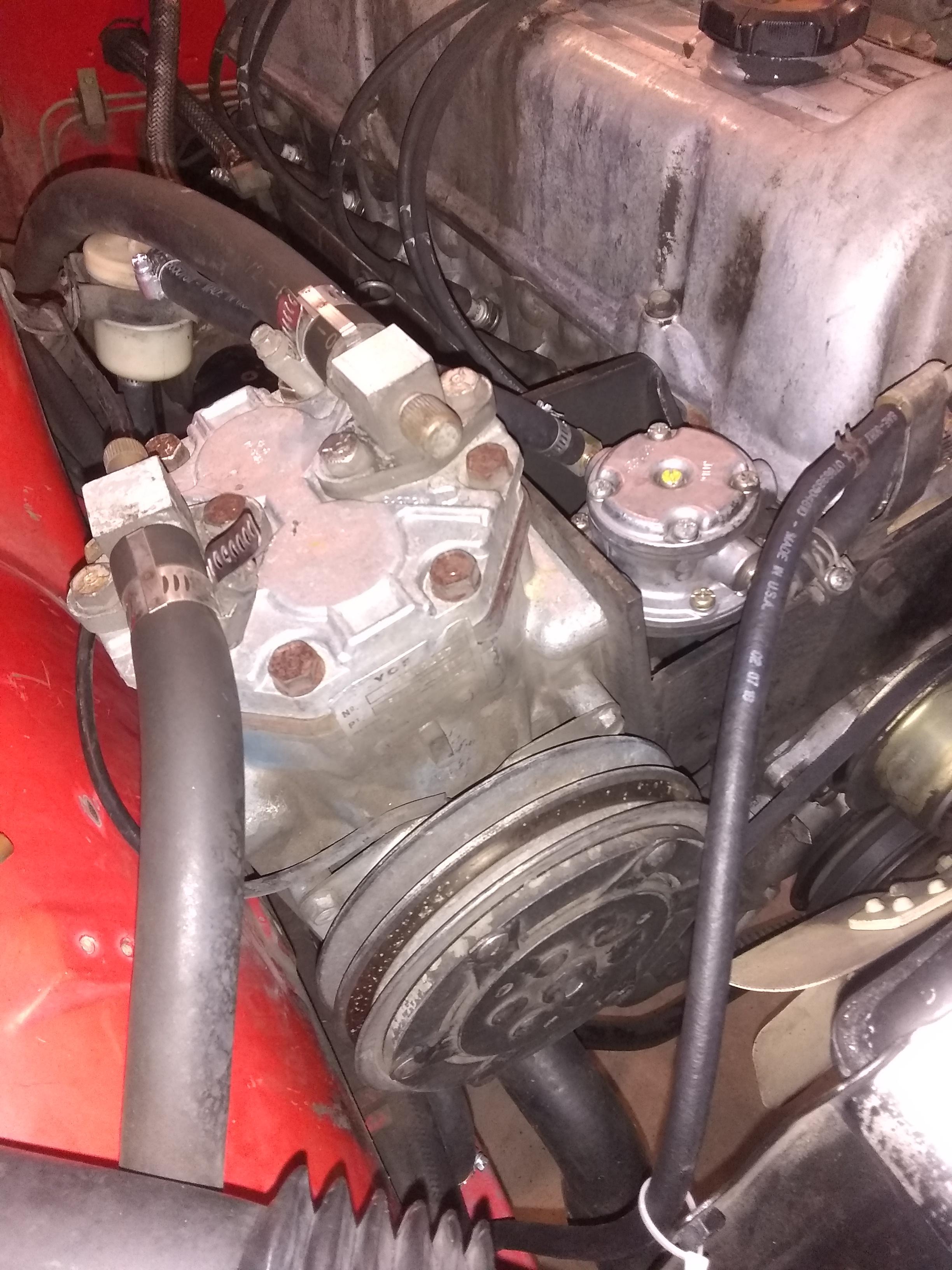

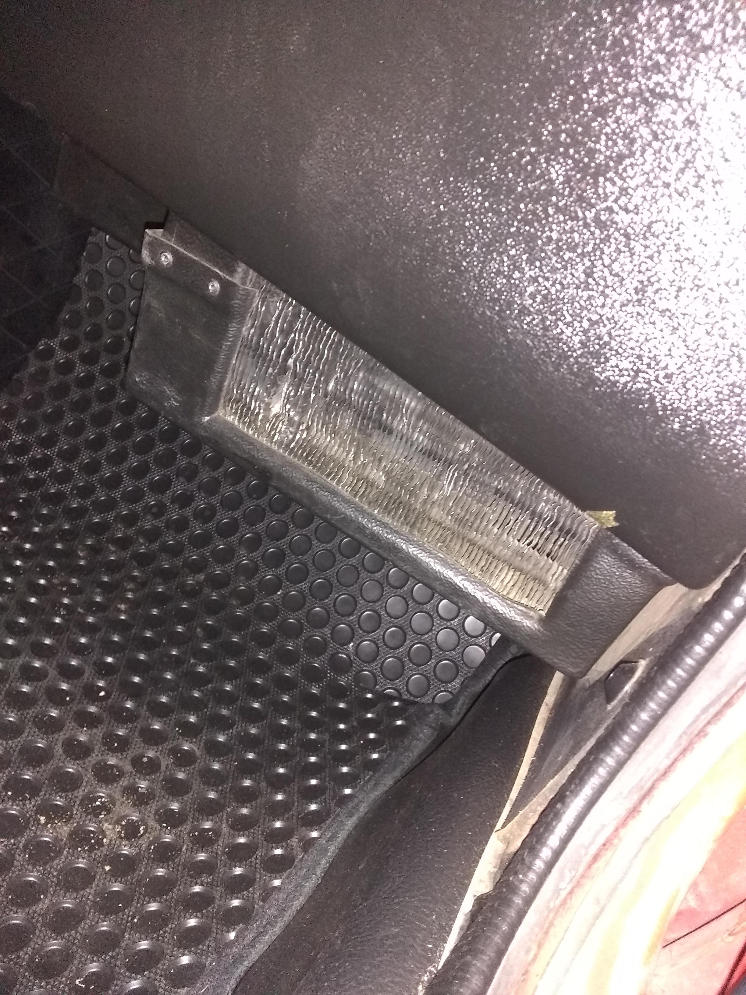

Is it worth keeping this A/C unit on the car? I have read these A/C units aren't that great. I don't know if it can be repaired or not.

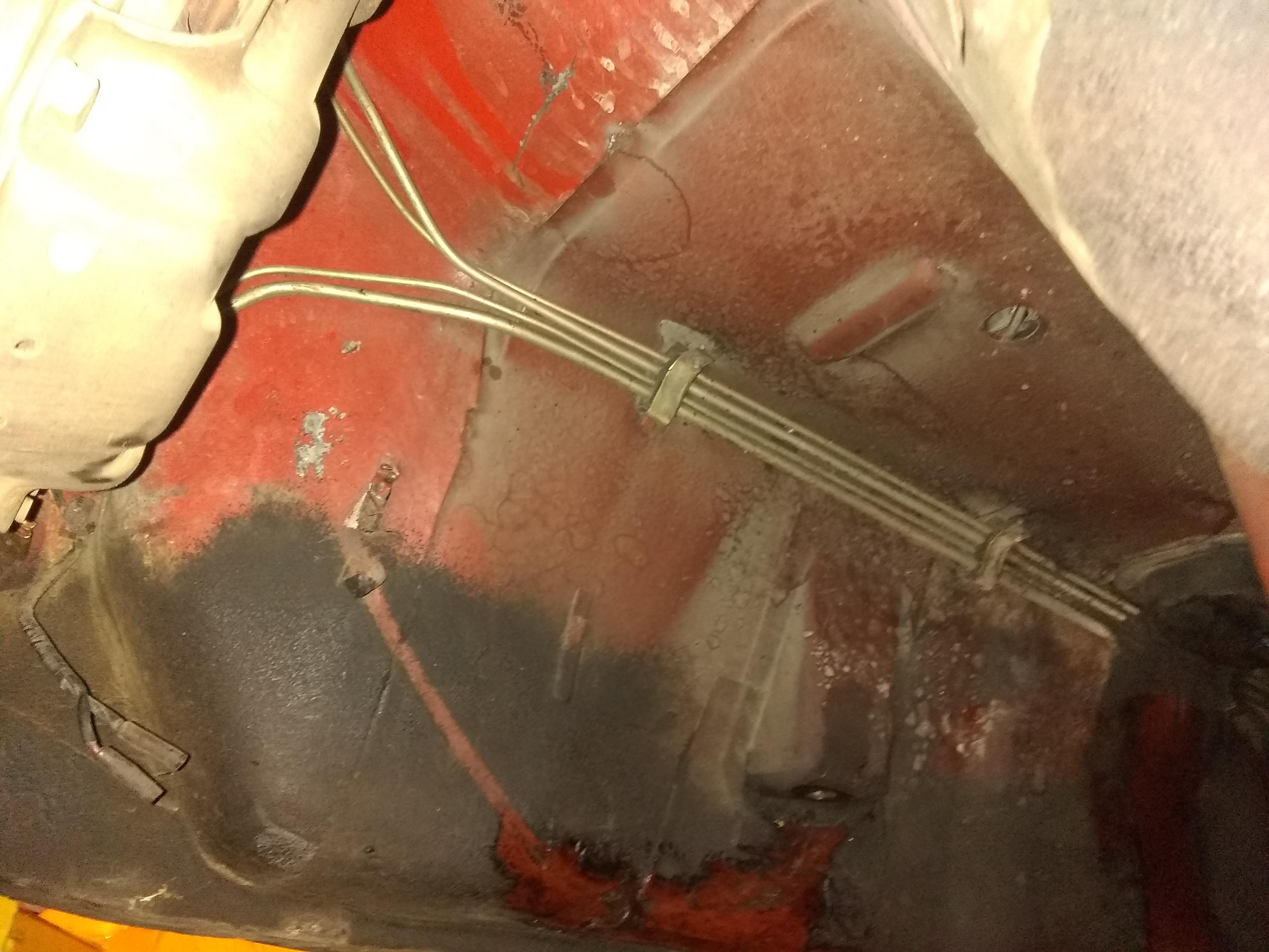

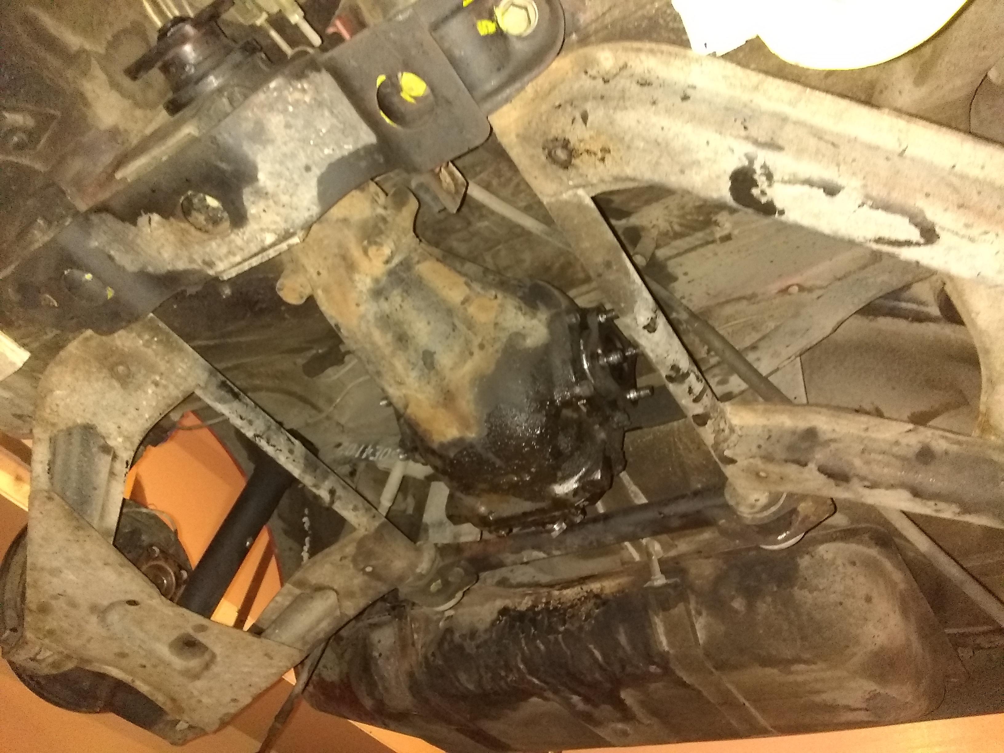

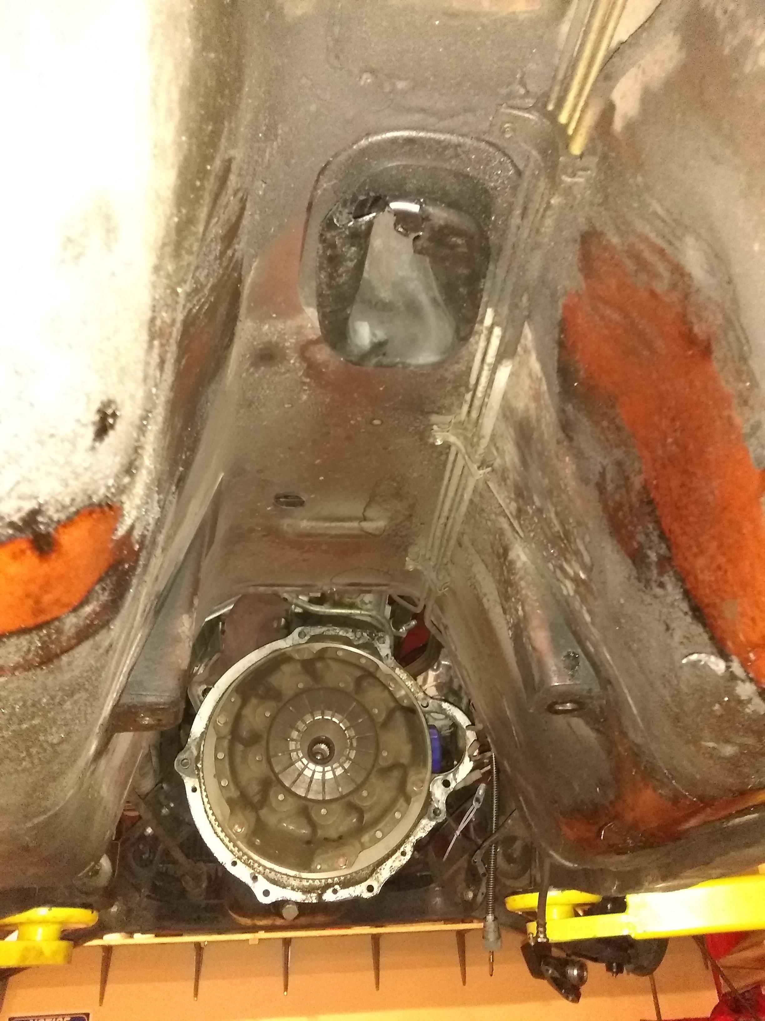

Here are some pics of the underside of the car for fun.
