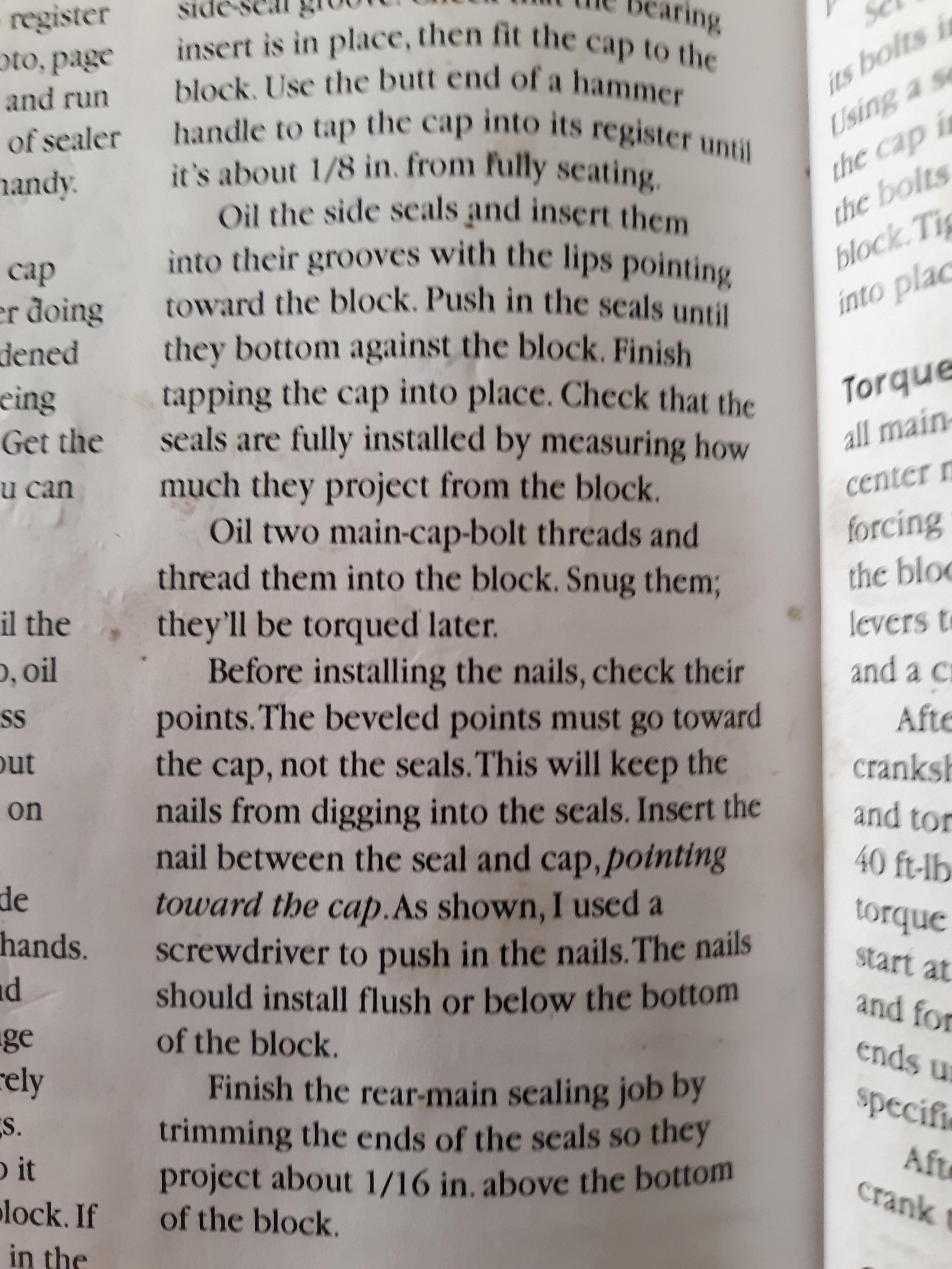

I feel good about the side seals. I wanted to post it here for reference. There isn't much info on the web about the OEM nissan seals. It is not confirmed but I feel strongly about the following orientation being correct. There is a strip of metal on one side that is barely visible. It is embedded in the seal. I wouldn't have seen it except I tore up the old one getting it out. The metal strip goes in towards the bearing. If it leaks and I am wrong I will post up the correct info.

You're right about no info online. I got my "how to rebuild" book out this morning and here's what I went by...
I rembered them having a metal wire like strip embedded in the rubber I assume for some rigidity to push them down? I had to nip that off to get the cap to sit down flush.

Thats great info. It looks like both types of side gaskets are covered. The OEM one I am using, without the nails, fits real snug on its own. I have some leftover Motorcraft sealant that I really like.  I ordered the competition oil pan gasket before reading that it may be best suited for the competition pan. We will see how it goes.

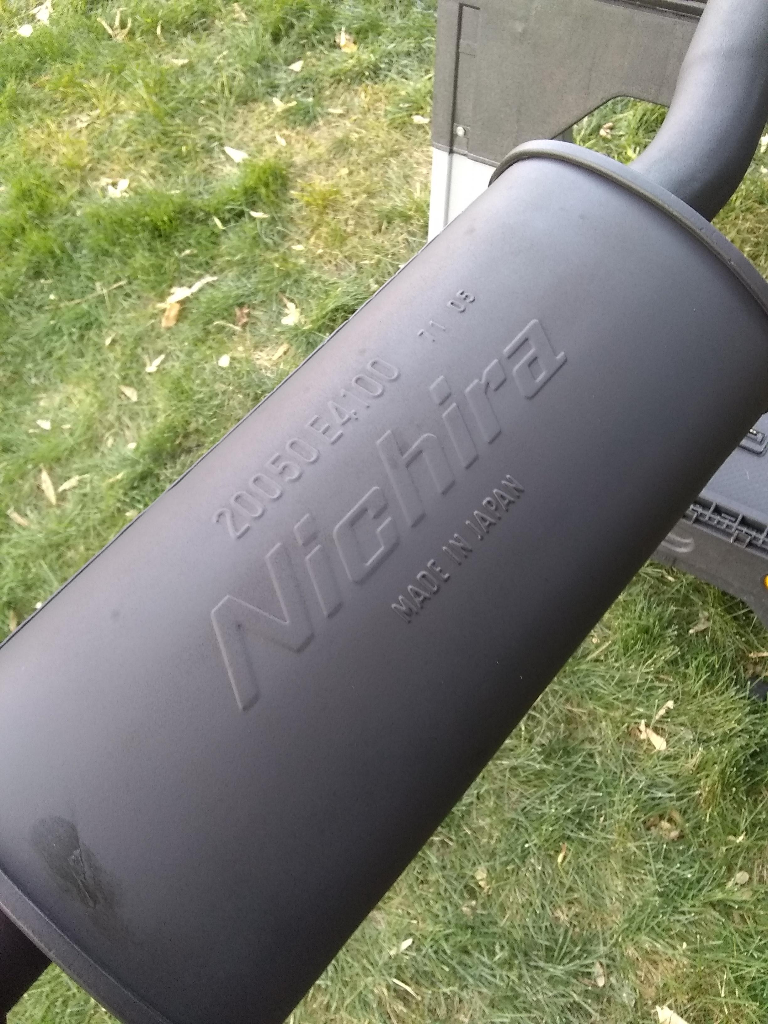

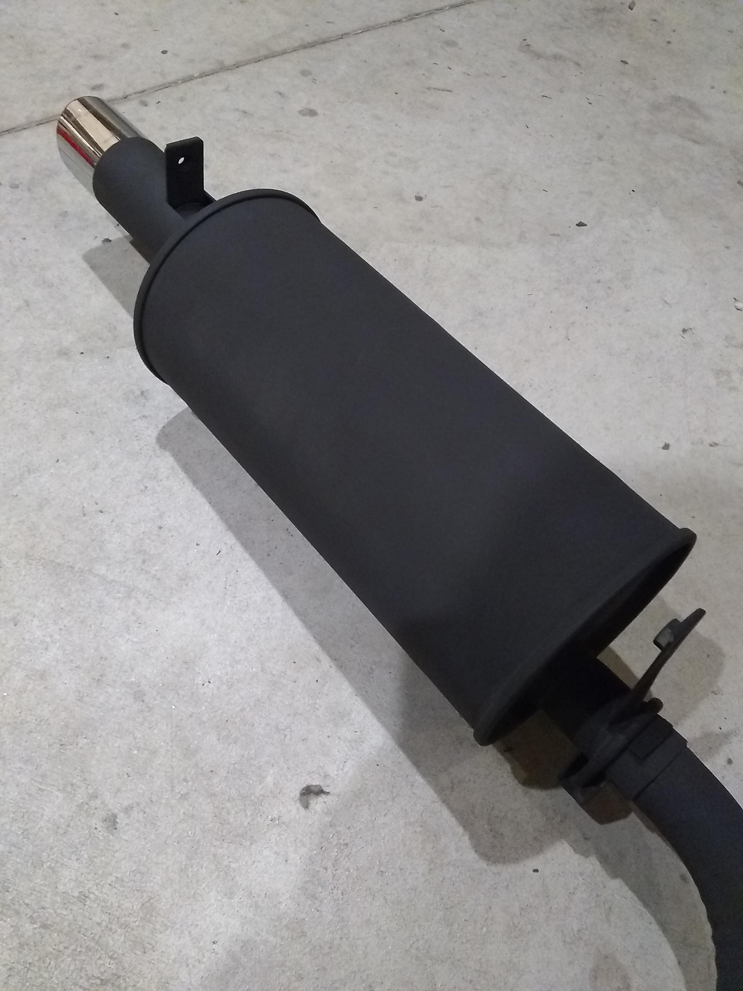

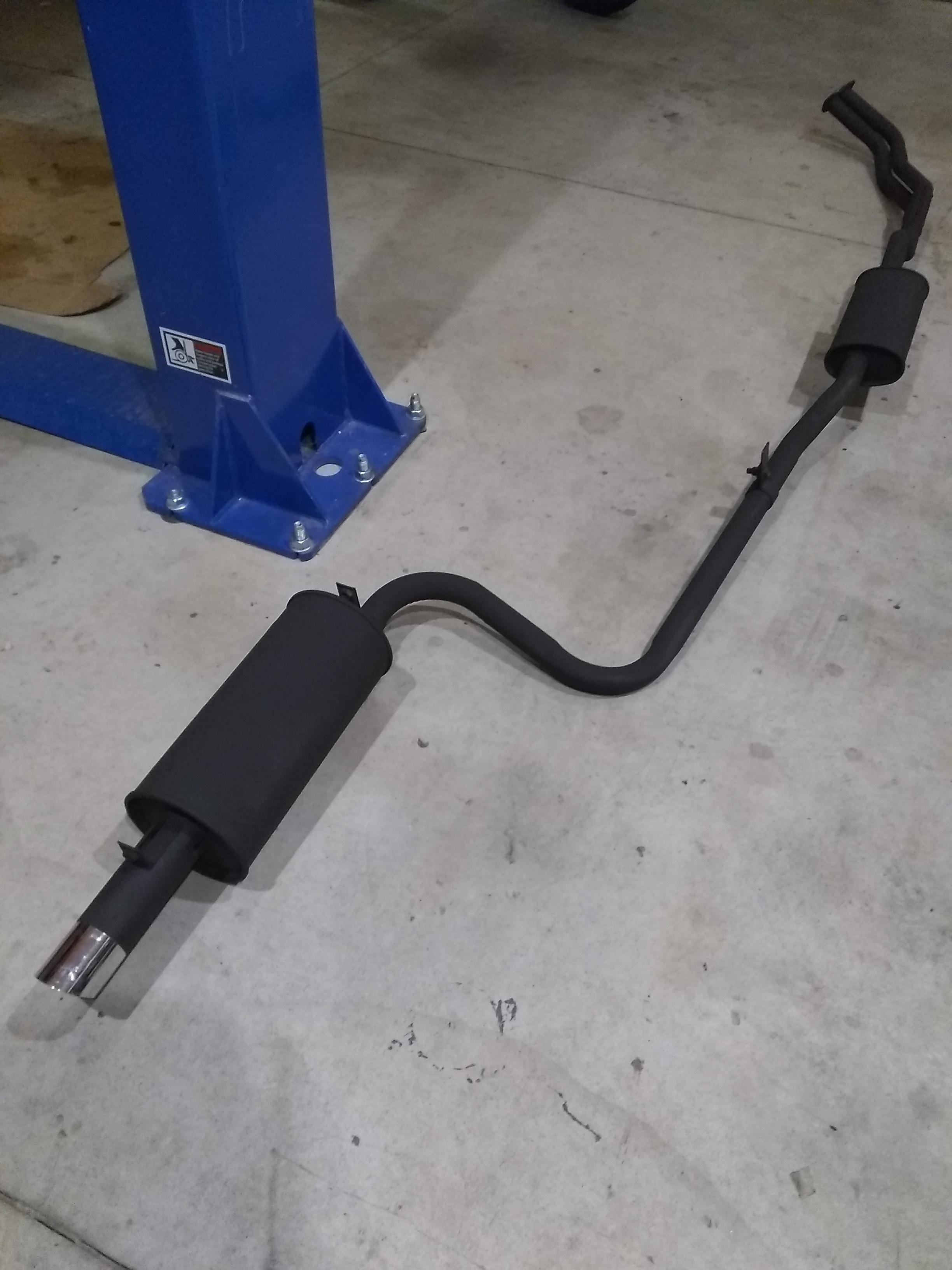

Another big day. Today it was my daughters birthday party at the house and I still got the exhaust painted, the steering rack bushings installed, the sway bar bushings in, and the differential sealed up.

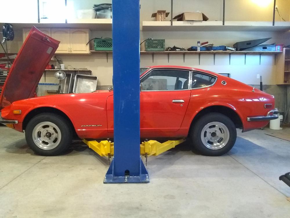

In case anyone is still watching, here is a picture of the car with kyb shocks and spring kit from zcar depot. I also replaced the rear rubber spacers with poly ones.
Is the car sitting a bit high? Could it be the torque sequence on the rear bushings making the car ride so high?
I tightened the control arm brackets and differential mount cross member nuts with the car in the air. Then I tightened the large bolts with the car on the ground and the suspension loaded.
