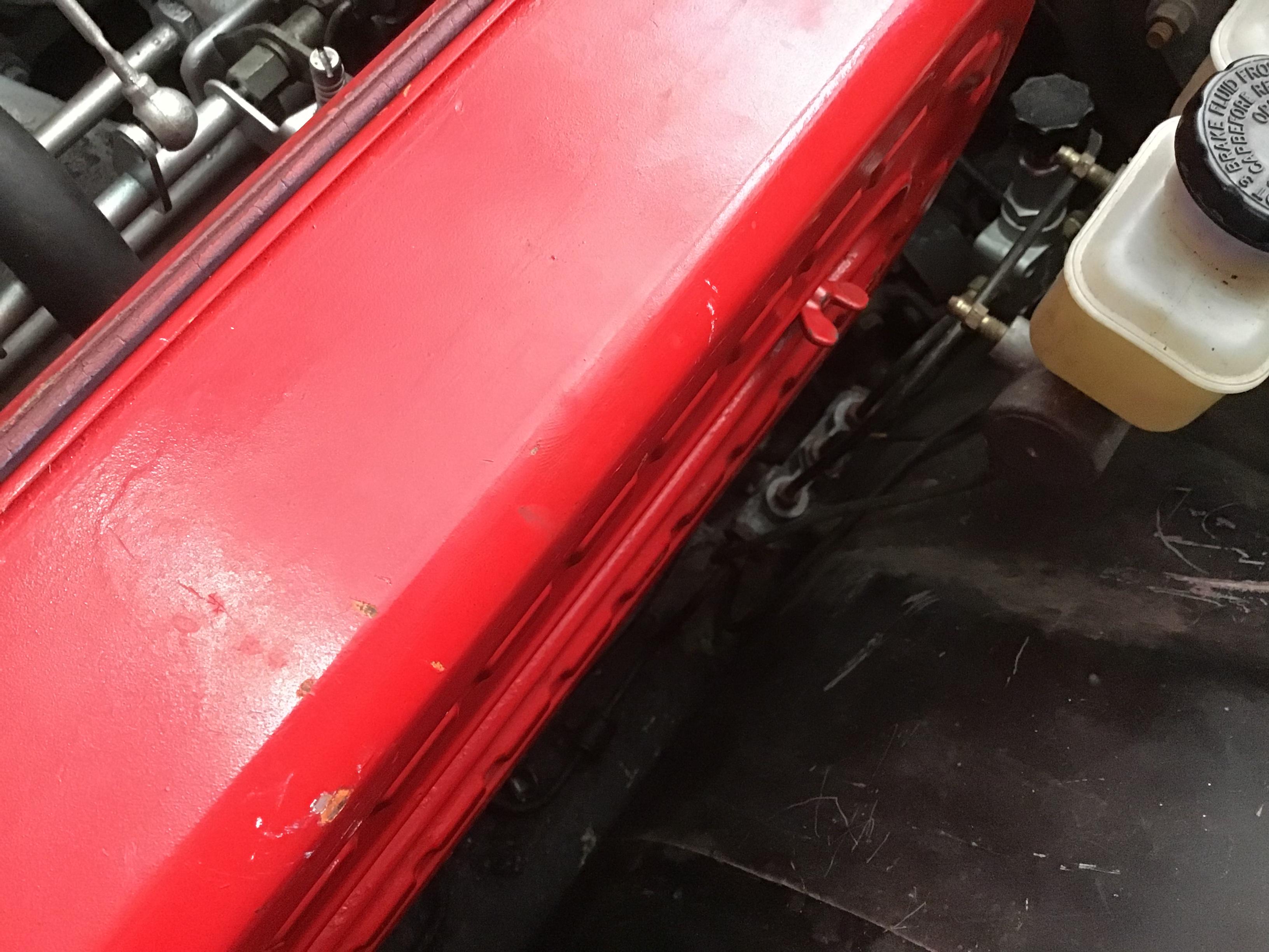

My air cleaner won’t clear the brake bleeder valve.  I must remove the air cleaner cover along with the back plate that is supposed be attached to the carbs.  I can never actually attach the back plate and can only secure the entire air cleaner by the two wing nuts.  Can someone tell me how far their bleed valves protrude from the master cylinder and also the gap between the tip of the bleeder valve and the air cleaner cover?  My bleeder protrudes 3/4 inch from master cylinder.  I have 1 inch gap between tip of bleeder and the filter cover.  In essence I have one inch of clearance to remove cover.
any help is appreciated.
Yes, It’ll come off and on with only the wing nuts holding the entire unit together.  If I mount the back plate to carbs then I can’t squeeze the cover on.  I can see it’ll be tight, but I tried every which way to fit the cover when the back plate is secure.
it always hits the front bleeder valve.

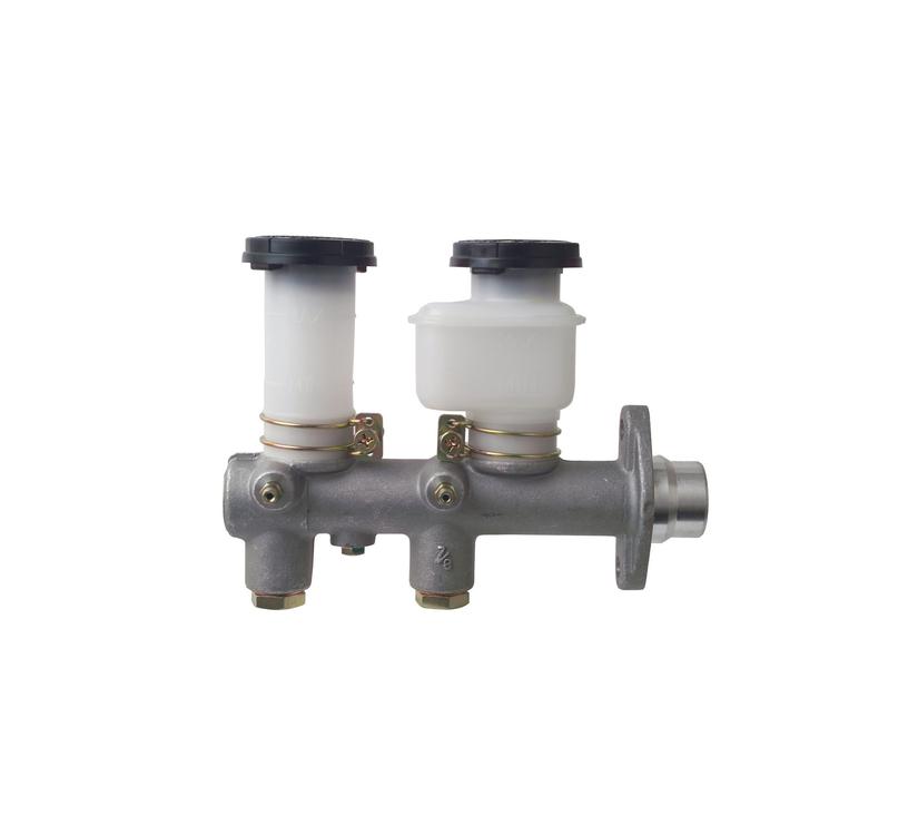

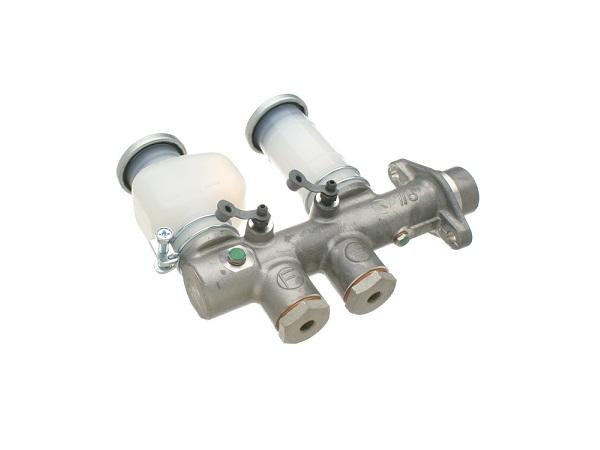

Just keep in mind that the picture @siteunseen posted is for a later car where the front brake circuit is closer to the booster. Otherwise, the bleed screws are shown correctly.
