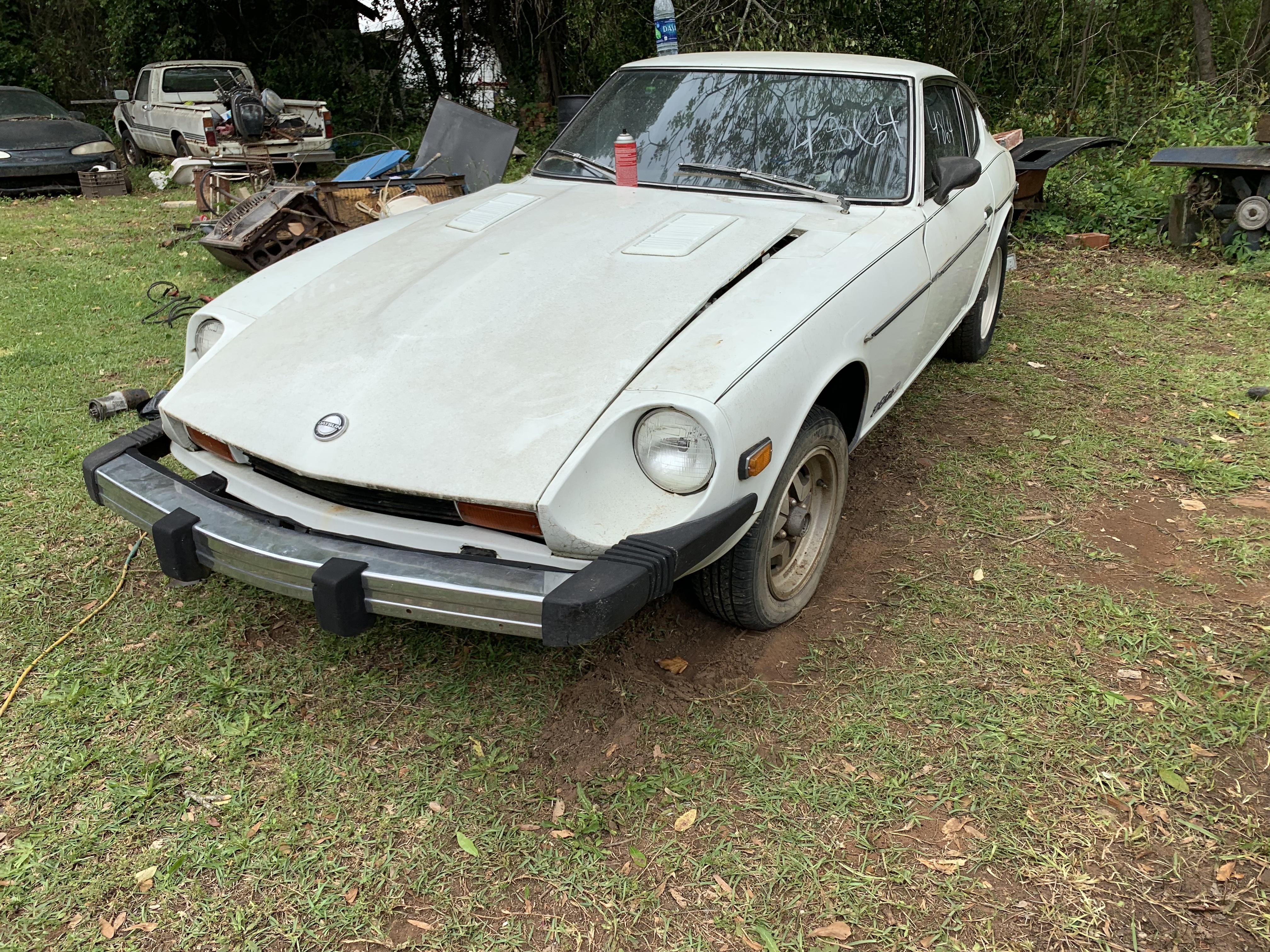

I have two 280's, one black and one white. The black one was the donor vehicle as i deemed the rust situation and previous fender bender to be more than i cared for. It was an automatic. At the time we got its engine to run while up on stands. The other is white with a 5speed. I assume it was a swap due to not having a 5speed badge. This car was saved from a local scrap yard along with some choice parts out of a green all original 76 that had seen better days.
We swapped the engine from the donor vehicle to the white one and it no longer seems to want to work. fuel wise anyway.

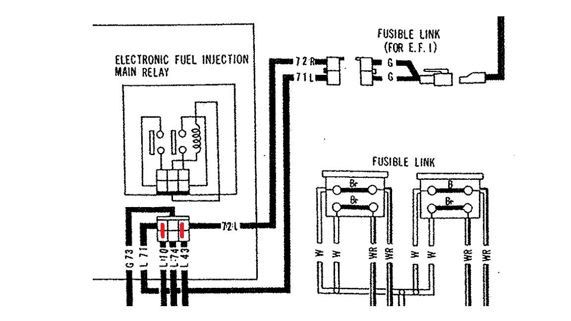

So, if you're concerned about grounds, check for continuity from wire 74 to ground. You'll find this wire at the EFI relay. It should be on one of the middle pins on the 6 wire connector.
The coil on the EFI relay is energized off the white/black wire from the ignition relay (make sure the ignition relay is good).
For testing, you could put jumpers on the engine harness at the EFI relay as I have shown in red. For safety, keep the fusible link unplugged until you are ready to test.

Just to make sure, did you check the EFI connection by the battery?  It splits off the positive terminal.  That connection can get overlooked connection wise and or become corroded.  There is also a fusible like there that you could check.  top picture, upper right hand corner.
