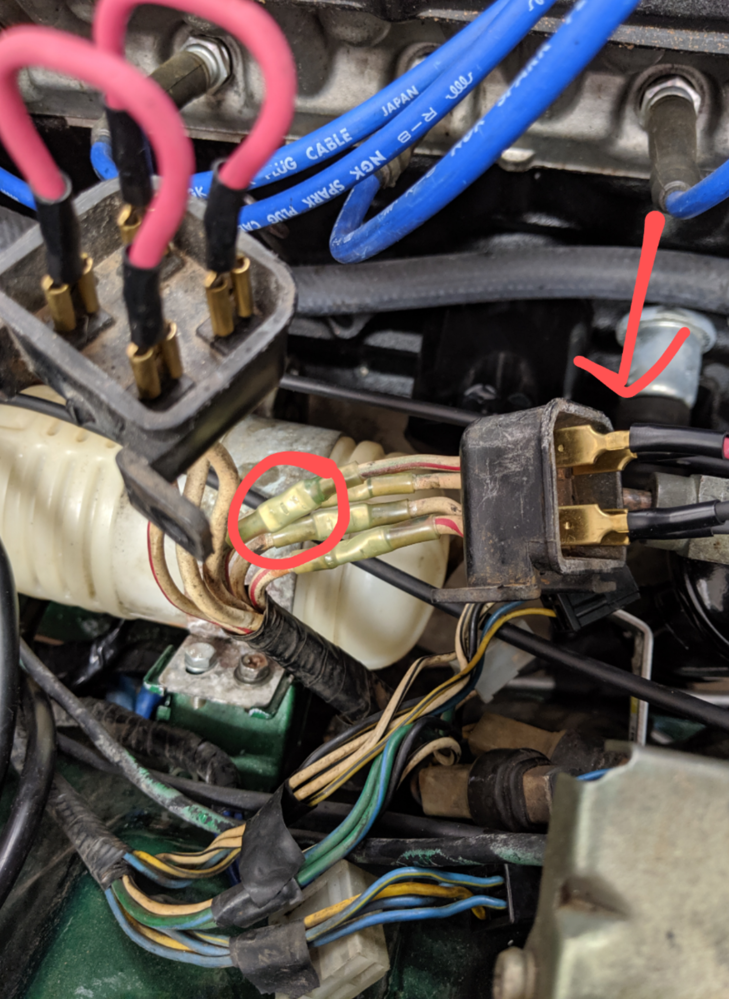

Digging deeper I do remember some splices in for the connections to the fusible link that I thought I fixed from the PO. When I got the car there were heat shrink crimps where the plastic was cracked and gone so I took them off and redid them. The fusible link in question (I believe it's the one closest to the engine in the front) has some green corrosion within the crimp and I also didn't get all the strands into the crimp. If I was to cut all of this out and redo it what gauge wire should it be? It looks heavier than the 14 gauge I have and is getting pretty short from whatever the PO did.
You should do the Cadillac upgrade that @wal280z came up with.
I can't find on this phone but will with my lapdance.
2 minutes ago, Patcon said:
I like to solder connections when ever possible. Especially some where , like there, under the fusible links
How powerful of a soldering iron do you have? Using a 15w one I was struggling with 14 gauge
