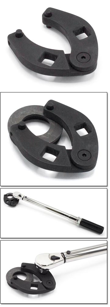

31 minutes ago, Patcon said:
I thought I would add this here.
MSA now sells a gland nut tool. Pretty reasonable and allows torquing
https://www.thezstore.com/page/TZS/PROD/classic07/60-9956
The MSA Summer Sale email pushed me over the edge.  I just ordered a full set of Koni's and the gland nut tool  Sale price + free shipping + no sales tax.  Rationalization rears it ugly head!
