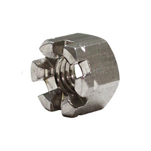

I think I might have the answer for you...
https://www.belmetric.com/stainless-castle-nuts-c-3_558_1376/cn8ss-castle-nut-stainless-steel-p-8342.html?zenid=3j9n5fjlbd4p3hntj7jub44nl5
CN8SS - Castle Nut Stainless Steel
Looks to be a lot shallower than what you bought, although maybe not quite as shallow as the Nissan OE item.
I've bought from Bel-Metric before.  Good vendor, good products, great catalogue.
BTW, if all else fails you should maybe pay your local Nissan dealer a visit.  This might be a PN that's still available.
