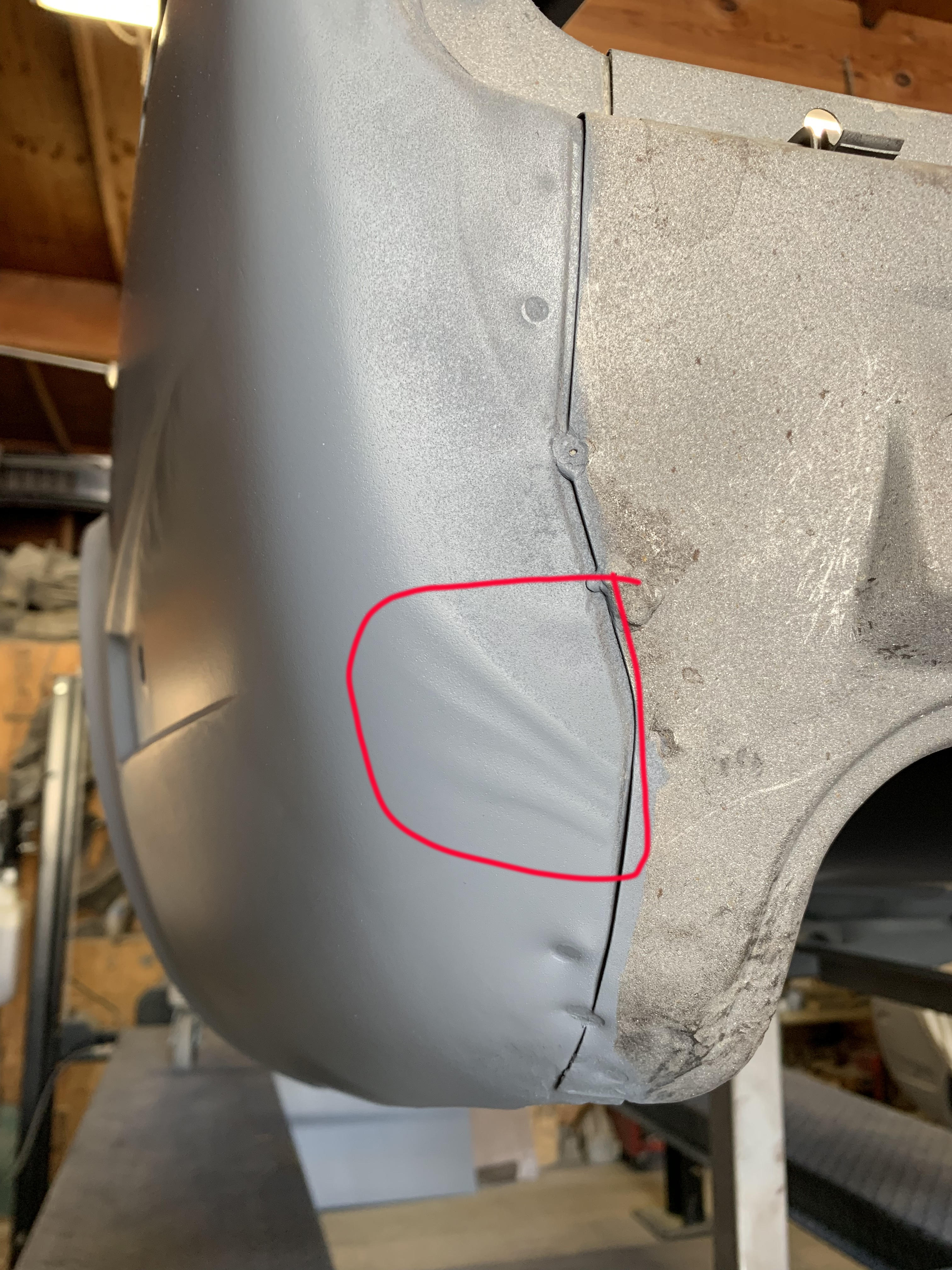

Wrinkles in 240Z Body: Lower Left Rear Corner (Opinions Wanted)

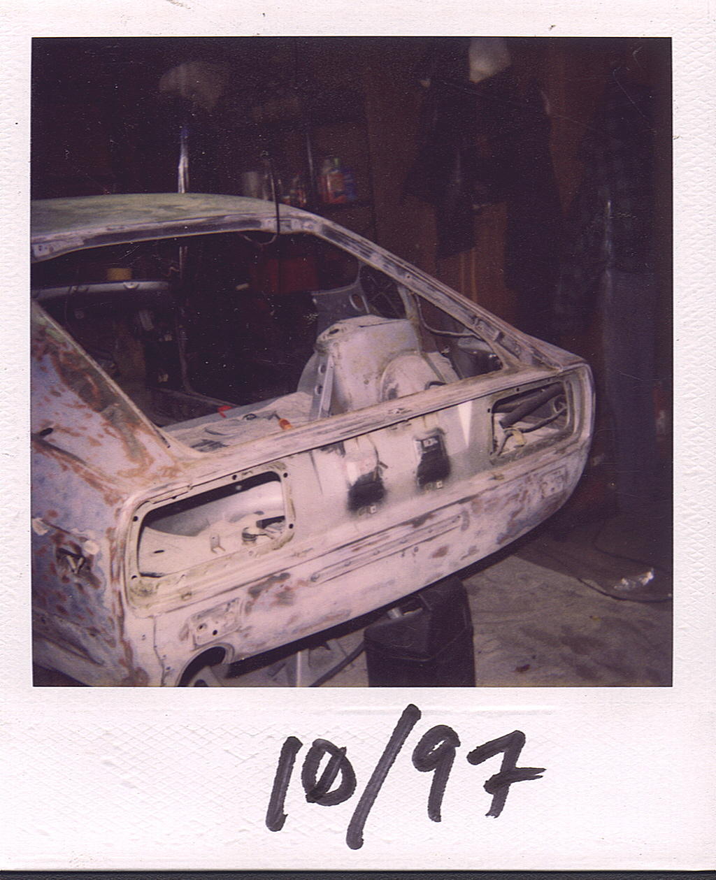

None of these wrinkles on mine...  even back in 98 when I had the Z sandblasted.  Although I do see some bodywork in that area.  Maybe these were smoothed out with filler?  Enjoy the before and after shots...
Sheet metal shapes were formed on a hydraulic press over shaping bucks with heat and pressure.  Your car is a perfect illustration of the technology at the time and just how much curvature could be formed in sheet metal.  It is why, for instance, the early headlight 'scoops' were made of FRP and later ones metal as the technology and machinery improved.
