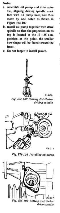

Went back to fix oil pump and dizzy orientation the correct way 11:25 short tang on left side. Dizzy rotor on point with #1 plug on dizzy cap. Cylinder #1 at TDC.

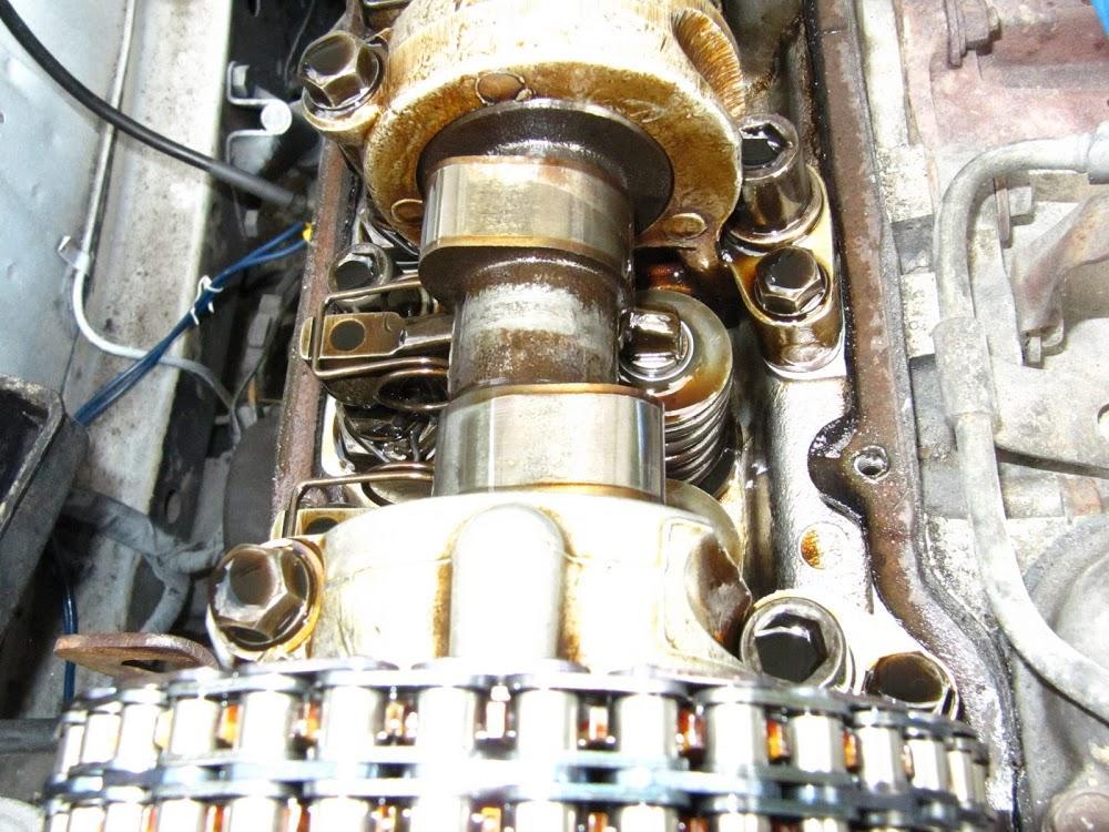

Are the first 2 cam lobes pointed up?
Image result for 240z cam lobes at tdc

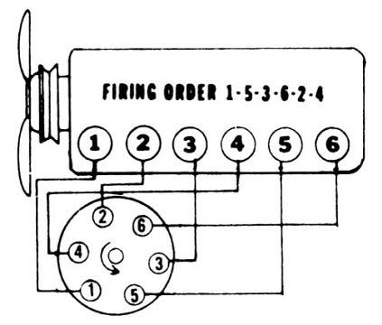

Image result for 240z firing order

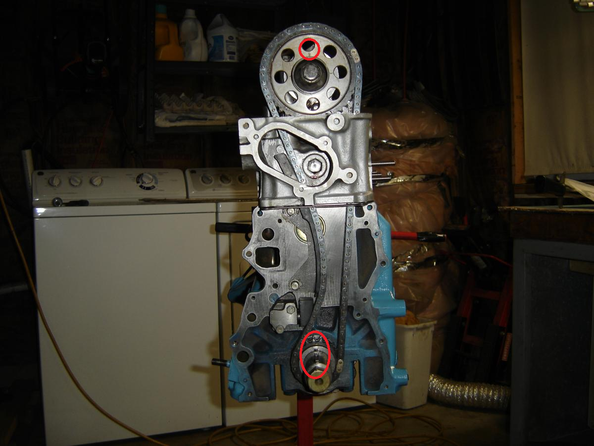

If it's at TDC the pulley should only be able to go on with the slot for the square key pointing straight up.

Make sure these aren't crossed up too.

Your timing mark is the crankshaft position.  You installed the oil pump gear in the wrong position.  Best to take the oil pump back off and reinstall it and the distributor drive quill correctly.
https://www.classiczcars.com/topic/62655-75-280z-wont-run/#findComment-581829
I just noticed that the FSM never really says to have the timing mark at zero when installing the oil pump.  It must be assumed that things are done directly after installing the timing chain.  No wonder so many people have problems.  They left out the most important part, for people doing only the oil pump work.

For visual verify isn't that when the first 2 lobes are up-ishy looking?
