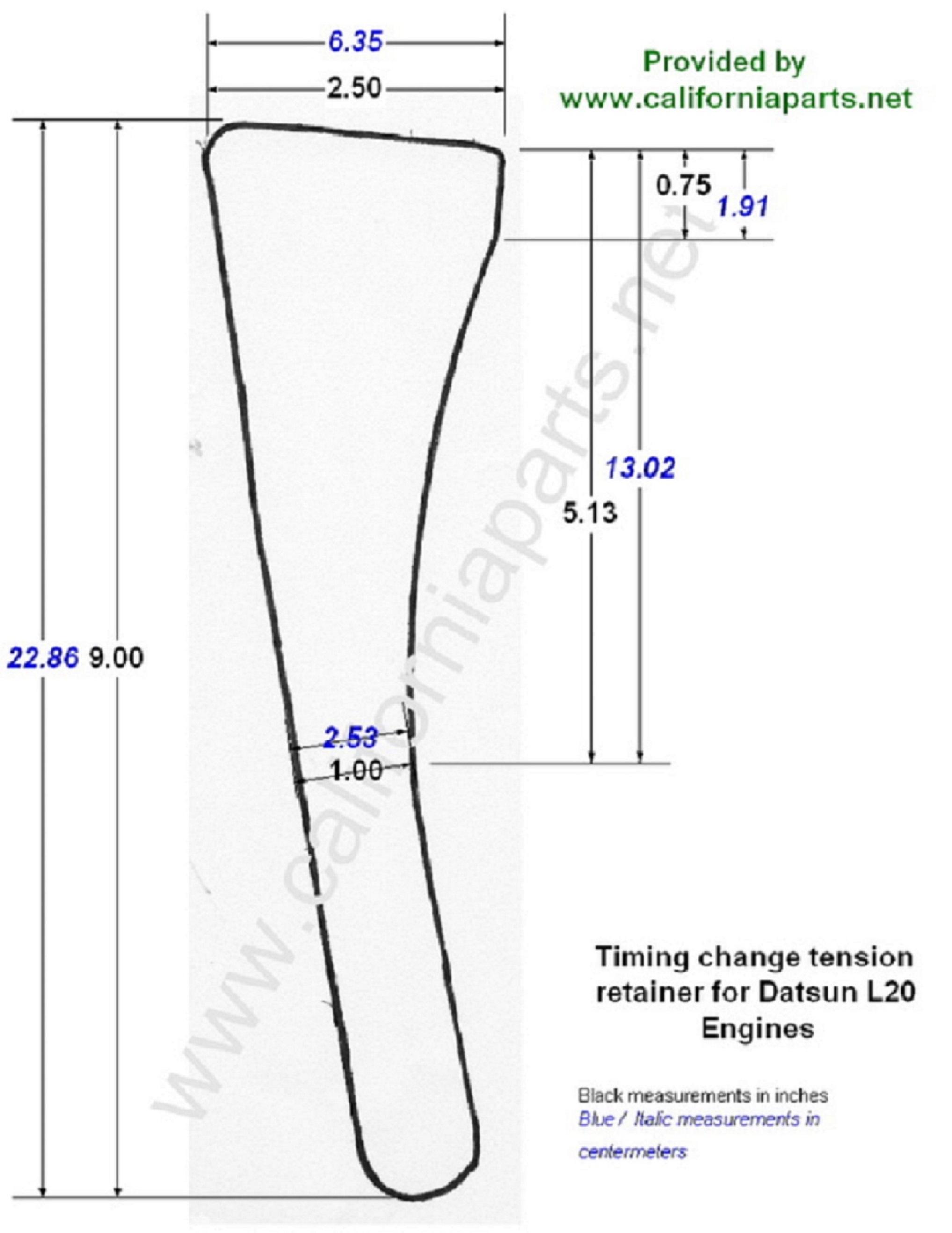

I made the one from the down load plans.
The one I scanned? If it worked I'm happy. I wasn't sure the true size would come out on a printed piece of paper. Thanks
honeslty cant recall, but it did have dimenions, and I did have to adjust printer setup.
Edited by Dave WM

I'm a bit nervous about pulling the camshaft after the warnings. I don't mind digging into things, but would prefer to not need to pull the fan, etc. I have the time to do this as I'm waiting for the injectors, but sounds like it may make sense to test other things first. But do appreciate all the help with the tension retainer. I'm going to go ahead and cut one out now to have and test.

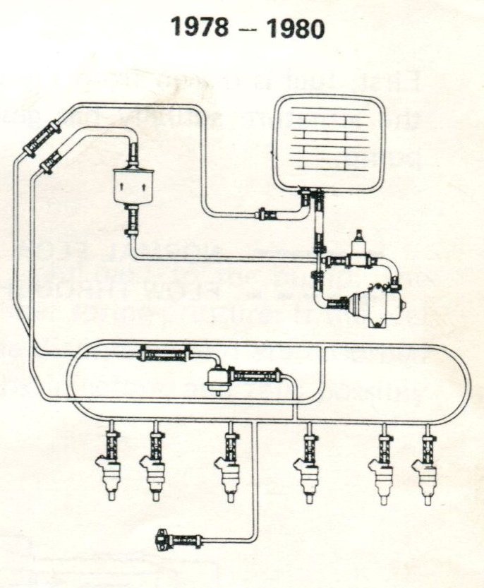

Going by my '77 and what I did as far as removing everything like your sons car, my honest opinion would be go back to a '78 fuel pressure regulator with that fuel rail.  Unless you injectors are some fuel hogs it should run fine with the OE style FPR.  I ran into that same dilemma when I did mine but after tons of reading I found the '78 one inlet style was sufficient.  Maybe the previous owner read something I missed but I doubt it.
I was looking at the OE FPR and have a question. With the fuel rail that I have it doesn't look much like the pictures in the EFI book. It's basically tank > fuel filter > Rail (injectors) > return > FPR > back into tank. Maybe not too much different than stock rail, but less loops and such. If I get a stock FPR, do I just put it on the return line after it's gone through the aftermarket rail?
