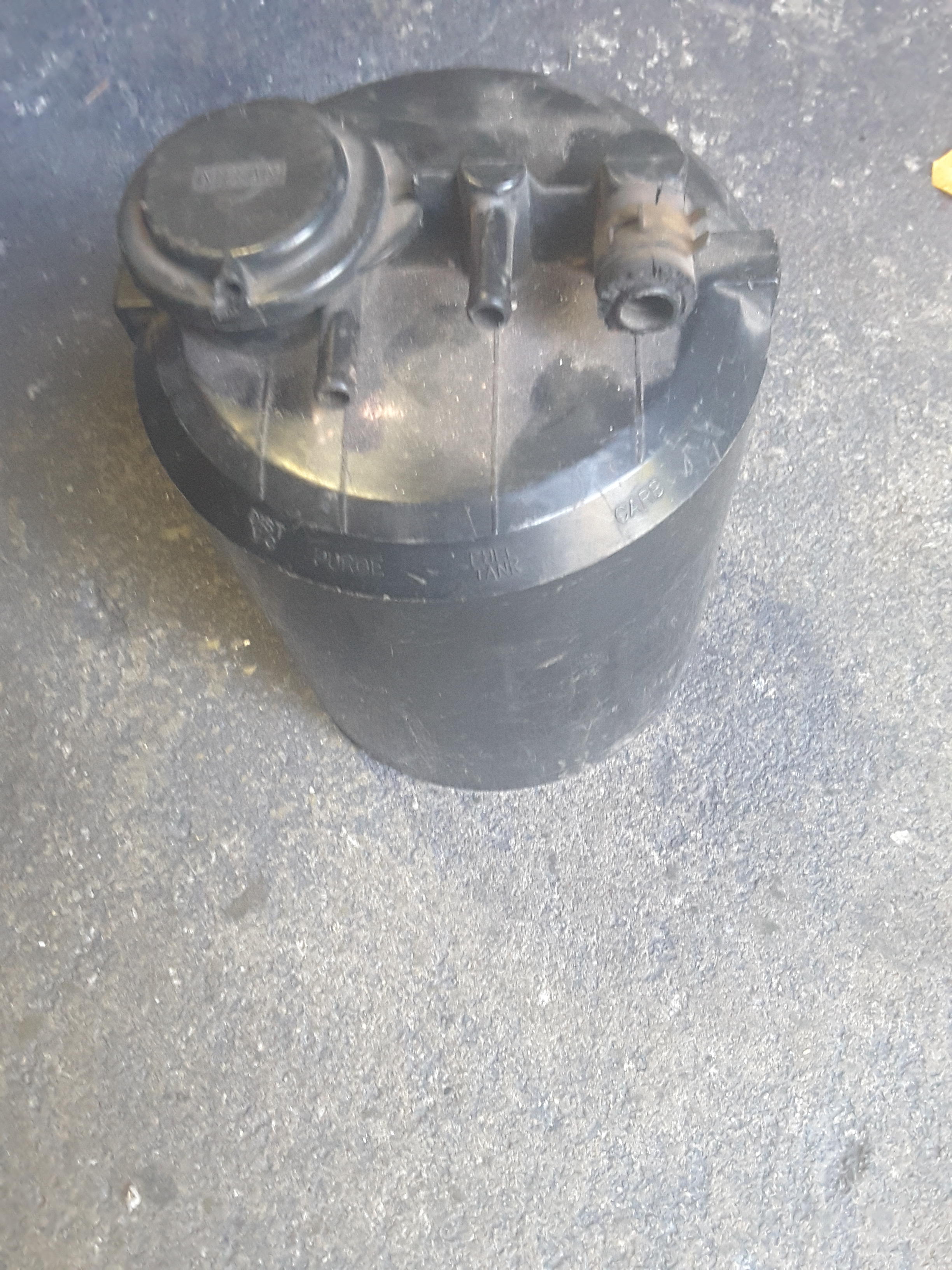

I've been looking for a charcoal canister and haven't been having much luck. Can I use a 280zx charcoal canister instead of the 280z? It's still 3 nipple, so I'm assuming it would work fine. But didn't want to spend money before making sure.
It should be ok. The 3 lines are the same on all the variants.

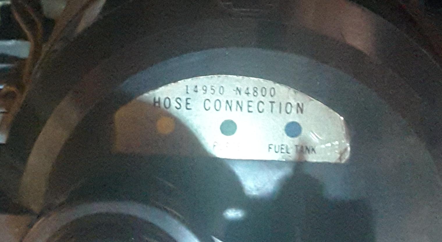

Tube layout.
Yellow: Distributor vacuum.
Green: Purge
Blue: Fuel tank
White: Carbs. This is for the 240Z, 260Z carb models and also fitted to the early 280Z, but then with a cap p/n: 14964-F1700.
The three tube variant part numbers: 14950-N4800 and 14950-P8200 (280ZX)
The four tube variant part numbers: 14950-N3600 and 14950-N4200 (early 280Z)
I'm not sure what that fourth connection was intended to do. The first year for the carbon canister was 1974, and (even though the 1974 model used carburetors) they capped off that fourth connection.
I don't think "CARB" means "Carburetor".  I would guess that it means "CARBON".
I've never seen a picture or vacuum diagram that did NOT have that fourth connection capped off. I don't know what it does.
