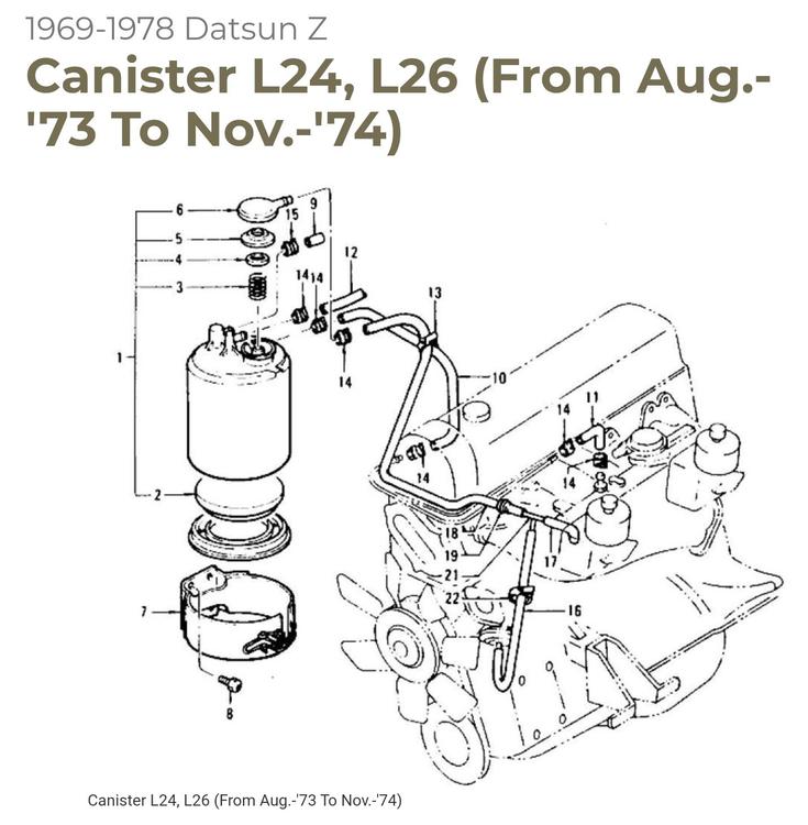

I now have a carbon/charcoal canister and it looks good. Looking at where it hooks up to, I see where the purge line goes to but the other line shows going to a 3-way connector. I don't have a 3 way connector. I have line directly connecting the dashpot to the bottom of the throttle chamber. Should I just add a 3 way connector in the middle of that? It's difficult to see exactly in the diagrams.

Sounds like somebody has messed with your vacuum lines and was unable to resist the urge to connect a vacuum line to the "Sorry:" piece.  Not uncommon.  The dashpot does not use vacuum, it's open to atmosphere.  Make your vacuum lines look like the diagram.  Get a three-way connector.

They messed with almost everything, including the vacuum lines. Sure makes this an adventure. So dashpot does not go to vacuum. In that case, one end of the 3-way goes to the throttle chamber. One to the charcoal canister. What does the third end go to? I think it says to the distributor in the diagram in the EFI manual, but then has a not that it would be for automatic transmissions only. Since this is a manual, does it even need a 3-way? Or does the charcoal canister just go straight to the throttle chamber?

Yes, it goes to the distributor.  Manuals and automatics both have vacuum advance timing also. The port on the throttle chamber is what they call "ported vacuum".  It only has vacuum when the throttle is open, not at idle.  The distributor's vacuum controlled timing advance and the carbon canister both use ported vacuum.
Ported vacuum port on the throttle chamber goes to both the carbon canister and the distributor.

To add some info to Zed Head's post... The ported vacuum signal only provides vacuum at a "light cruise" pedal position. There's no vacuum at idle, and the vacuum falls off quickly above light cruise. It's peaky right at one throttle blade position (light cruise), not simply when the throttle is open.
And there are two ported vacuum connections off the bottom of the throttle body. Make sure you are using the correct one. You want the one on the right side. The other one is for the EGR system.
Actually, you could describe the vacuum level on the port as matching manifold vacuum once the throttle blade opens.  Zero when it's closed, manifold pressure (vacuum) once the blade moves.
That's the simplest view.  I think that Bernoulli, and Venturi's, principles have been discussed before as causing higher vacuum at the crack of the blade but I don't think that anyone has actually measured.it.  So, really, it's just none and some.
