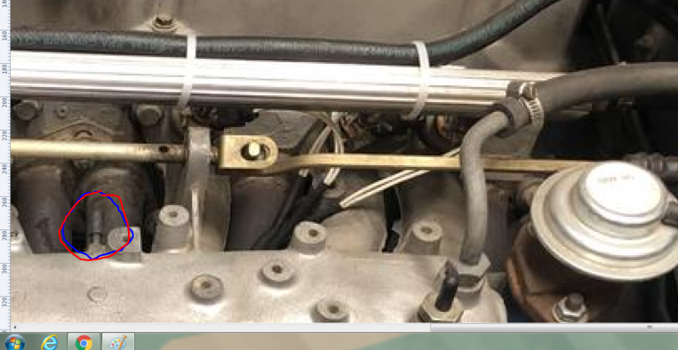

Where does the FPR vacuum line go to? Or know where in the service manual it goes over vacuum lines? I'm paging through but haven't found yet...
 It should go on one of the plugged ports on the driver's side intake manifold, down from the fuel injectors. Looking at the fpr though I think its plugged off too. You have fuel IN and OUT then that rubber plug up top, that's the vacuum line in my opinion.
Pretty sure it's this one, circled in red and blue.
Thanks. Heading to get vacuum hose and a new gas cap now. Once I hook up the FPR, should I be able to tell a difference listening to the engine at idle if it's working?

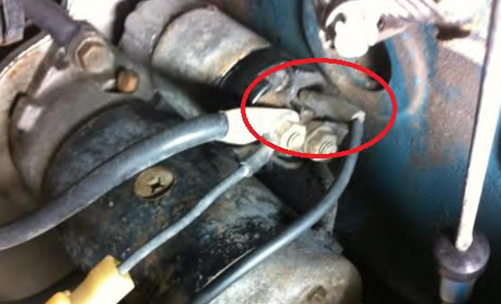

The fuel gauge should read a maximum of 36psi with no manifold vacuum. Test and adjust the regulator with the engine off.
To run the pump just remove the spade terminal from the starter motor and have someone hold the key in the start position. That will run the pump without cranking the engine.
Once you have done that start the engine and check the pressure. Idle should be around 32 psi. If you flip the throttle the pressure will rise close to 36psi briefly, then drop down to lower than idle pressure and return to idle pressure.
