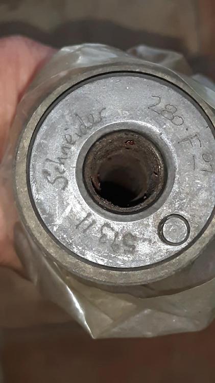

Question for everyone. How do I identify the model/type of cam? Pulled the valve cover, but the camshaft is just labeled Japan and C on one side, and E30 on the other. The C is on it's own raised section on the shaft. To fully identify, would I need to pull the camshaft? If so, I have a bit of research to do as I've never done so.
Here's a Schneider I have. The front is scribed with the info.
Go to Schneider's website and find the info. Mine is a 280F
You'll have remove the cam sprocket though I beleive. Whole nother can of worms! LOL

Older Efi cars use milder cams from what I've read. Go to motorsportsauto.com or MSA and read their cam recommendations for fuel injection. They sale Schneider cams. You might save yourself some trouble just assuming your cam came from them? A shot in the dark...
