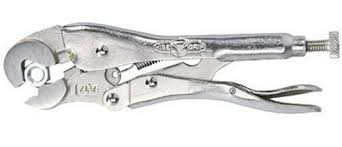

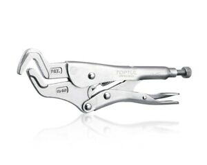

File the flats on the nuts down smooth and parallel,  Get some vise-grips like site showed or even bigger, with jaws that are in good shape.  Clamp the vise-grips down very tightly on the -nut, it's half=destroyed anyway.  Heat the area around the nut with a torch or a heat gun.  Put some force on the vise-grips and it should break loose with a sound like it broke.  If the vise-grips start to slip at all take them off and refile the nut flats and reset the vise-grips.  Take 20 minutes to setup and 20 seconds to actually break it free.

These
or these, might help
If the system is old then all four wheels really need to be disassembled, cleaned and inspected. If there is any rust or pitting in them, they can be difficult to rebuild. If they clean up you can just replace seals and reassemble. This applies to the master too.
