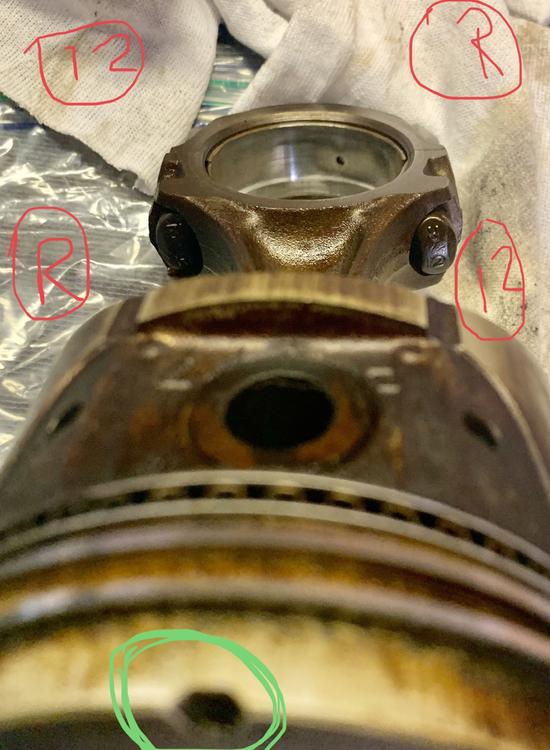

Okay, so I did a little investigative work this AM to see if I could find patterns or consistencies in the rod bolt orientation. I found no smoking gun but have some observations. The staining didn’t show anything remarkable. Captain I’d like to see what you find. Since I don’t know which ones are right and which ones the bolt fell out, I can’t determine which is correct. So there is a 12 and and R on the rod bolt. I’m assuming that was stamped there for a reason.
I took one piston and rod assemblyI think is correct and placed the piston notch forward and then assessed how the bolts were oriented from both sides. It appears that on the left side (looking down) the 12 is forward (same direction as piston notch) and the right side the R is forward. CO see if you have a similar observation or anyone who has one they know is assembled right can verify that orientation. See pics below. I love a good mystery.
