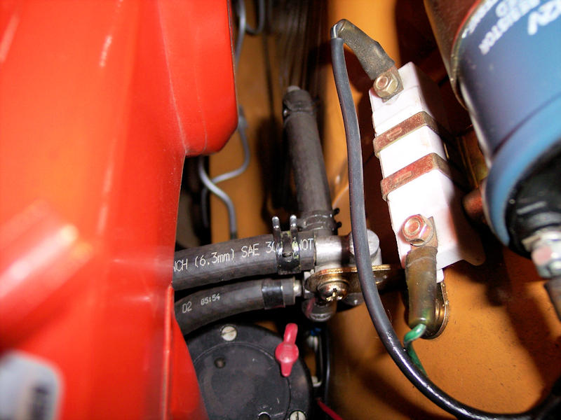

Will start the fresh rebuilt engine tomorrow. While reassembling I have decided to delete the su’s heating. Then came the questions...
A ) To keep OEM,
B ) To plug
C ) To leave open the following :
Photo 1 and Photo 2 : both sides of N36
Photo 3 : to balance tube
Photo 4 : on driver inner fender, connector from tank to ... 3 hoses
Photo 5 on balance tube, 1 underneath, 1 on top...
Thank you!!

Great car!!!  Your #4 pic is the Flow Guide Valve, it routes crankcase and fuel tank vapors into the air filter box for combustion.  Two ports face the engine, one port faces rear.  The lower of the two ports connects to the crankcase breather pipe, the upper port connects to a small forward-facing tube on the back of the air filter, the rearward port connects to a hard line rising from the left frame rail (coming from the fuel tank).  Since you are running the stock air filter set-up, there is no gain by not connecting these ports.  If you leave them open you are adding some small amount of vapors to the atmosphere.

My apologies.   I was counting the pictures and not even paying attention to the numbers he painted in.  It's #3, that's the one that confused me (still does).

I do have that!  You are correct Sir.
