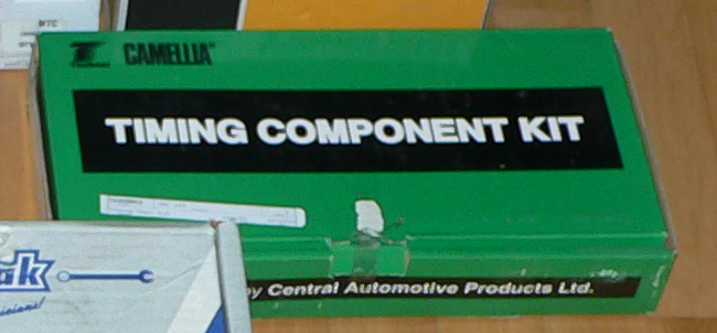

Does any one know if the ITM has it?
The ITM gear does have the marks. Reptoid Overlords confirmed that earlier. Here's my current list.
Yes Timing Marks:
TRW S462 - pic from ebay has the marks
Beck Arnley 025-0266 Pic from ebay has the marks
ITM 053-90400 has the marks (note this is a full kit) (Confirmed by Reptoid Overlords)
No Timing Marks:
Melling - Pic from rockauto shows no marks on back
OSK does not have the timing marks  - (Confirmed by Dave WM)
Federal Mogul (Sealed power) - pic from ebay shows no marks on back
One of the brands I haven't yet determined is Cloyes. Anyone seen a pic of the back of that one?
