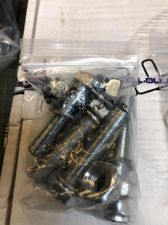

Installation was a bit of a head scratcher. You definitely have to do the bolts "just so" and in the right order or they ain't going together. The bolt that attach the adapter bracket to the spindle have to put in "backwards" (in my mind) with the nut on the inside. Bit tricky to start that nut up inbetween the rotor and spindle, but it can be done. All in the name of a small caliper and tight spaces.
I was able to give them some feed back to change one set of fasteners to hex rather than socket head to aid in the assembly.

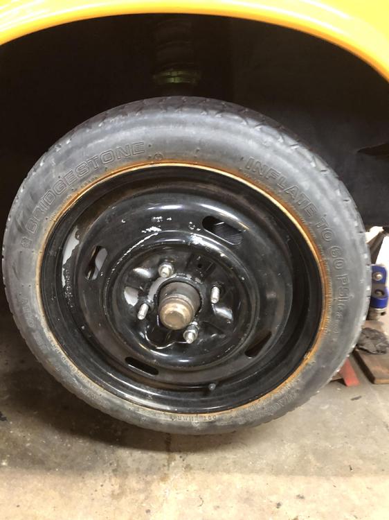

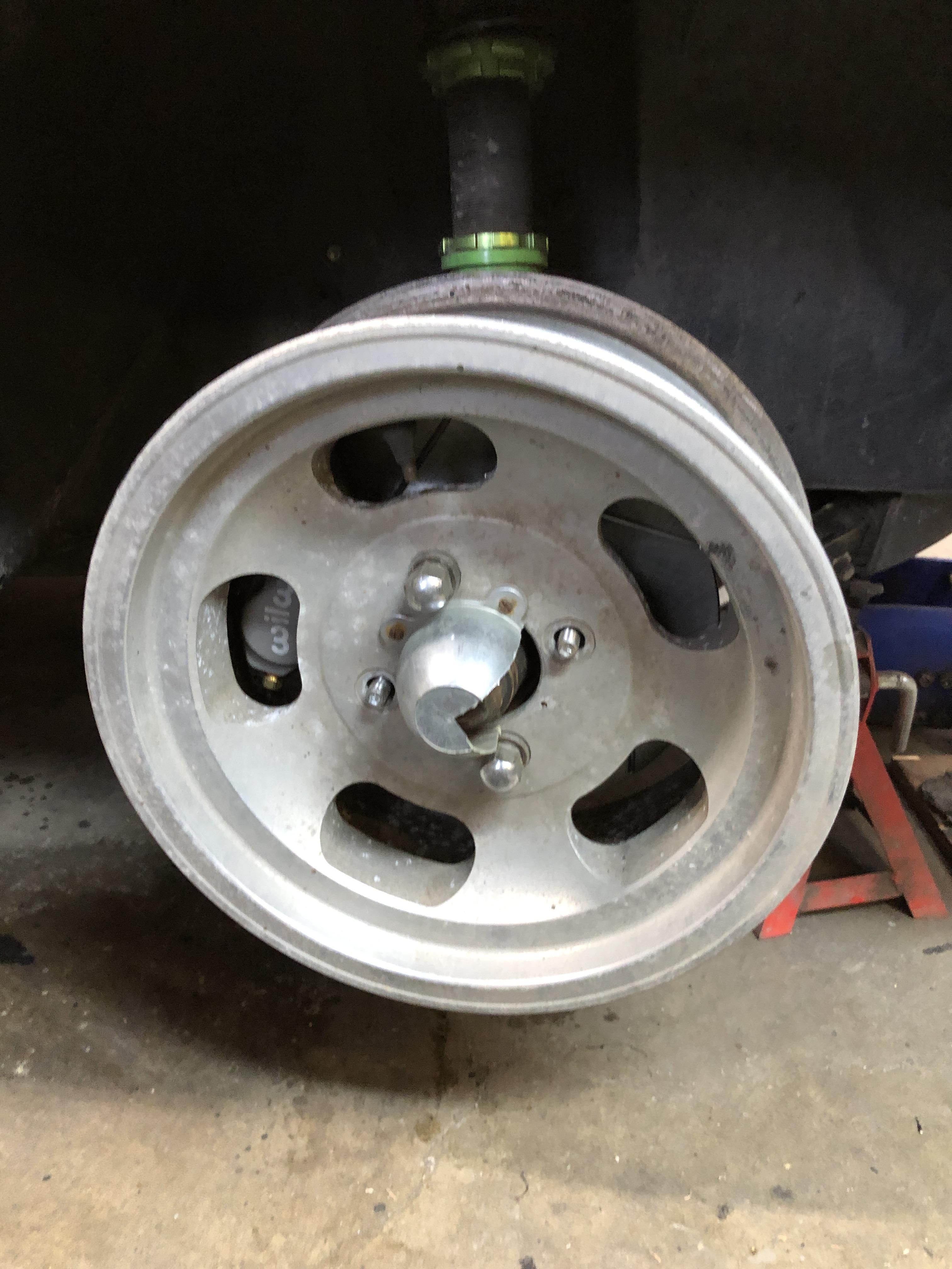

I've been able to fit all my 15's and almost all of my 14's (stock ZX alloy and standard 5 D slot mags). One set of Z steelies would fit with a bit of spacer. Can't fit a stock 13" 510 steelie though. I have a set of 13" classic  Libra's that are on another car that I pray fit these brakes as well. I know those wheels just BARELY fit stock ZX brakes, so they "should" fit these. I even have a Nissan Sentra donut spare (15") that fits! And all testing was done with NO spacers.
