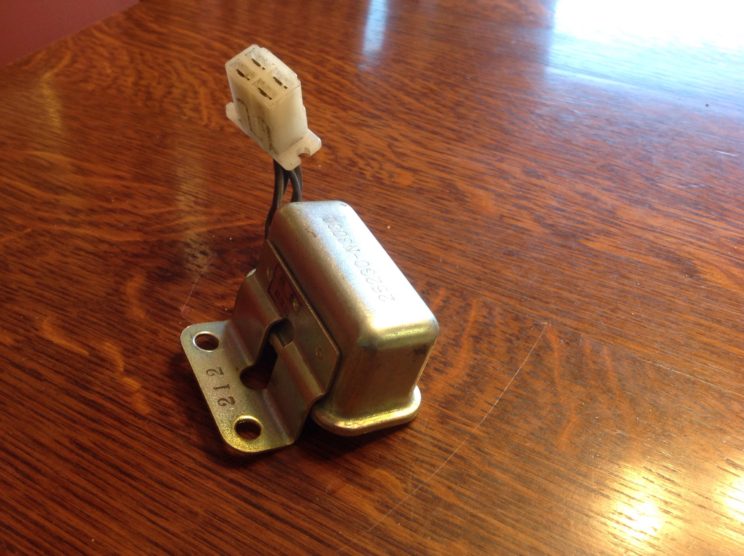

I think I would still like to have a new one under the hood for authenticity's sake. Steve knows I am not using flat tops as my car was retrofitted with roundies during the ongoing bouts with vapor lock back in the day. Does it make sense to install an electric fuel pump...?
To find a new one is unlikely.
After several years of observing e-bay, etc. I found a very nice one for my 73.
Philip's suggestion that you clean, polish and re-plate yours is a good solution. The metal housing can be removed easily by prying the retaining tabs up from the backplate. Yellow zinc plate should be used.
As SteveJ states, without the flat tops you don't need it-----for you it is cosmetic.
Edited by Zup

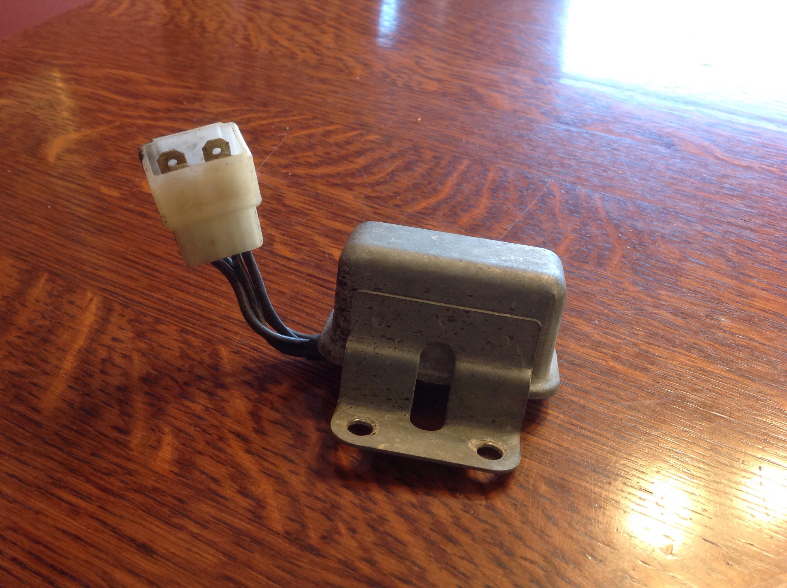

So close. I could put the male plug on it and it would do just fine.
I do have the right relay (but its ugly), so I can either exchange housings or just put a plug with new male pins and new shell and even get the right pin in the right position using the correct relay as a guide.
