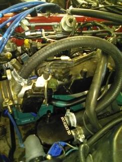

After a few hundred more miles my oil consumption issue seems to have stopped. I've added a People's Liberation Army oil catch can and can't get it to smoke anymore either. 02d38e443f026cd05c89c9a039eca232.jpg

Today I installed an oil separator in line with the crankcase PCV system. I found excessive oil in the rubber line from the crankcase tubing to the PCV valve in the manifold.  If I'm unknowingly running a cam with longer than stock duration could the valve timing be late, causing high vacuum?

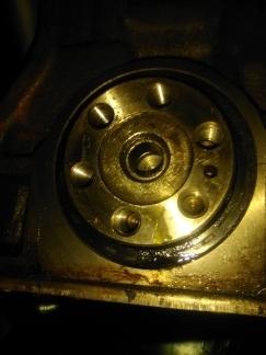

However, today I observed the oil level too low after another few hundred miles. According to the dipstick, after letting the hot engine sit about 30 min, about a half quart is gone.
I looked around underneath and discovered a bit of oil seeping down the bottom of the transmission that I hadn't seen until now.
So, being the reasonable person without a problem that I am, I got whatever inconvenient equipment that was in the way out, and discovered that the rear main leaks pretty good.
It's a Fel-Pro. Looks like I'll be stopping in by the Nissan dealer on the way home from work tomorrow.
One thing I didn't do, and it's no one's fault but my own, is install the trans to block brackets that came with the motor. Not sure if they are for structural support, but I'll be installing them this time. 87330424b791d1d594d4ae9701e42a8a.jpg
