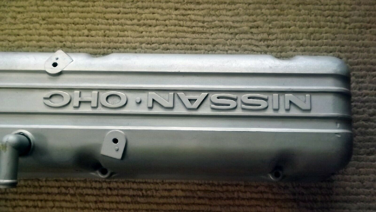

Rare NOS showing us what came out of the factory:
https://www.ebay.com/itm/Datsun-Nissan-Valve-Cam-Cover-NEW-OLD-STOCK-WITH-TAGS-240Z-260Z-280Z-OEM-NOS/333359148743?hash=item4d9dc0eec7:g:USkAAOSwTeJdoie7

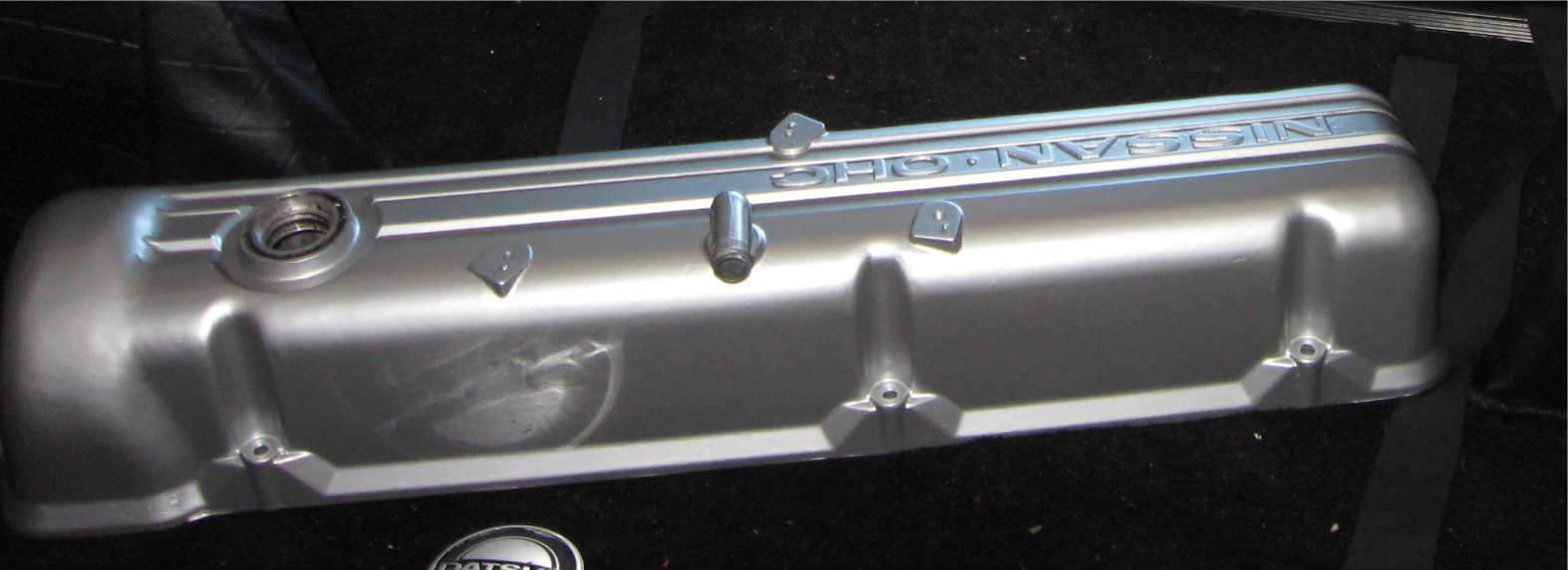

Here is a valve cover painted with high temp aluminum
https://www.classiczcars.com/topic/62990-stock-valve-cover-finish/

How would you describe the finish as shown in the photos of this NOS valve cover??
Raw aluminum, as from the mold, satin finish???
Do you think there were any additional treatments or processes used to remove casting flash or surface/ finish irregularities?

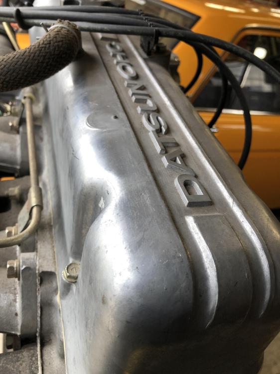

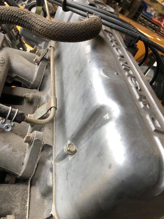

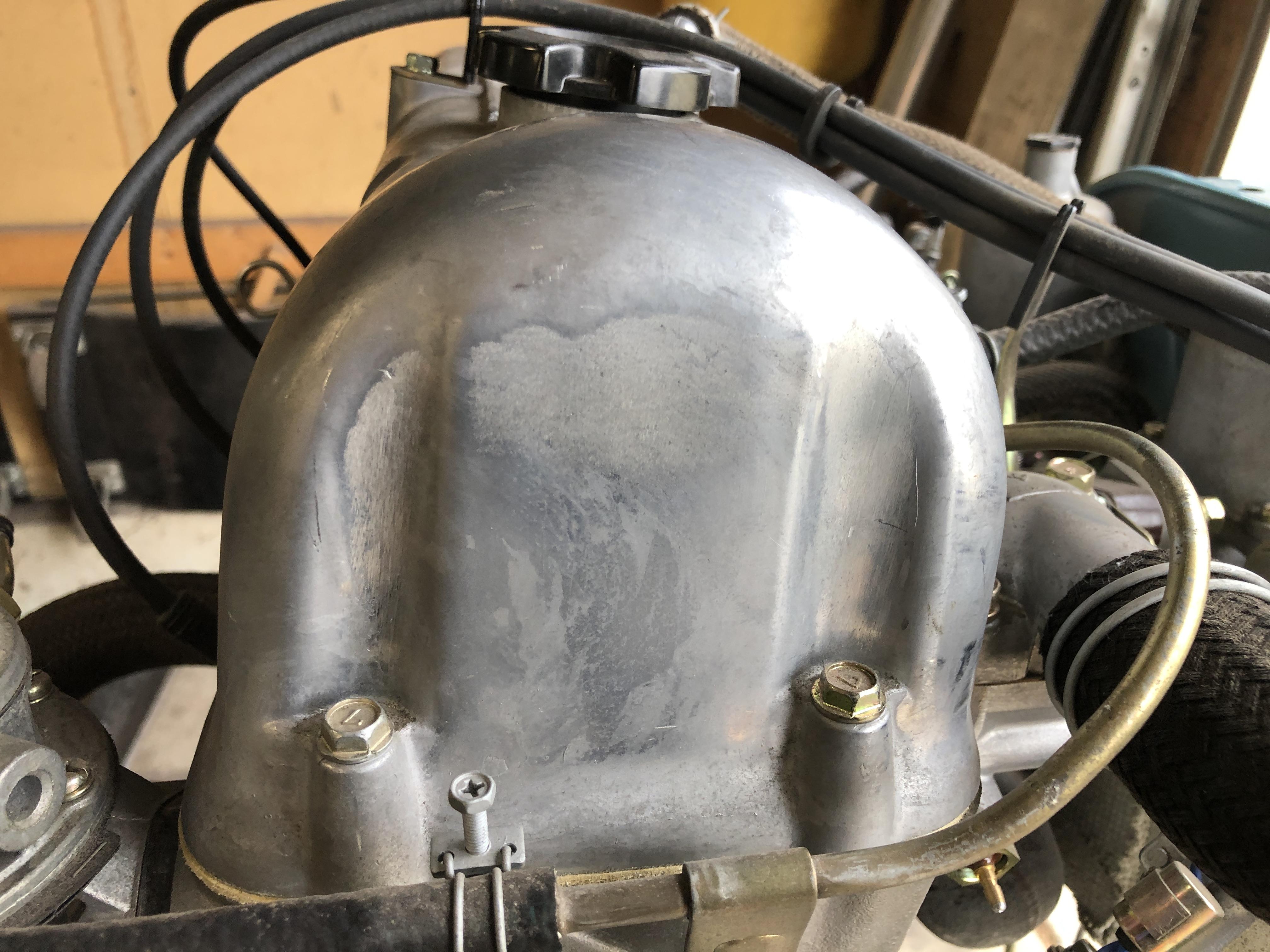

I have an NOS L4 valve cover that looks a lot like the ebay cover. The finish really appears like un-finished raw aluminum, and there is lots of variability in the finish. It is not shiny, but has some reflective qualities. It does look a lot like freshly fine bead blasted, but more variable and smoother if that makes any sense. This cover has been in open air for 40+ years on an NOS L18 SSS motor on display.
I'll try to get some sun lit pictures that show the variations.
There has I believe been some continued oxidation with time while in my possession.
Edited by zKars
