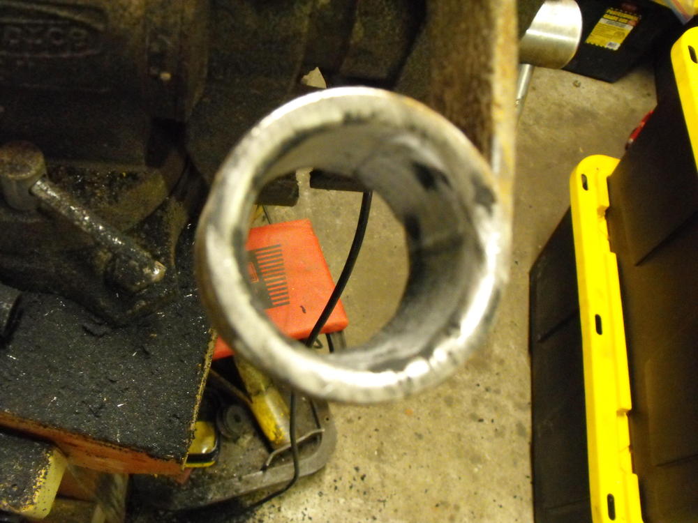

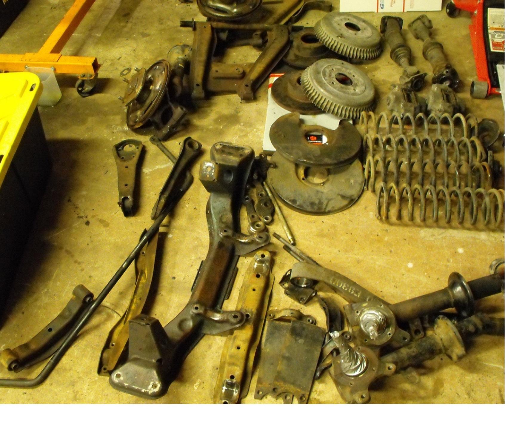

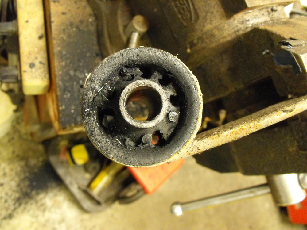

Got all the suspension parts prepped and ready to take to the powder coat shop.  Drilled out the mustache bar bushings using a .25" drill and then cleaned up the inside with a small wire wheel on the drill.  We will put in all new bushings for the suspension.
5 hours ago, grannyknot said:
So I guess you're going to use poly bushings in the mustache bar?
Yes, I typically use the complete Energy Suspension kit, except for maybe the steering arm piece.  I prefer the original rubber in that location if the part is in good shape.

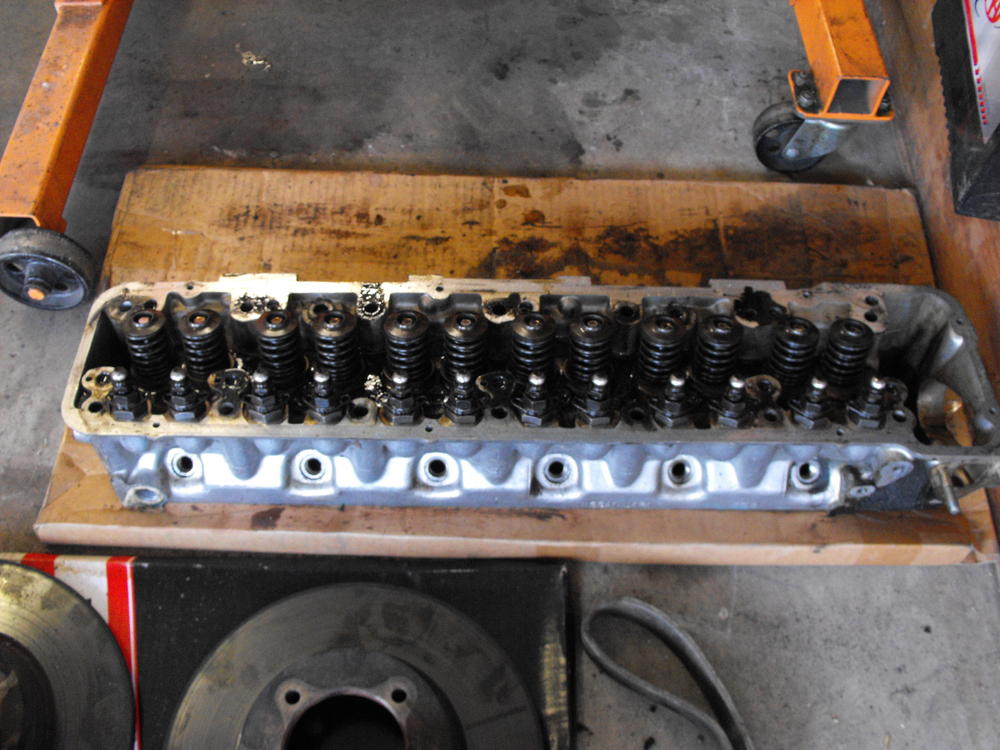

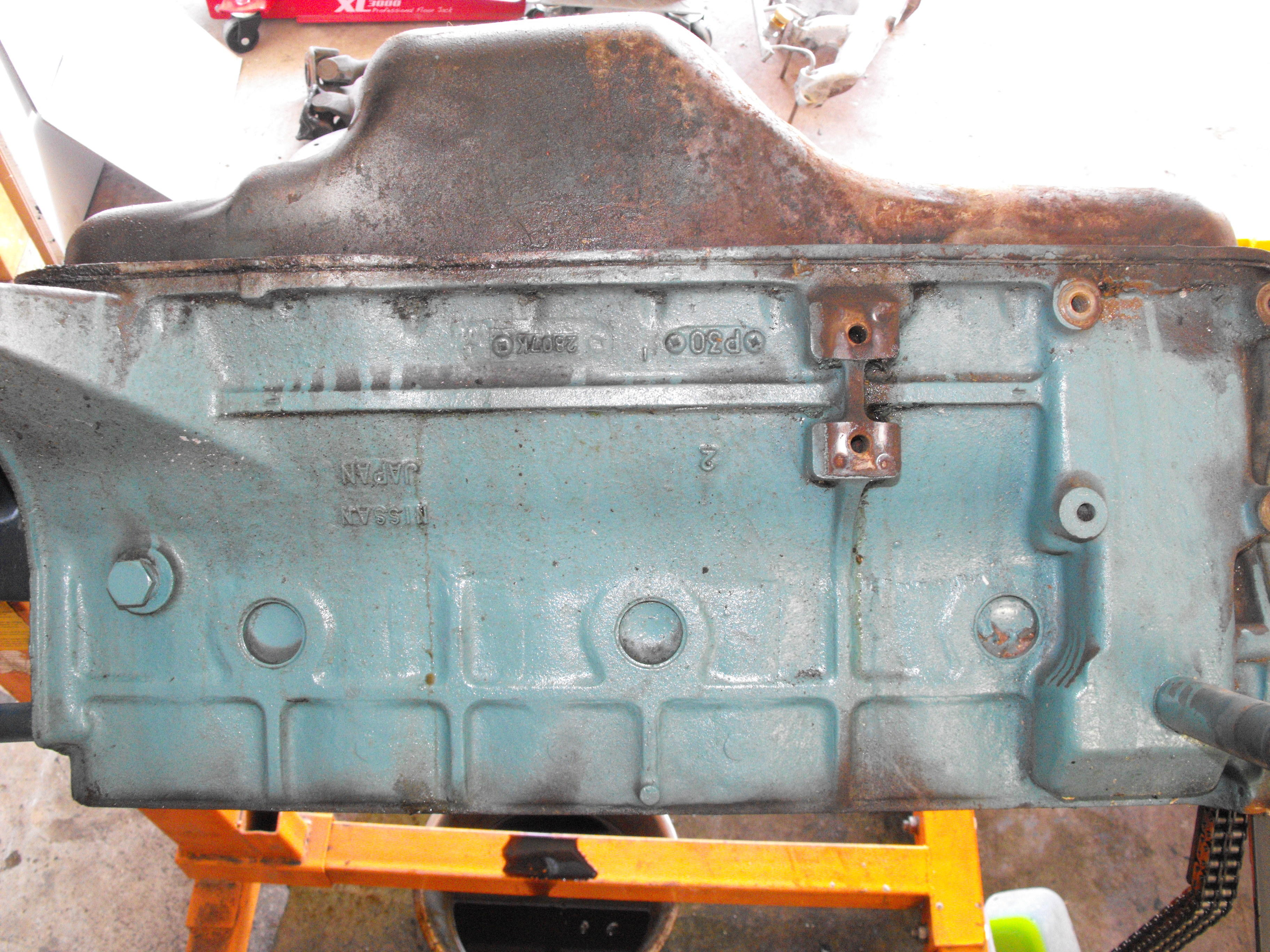

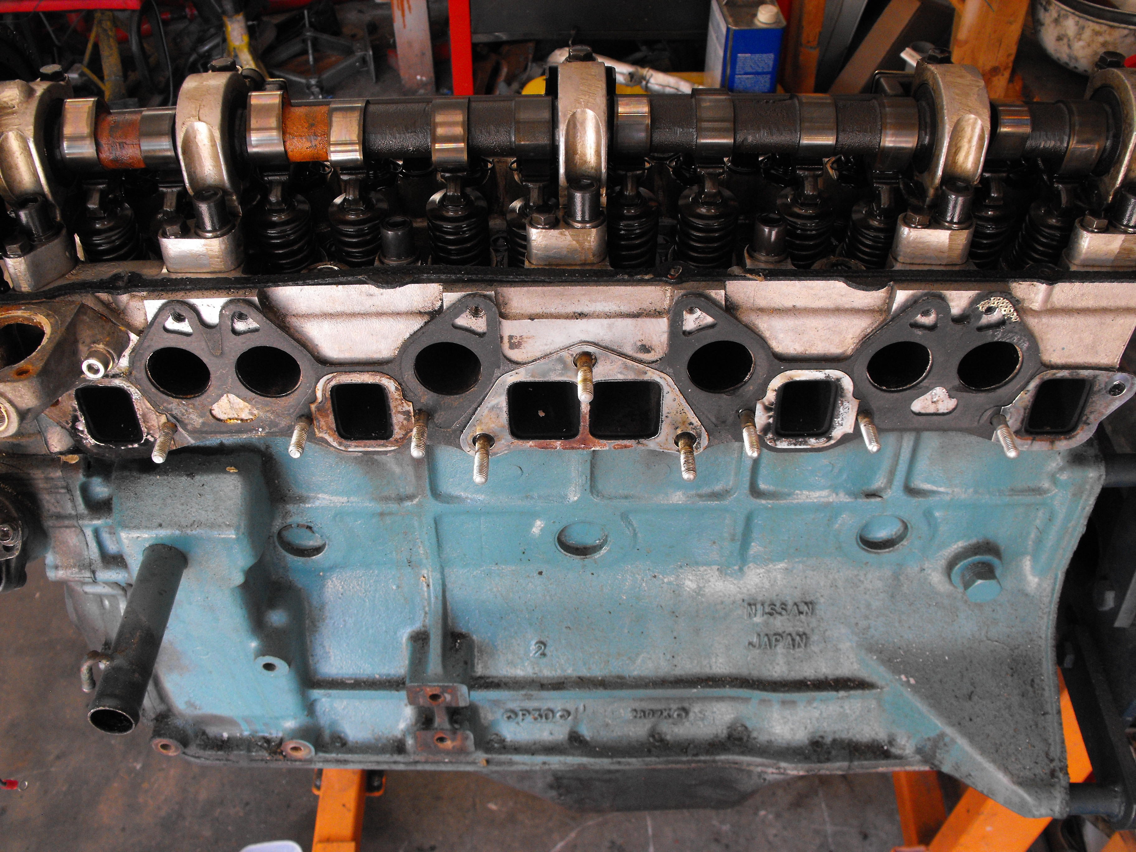

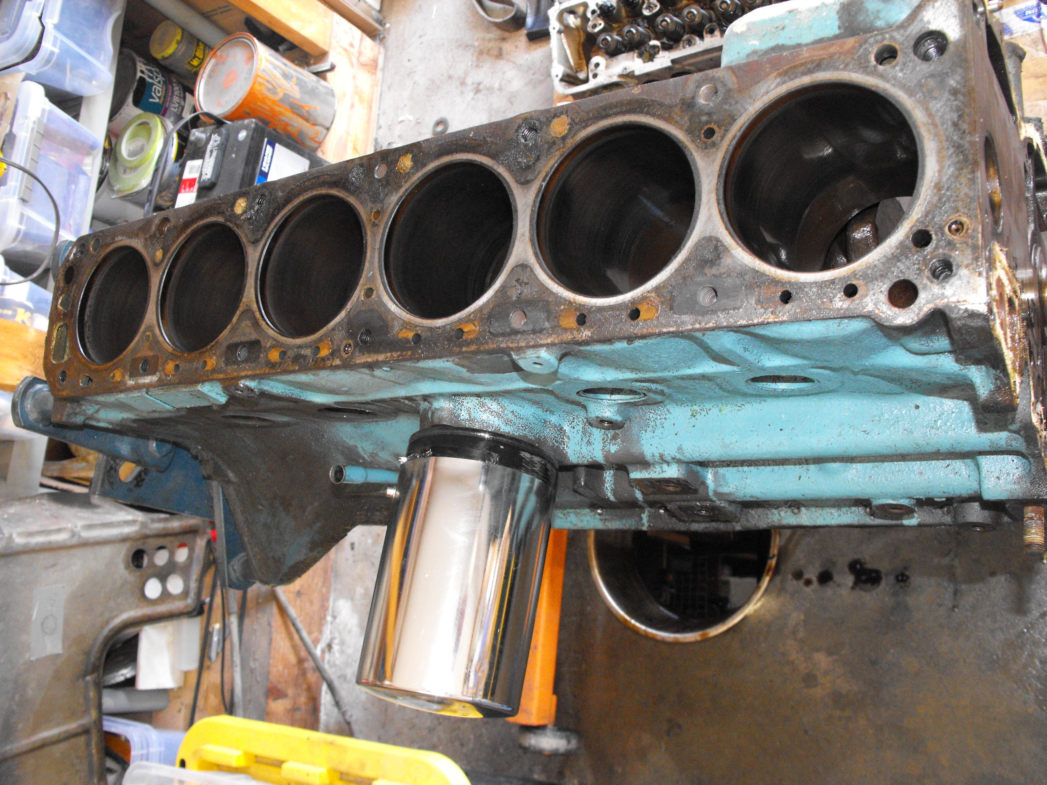

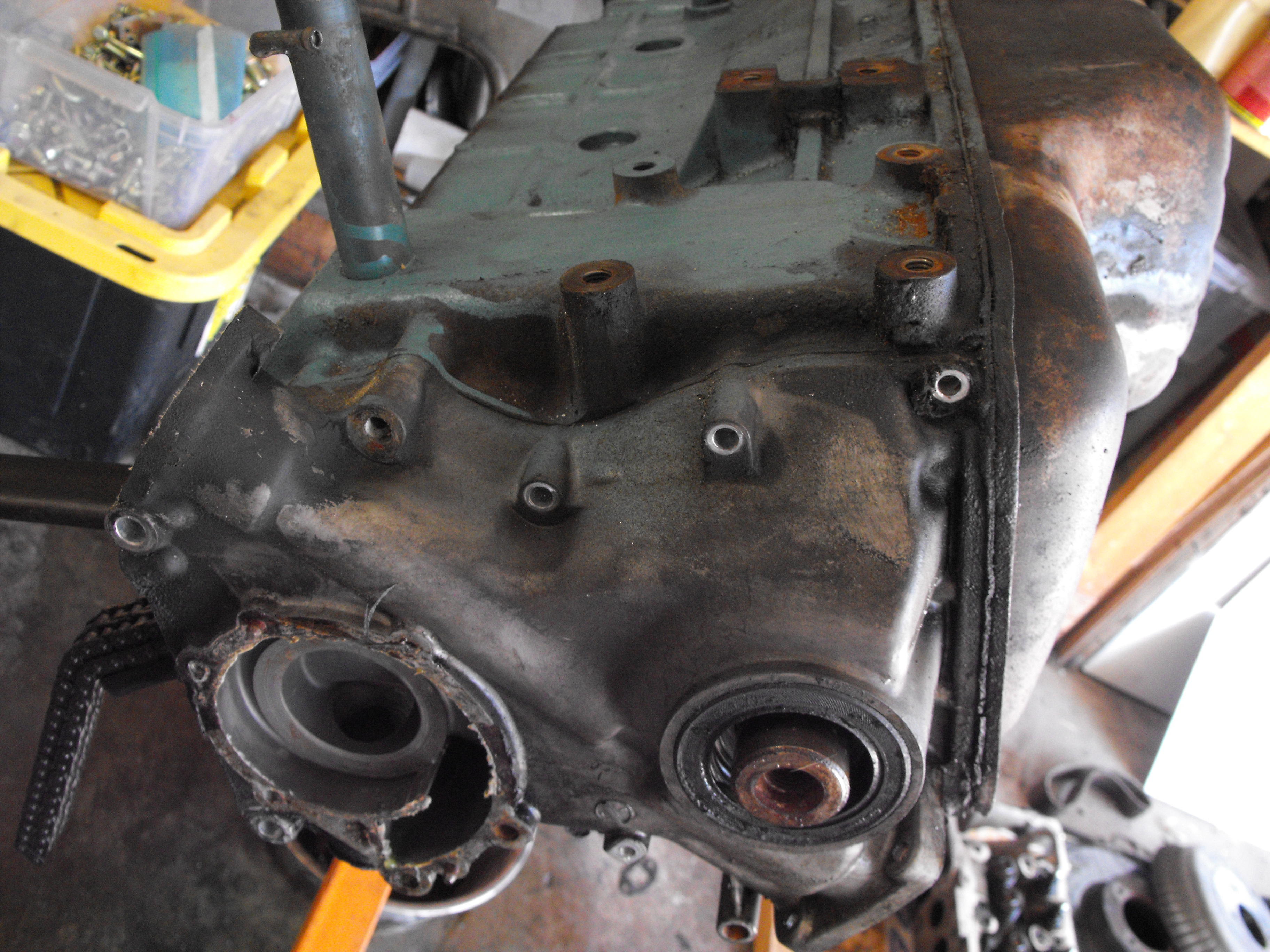

Got the engine disassembled and will bring to the machine shop tomorrow AM for block hone and and head work.  Will also bring the discs and drums and have them turned.
Started clean-up on the yellow zinc parts and should have those sent out for plating this week.

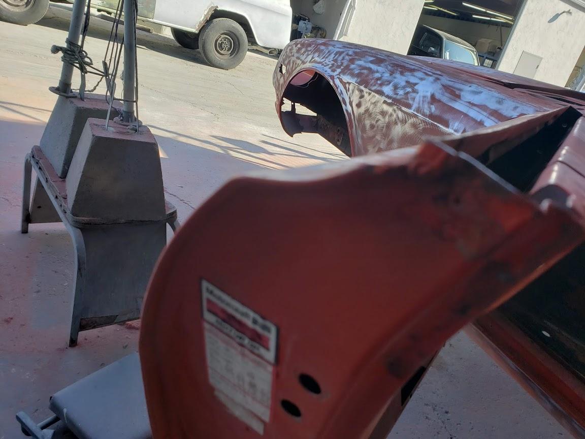

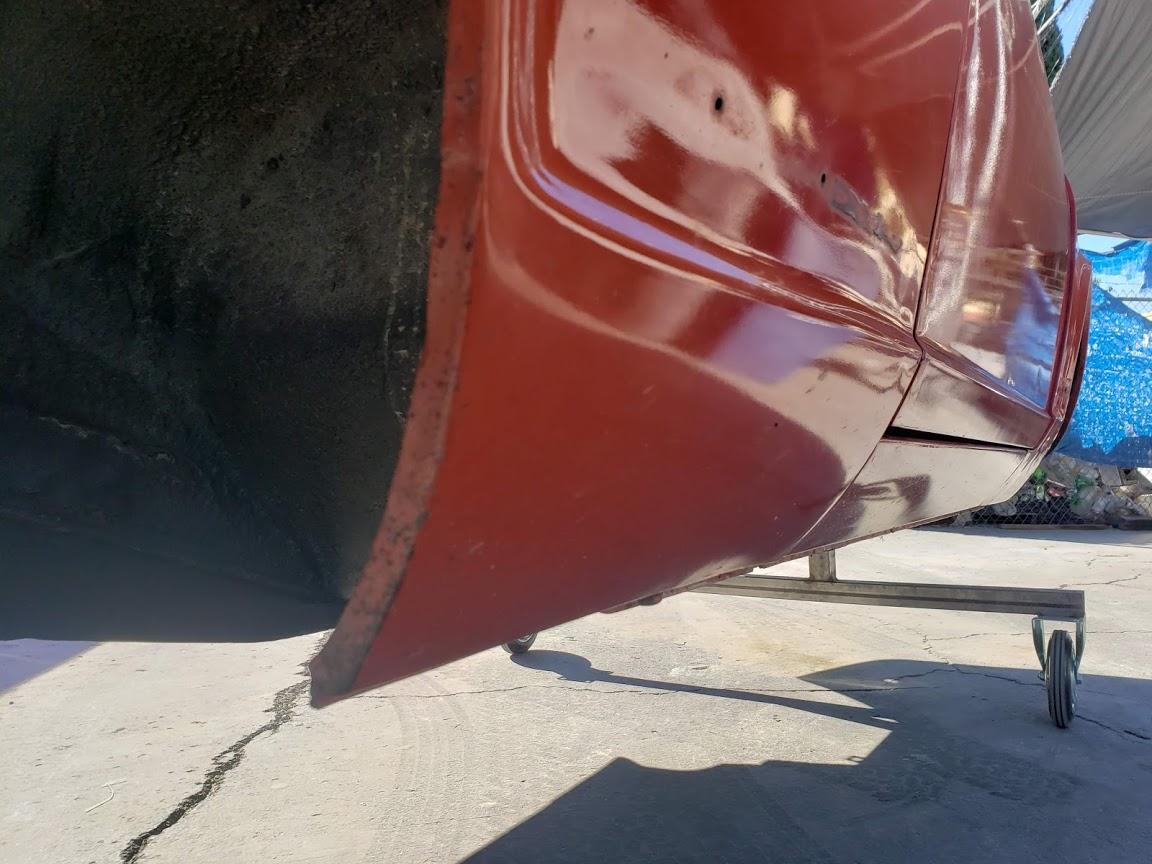

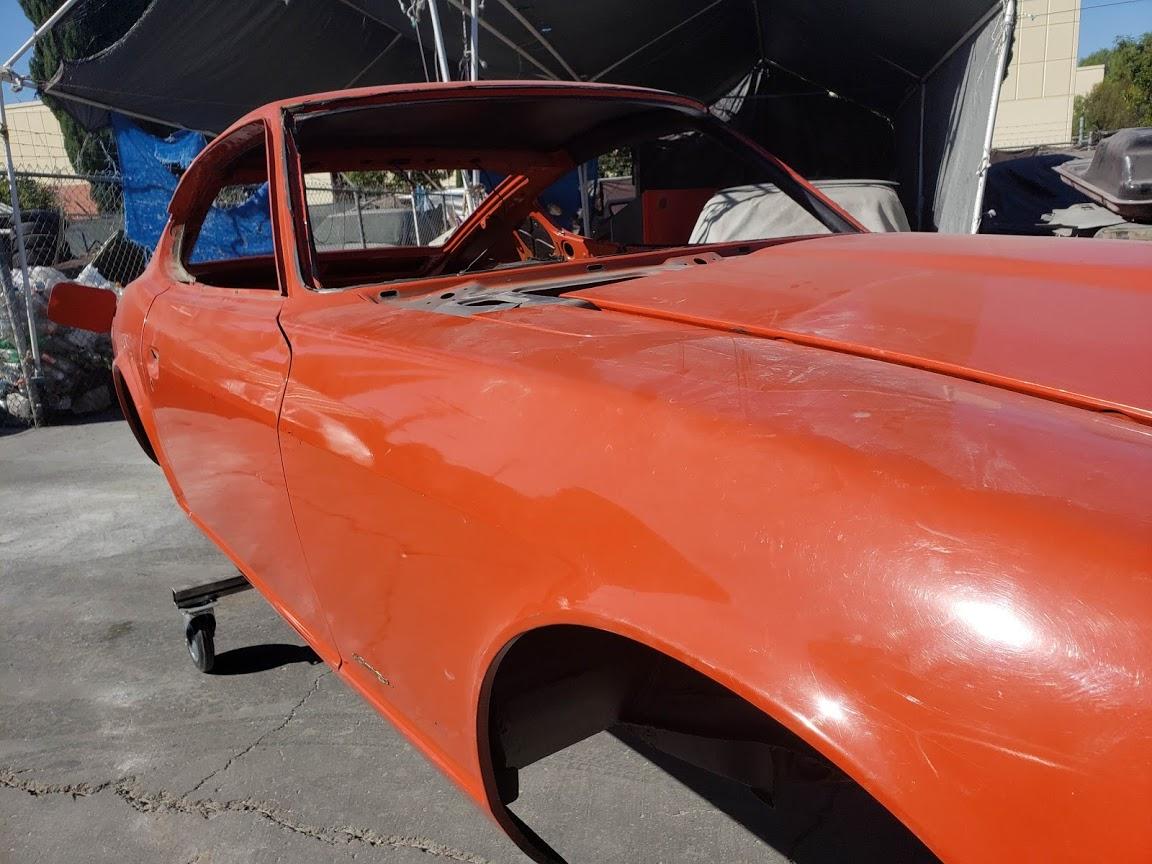

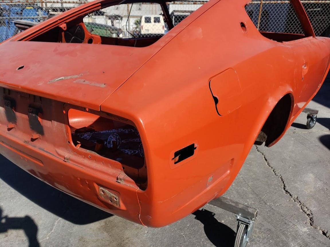

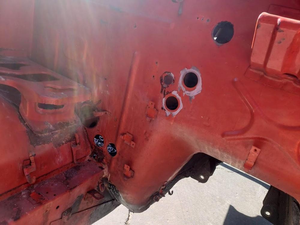

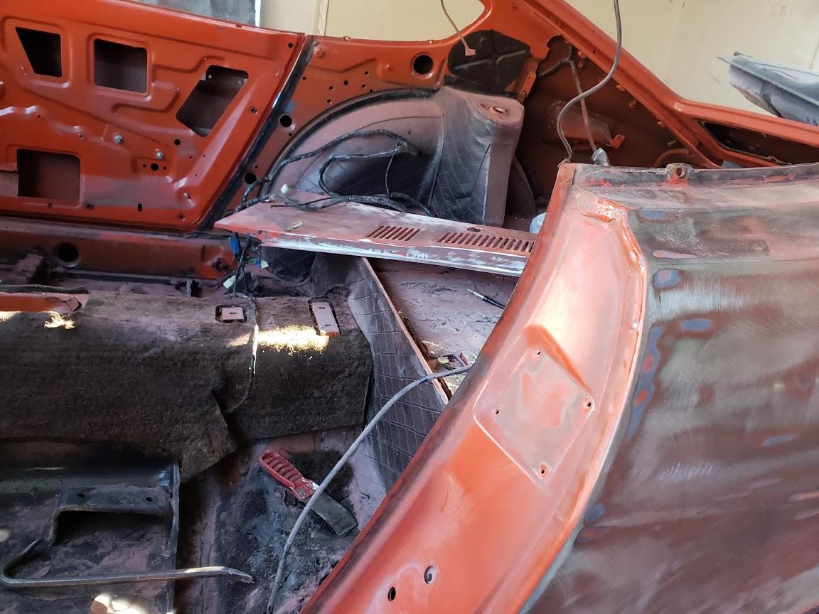

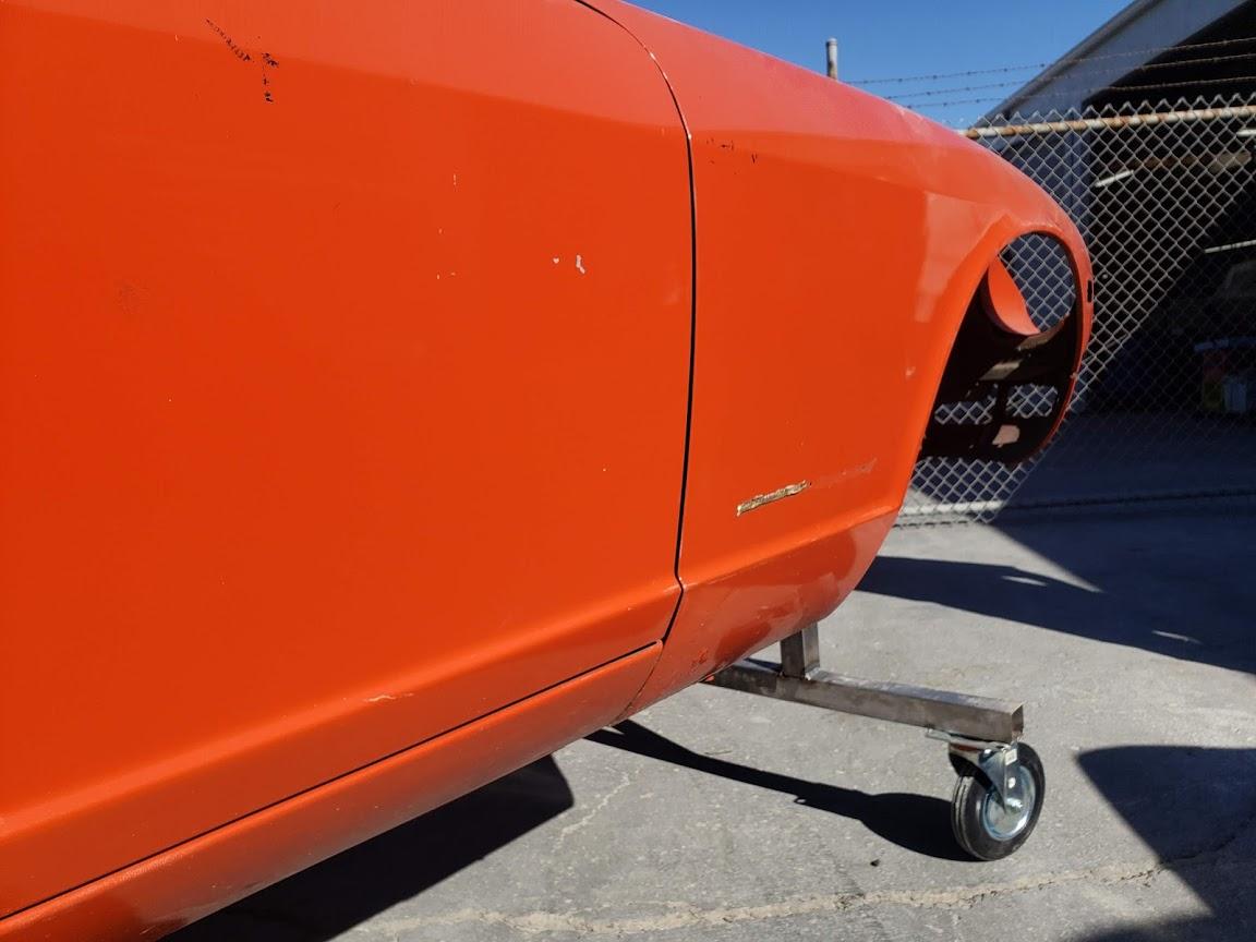

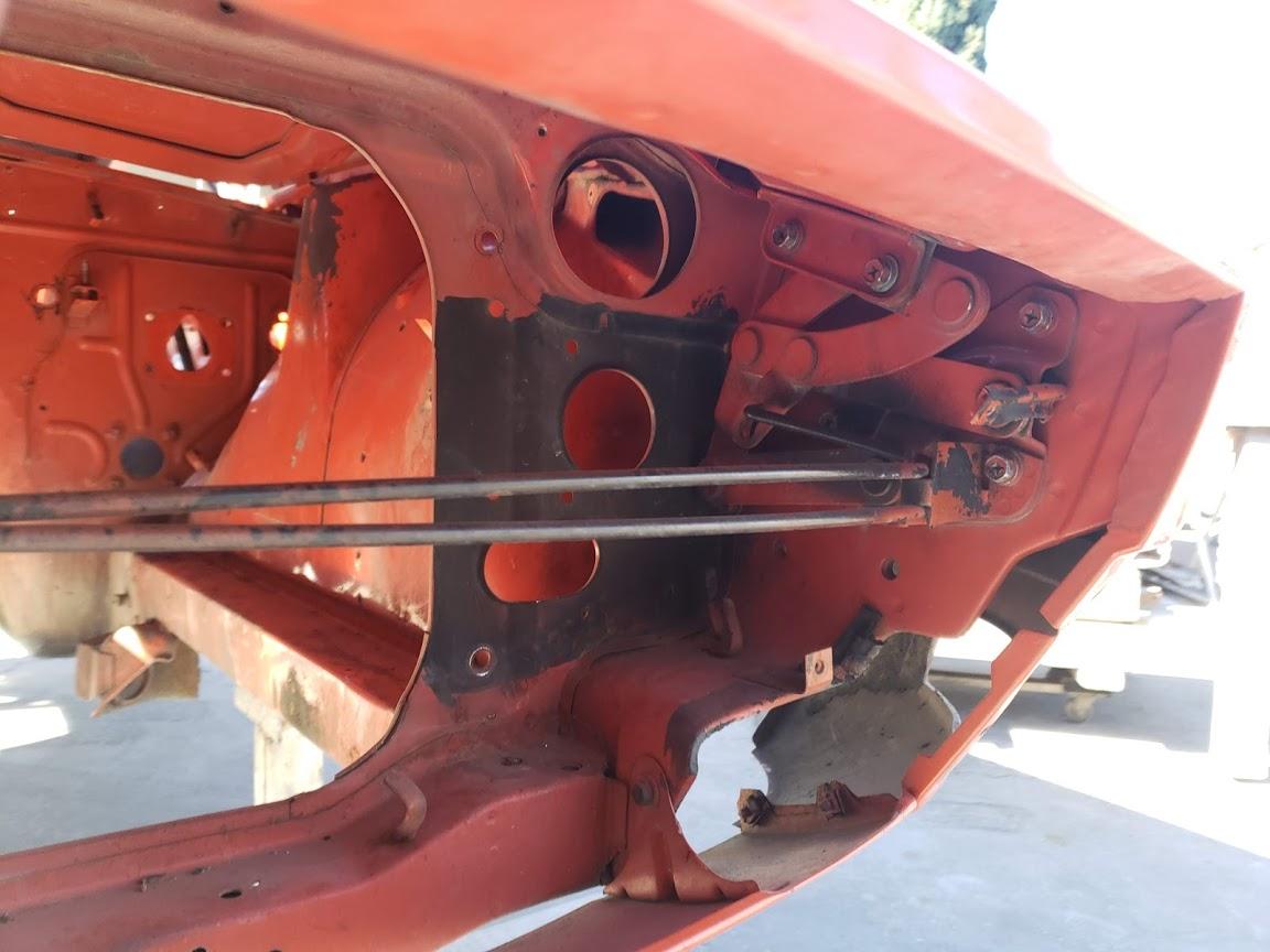

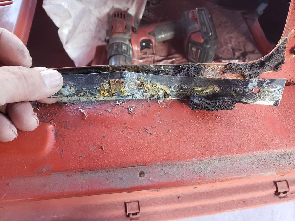

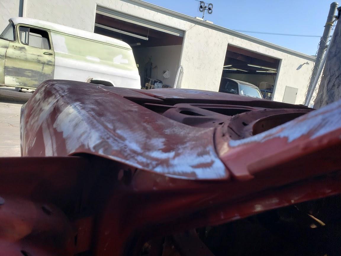

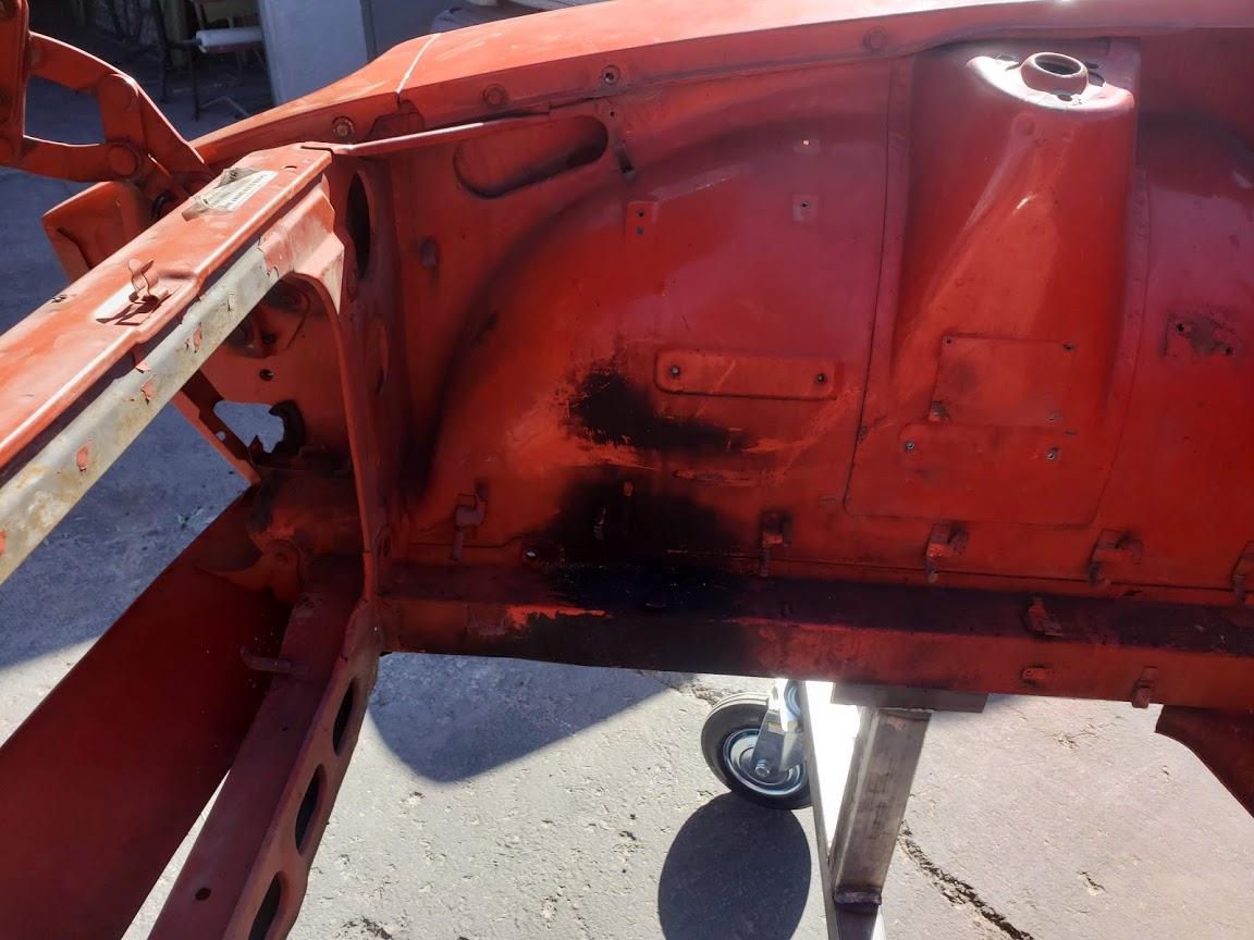

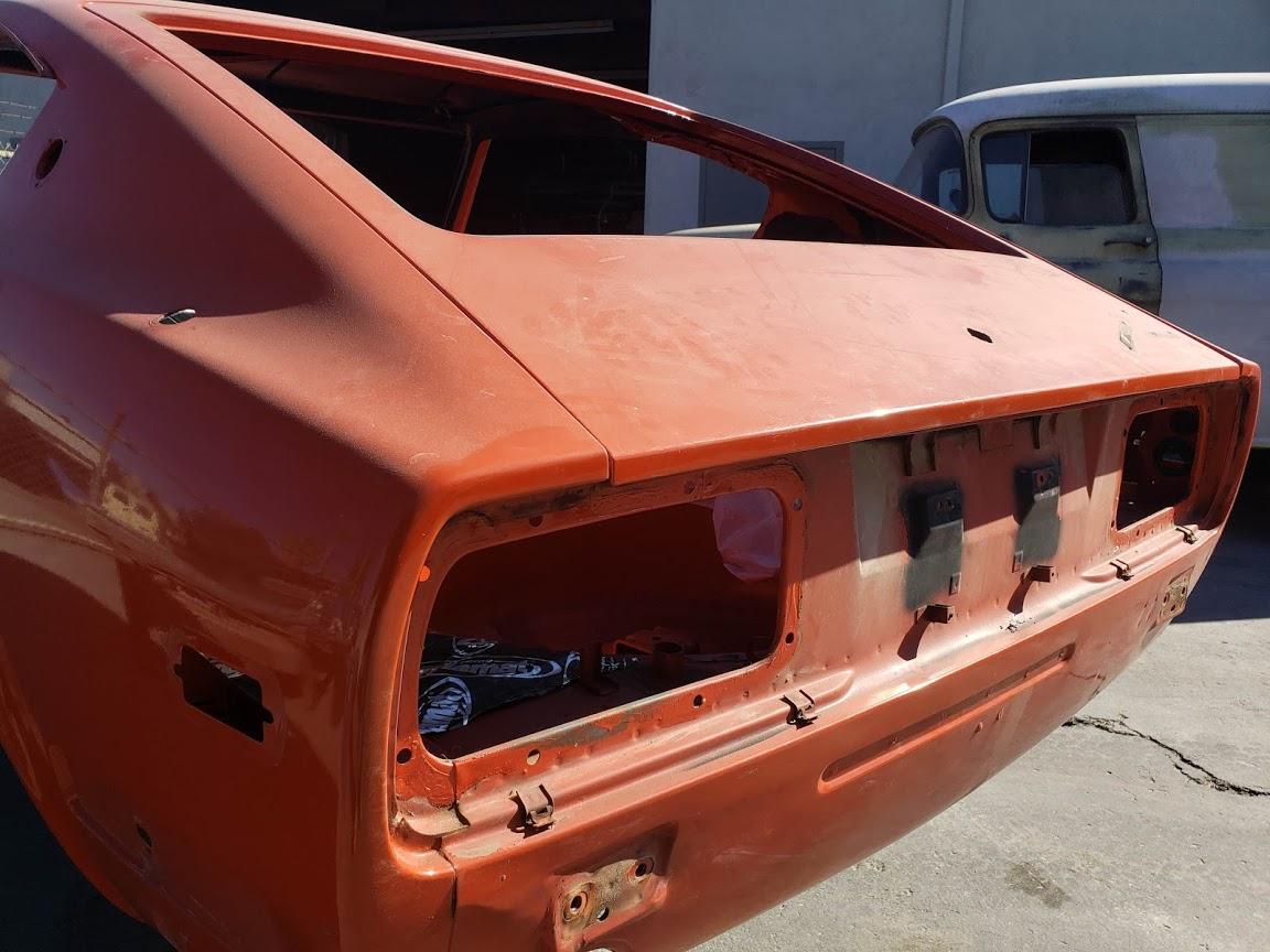

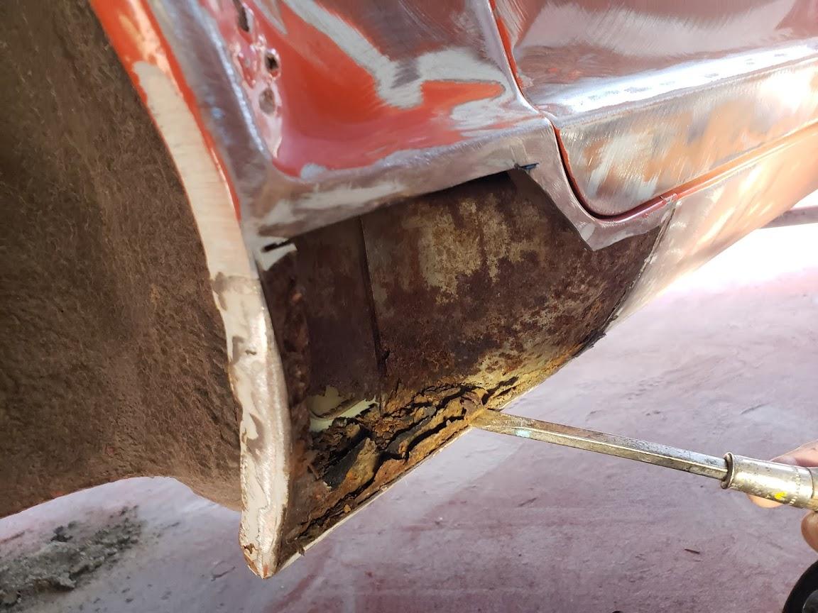

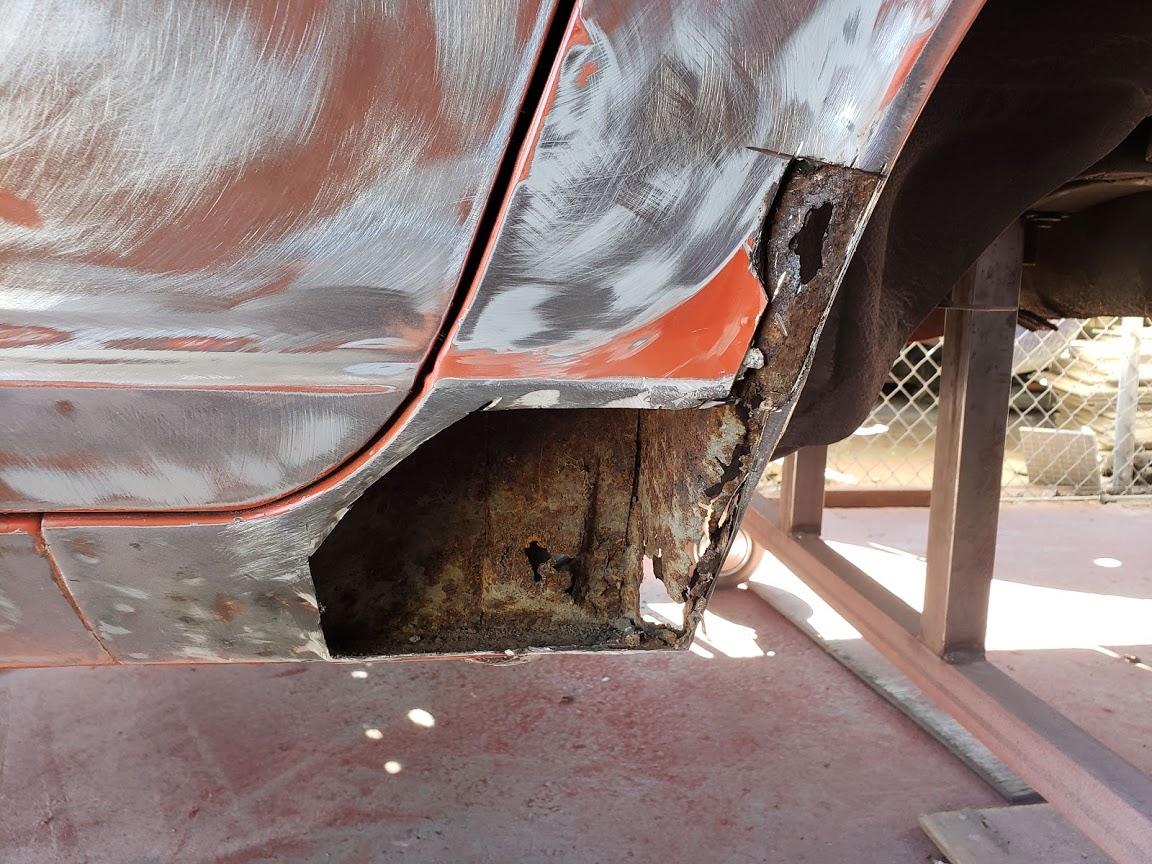

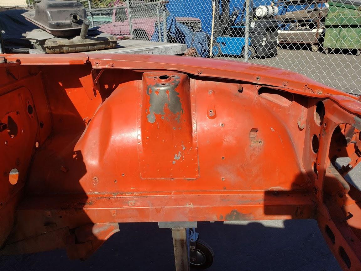

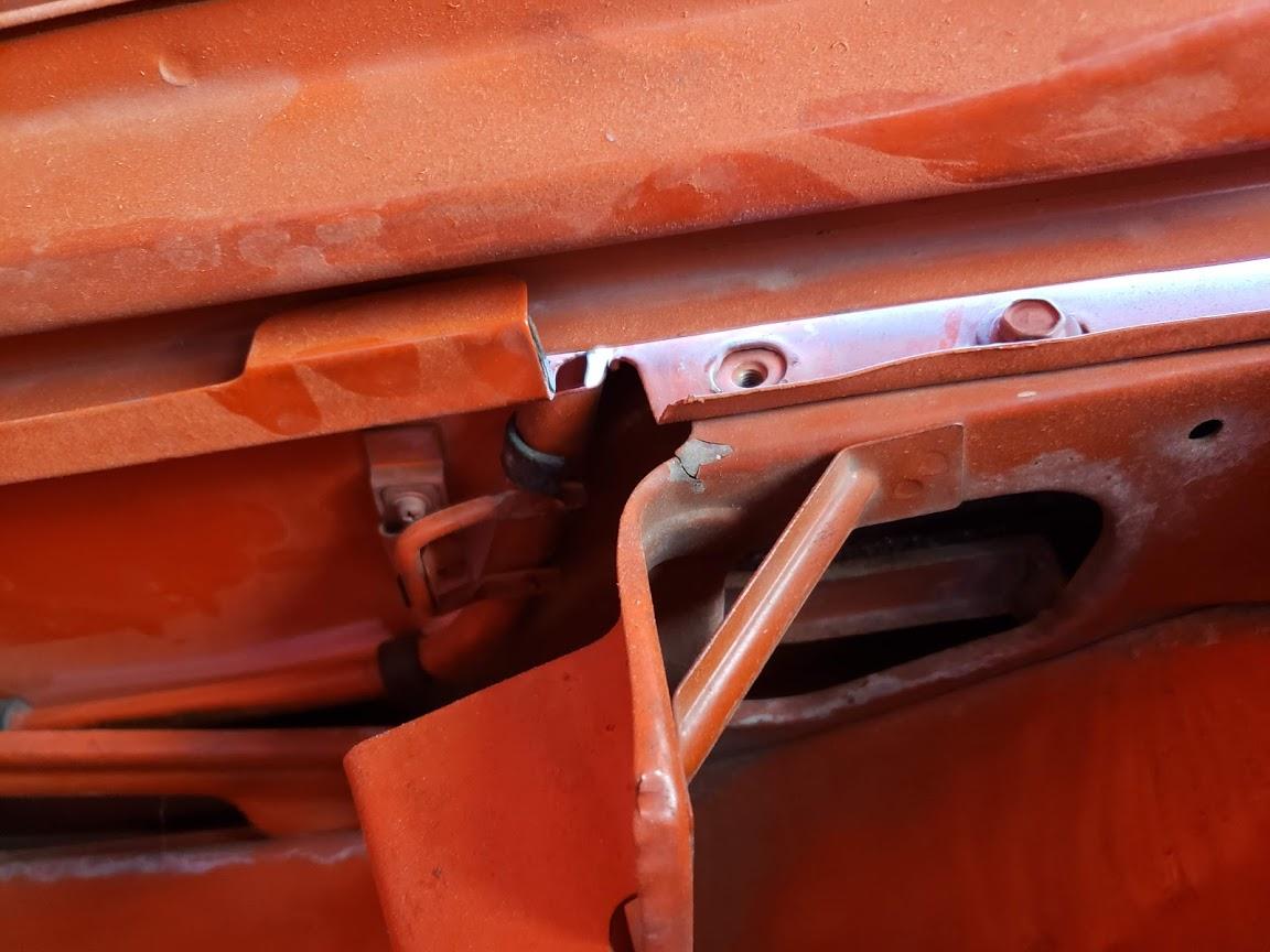

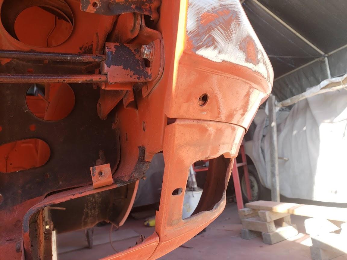

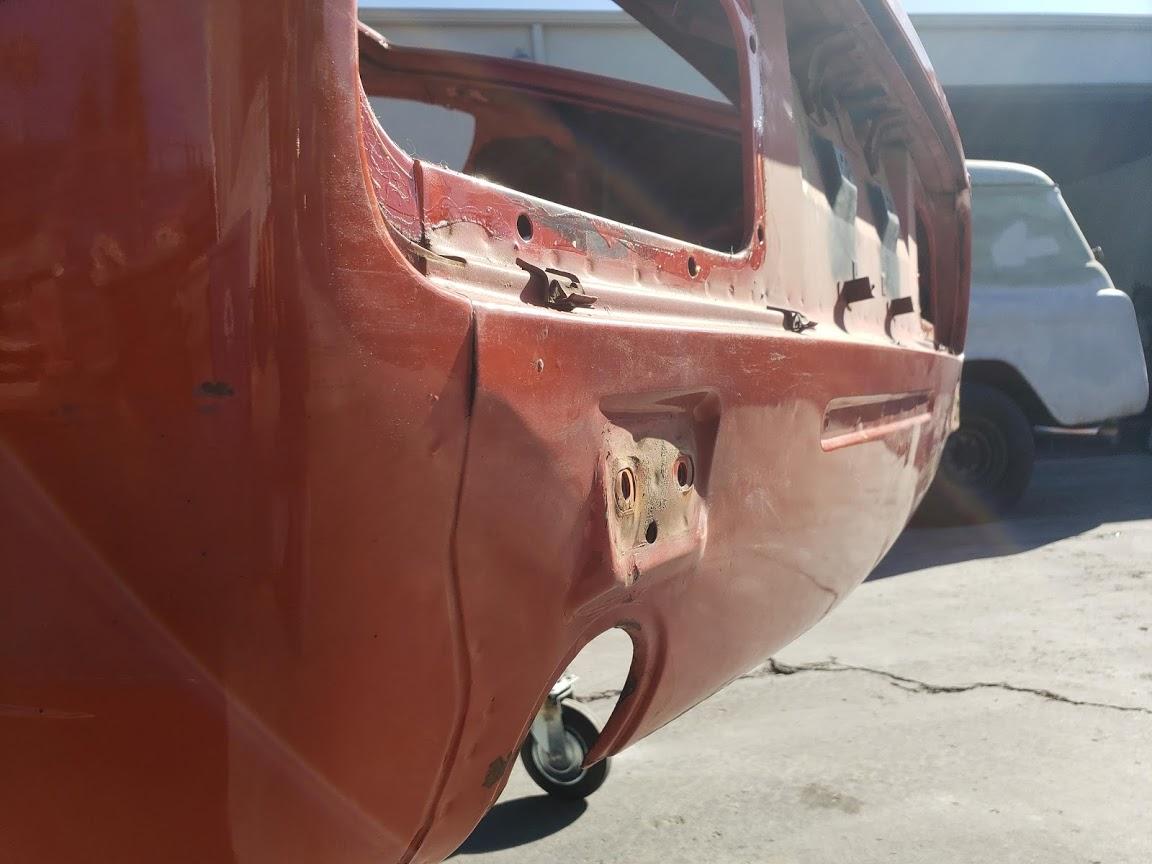

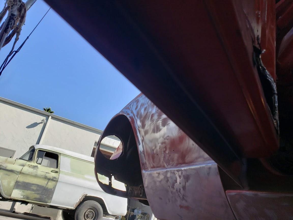

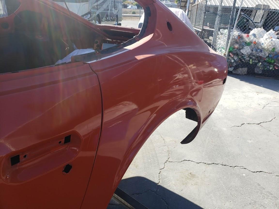

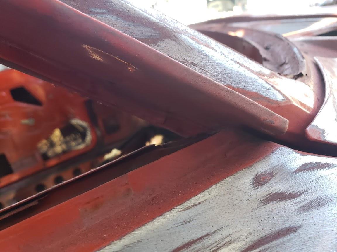

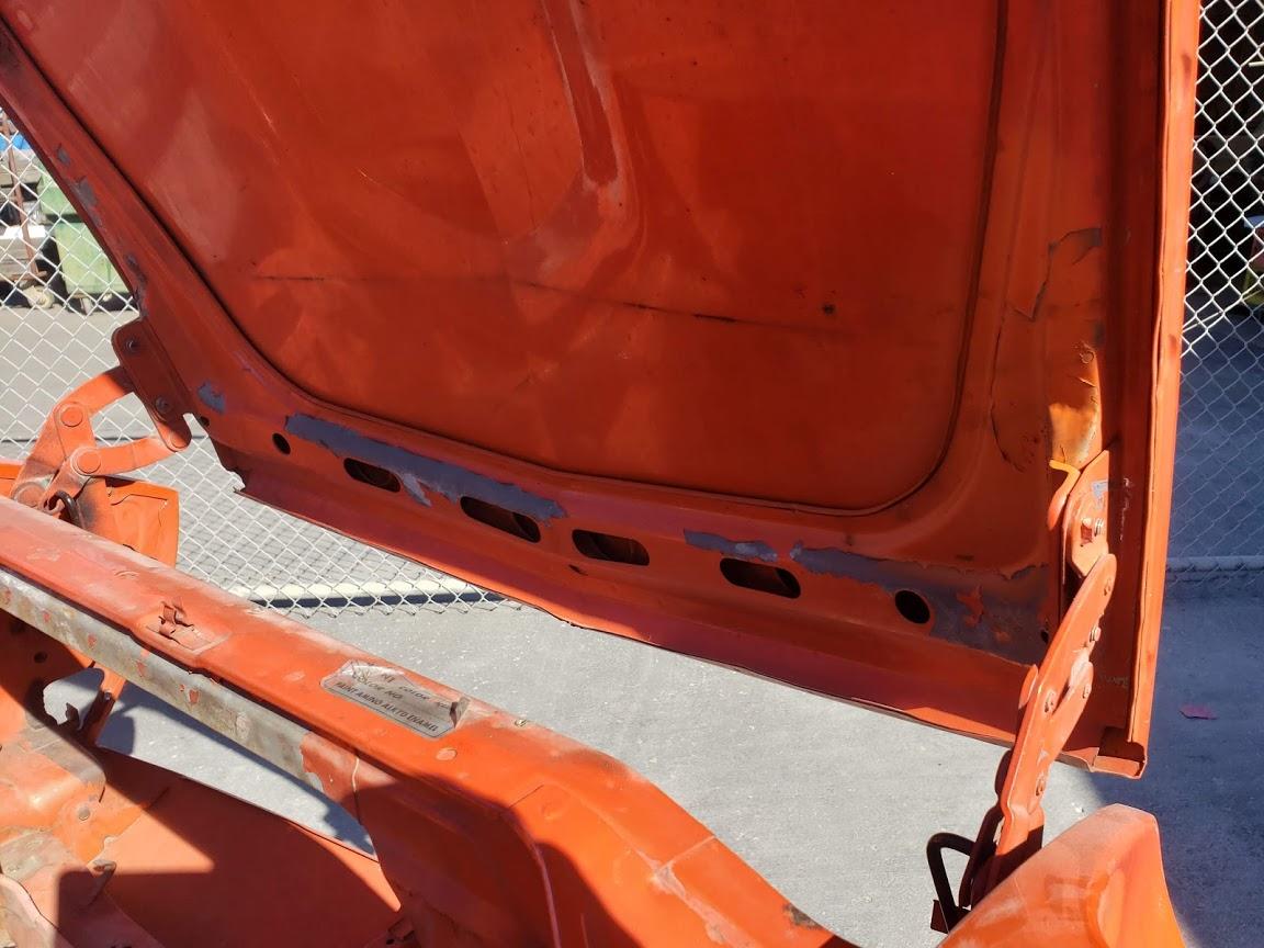

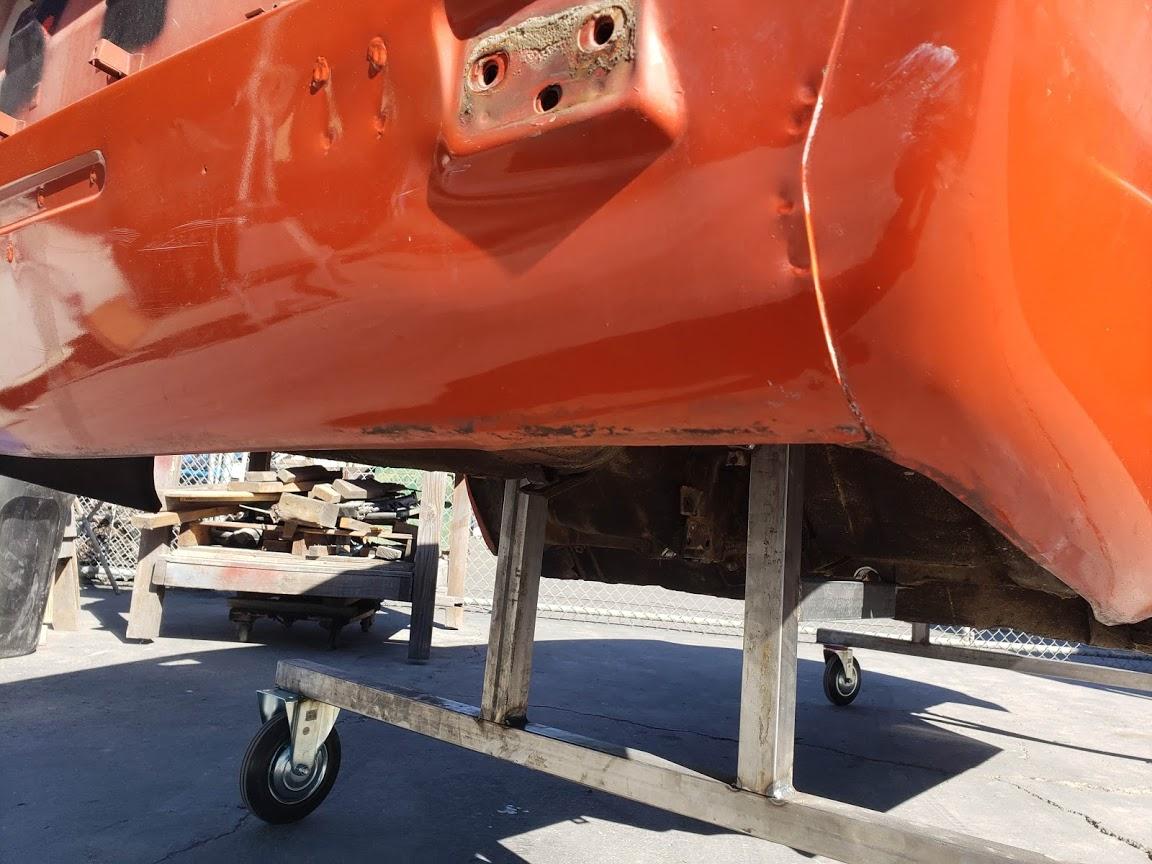

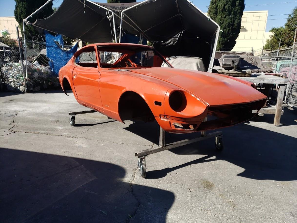

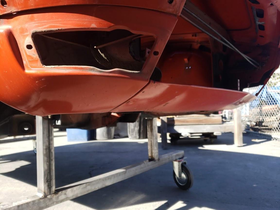

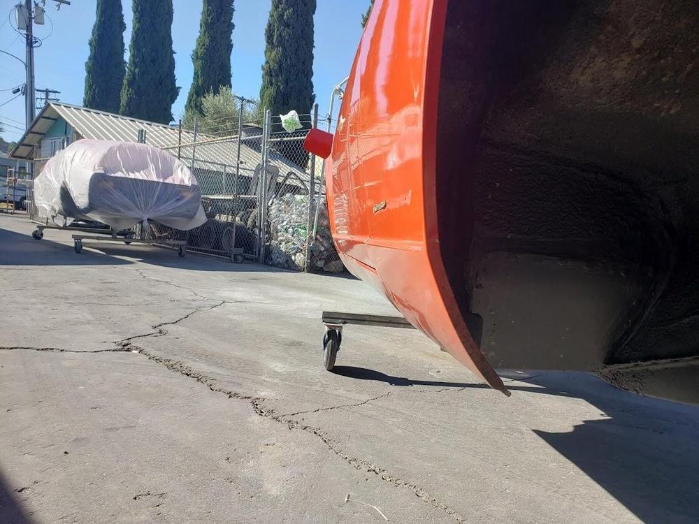

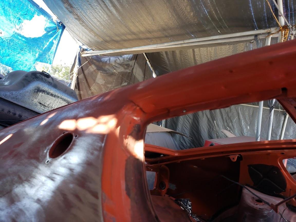

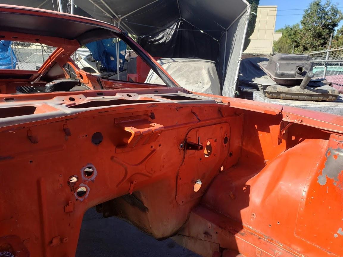

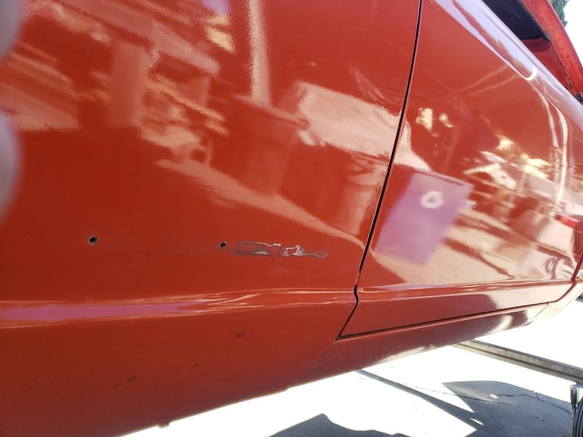

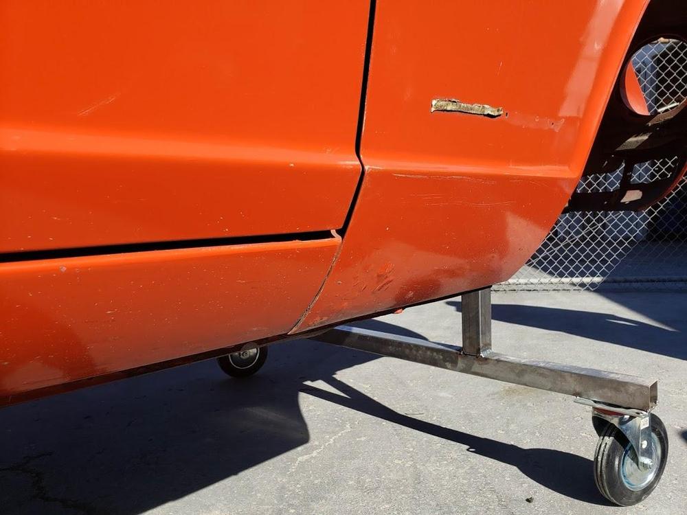

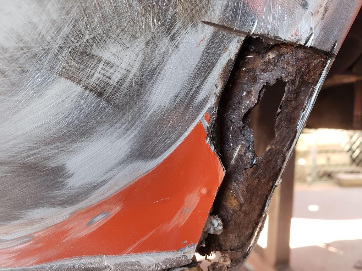

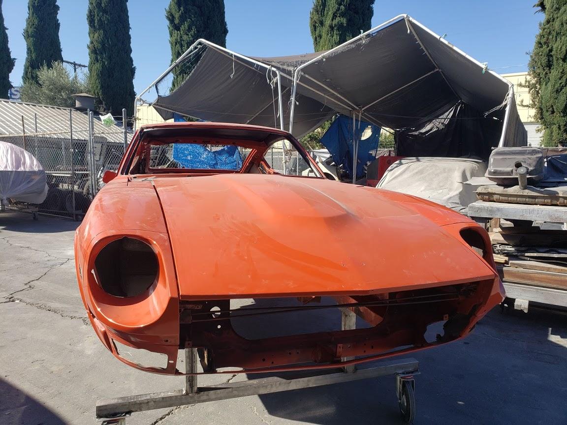

Fresh pics from the body shop.  Lots going on there.  It will go to the sand blaster pretty soon to clean up the deep crevices.

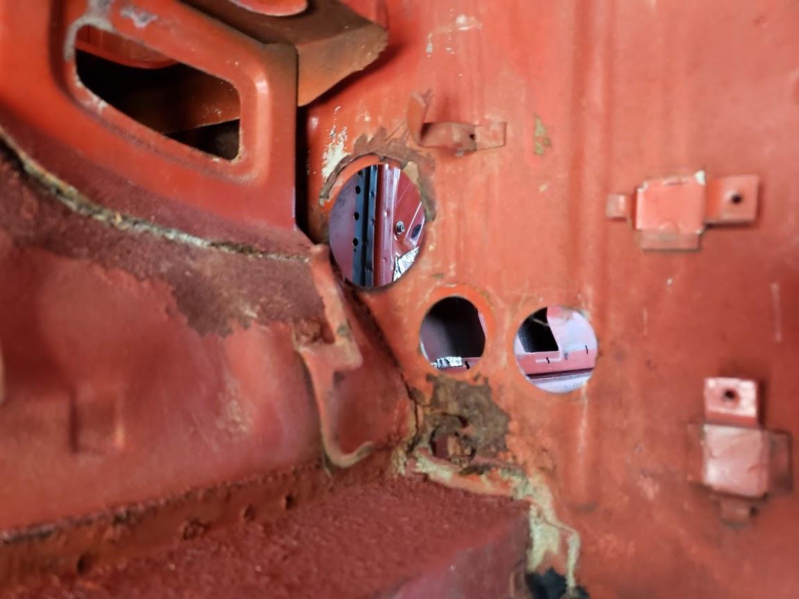

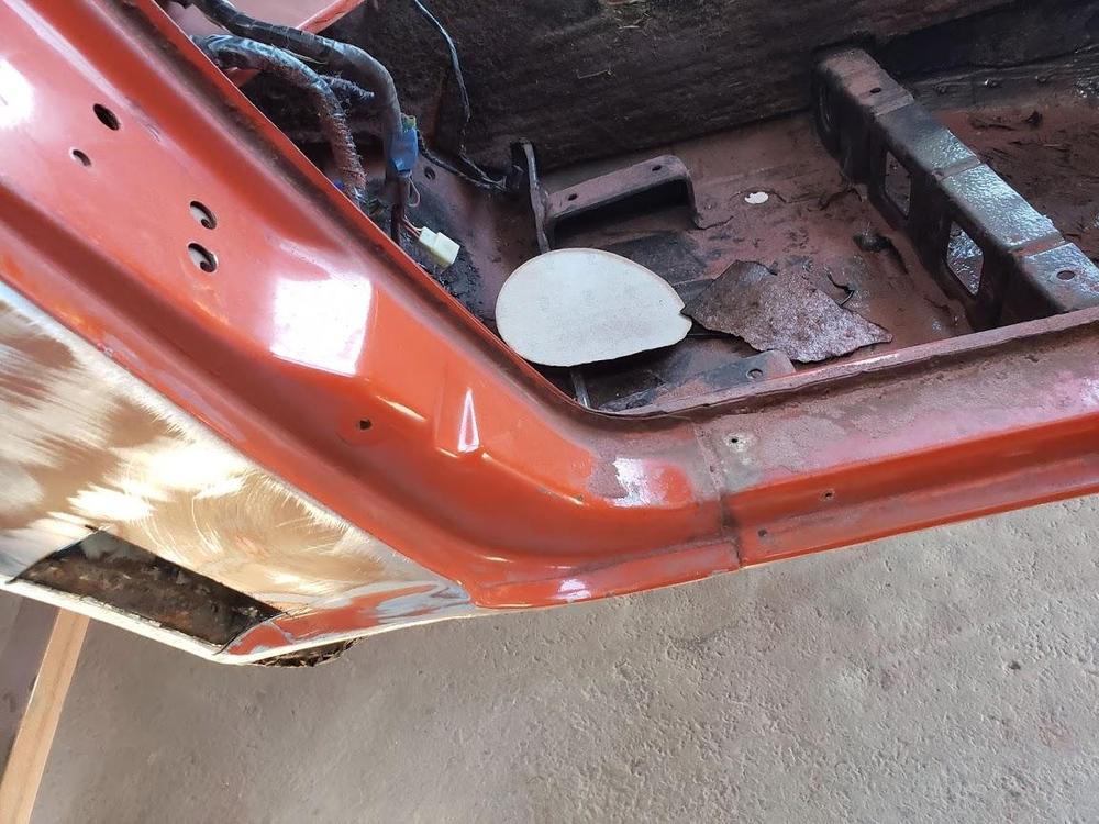

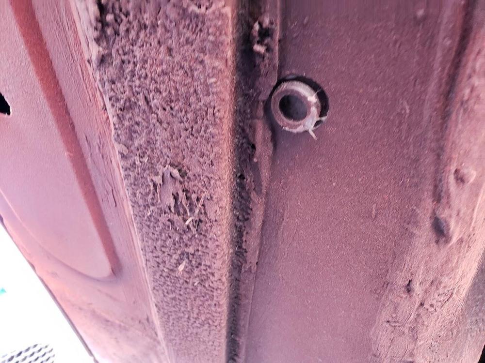

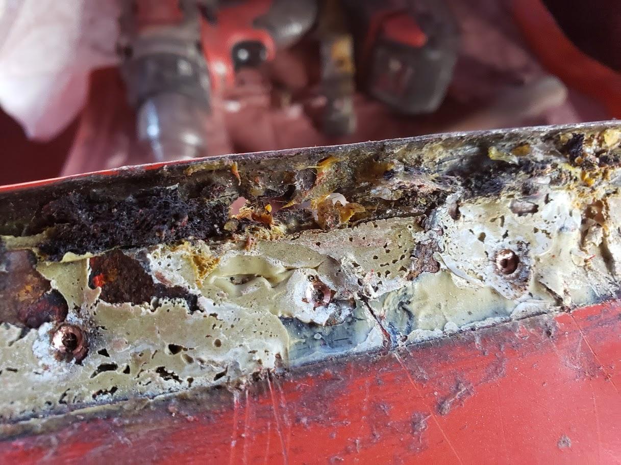

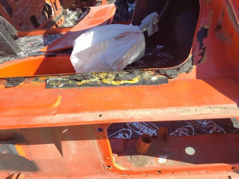

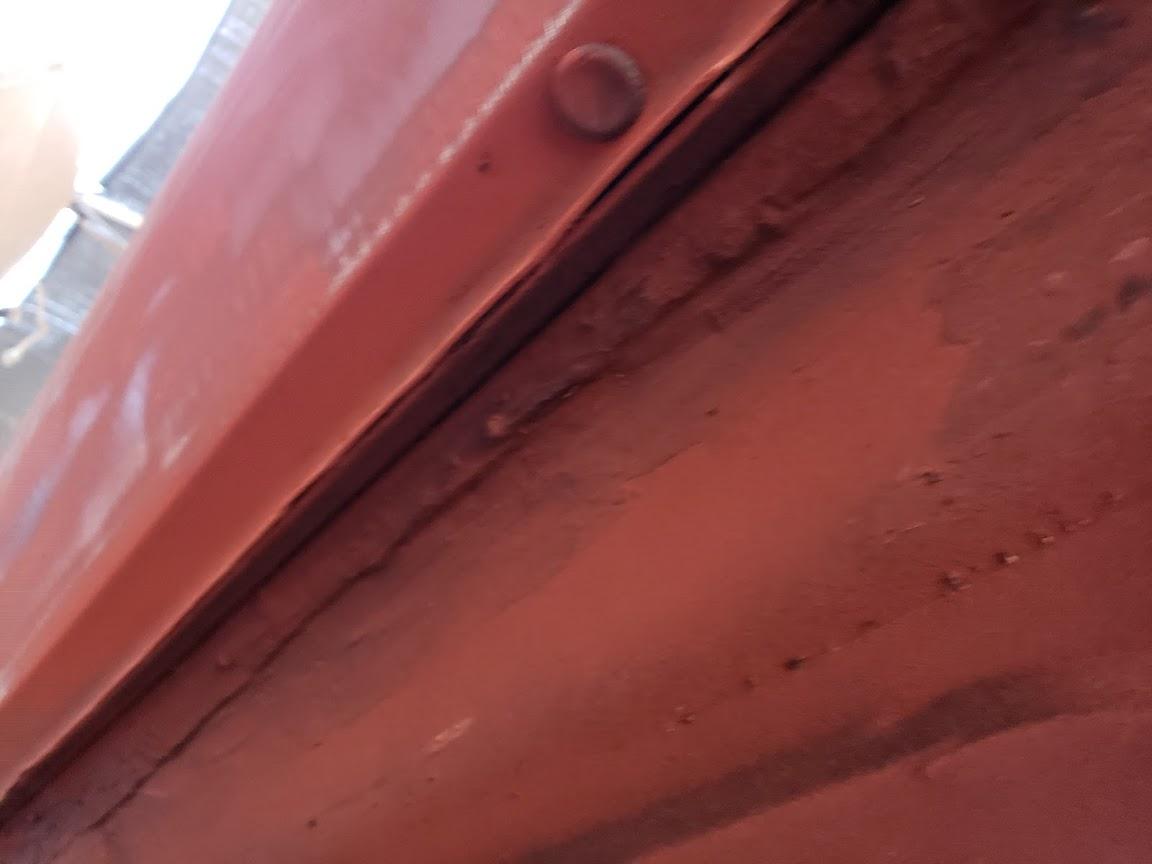

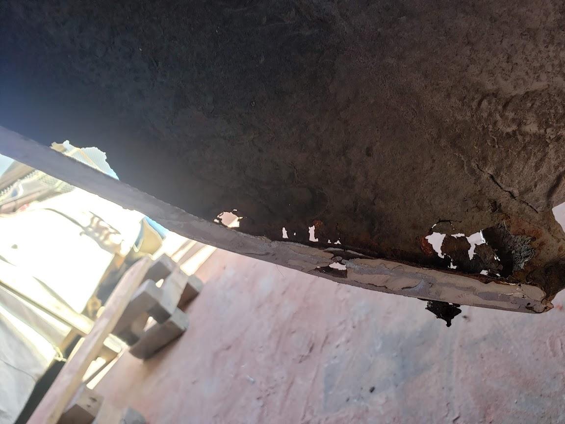

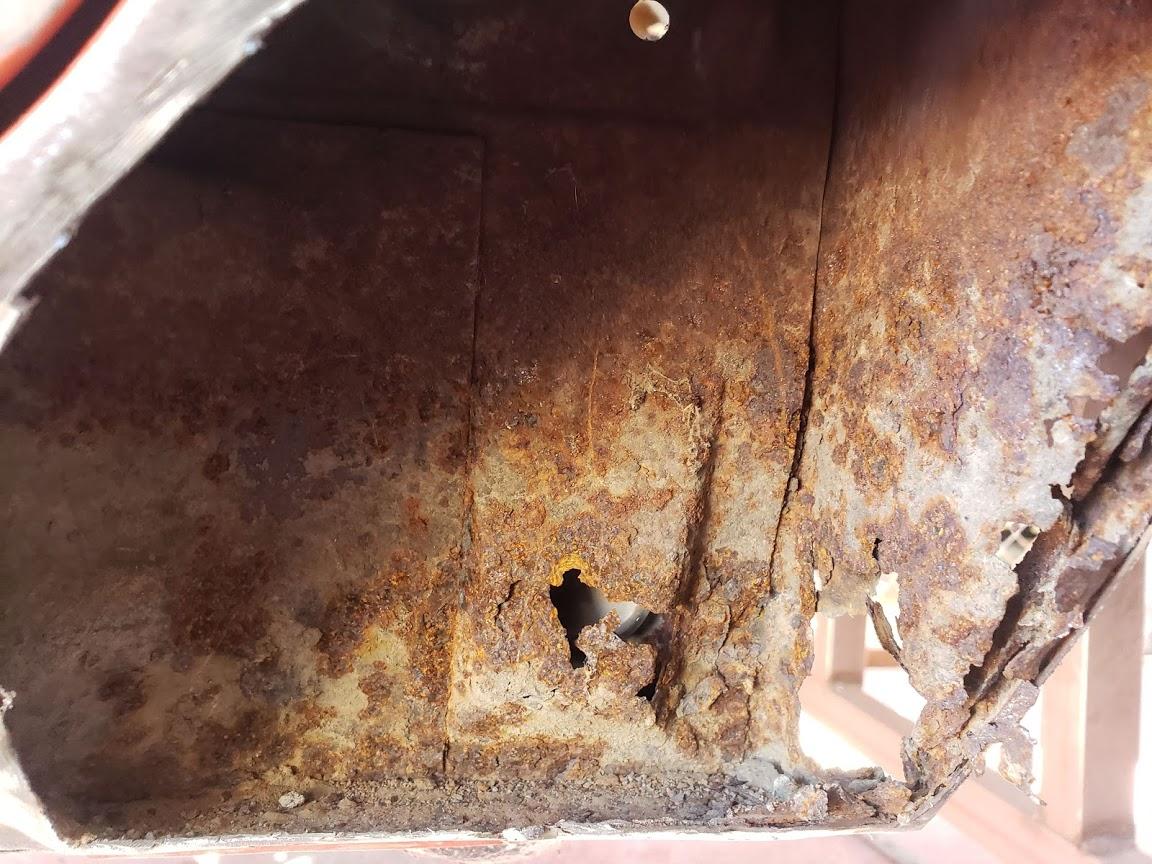

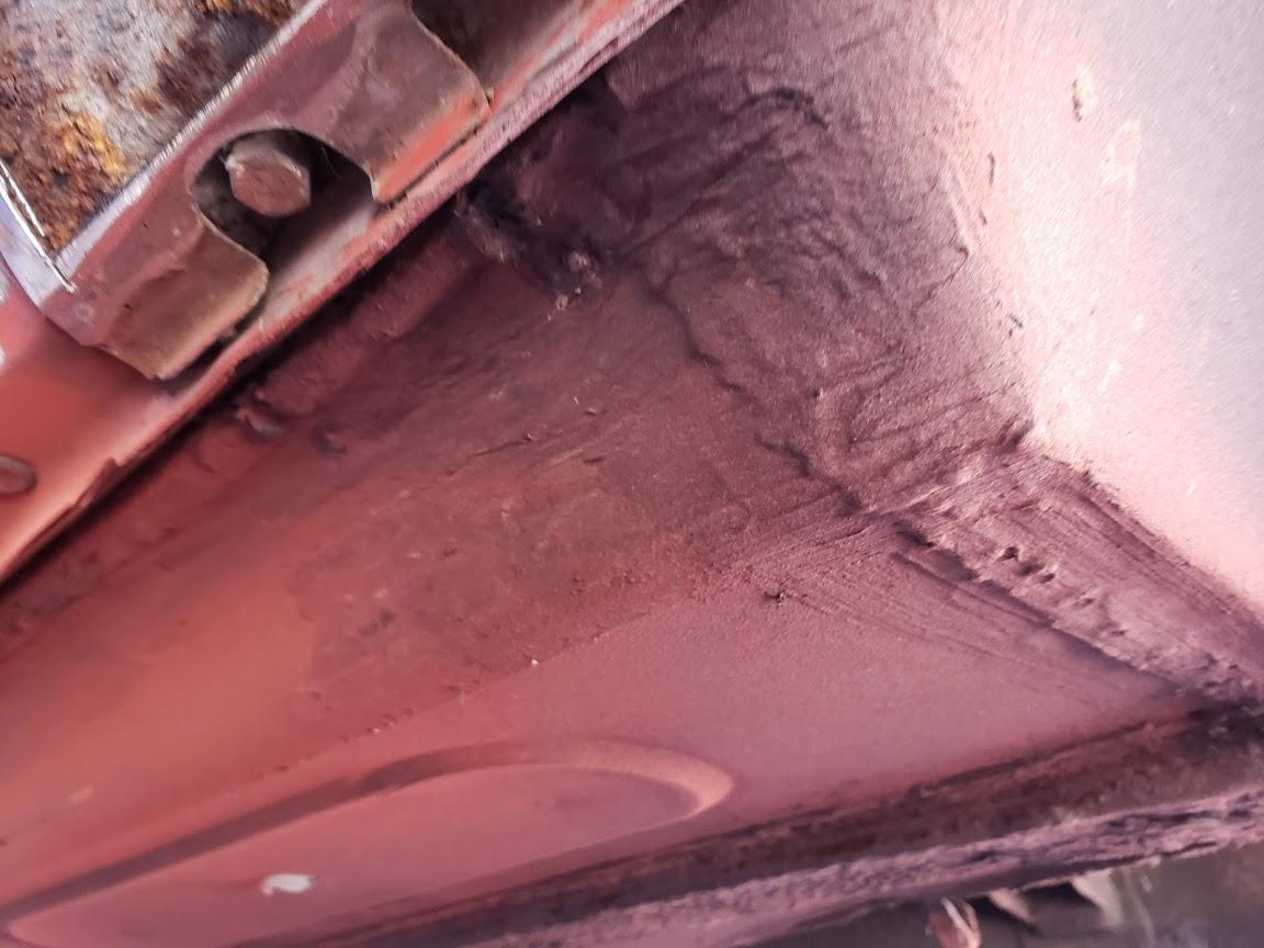

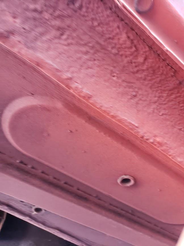

1 hour ago, The Orange said:
What did you discover about the floor after the Dynamat was removed?
Will know more and have better pics once it comes back from the sand blast.  It is there now.  We should have pics also.
From the pics above, looks like the replacement panel was spot welded on top of the original floor (after rusted area was cut out)  with epoxy used to fill the gaps.

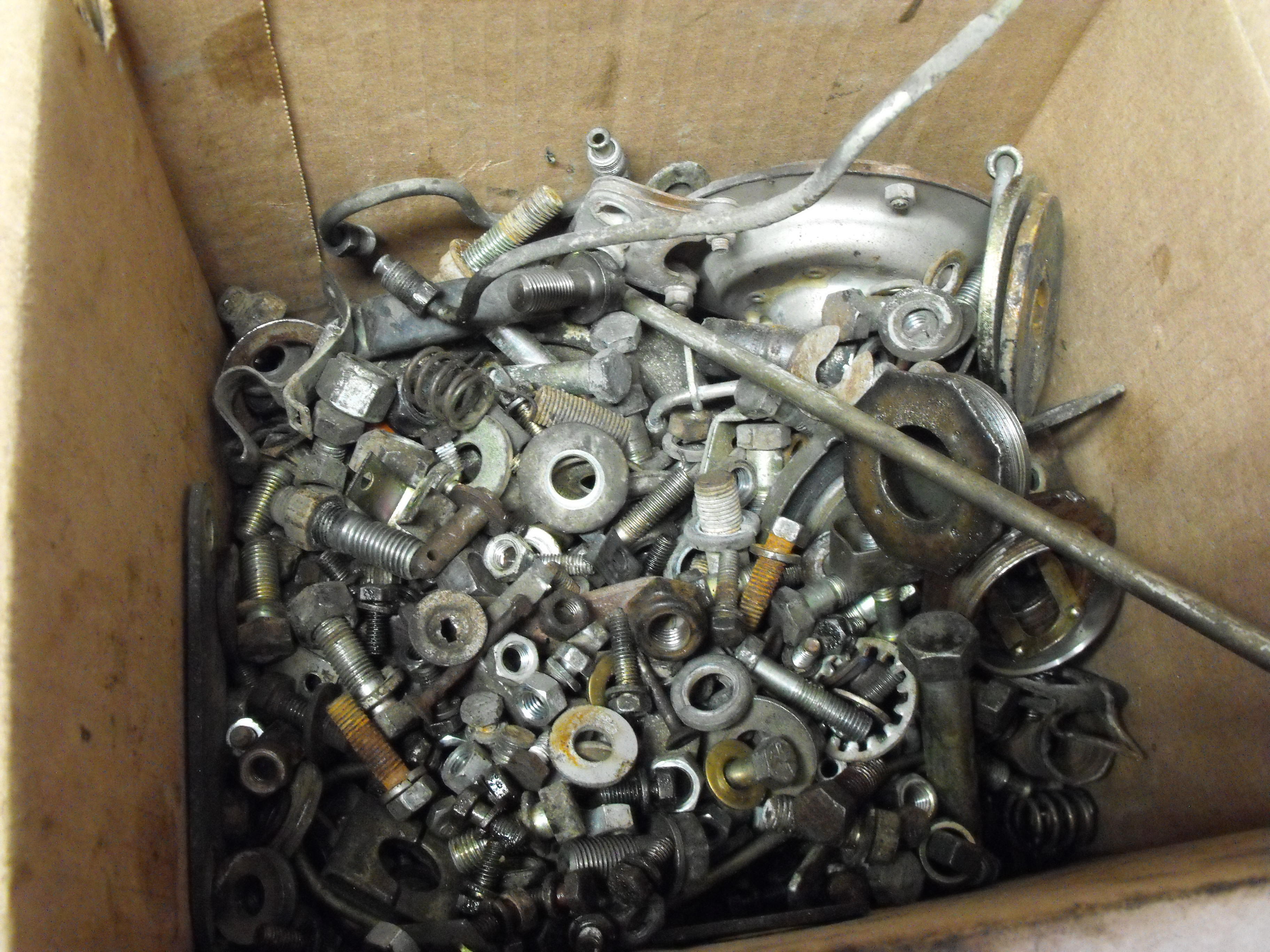

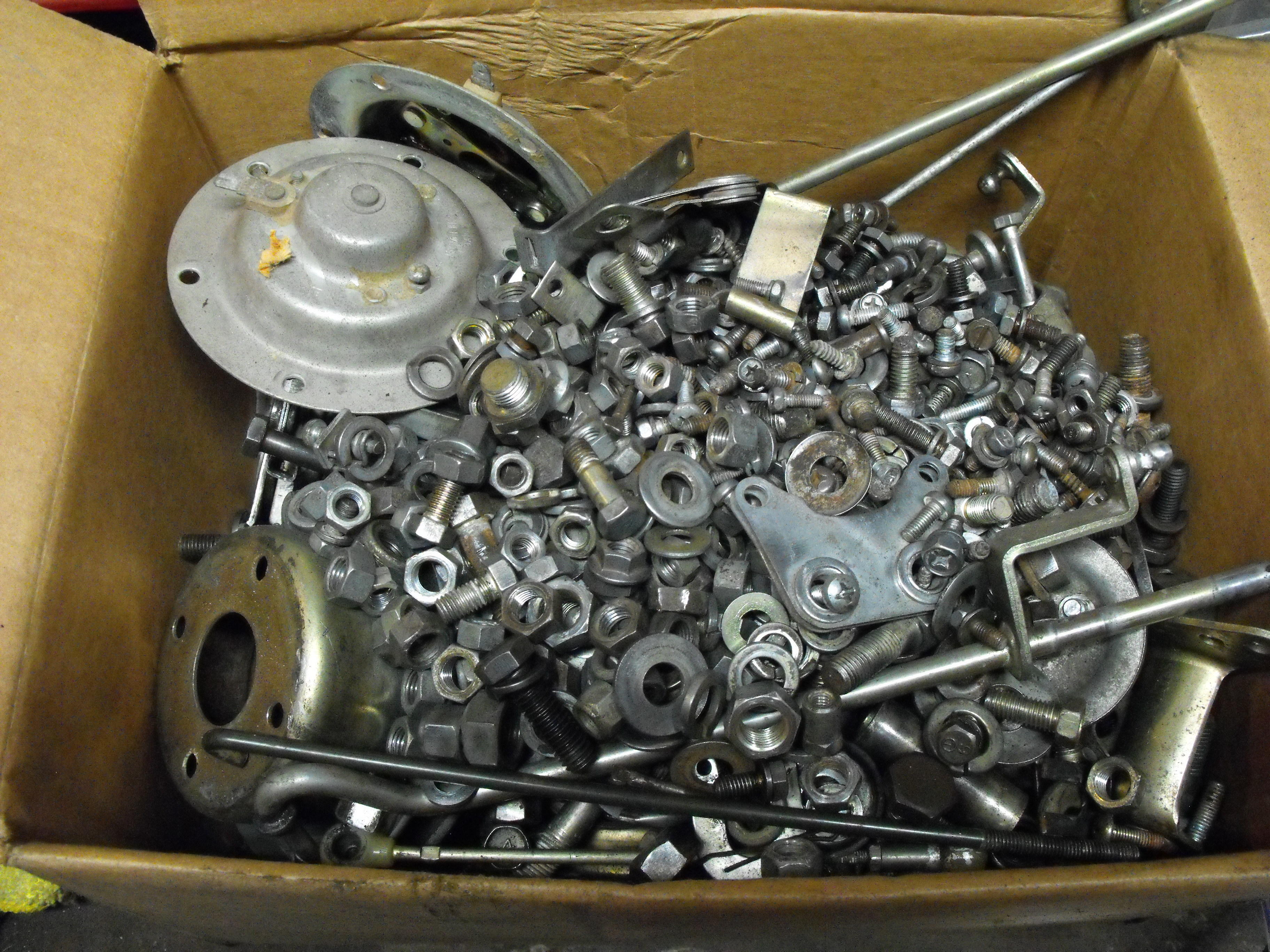

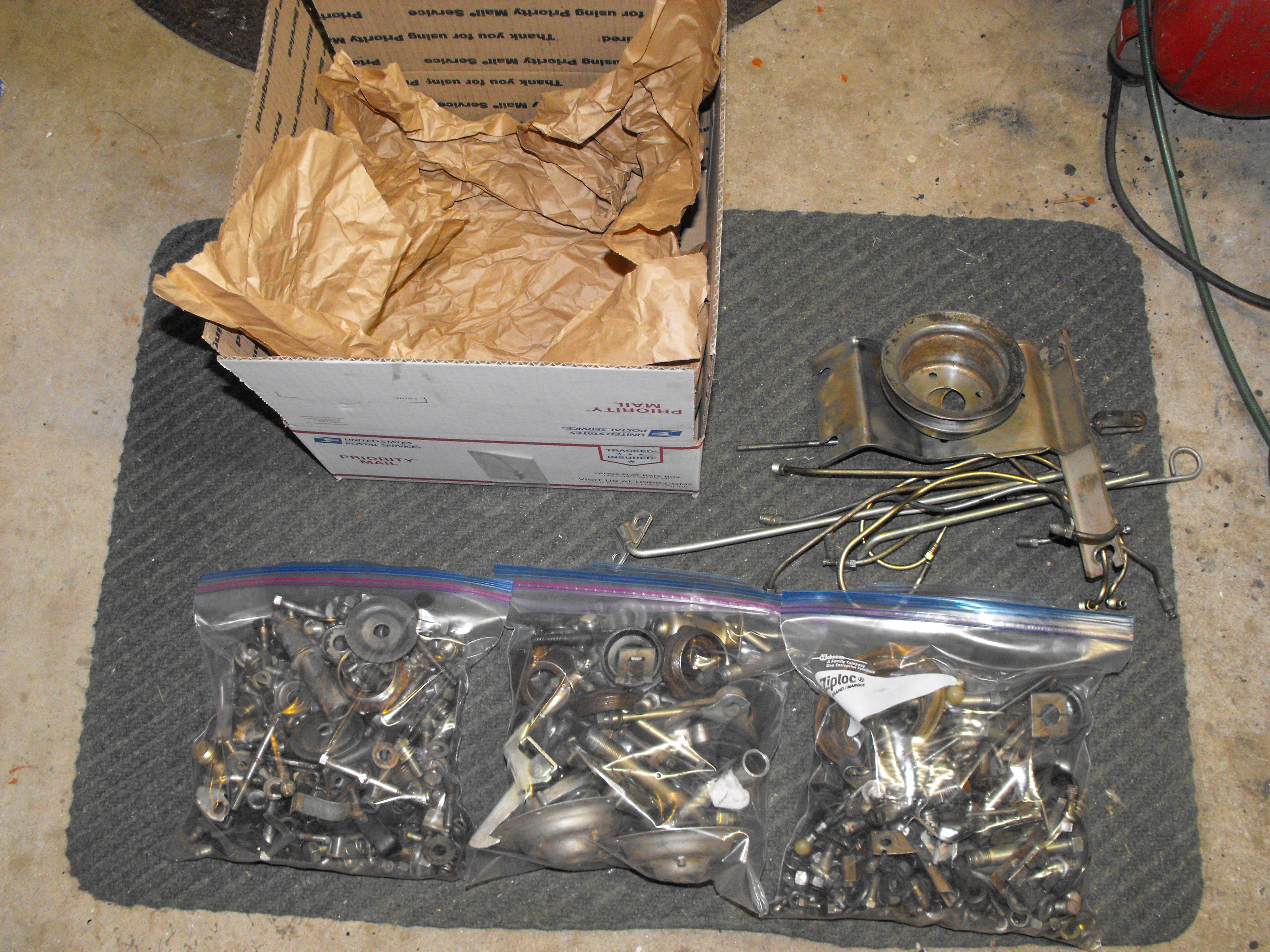

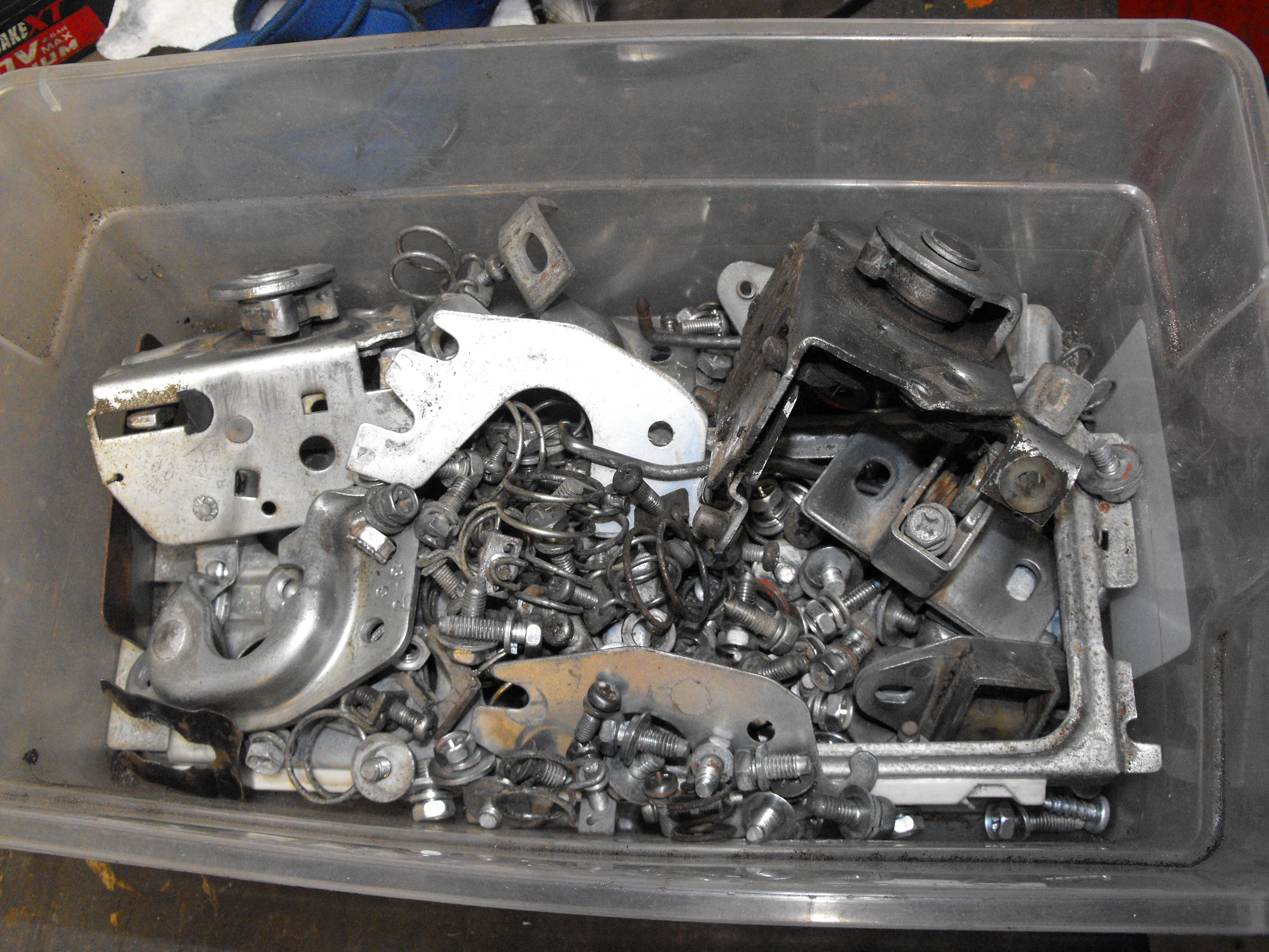

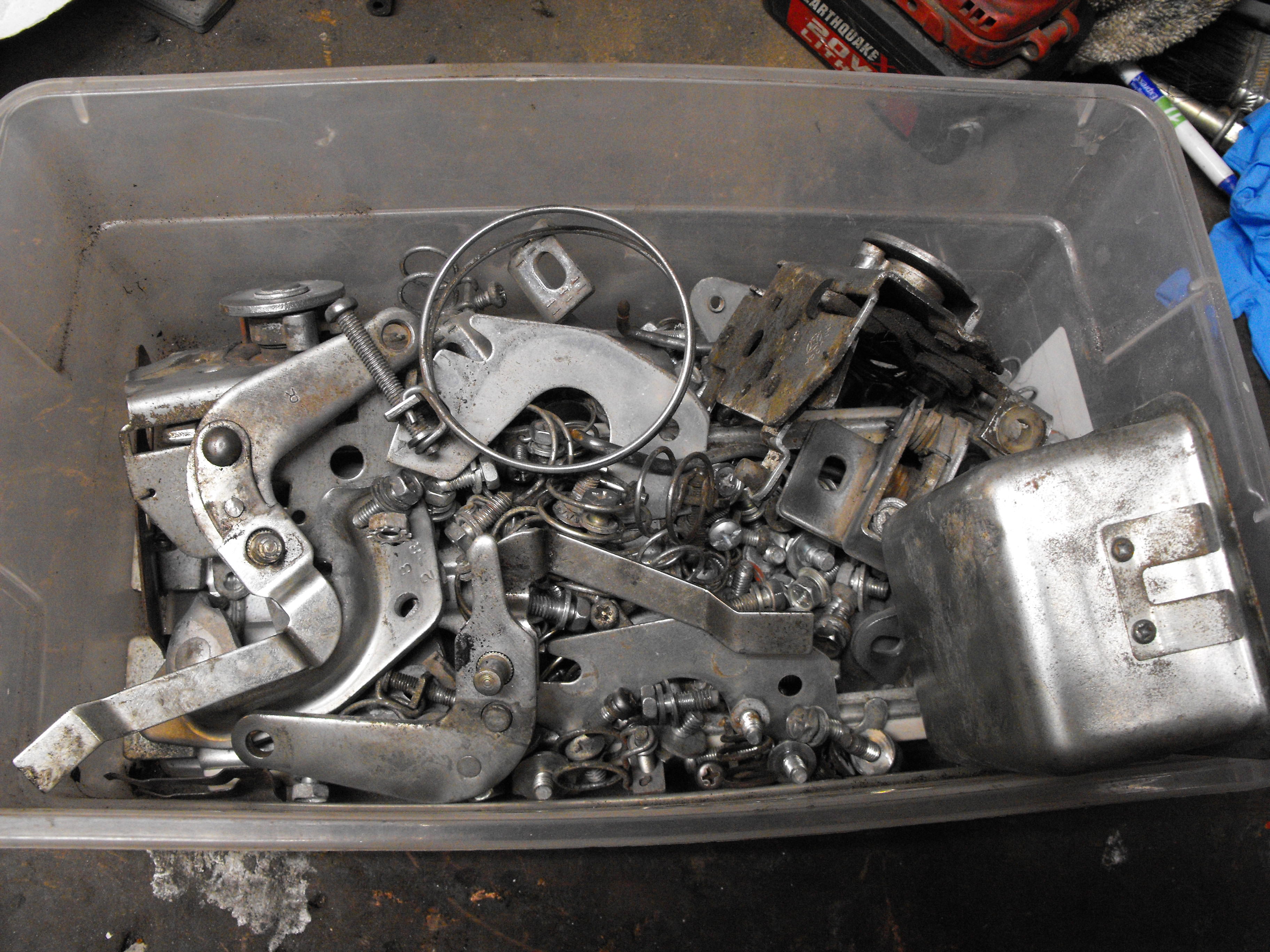

Looking good,  do you keep an inventory of what goes where, referring to fasteners?
I see the horn backs and mounting brackets, are the horn fronts being painted olive green?  Also did you have to sandblast the horn backs or just wire wheel them, mine are quite rusty. Just inquiring as I will doing mine soon. Soon meaning, sometime in the next couple of years, LOL.
