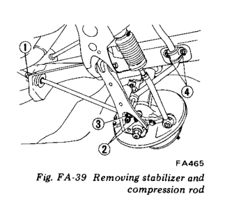

Only comment... Many people don't recommend poly/poly for the T/C rods. I've heard (read on the internet) that a combo of poly and rubber is better and that's what I run on my car.
I totally agree that those parts look great- I'm starting to get some similar parts stacked up as I wait for my body also!
I'm curious about the rubber/poly for the T/C rods- what is the theory behind that as opposed to all poly or rubber?  My car was almost 100% poly and I'm going back to rubber everywhere mainly because I couldn't stand the poly squeaks.  No clue what I'm going to do for the moustache bar- my bushings seem fine but the washers are shot.
The theory is that if you use poly on both the front and rear of the T/C rods, you run the risk of snapping the rods from the stress.
There are a number of threads here (and on other forums) on the topic, and I believe there are even pics of T/C rods that have snapped off.
Interesting.  I wonder if the broken T/C rods are on more high performance or race cars.
If you move the T/C rod through its normal motion while the suspension moves up and down you'll see that the rod pivots through the mounting hole where the bushings are.  The end of the rod needs room to move up and down as the front of the rod moves.  The PU bushings are solid and fill up the space that the rod end needs, putting a side load on the rod end.  It fatigues and breaks off eventually.  I think that it's also where the squeaking and groaning comes from.
