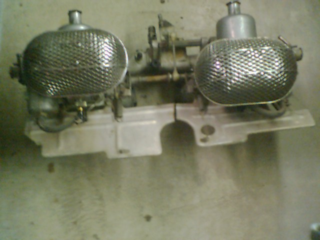

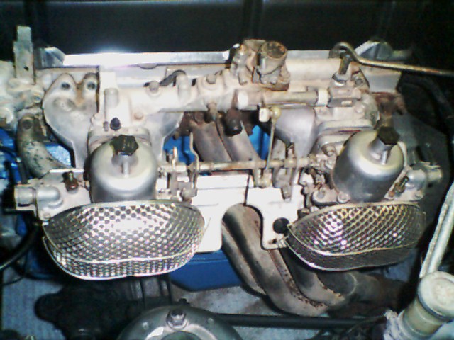

Piece of cake.On the intake behind the carbs are 4 screw holes(2per carb).Get a piece of aluminum used as flashing in the siding/roofing business(lowes/homedepo).Many colors/widths are available.Mine is 24 inches long and was 12 inches wide flat.Measure 3/4 inch in from the width.lay a 2x4(whatever)across your mark and bend to make an L.The 3/4 is what will attach to your intake you will cut out about 3 inches between the screw holes so in will slip up and clear the intake .Next make stairstep type bends.out 1 1/2 inches.down2 1/2 out 4 1/2.Be creative!Any time you bend metal it gives it strength.You'll see.Just make sure it covers you carb bottoms.For the springs drill holes thru your shield.Get longer springs.Attach spring to header with hose clamp.(no one can see it).You could make a Y type that attaches to the same carb holes as the shield to hold the spring,Be Creative!!Have fun!! Daniel
