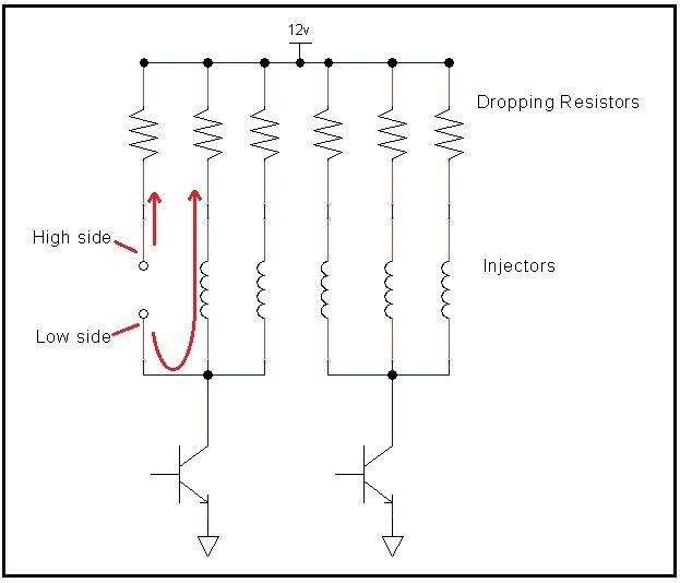

5) To sanity check the mechanics work, I checked one of the injector wiring harnesses.  While cranking, an LED on the harness did NOT turn on.  While messing with the key in the ignition, I saw the LED flicker 1 time, not even a "pulse" but a flicker.  I'm still determined this is the cause.  Something in the ignition assembly (even tho it's new) or other EFI wiring must not be connected/grounded right.
I found it bizarre with the key in the ON position, and the motor not started: both pins on the injector harness had +12 volts.  Either pin would light up a test light with the other end grounded.  One pin is supposed to have +12v at all times, but I thought the other pin should be floating, waiting to ground pulse to complete the circuit.  Tomorrow I'll be doing FSM tests related to this circuit tomorrow.
The situation where you're getting +12 on both sides of the injectors is normal. It only takes a small amount of current to light up the test light and you'll pull that small amount through the injector on the floating side. It's not enough current to click the injector, but it'll pull enough to light the test light,
In fact, you'll see that same situation even if you pull the connector off the injector completely. You'll pull current through one of the other injectors. Like this:
Gotcha, good to know, makes sense as it was a lower power LED bulb.
