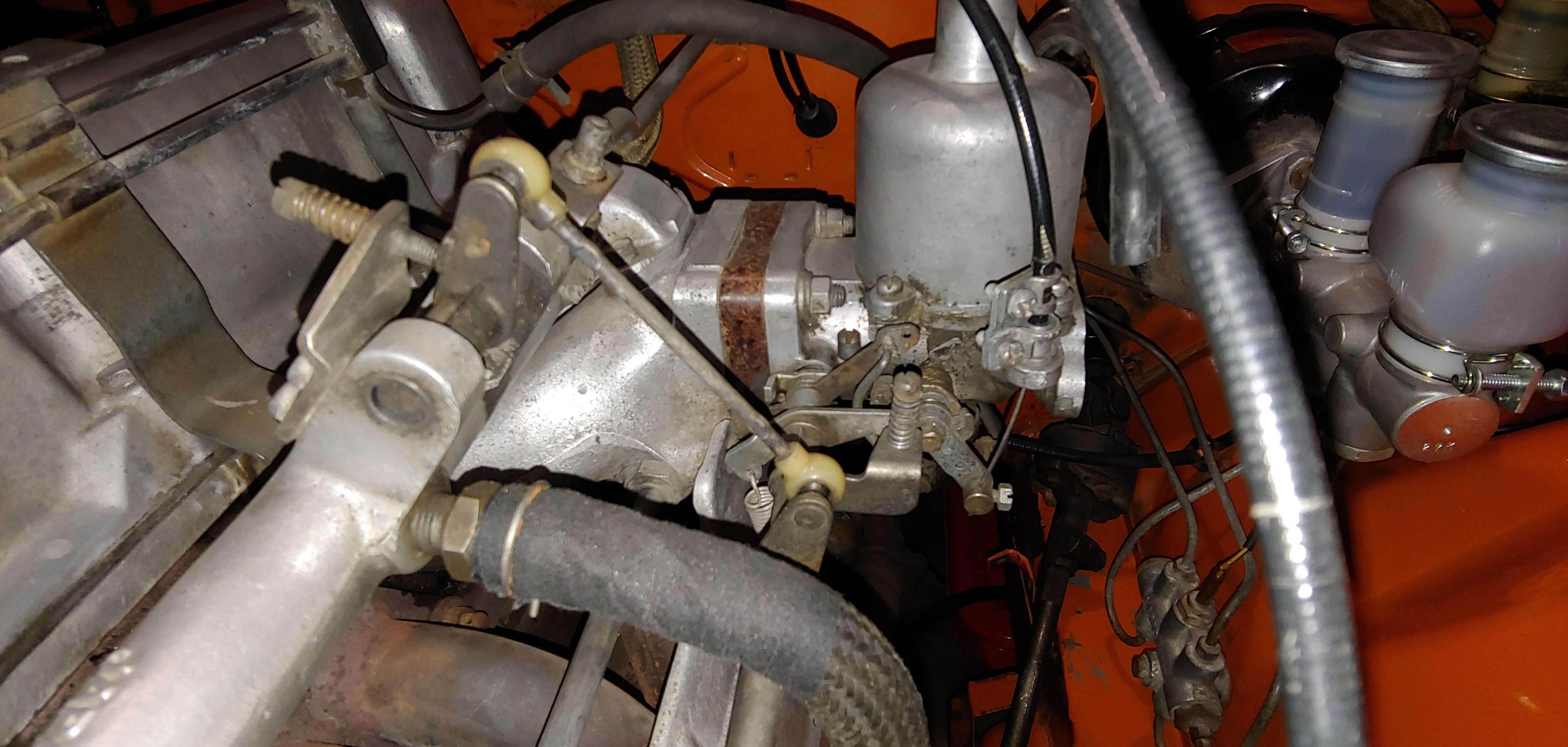

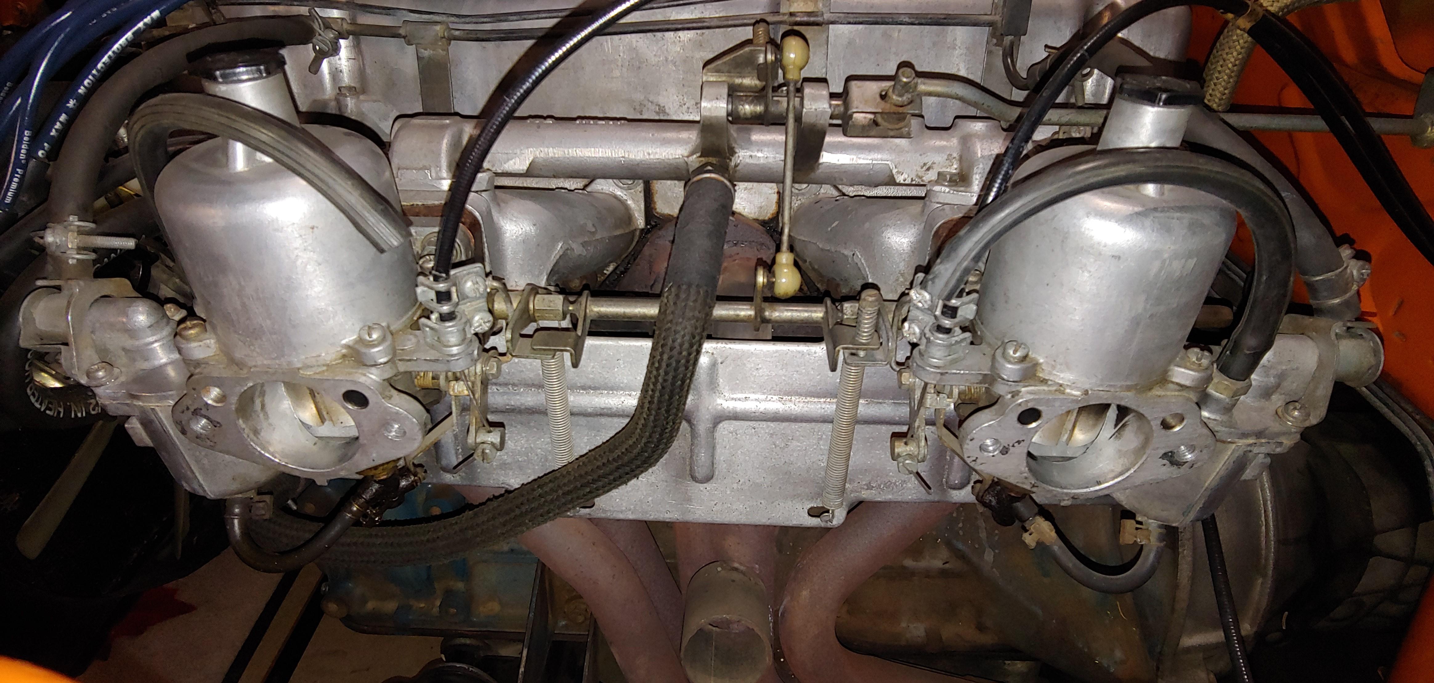

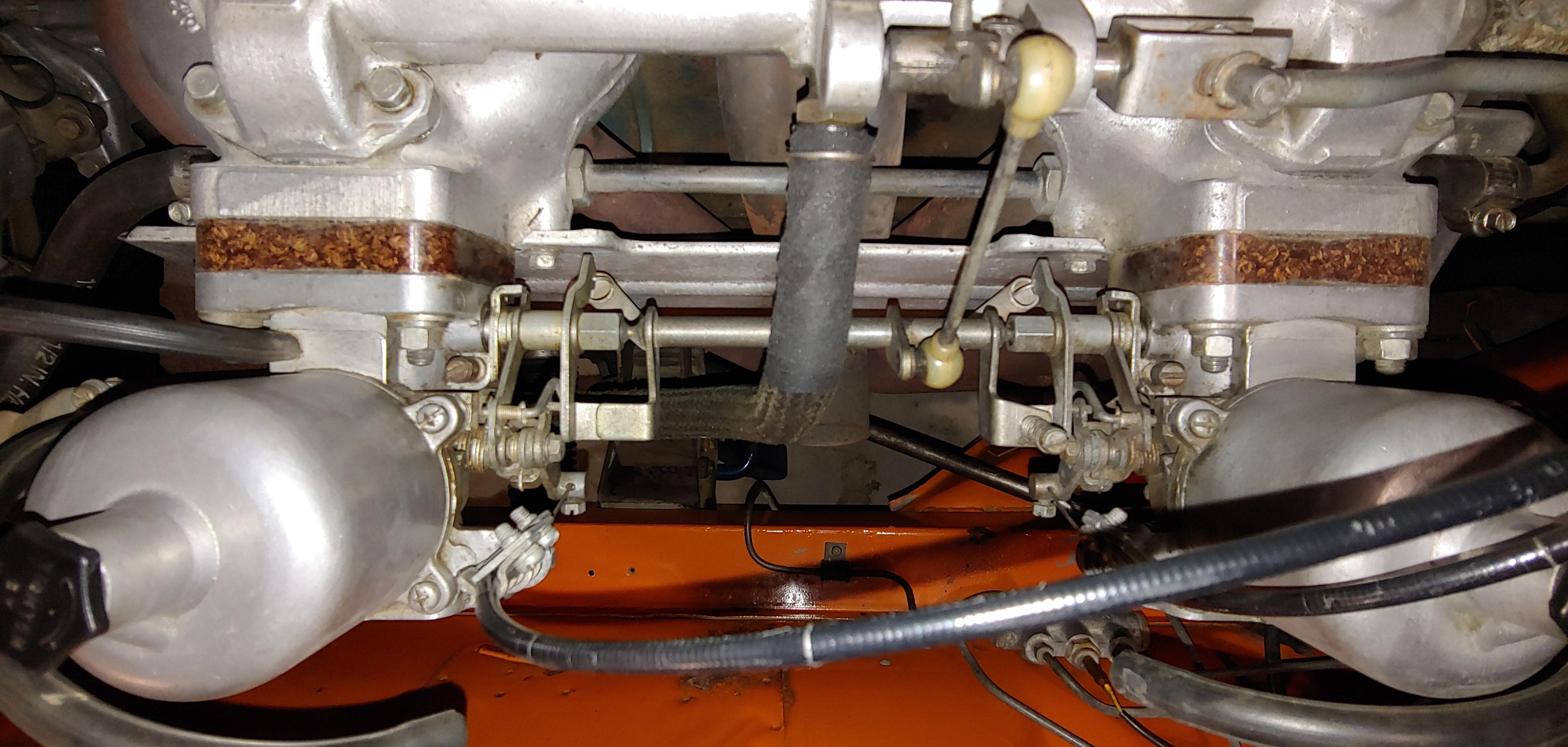

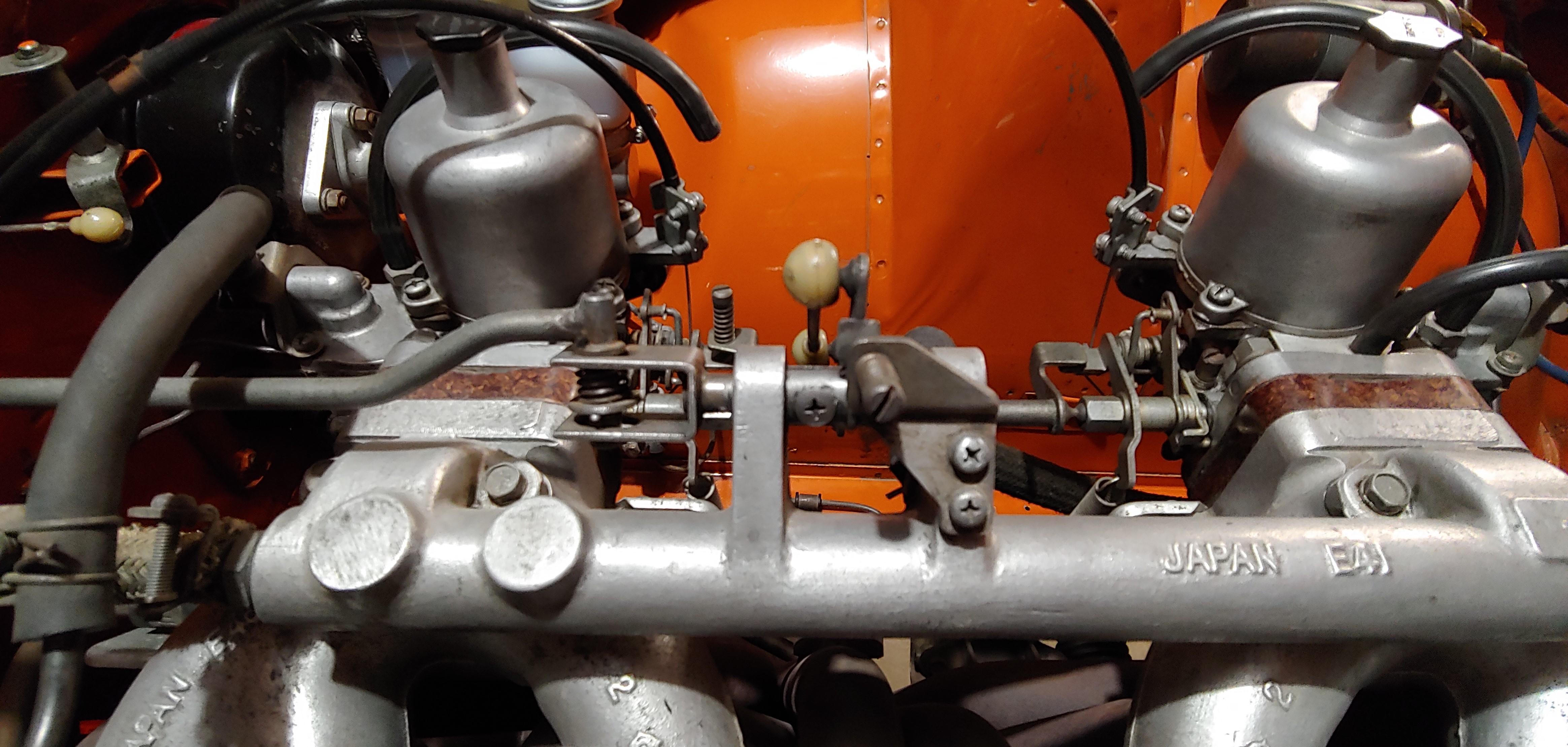

I thought I'd start by showing you the things that I don't believe are right. You might be able to just tell me what I did wrong or you may have to post some pictures of your own. Thanks again.
I am not sure about your insulator, it looks like it is in upside down.  Here is a picture of how mine sits.

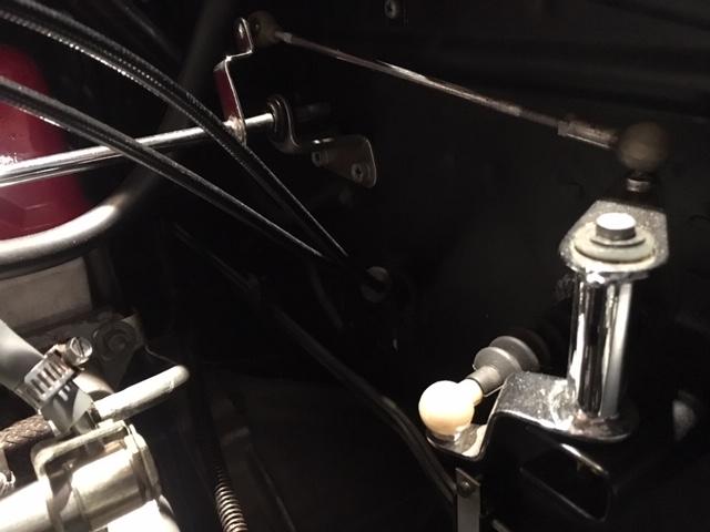

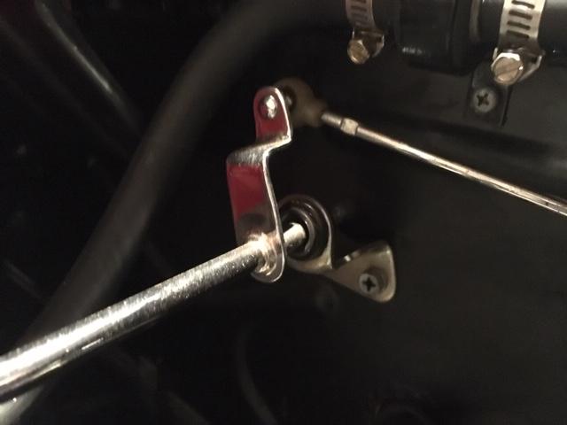

Here are some pics of the firewall connections for the throttle as well, You asked for those too.
I hope that helps.

I think that the tabs for the screw are wrong on the left side. The one closest to the carb should be on the bottom.
I went out to the car and checked. You are exactly right! All the comments are helpful, but this is (I think) the root cause. The rest is tuning.
