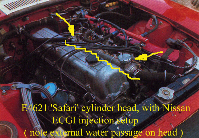

Special heads and cooling pipes for racing in early 70's. The S20 also had an external cooling pipe.  The later I6 Nissan engines also had this.
In theory, one could drill holes in stock head and fab a pipe.
I would do it if racing.
