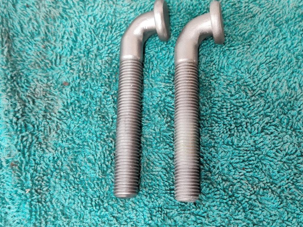

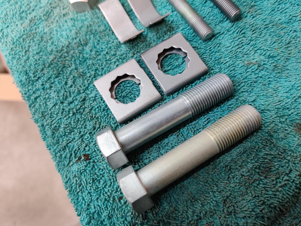

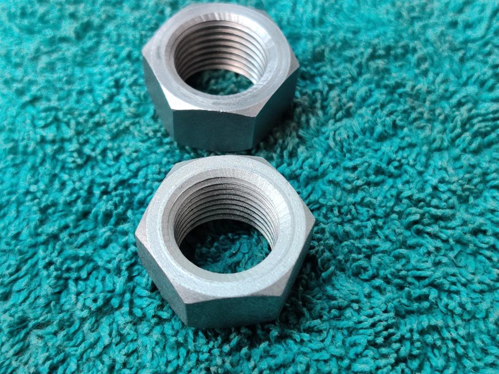

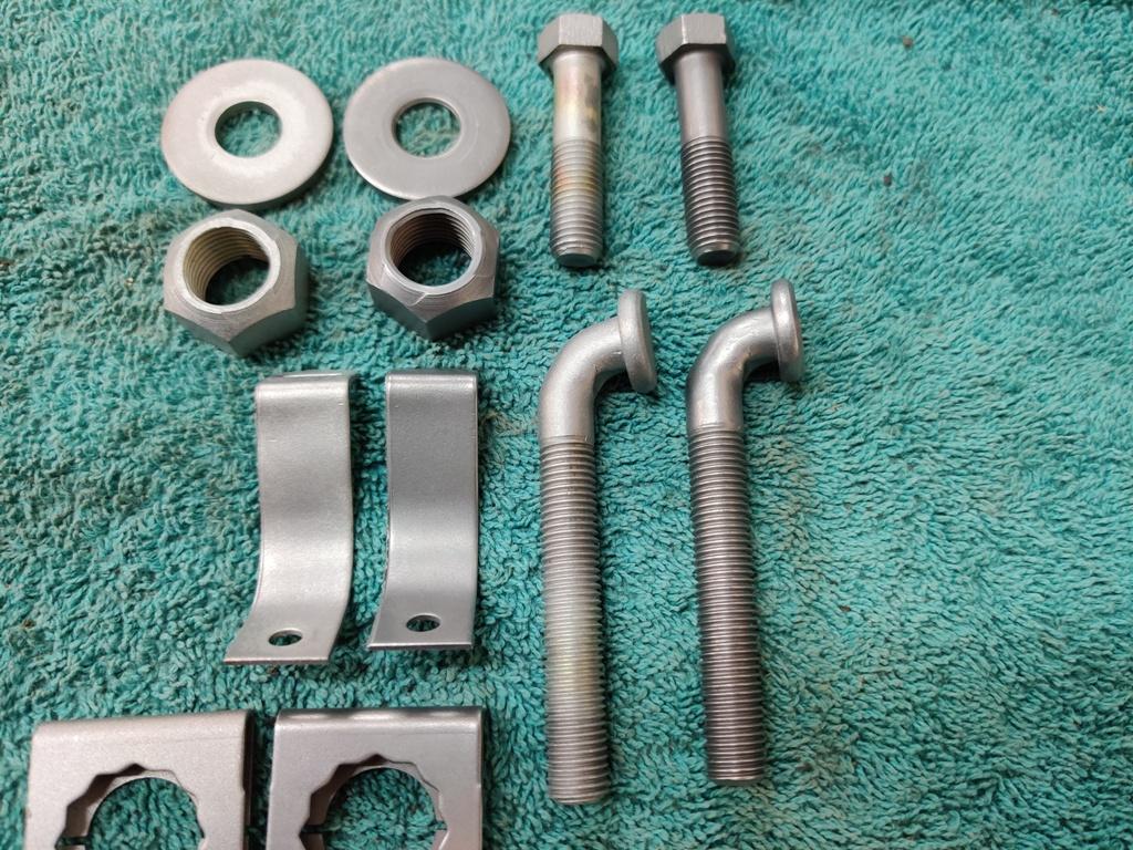

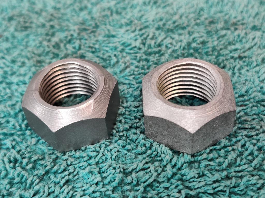

Today, I experimented with my vibrating tumbler.  I chose from parts I had already bead blasted and grabbed one of a few parts.  I ran them in the tumbler for about two hours.  I will post a few pics of my set up and media later.  I did some searching on Youtube before deciding how to proceed.  Following are some pics.  I am not going to resize them like a typically do so the difference is easier to see.
Glass bead blasted part is on the right (glass bead blasted and tumbled on the left):
Glass bead blasted part is on the bottom (glass bead blasted and tumbled on the top):
Glass bead blasted part which has been tumbled is on the right in each pair:
For the large bolts in bottom of pic, blasted and tumbled one the top one.

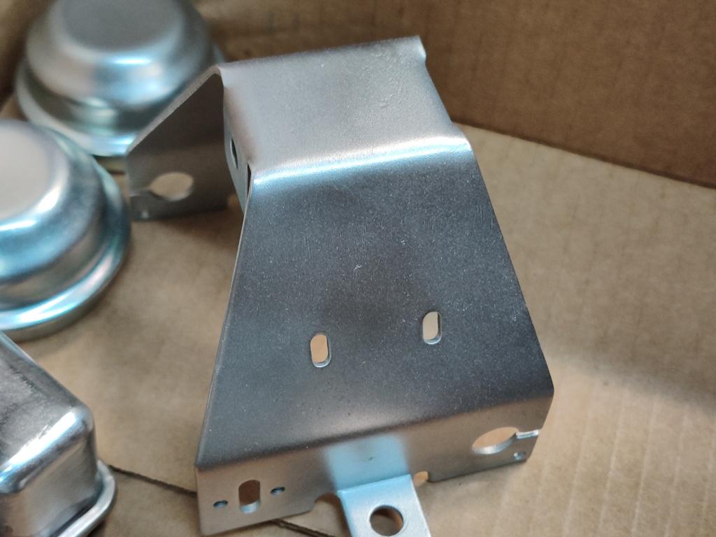

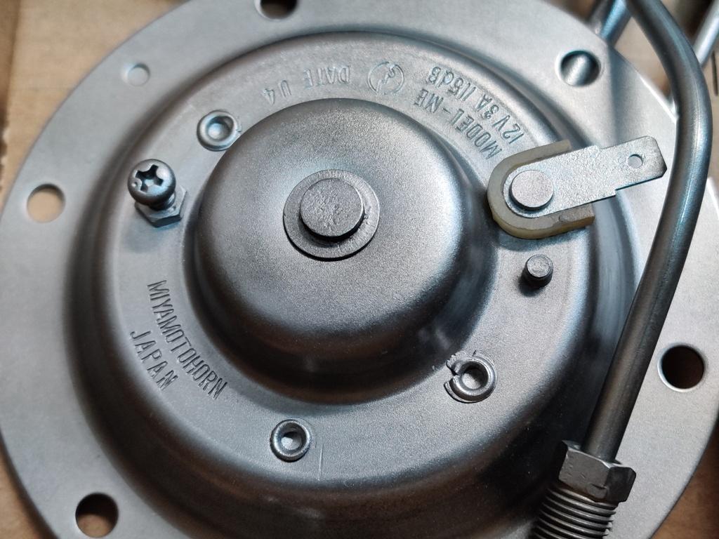

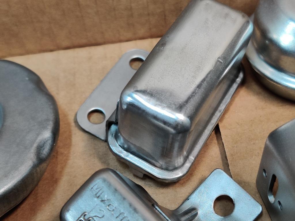

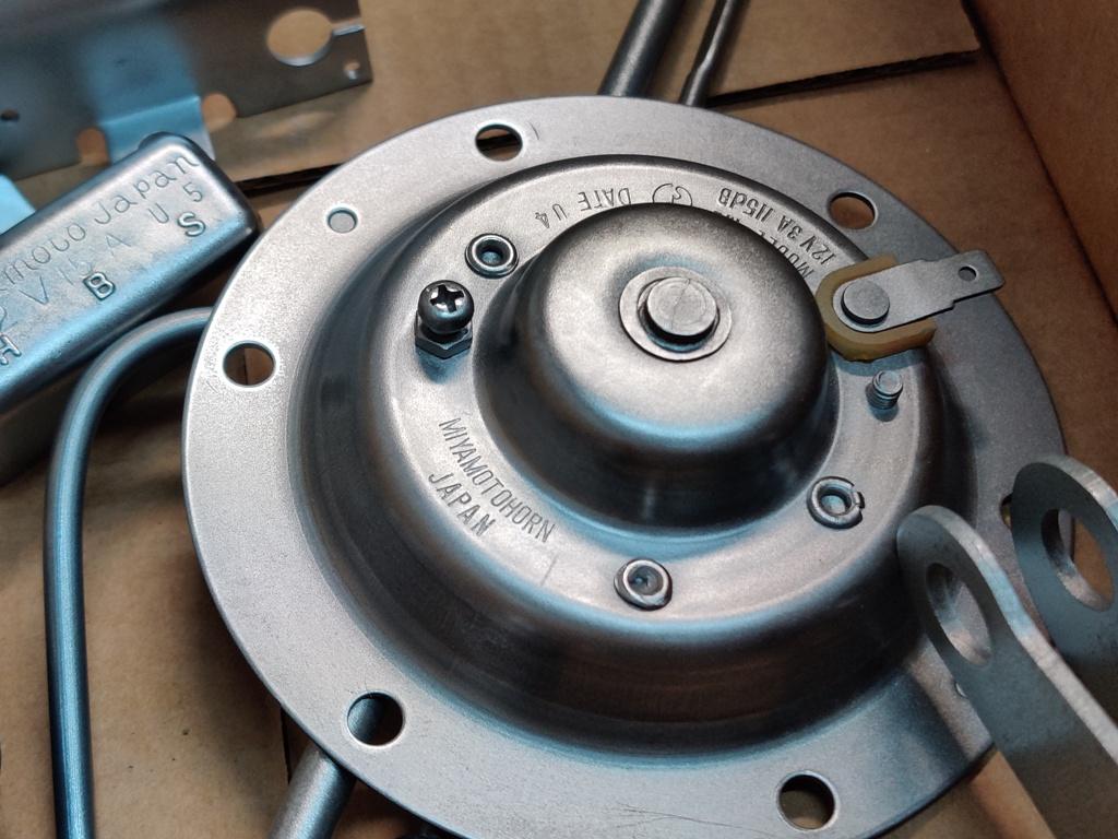

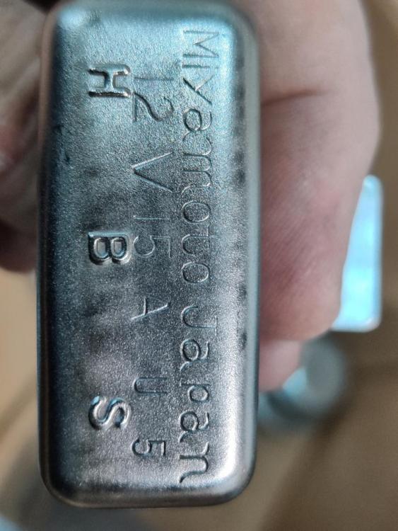

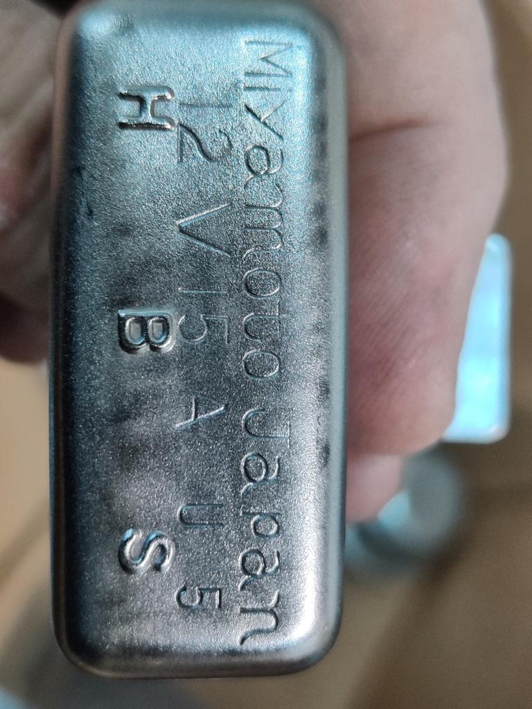

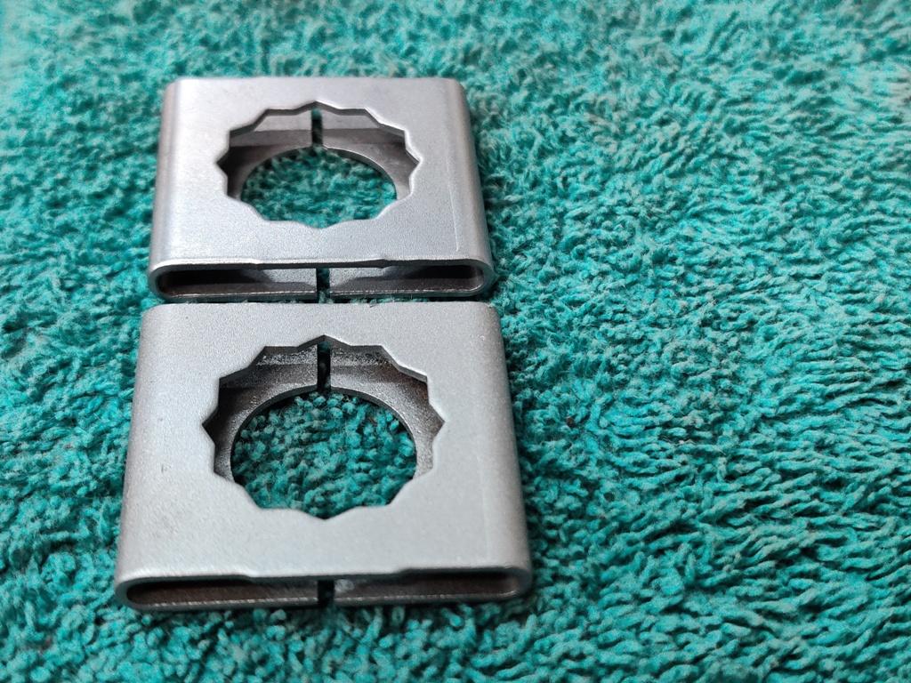

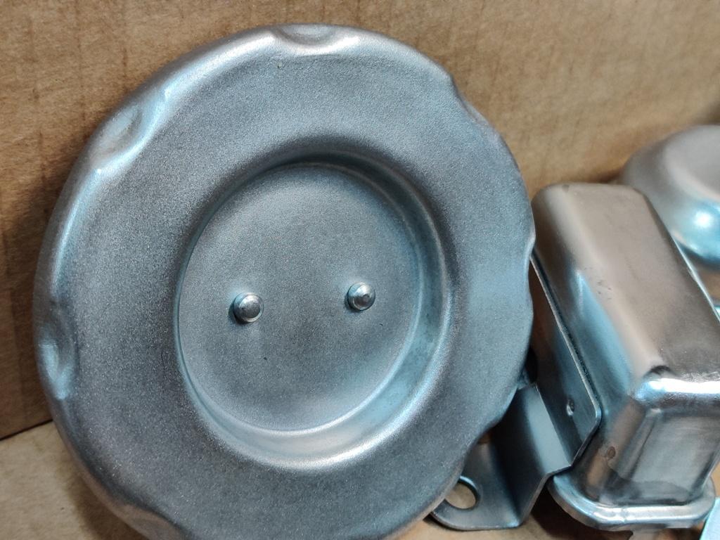

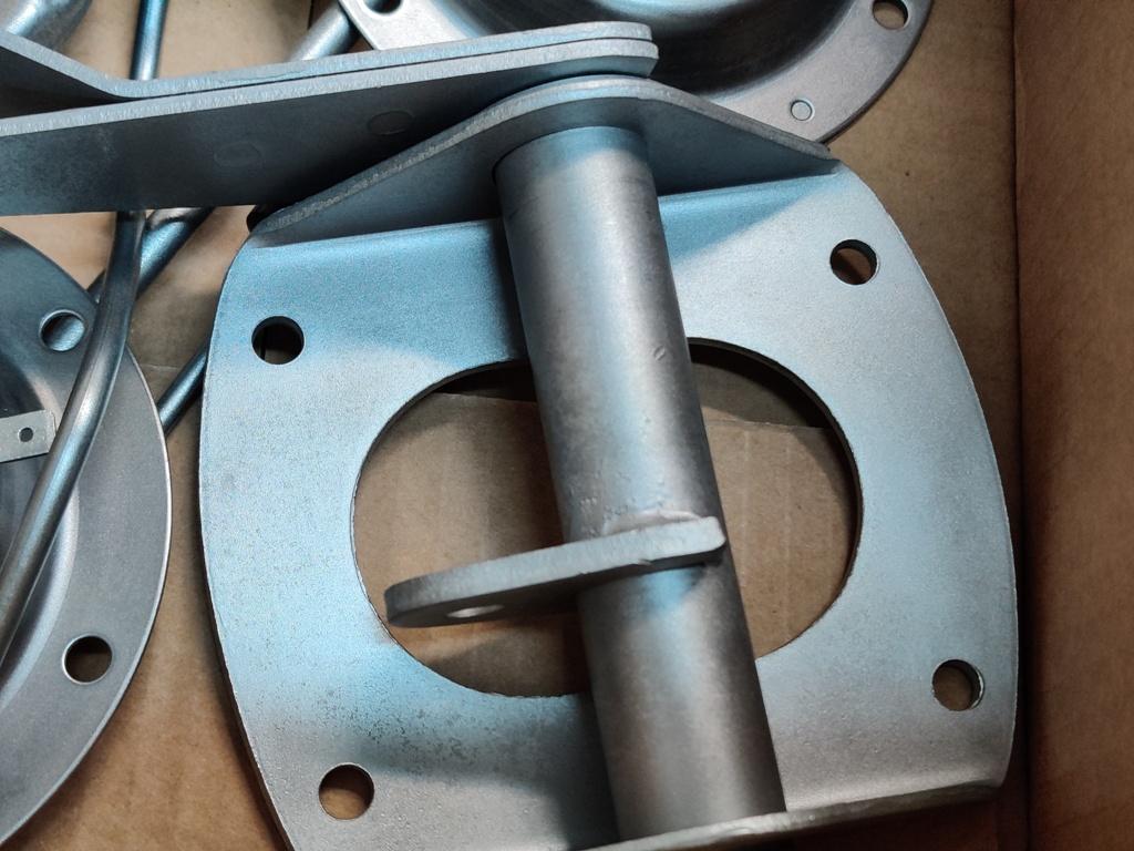

Well, I have a couple of questions then.  How do these look?

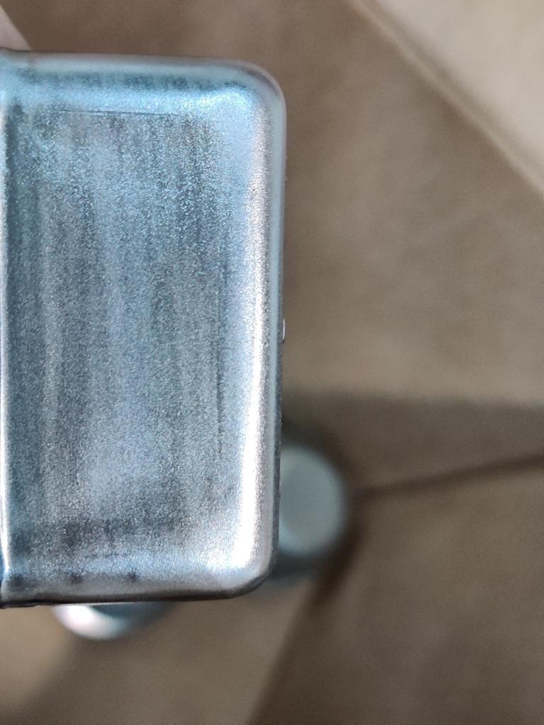

Additionally, when using the dremel with stainless wire brush I am getting some of this (uneven polishing):
I assume that is not desirable?

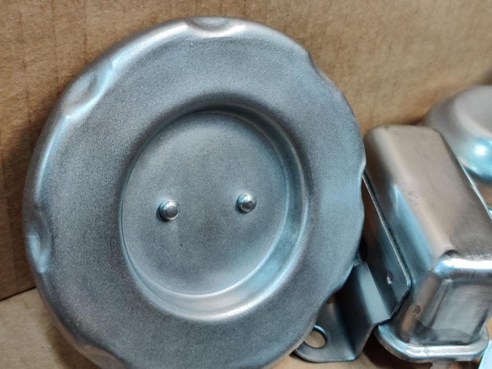

These horns - they need more work?

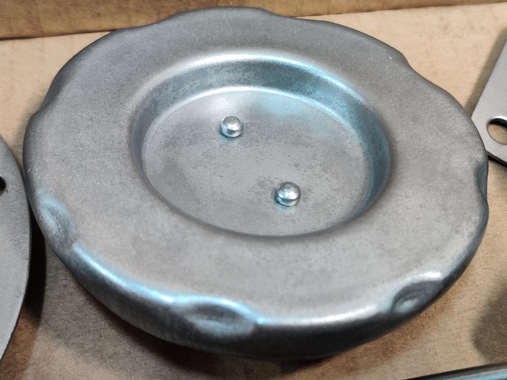

With regard to this relay cover, it had some imperfections (dents) which I straightened.  I ended up hitting it with 1000 grit sand paper (wet) for a bit to try to help it.  It is notably more shiny than other pieces in this cardboard box which I have hand finished.  Should I be shooting for that level of shine for the larger pieces if my desire is to come close to replicating the factory finish?
Edited by inline6
