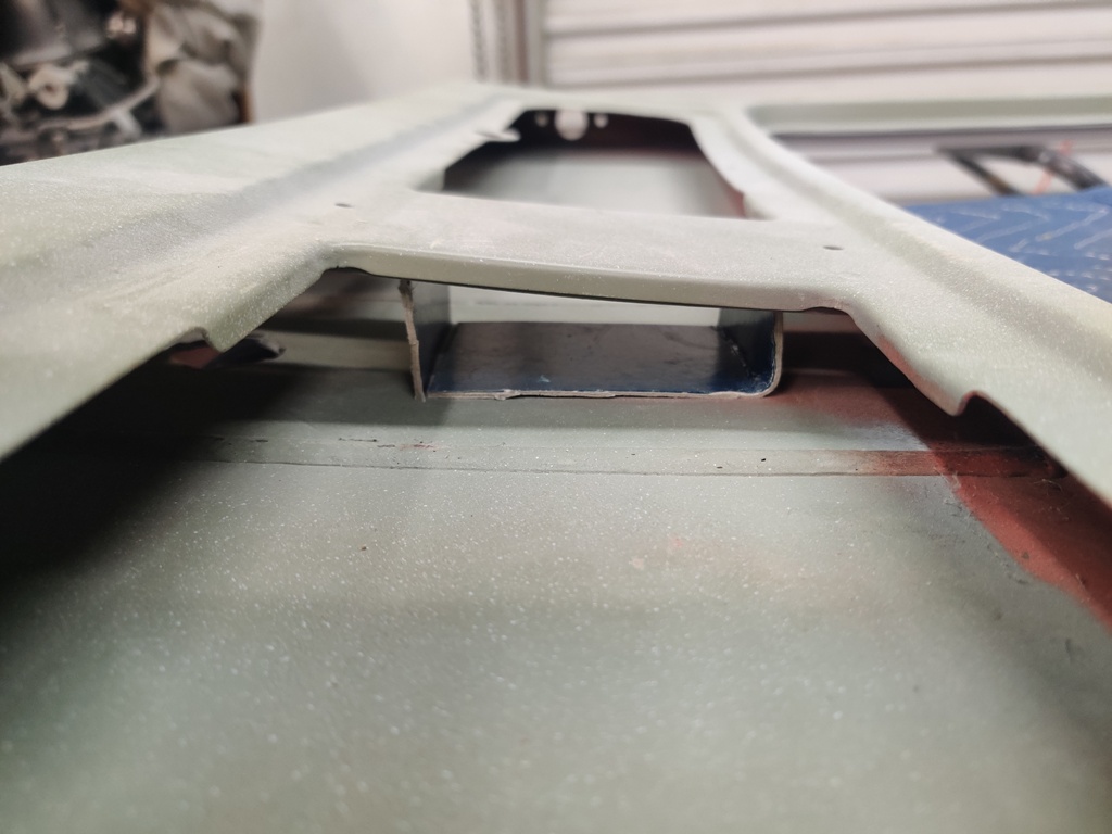

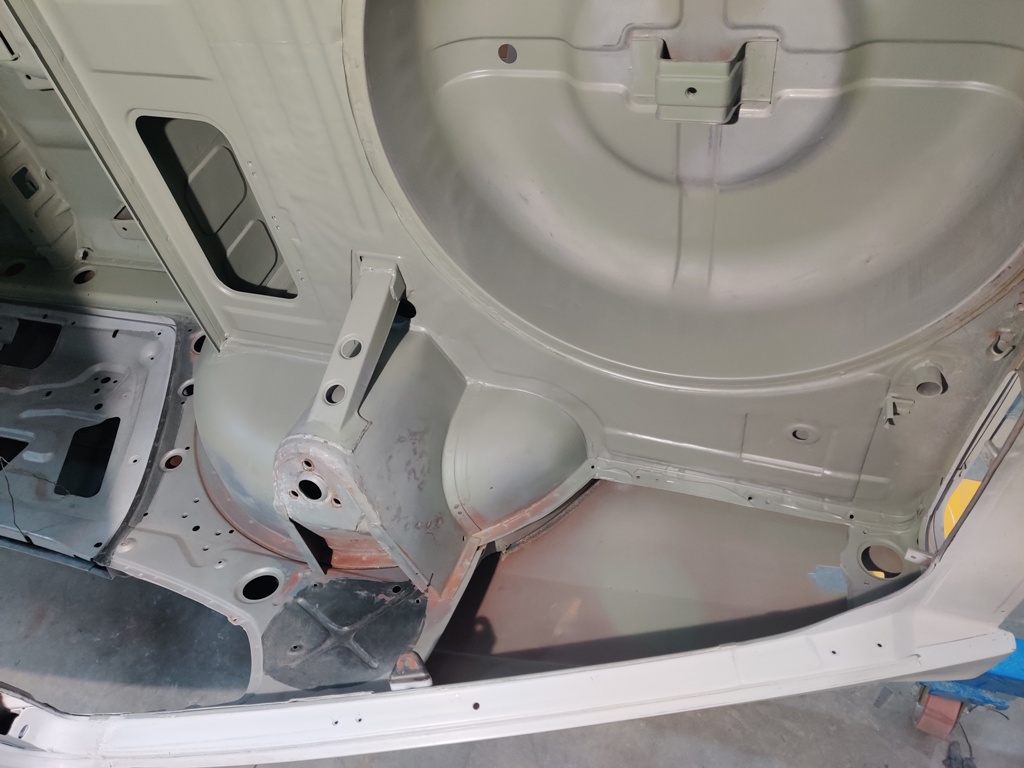

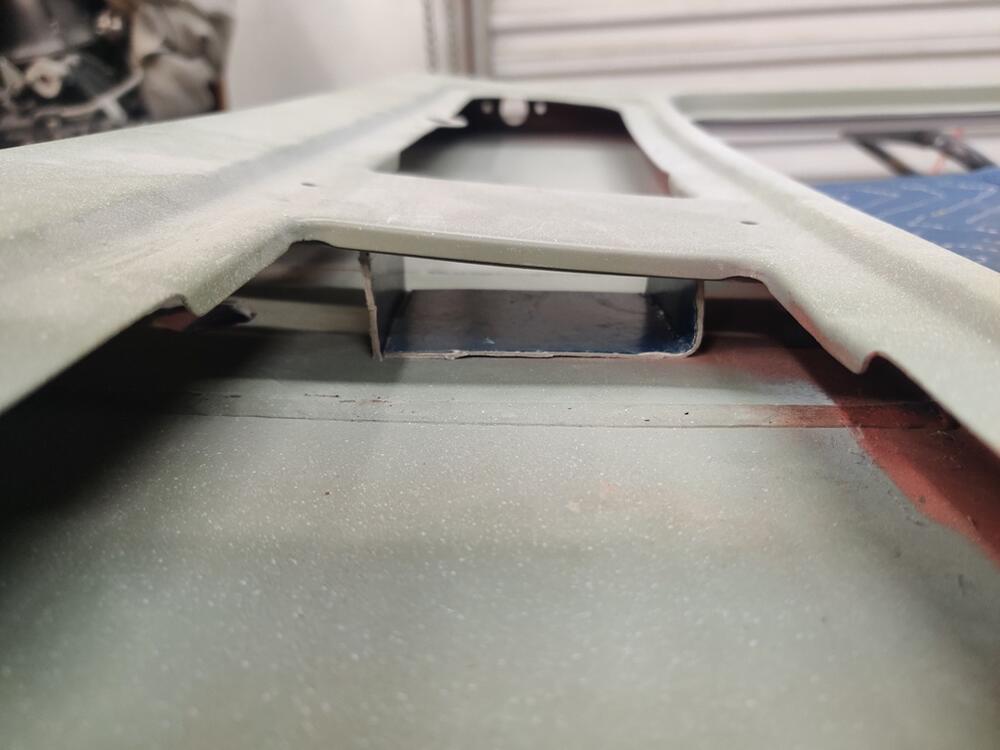

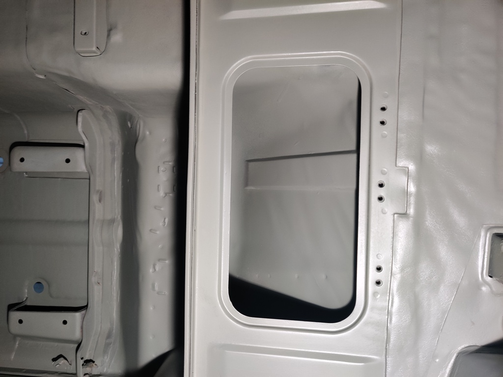

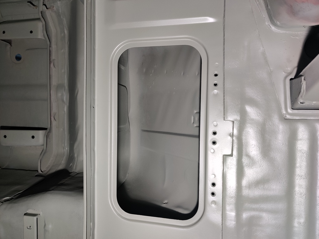

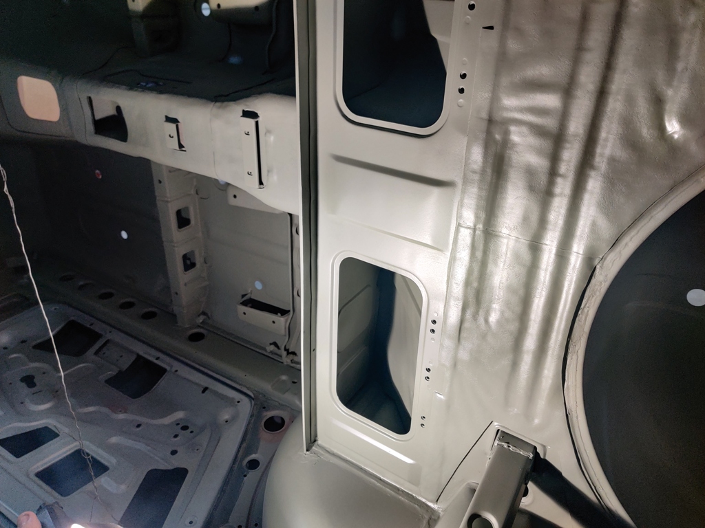

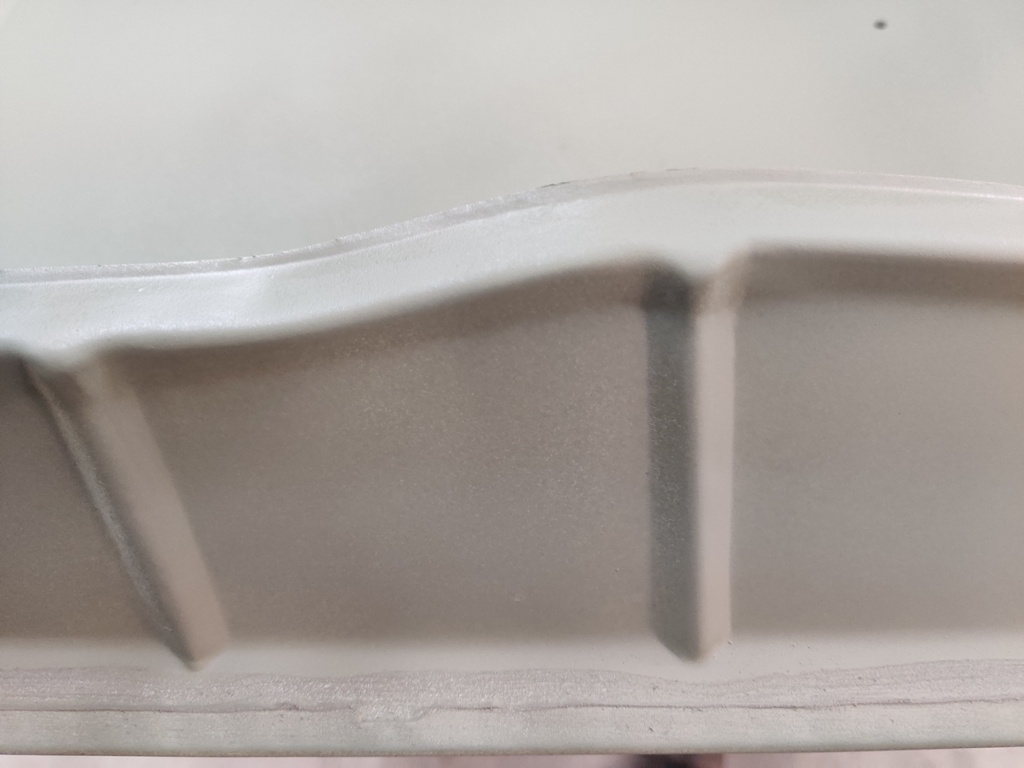

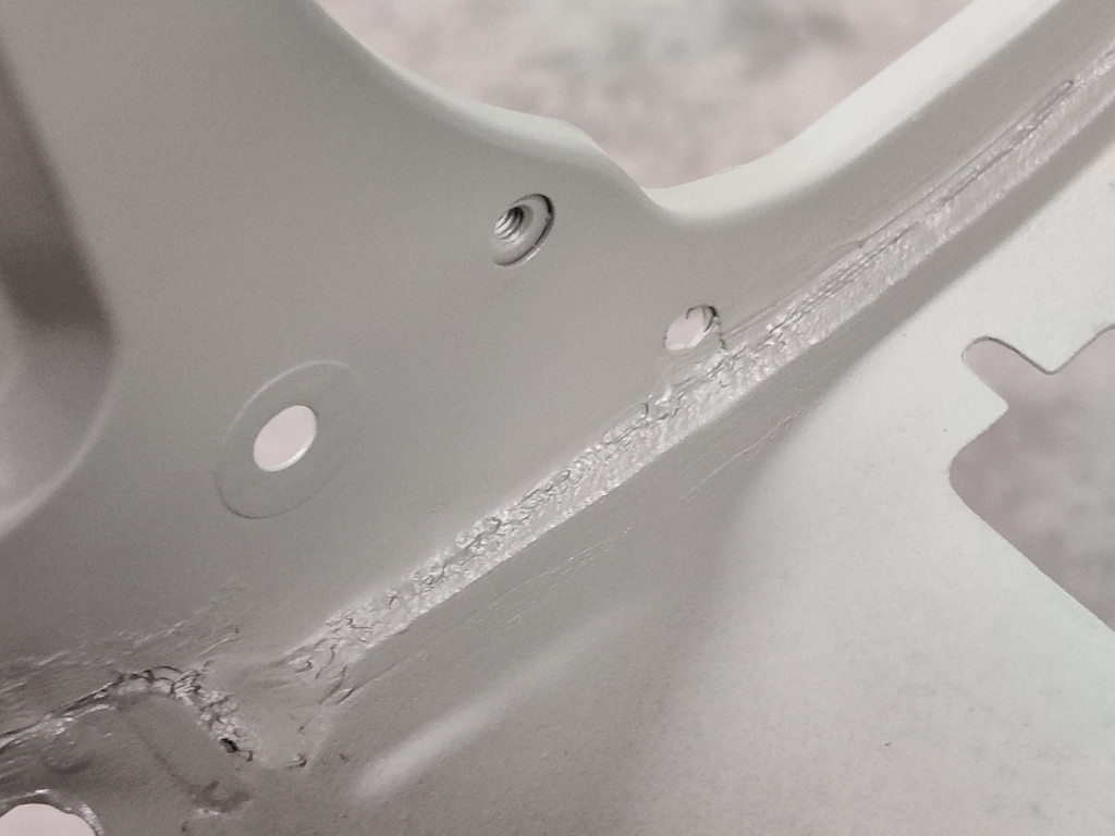

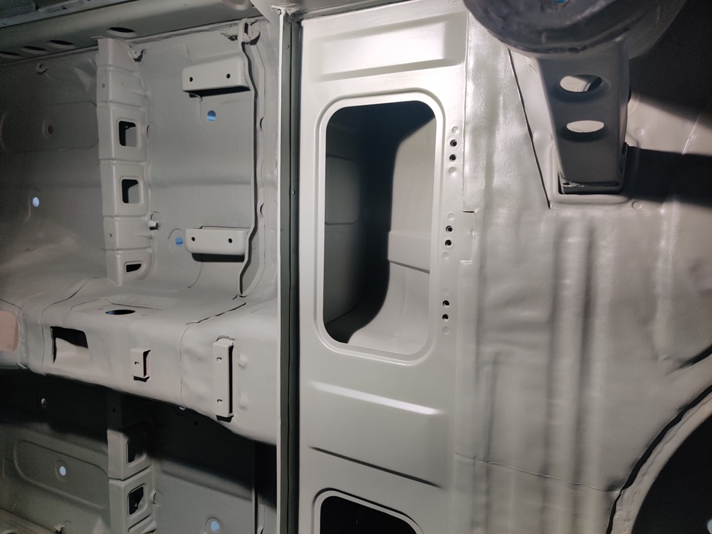

Picking up where I left off, I primed inside the rear hatch area.  In the spare tire well, I only sprayed to cover spots where bare metal was exposed during sanding.  Since the spare tire well and tool door areas will be more visible when all is said and done, I have spent and will spend more time in these areas to make them look factory fresh looking when the car emerges from the paint booth.

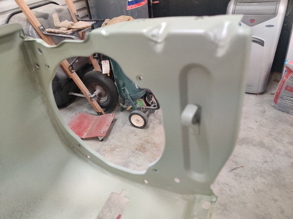

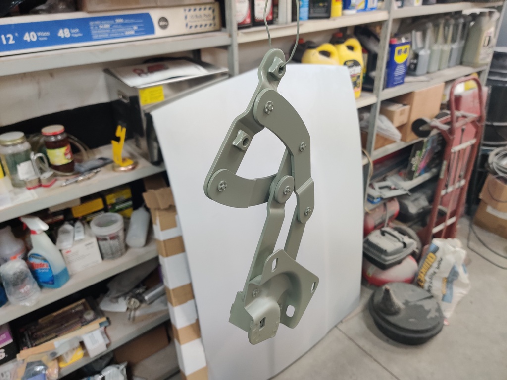

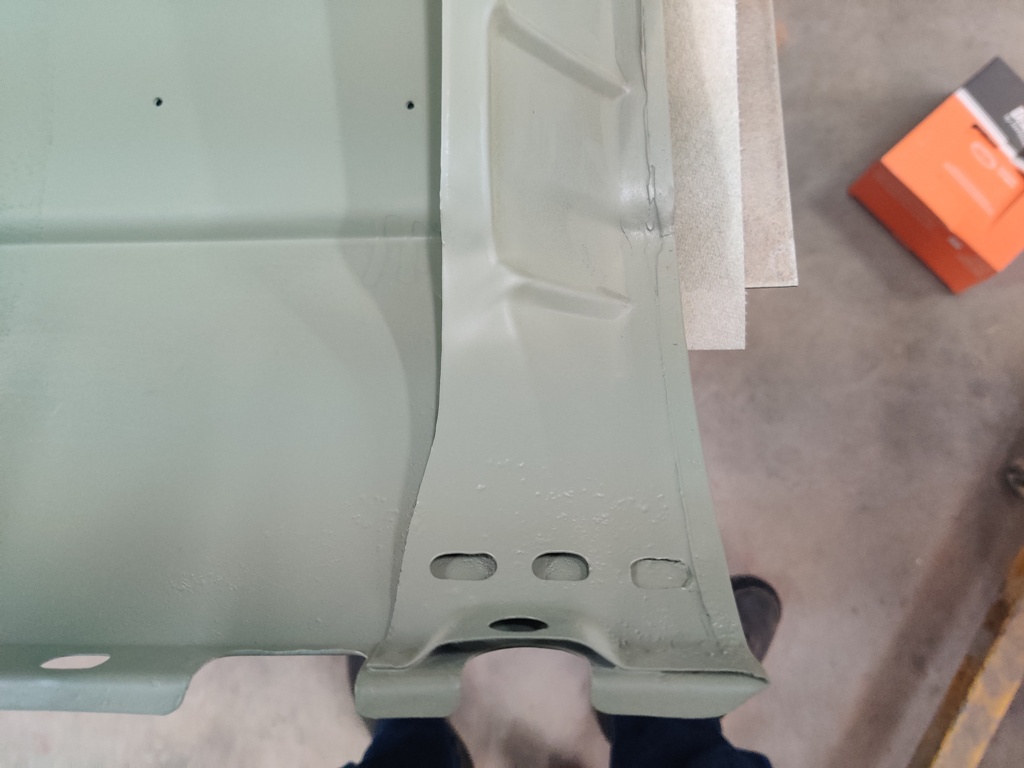

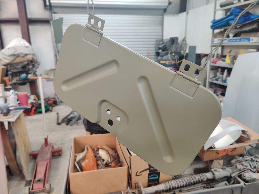

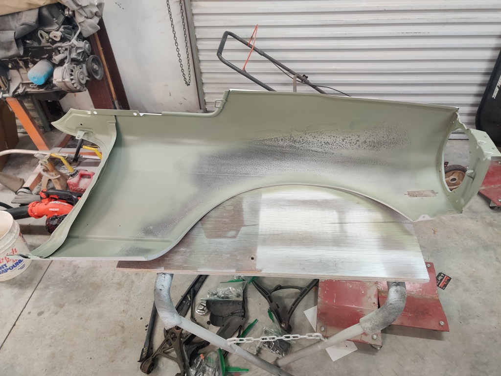

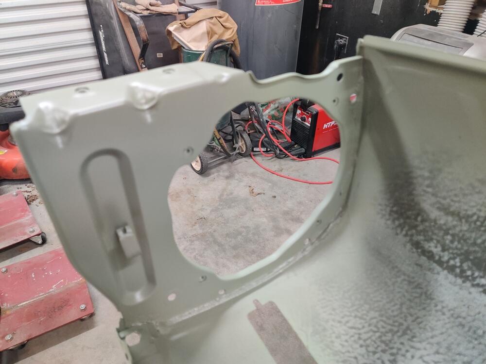

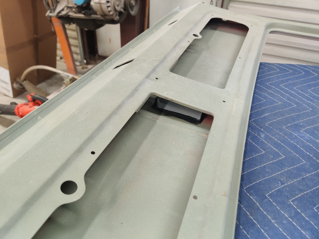

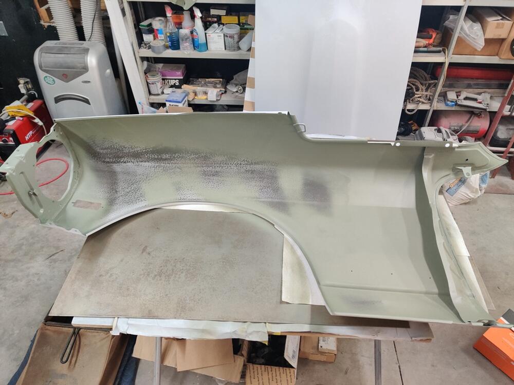

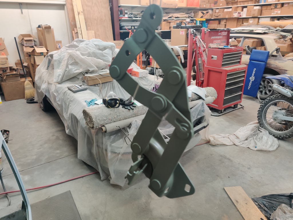

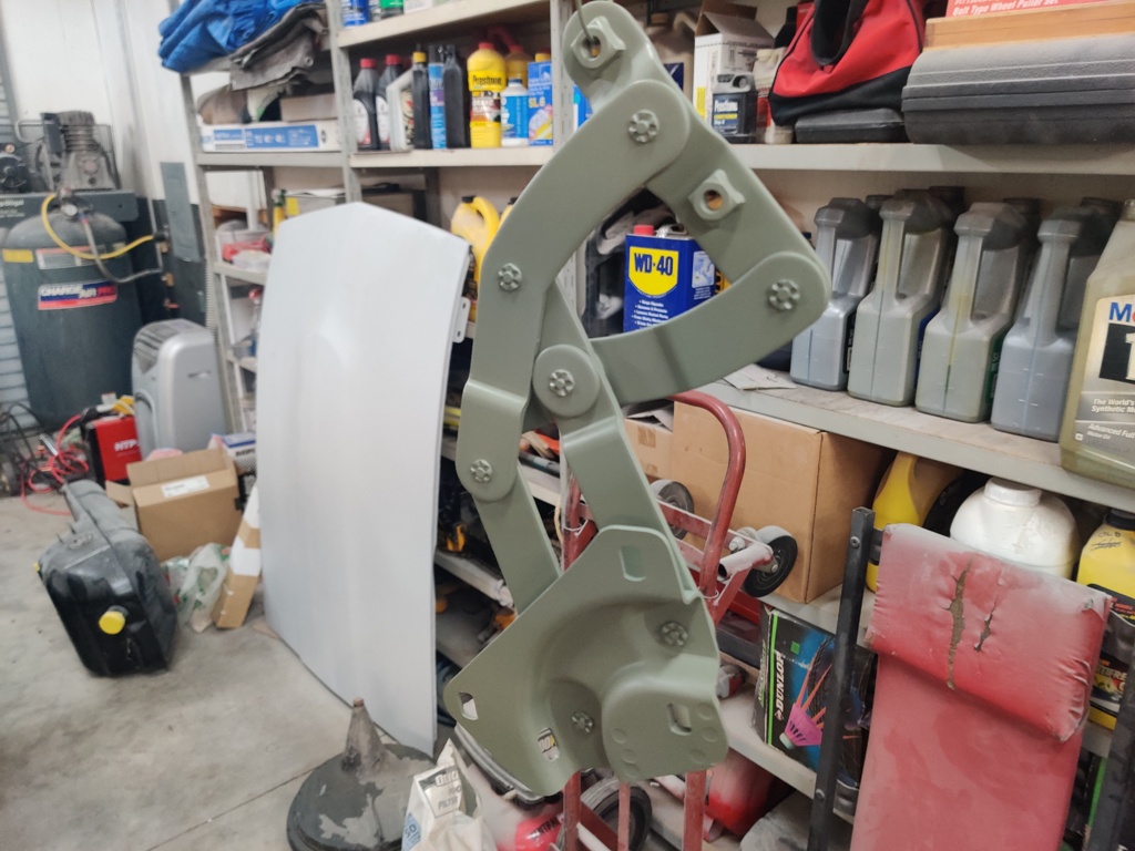

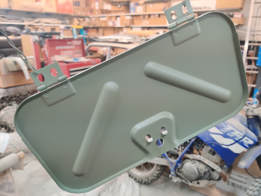

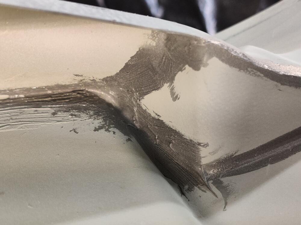

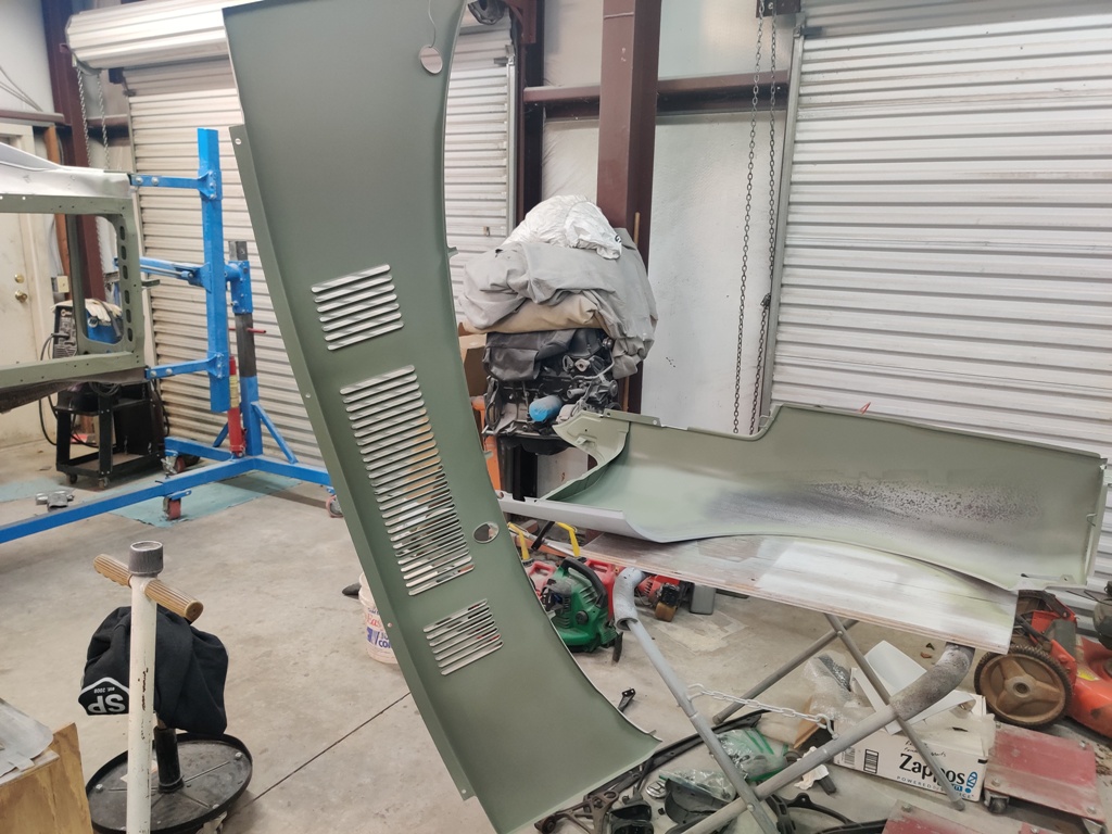

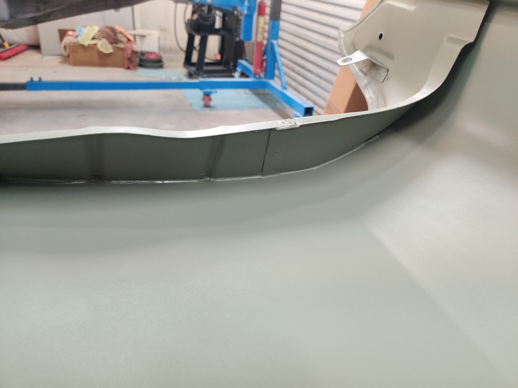

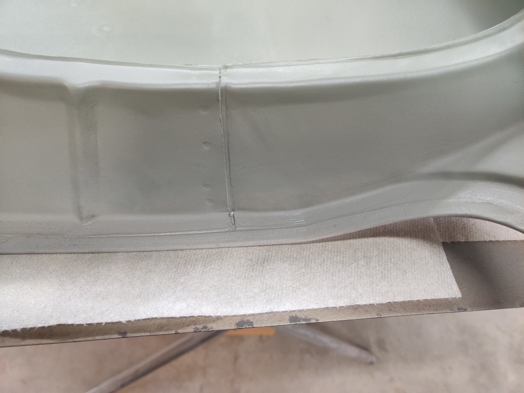

While spraying epoxy primer, I sprayed a few other items including a glass bead blasted tool compartment door (I got the car with one blue and one silver one), the two sand blasted hood hinges, and the insides of the front fenders.  For the fenders, I put seam sealer in some important areas before priming.

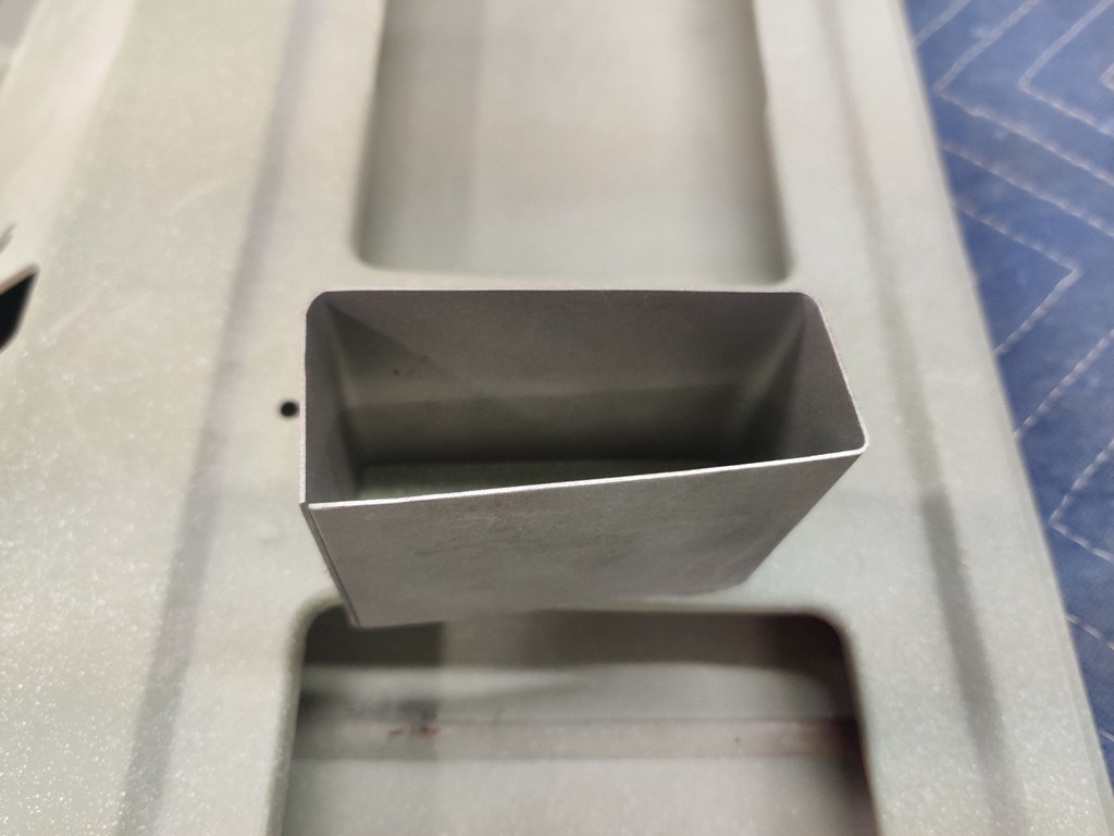

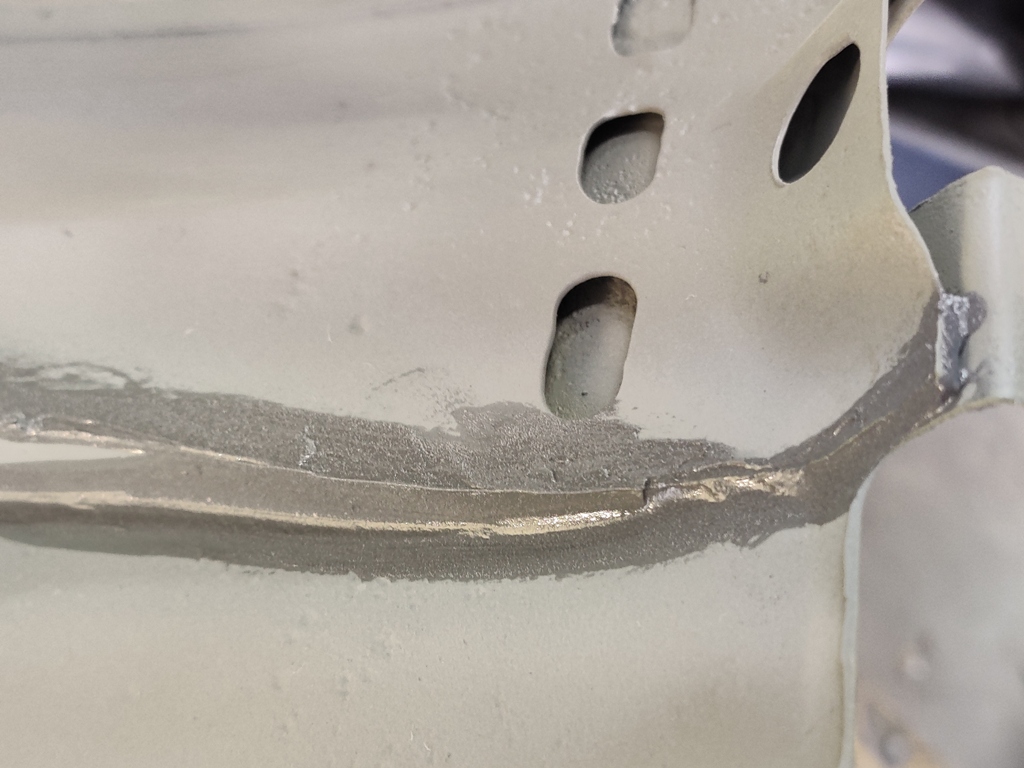

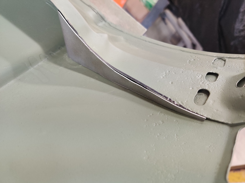

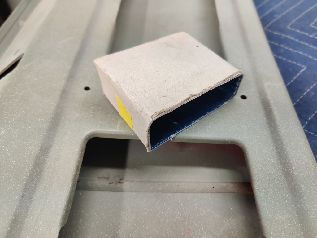

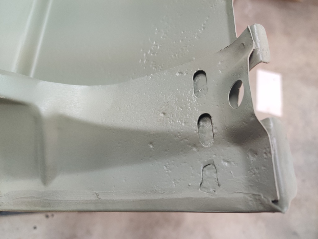

I've been thinking about how best to address one of the most common rust out areas on our cars, the bottom corner of the front fender.  There is a reinforcement panel which is crimped into the back edge of the fender, and where it twists at the bottom of the fender, it creates a trap for dirt and debris which over time, collects in the bottom rear corner.  The debris which gets trapped here allows no air circulation so it holds moisture for extended periods of time, over and over again.  Eventually, bare metal gets exposed and rust starts.
Initially, I thought I would address this problem area by cutting some oval vents to allow additional drainage from this corner, and additional air circulation for drying.  However, I think that would only be a slight improvement.  Instead, I now have in mind fabricating a small metal panel which will seal off this area completely, and therefore, not allowing any dirt or debris or moisture to collect in the corner at all.  Here is a cardboard mock up:
I will extend the actual metal piece I fabricate a little further down than this cardboard template, so that the gap is closed.  I may pop rivet this piece on using the little tabs.  Once secured, I will use seam sealer to seal all the gaps.  Of course, I now need to do something to seal up the oval holes that I cut into the reinforcement panel, or water and debris will enter there and I will still have the same problem for the bottom inch or so of the fender corner.
Edited by inline6
Interesting idea, I would tack weld the entire piece in place in addition to the seam sealer, aluminum or even SS rivets will corrode at some point. The oval breather holes I would leave open, they are very close to the body in that area. Maybe some oil treatment or cavity wax after the final paint job.

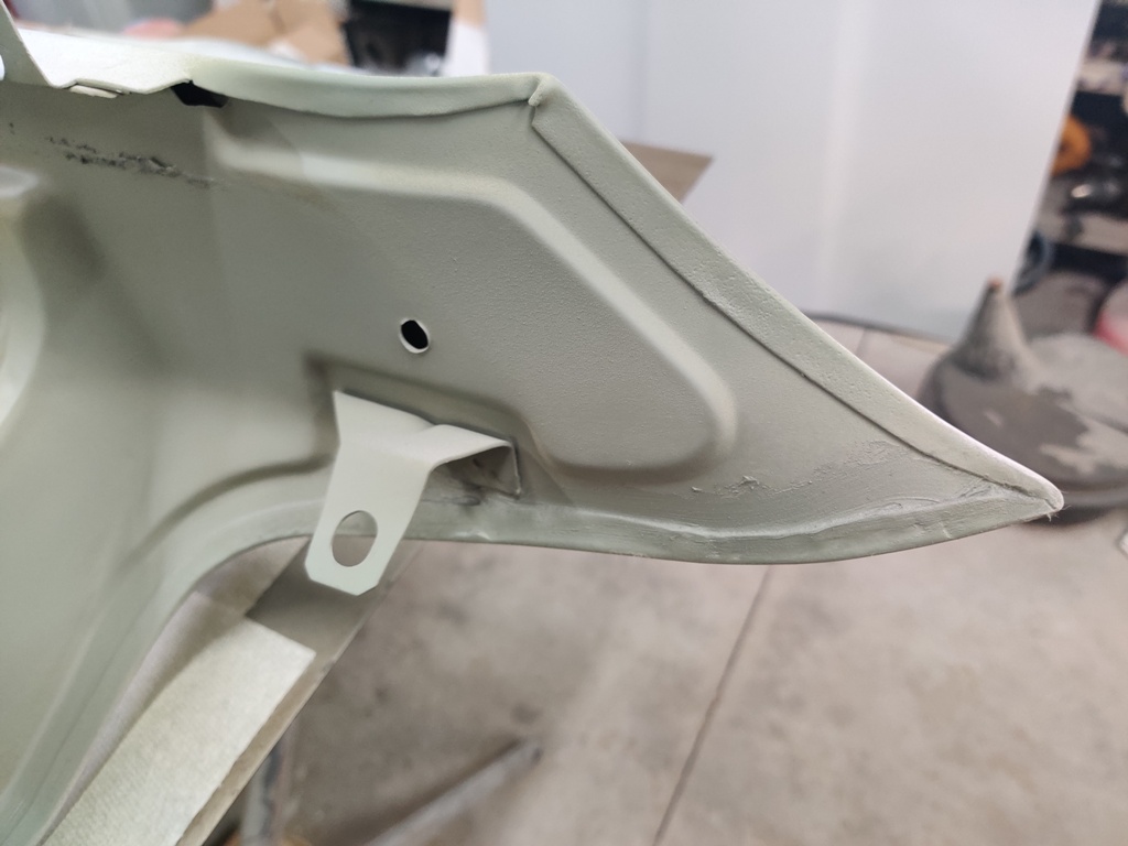

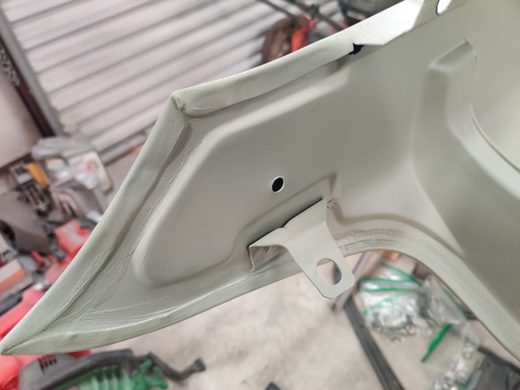

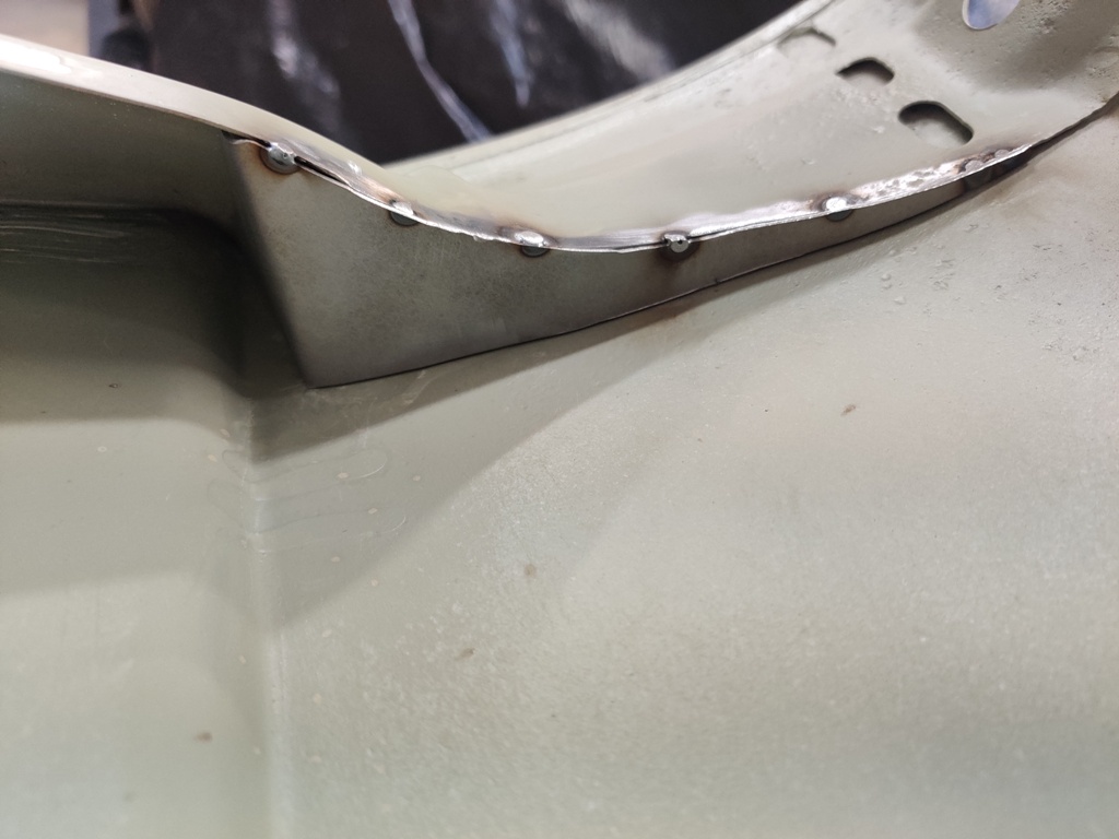

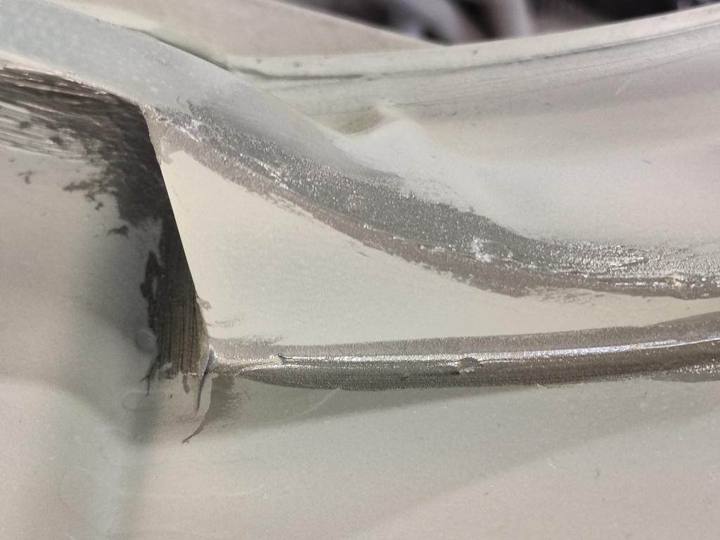

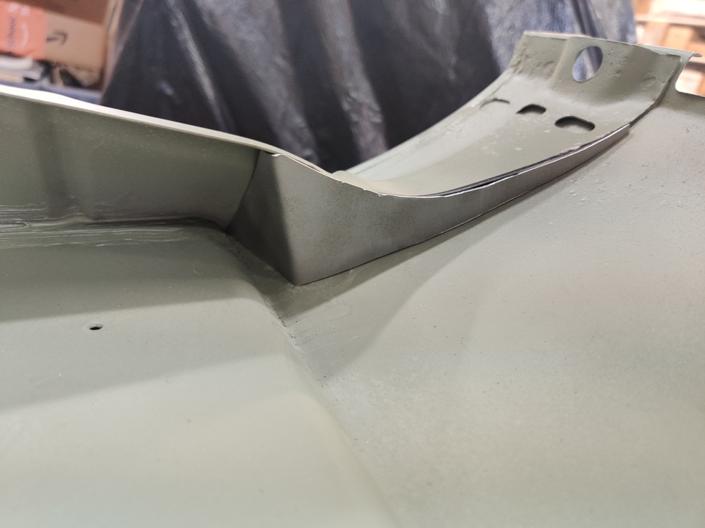

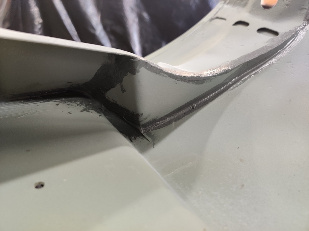

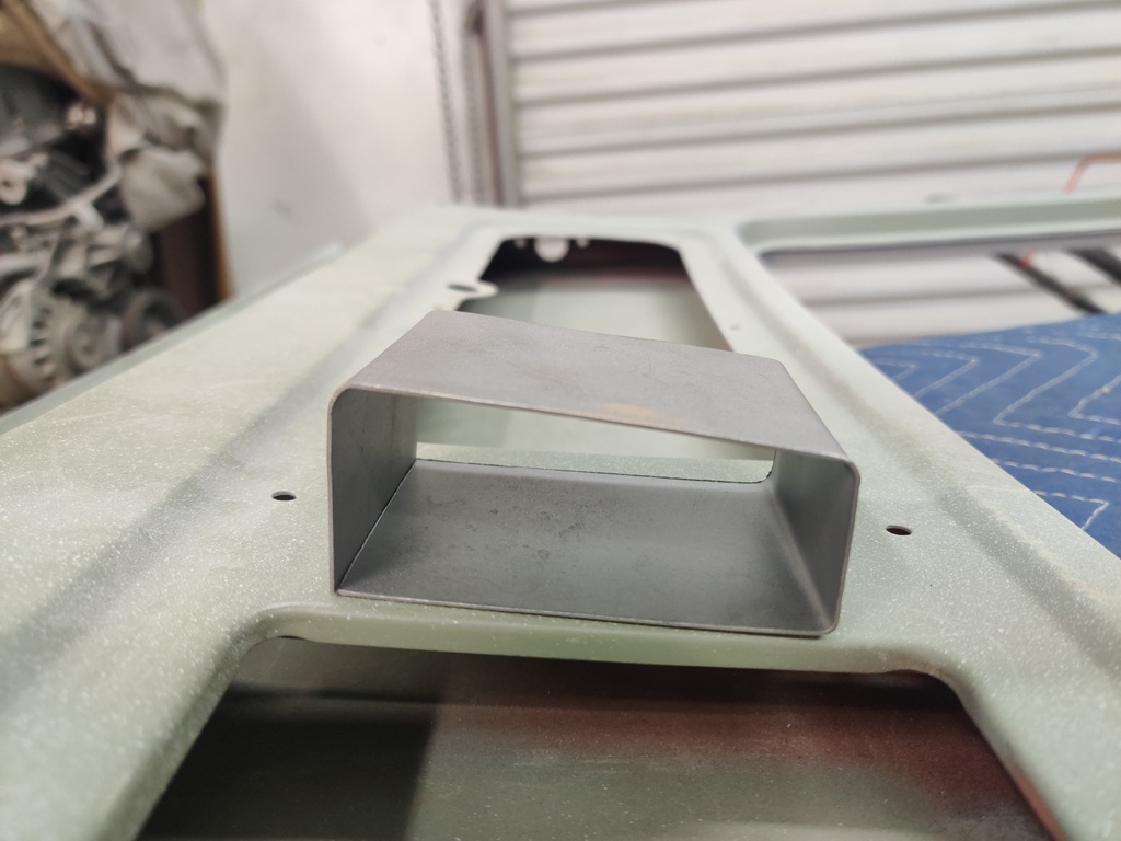

I was able to fabricate these for both fenders today.  This metal piece is easy to fabricate as it only has one bend.  I decided to tack weld it to the support instead of using pop rivets - thanks grannyknot for the suggestion.  I did not tack it anywhere else though, as the body work is nearly finalized and I am not interested in deforming the outside surface of the fender.  Hopefully, the addition of this piece does not cause a change in the shape of the panel when it is bolted in place. It might.  And more time on bodywork will be the result if it did.  After tacking, I used a hand-held belt sander to clean up the edge and then applied seam sealer.
Now, any water coming inside the fender will run down the inside and be directed away from this corner by the shelf of this panel.

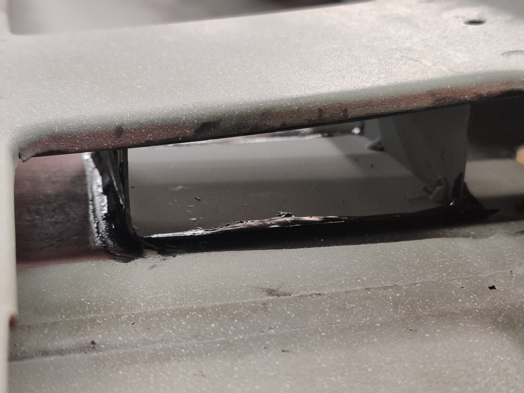

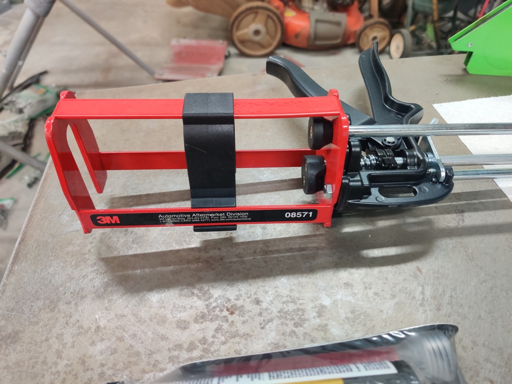

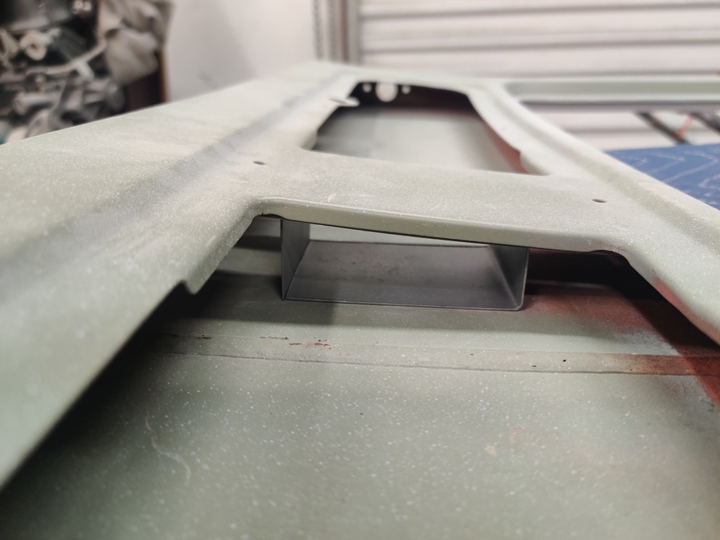

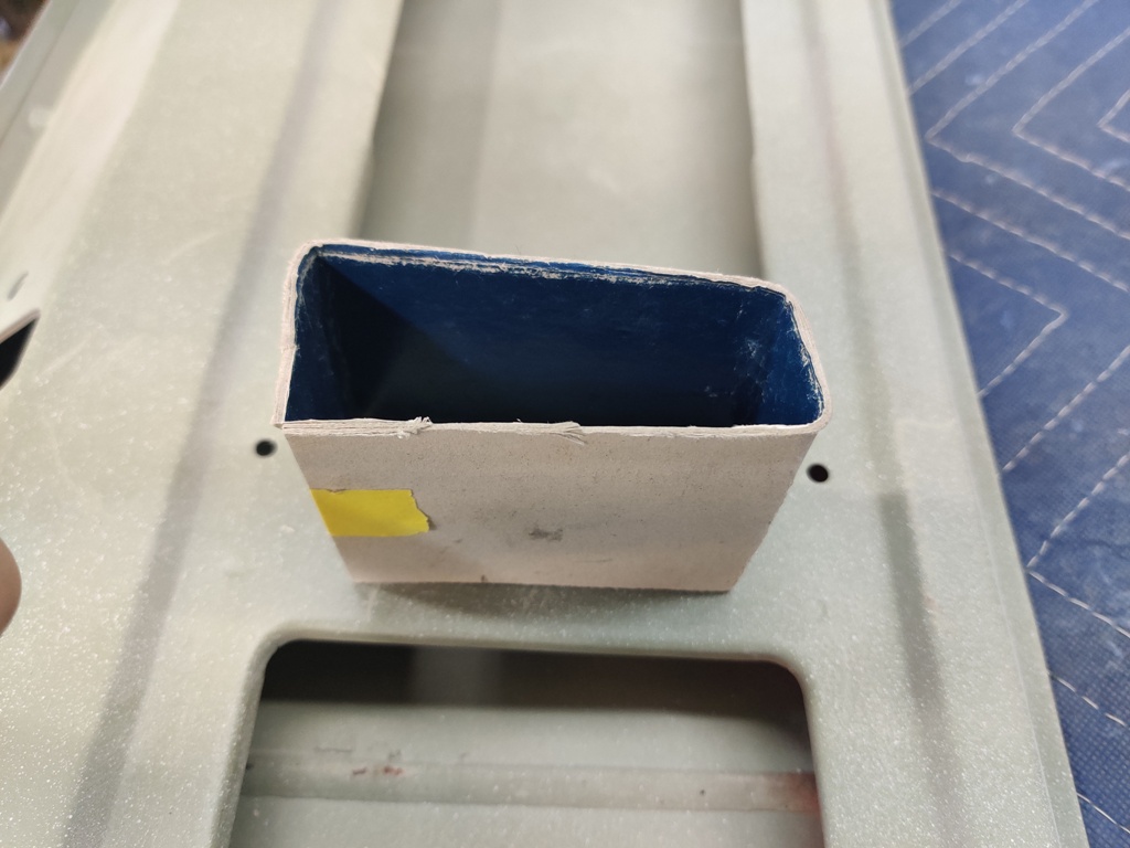

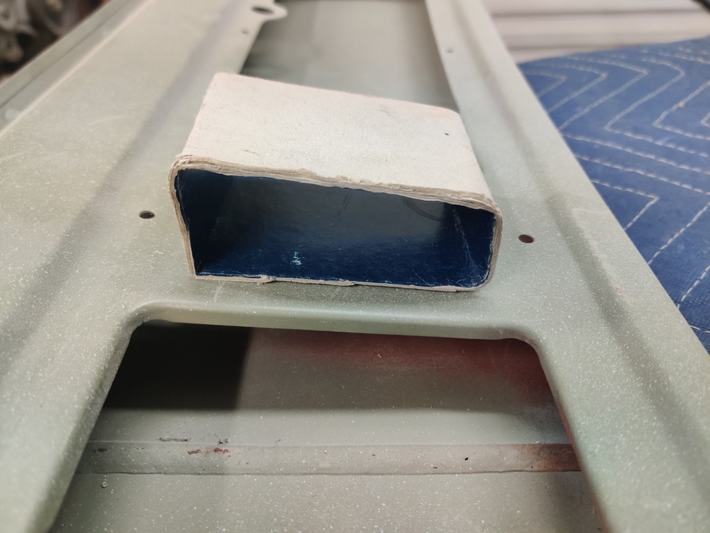

Pictures after using the panel bond.  I sprayed the non-bonded surfaces with zinc primer before I bonded the bracket to the outer and inner hatch panels.
