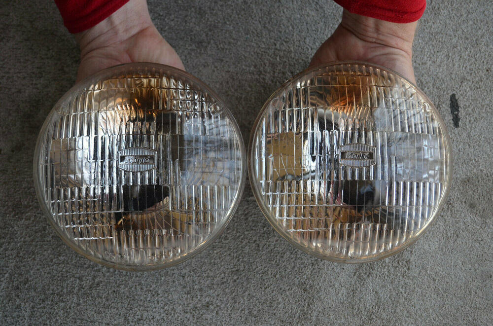

I think I found some Koito headlights like the original ones that came on the car new.  I went ahead and bought them.  I was using this very original 280Z on Bring a Trailer as a reference:  https://bringatrailer.com/listing/1978-datsun-280z-108/
Here are the ones I bought - these sealed beam bulbs look the same:

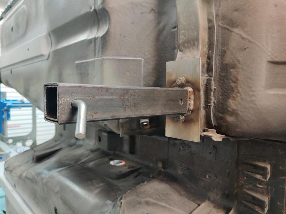

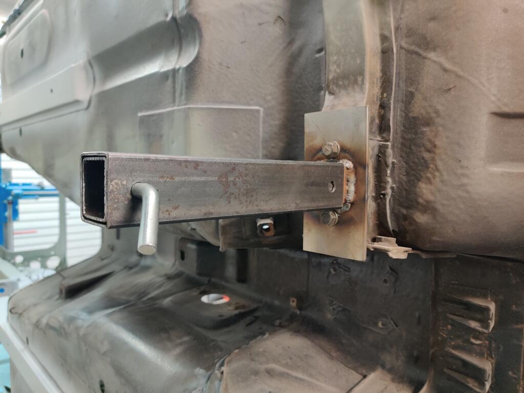

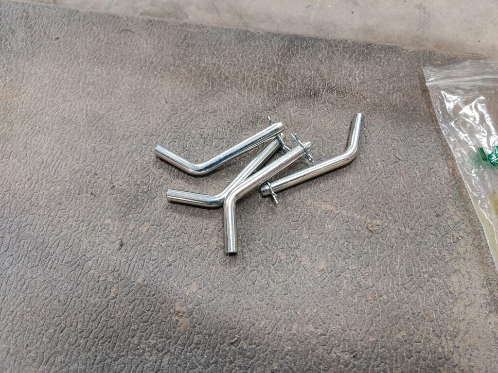

I started a little project to build some frames with wheels assemblies that will allow me to roll the car around easily when it I take it off the rotisserie.  Here are a few pics.

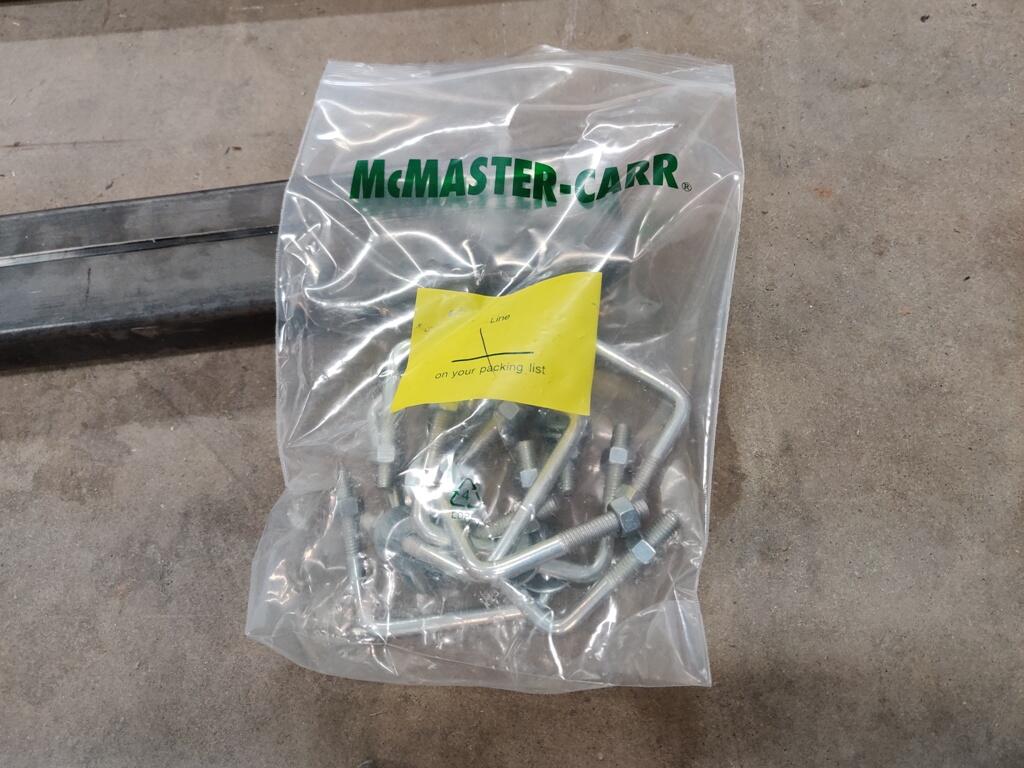

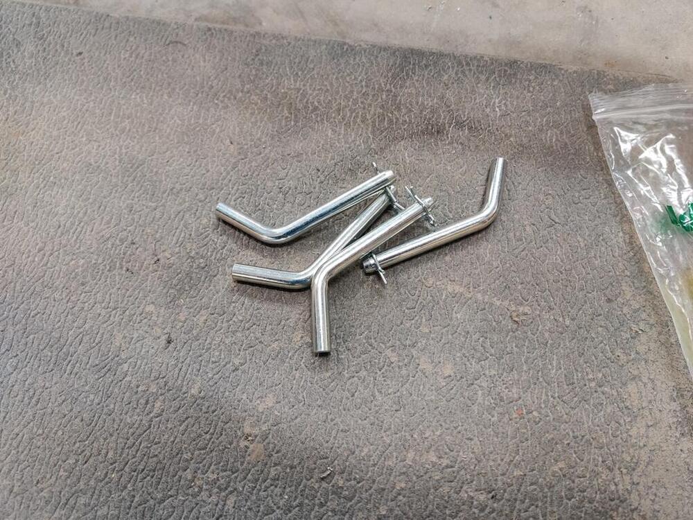

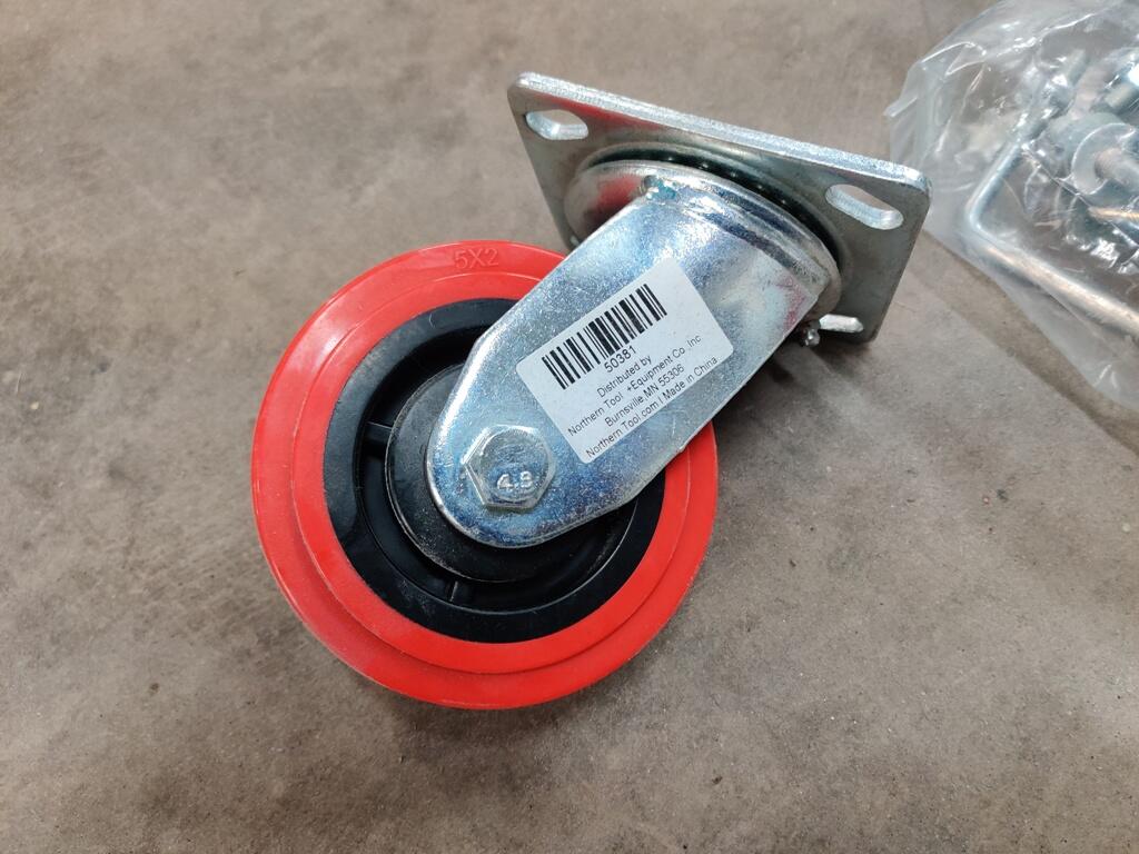

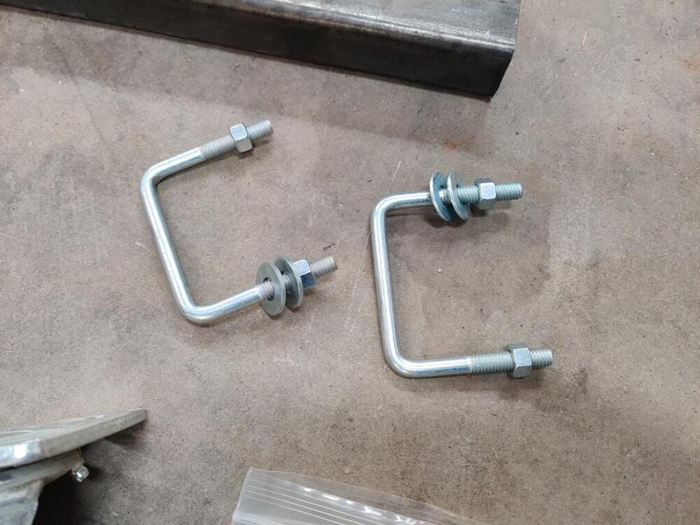

Rather than make a body cart, I am going to try to get away with just two assemblies, one for the front and one for the rear.  The front will attach to the front crossmember support bolt holes on the frame of the car.  The rear will attach to the inner control arm pivot areas on the car.  I am also making it so that it has two height positions.  I found some square tubes and rectangular box sections (scraps) at a local metal supply place.  The rectangular box sections are about 55" long and 3" X 1.5".  I sourced U bolts with 3" inside spacing to secure the caster wheels.  U bolts and some pins for setting the height were sourced from McMaster Carr.  I got the wheels from Northern Hydraulic.

6 minutes ago, Patcon said:
I would want to tie them together with a bar or two, front to back. I would be afraid of tweaking the body mounts if one frame doesn't roll for some reason
Yes. I was looking at it and something wasnt sitting right with what I was seeing.
Nailed it.
Hmmm.  Maybe I should do that.  I'm not ready to use these, won't be for a while longer.  I'll have to look for suitable "drops" at my local metal store.  Those are the leftover bits that they sell for a single rate by weight.
