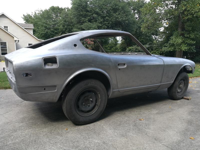

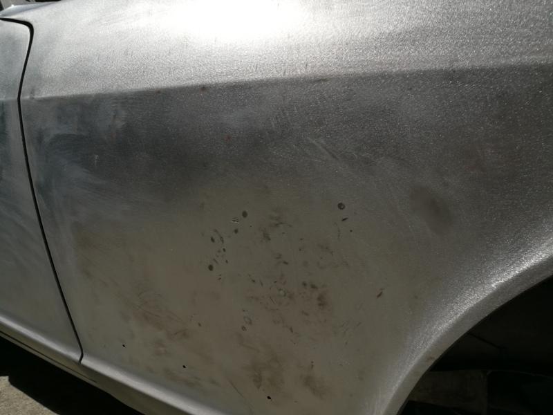

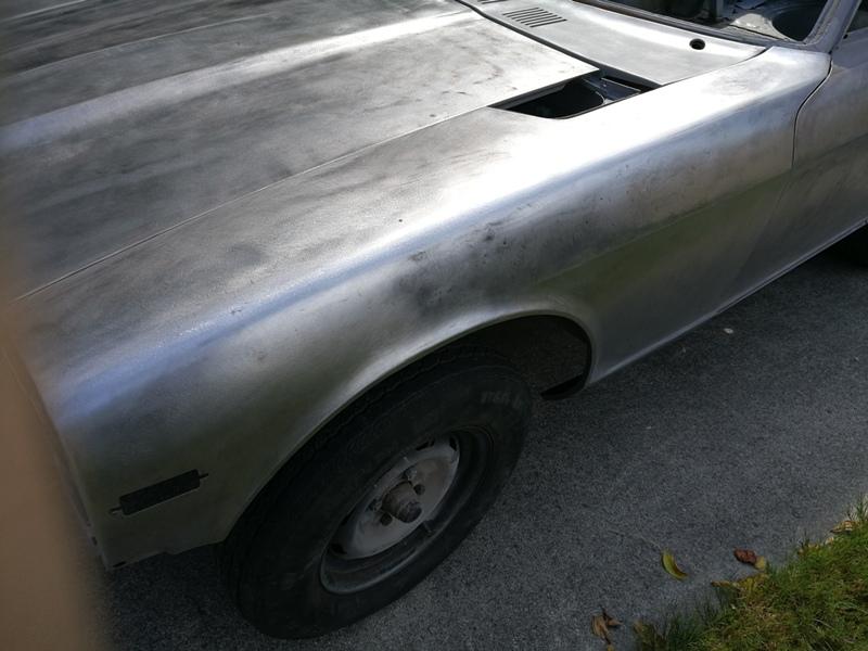

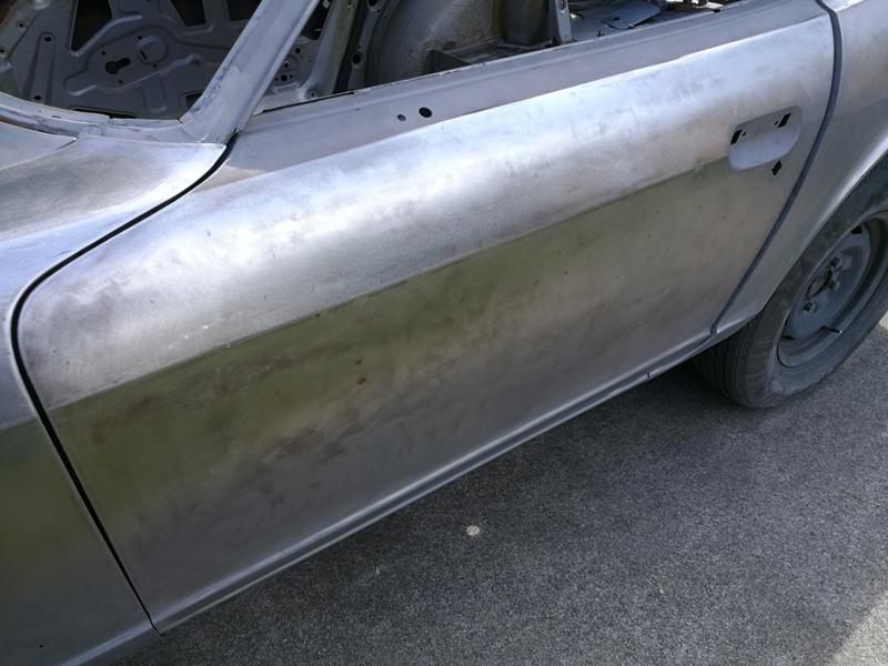

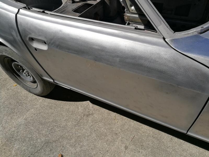

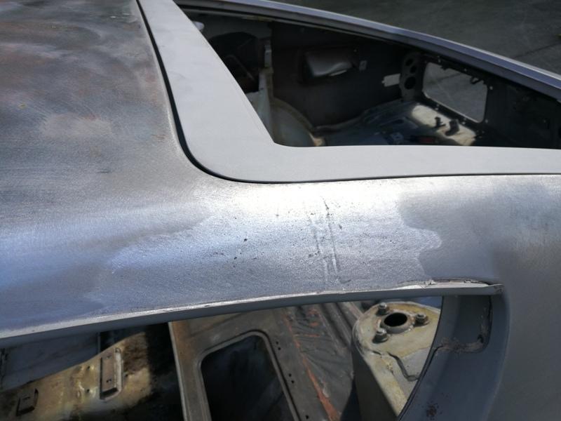

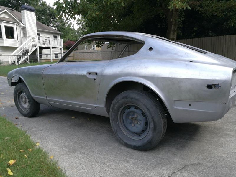

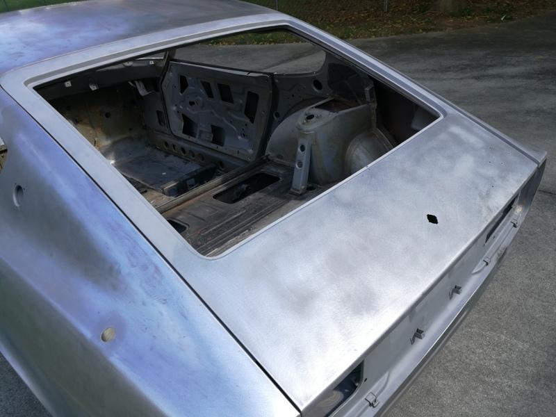

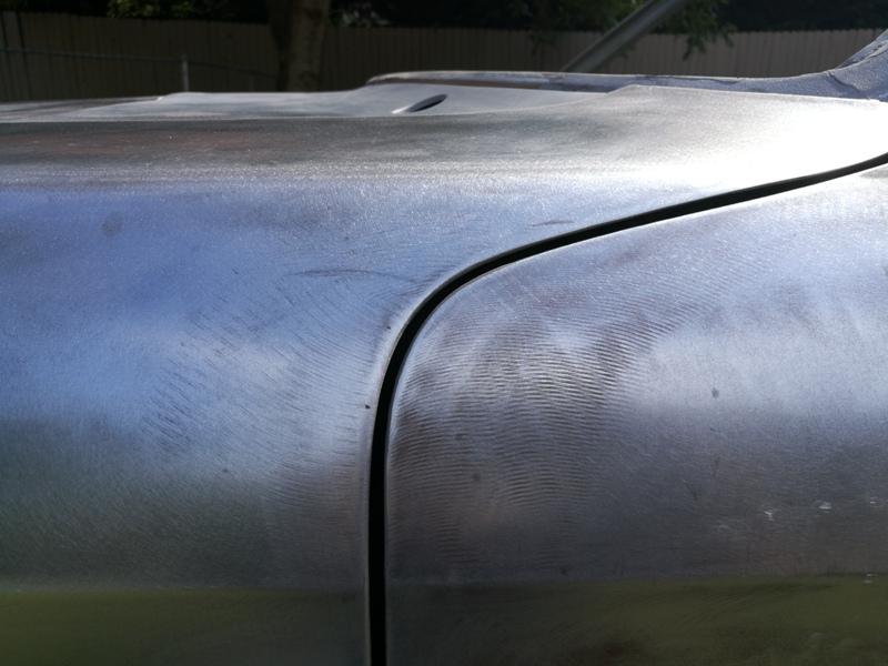

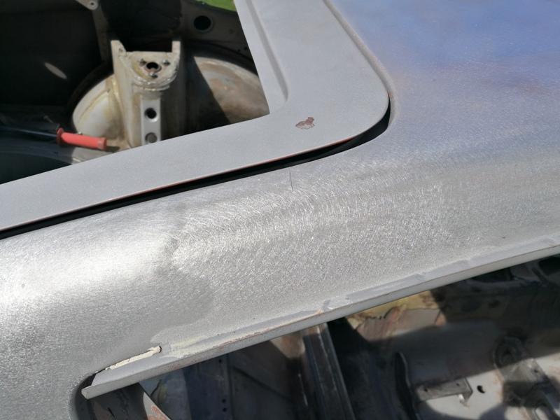

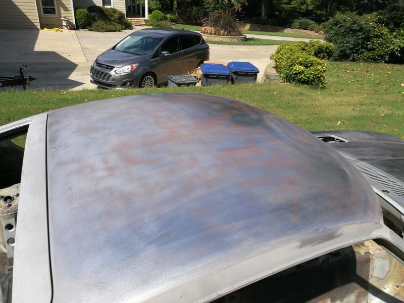

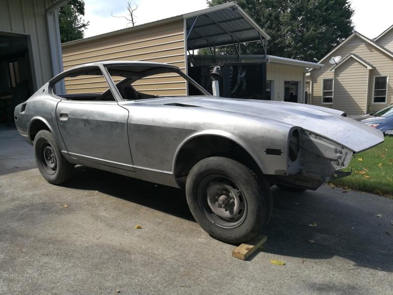

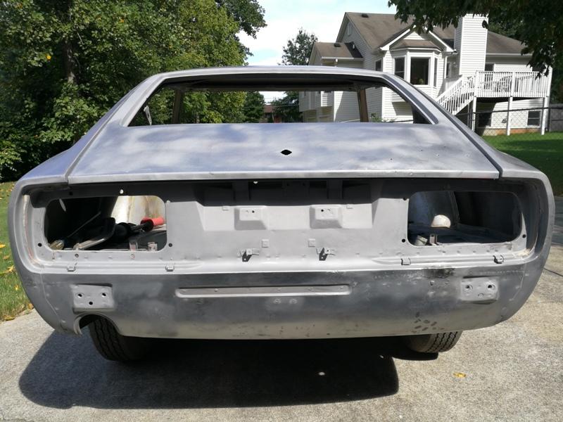

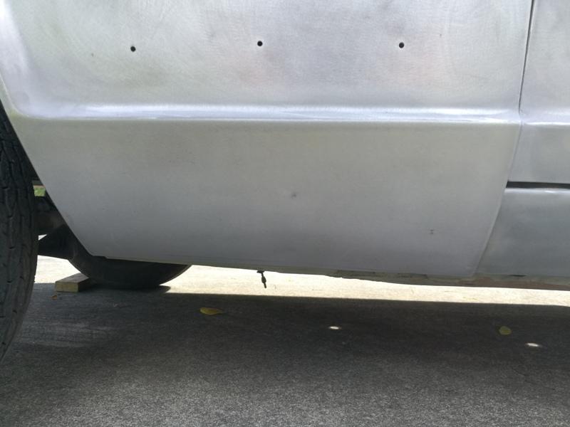

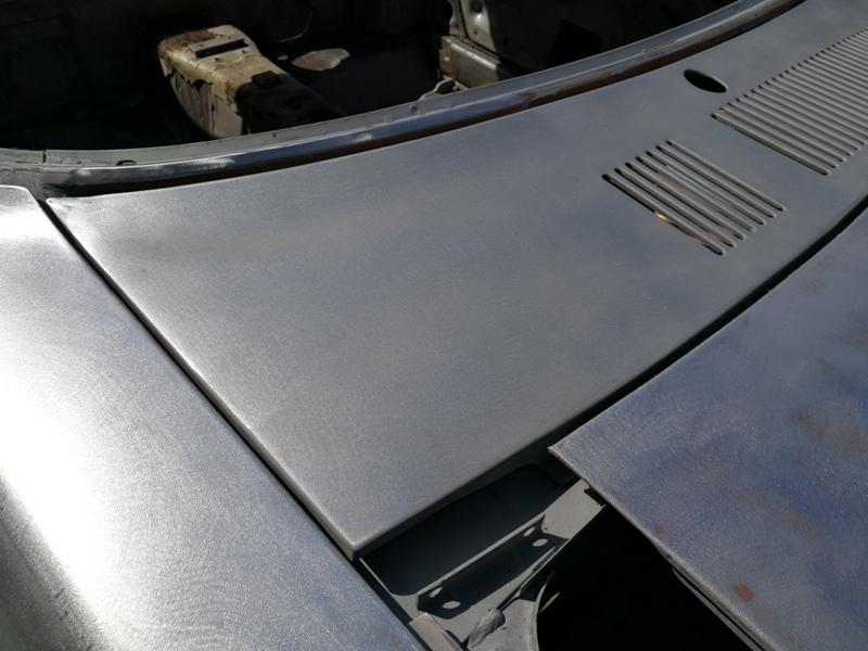

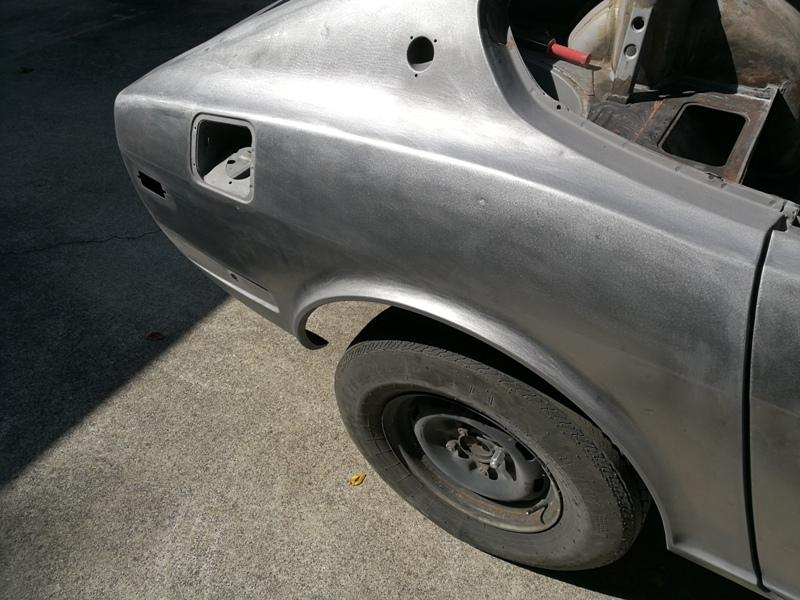

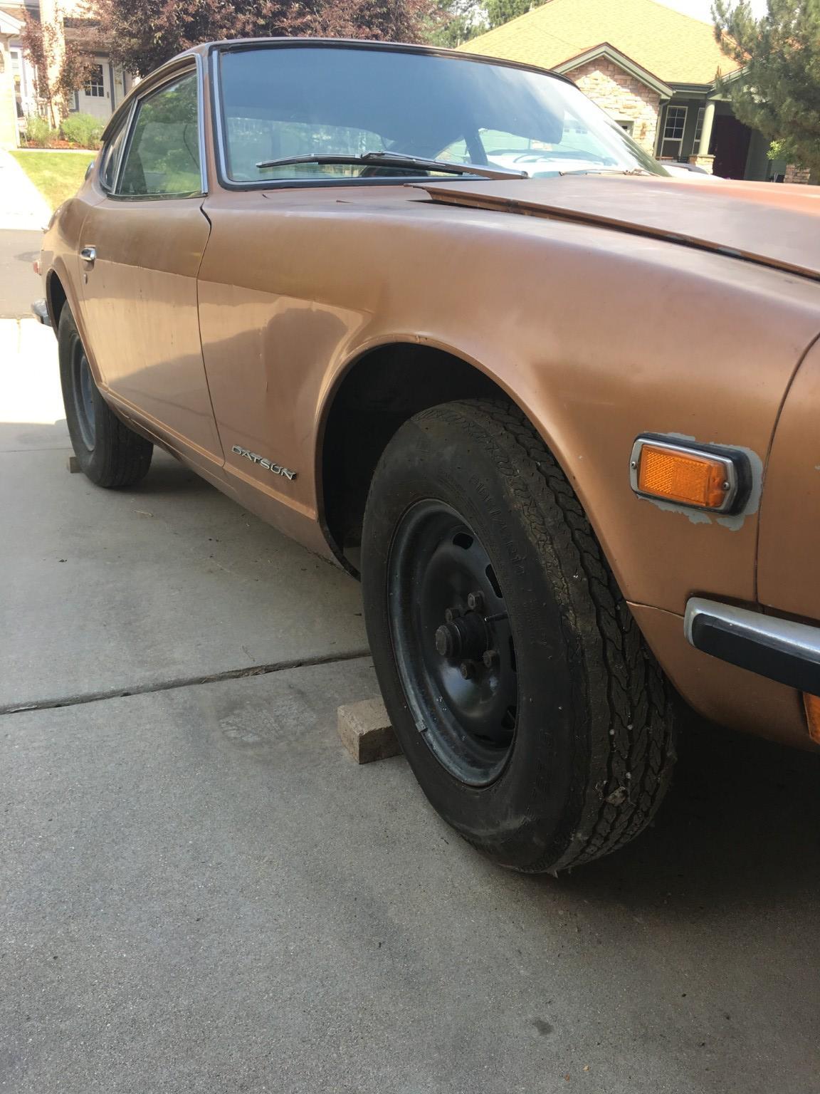

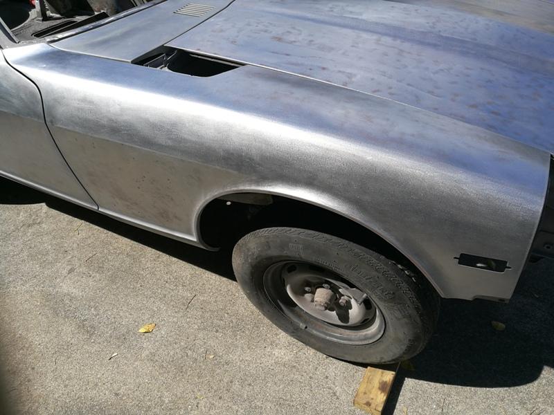

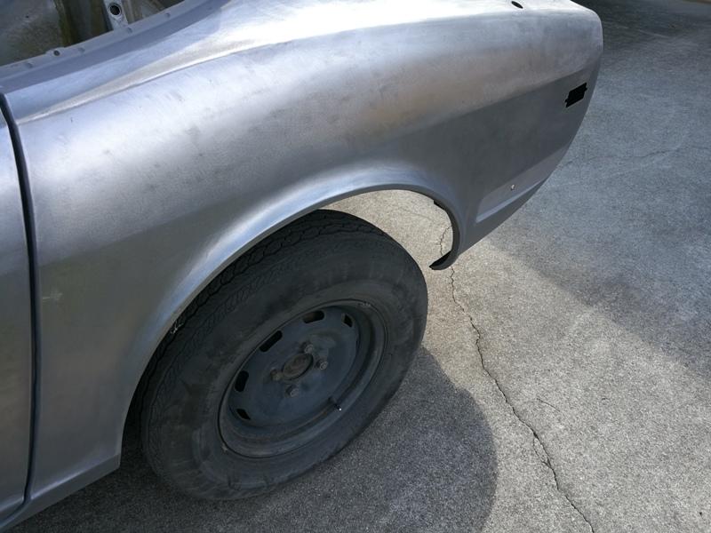

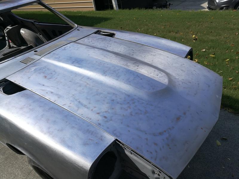

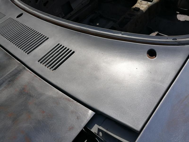

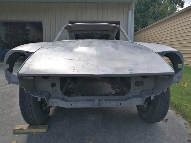

The car with most of the exterior stripping and metal work complete.  The hood got some more work after this pic which can be seen in pics I already shared.  The tail light panel and rear apron received a lot of hours because of the light tap that the car took at some point in its life.  Also, the front passenger side fender was damaged as you can see in the bring a trailer pic at the bottom of these:

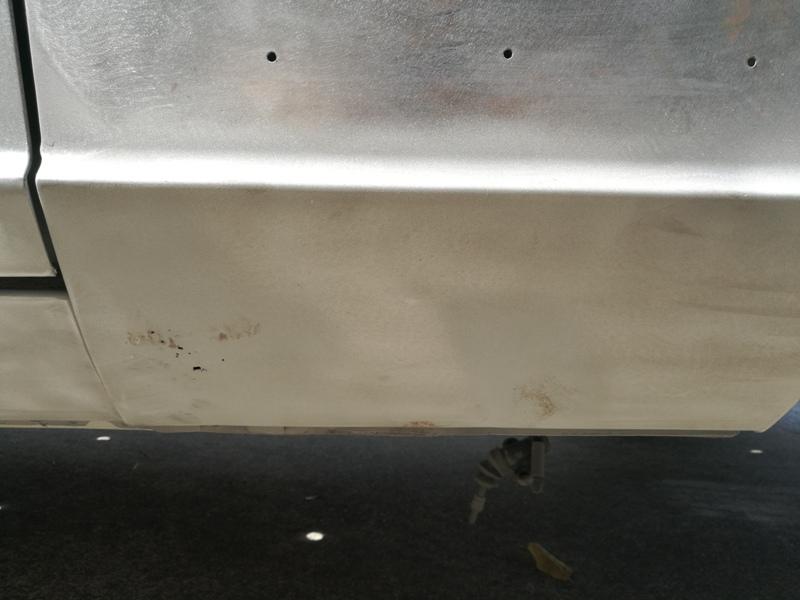

Some rust through on the lower corner of passenger fender.  Also more metal work to be done on fender (middle pic)  Shrinking and stretching was necessary to get this area in good enough shape to require only a skim coat of bondo.
