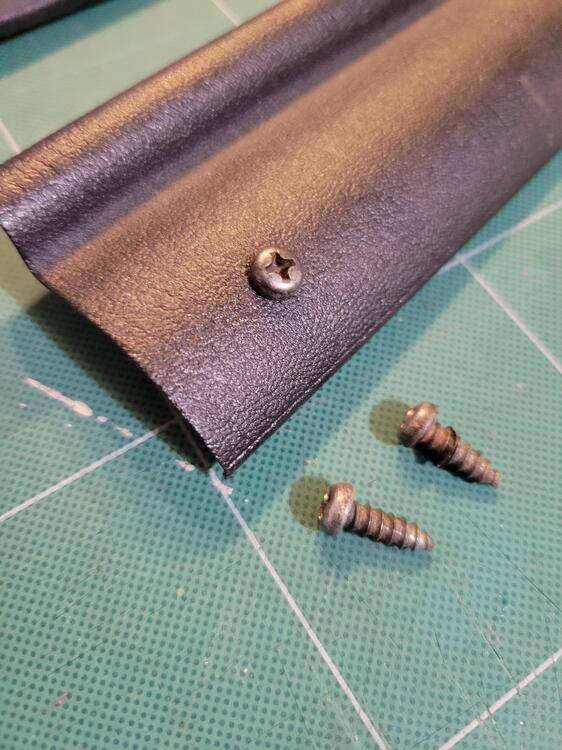

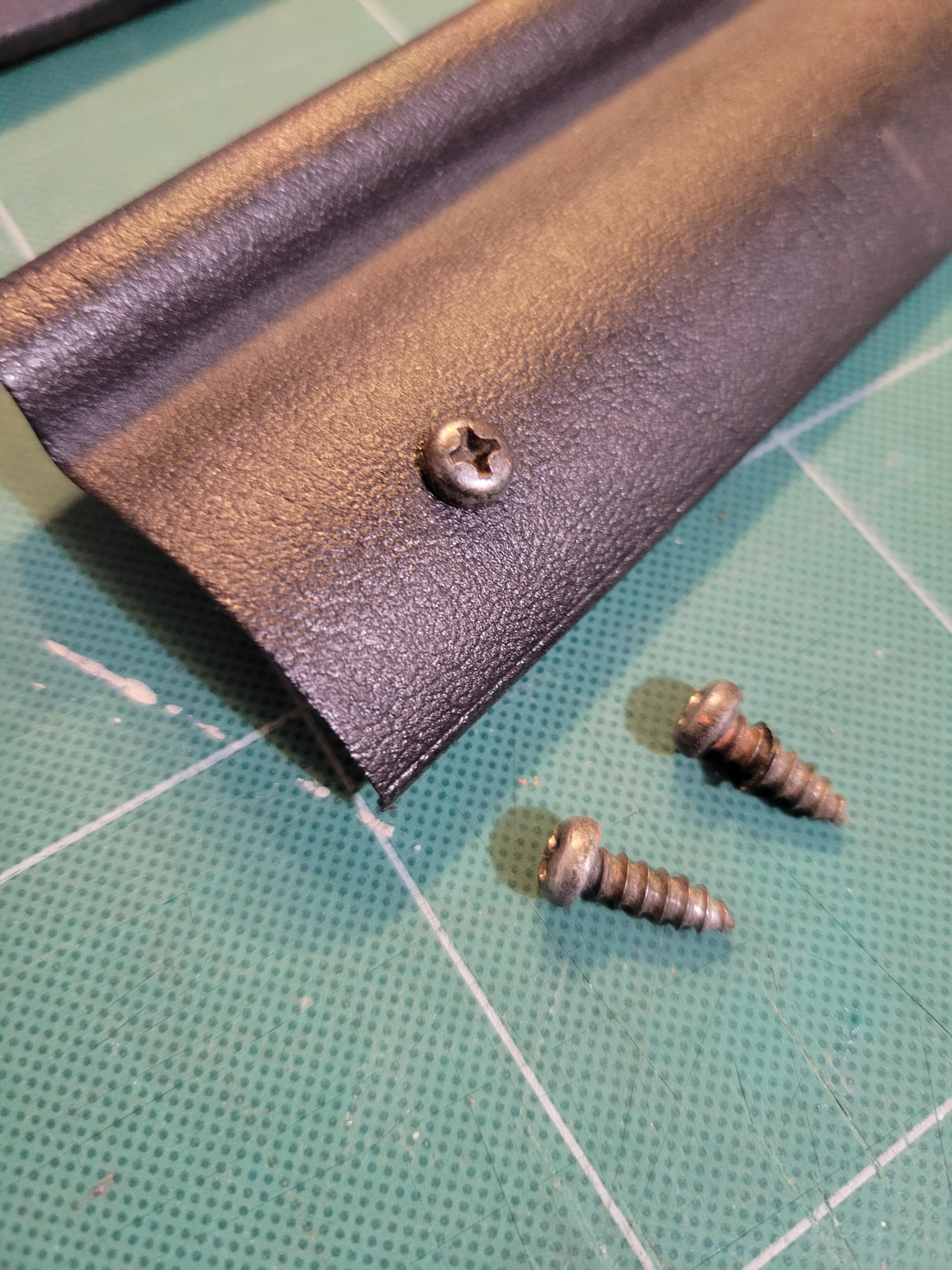

1 hour ago, CanTechZ said:
Here's a picture of the screws that held down those strips on my '70. They are round head type 4mm thread OD x 12 mm long. There appear to maybe have had blackened heads, some evidence on a few of mine.
Same screws on mine as well.
