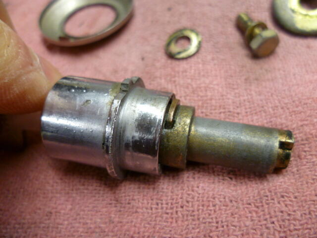

As @Captain Obvious said, the hatch lock is the easiest when compared to the door and ignition locks.  To get it apart, you just have to straighten the 3 little tabs on the backside of the stainless trim ring.  The trim ring (1) then releases from the lock case, and you can take out the tumbler assembly (2) with the sleeve (3) still on it.  To remove the sleeve, you just have to depress one of the "wafers".  Then (2) slides out of the sleeve (3).  You can then swap out the wafers to match your key.
The ignition key and the door locks are more difficult to take apart and put back together.  The keying kits I bought off of eBay had replacement stainless steel covers for the door locks.

Wow, thanks for the detailed pictures and instructions! This was the part I couldnt figure out:
To remove the sleeve, you just have to depress one of the "wafers".  Then (2) slides out of the sleeve (3). "
I am going to give it another try, as mine is pretty beat up.

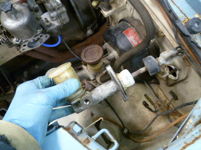

 I also included a pic of the master cylinders.
My little eye spies the wrong clutch master cylinder.   LOL   It's a Nabco, but it's the new style. You guys are all gonna regret me seeing an early car with my own two eyes. Hahaha!!
You need one of these.  Maybe not quite as crusty, but this style:

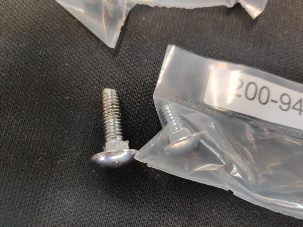

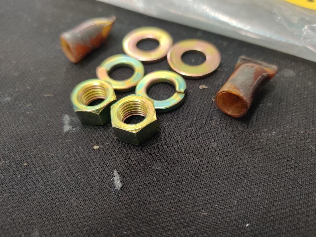

I finally painted the radiator.  So, I was able to install it today.  Is this the correct orientation of the hardware - just the bolt on the front side, and the flat washer, locking washer and nut on the inside?  Oddly, the flange on the side brackets of the radiator basically touches the insides of the frame rails.

All three of the radiators I have in my possession have this flange on the inside surface of the radiator.  It appears to be for mounting a fan shroud, though I don't believe US cars had them as original equipment.

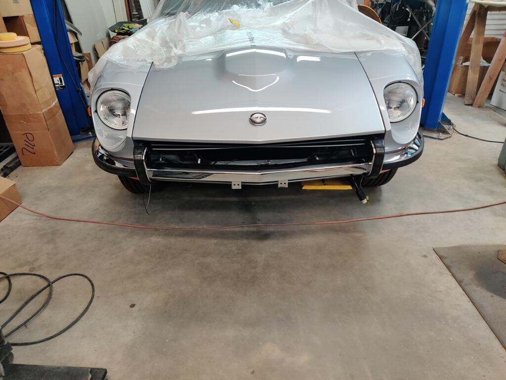

Today, the bumpers arrived back from Tri-City Plating.

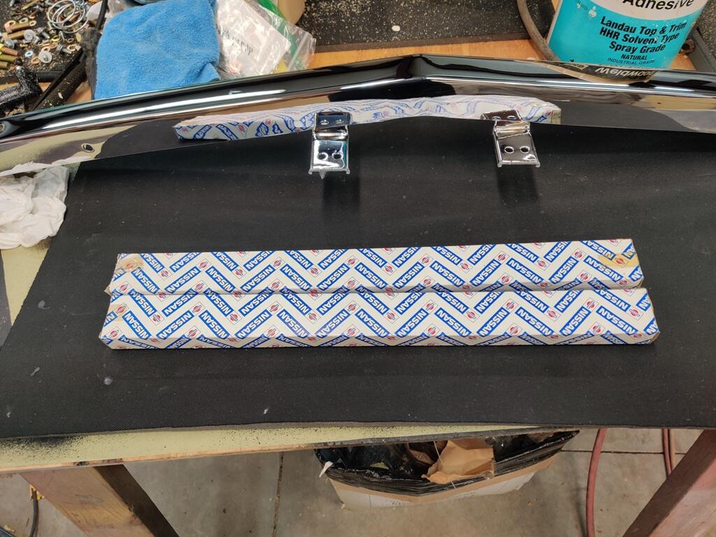

I spent some time putting the front one one together with some NOS factory rubber:
Mock up:
I am pleased with the results for the most part.

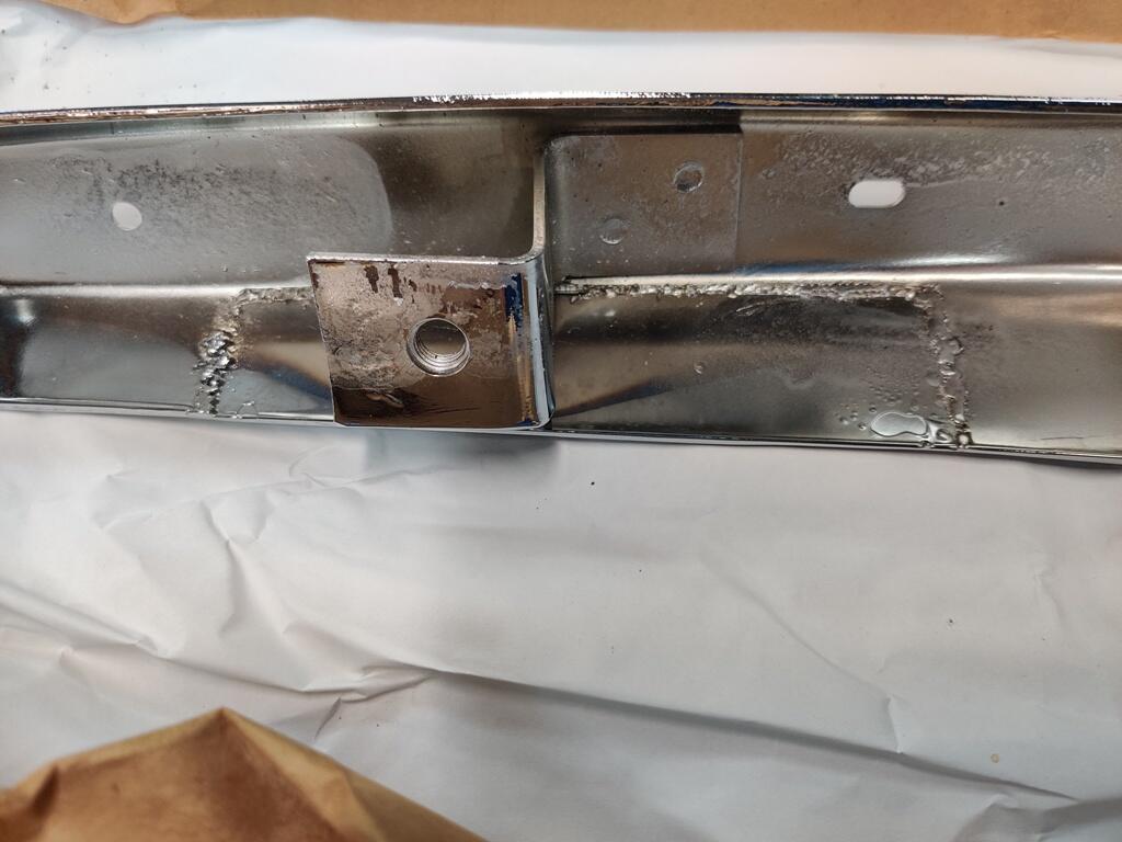

I sent them one front and two rear bumpers, and one set of each, front and rear over riders.  One of the rear bumpers was NOS and one of them was original to this car.  The original one was damaged when the car was hit in the rear.  The center section had a wicked twist in it, along with many dents, some deep scratches, etc.  I spent a lot of hours working on it.  I found that my hydraulic press was handy for some of that work.  I got most of the twist out of it.  And I got it relatively close to the same shape as the new old stock one.
From talking to a few shops, it became clear to me that they have some expertise with straightening bumpers.  So, I decided not to put more of my time into the center section, hoping that with the NOS center section also on hand, they could make the original one match its shape.  That... didn't go well.  I am not pleased with the final shape of it.  I am glad I bought the NOS one and had it re-chromed as well.  I am pleased with the work they did to that one.  They did good work on the front bumper and the front and rear over riders as well.  So, for this car, I have a complete set that are good quality.
Inexplicably, on the NOS rear bumper ends, where I had asked them to fill in these half moon cutouts...
they cut about a 6 inch long section out of one of them and welded in a replacement section to address this issue.
And for the other bumper end, it appears that they stitch welded material into the half moon cut out until they had filled it with... weld.   ???   I will share pictures of that nonsense when I put the rear bumper together and put it on the car.

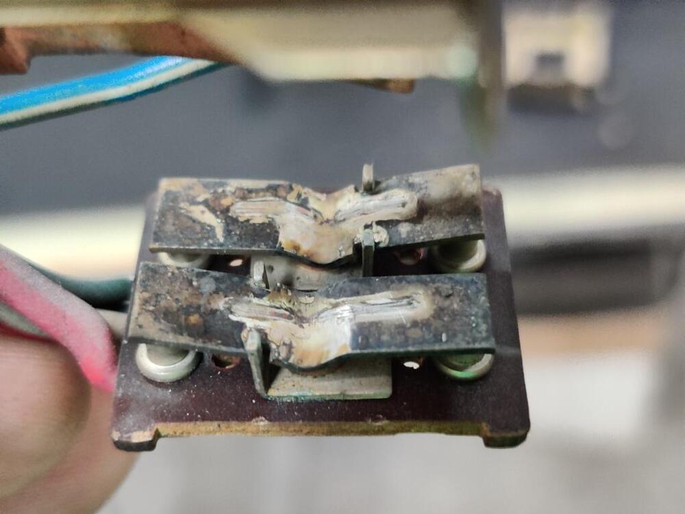

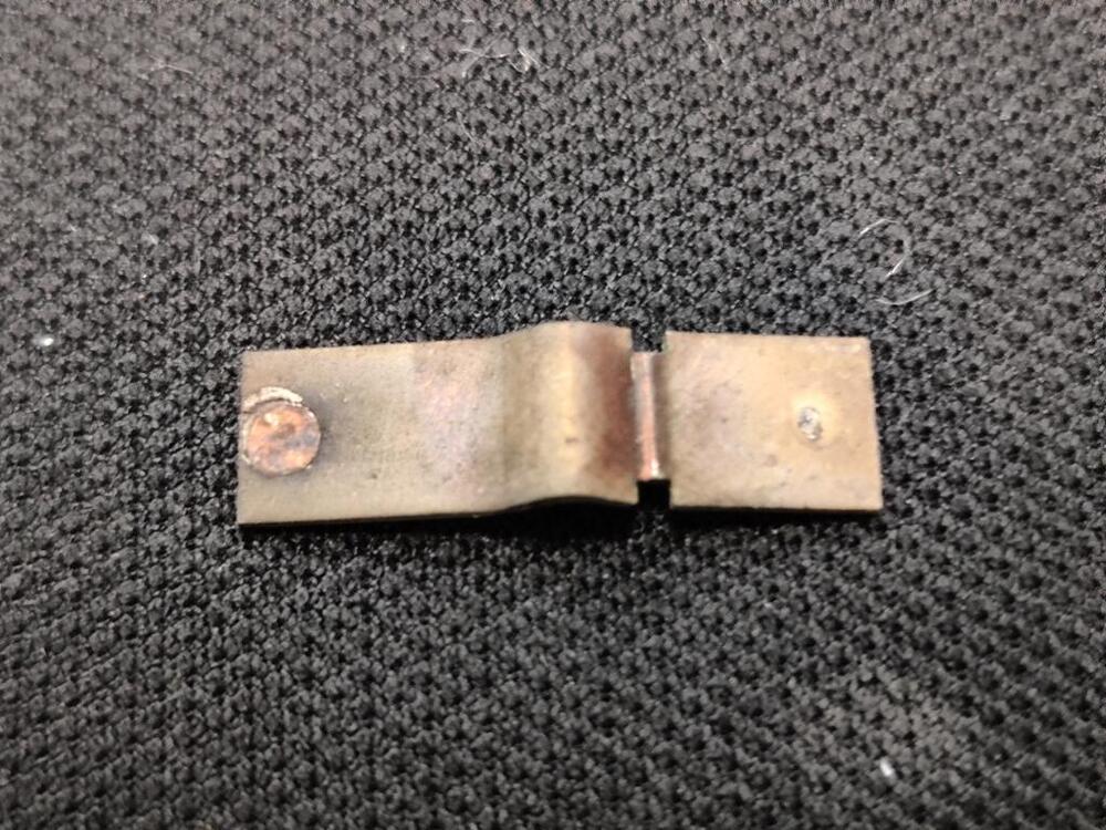

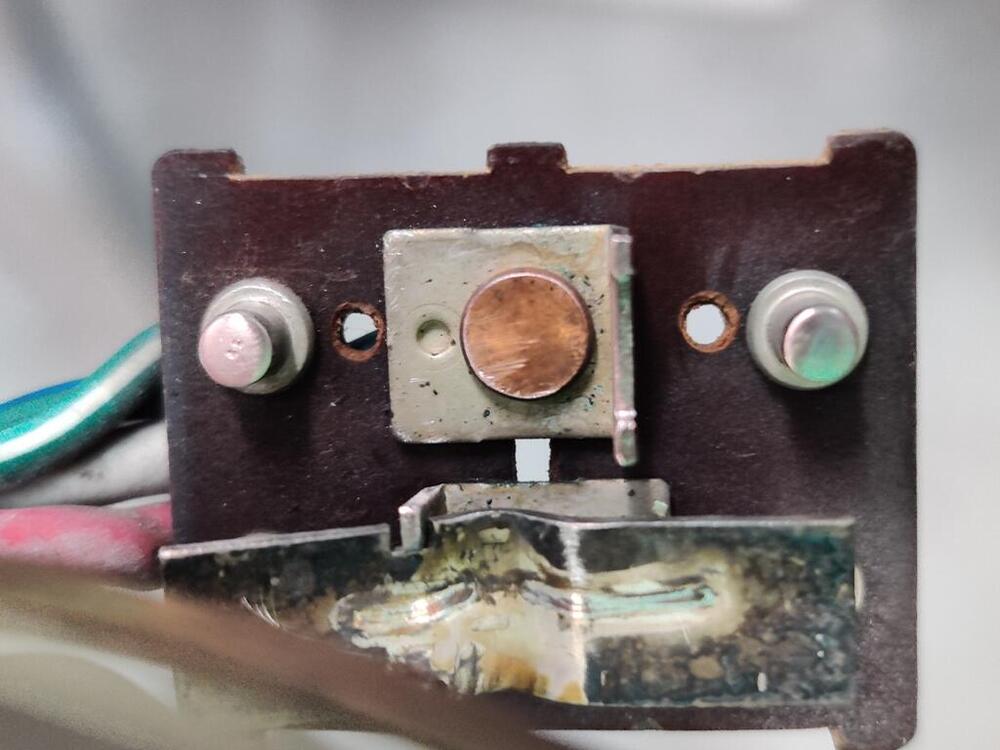

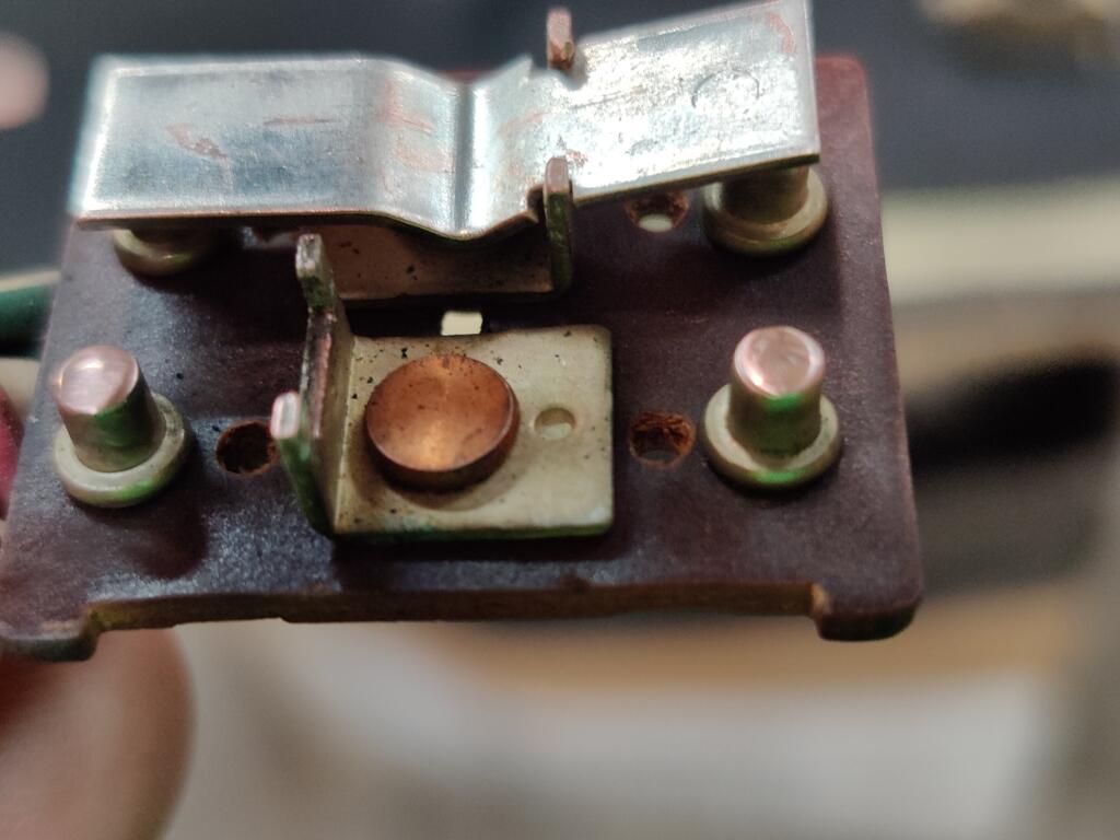

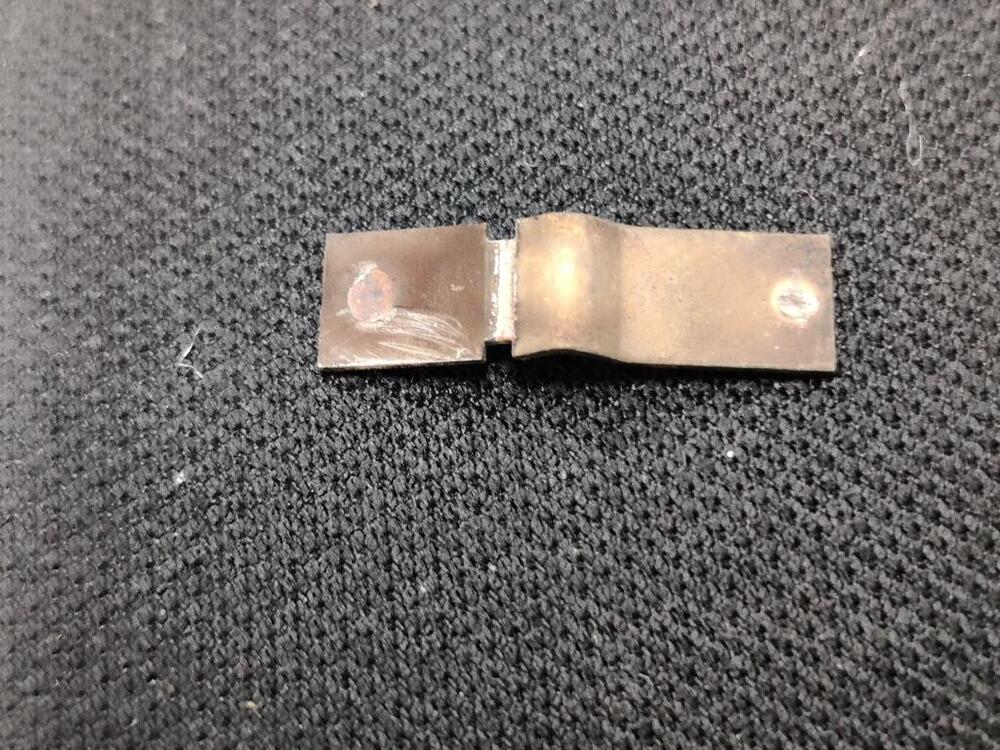

Other work I have done on the car this week included tear down and rebuild of the headlight/wiper steering column switch assembly and the turn signal stalk assembly.  The electrical contacts for the headlight do wear.  As I understand it, there is a high level of current going through the original circuit.  I think tends to make arcing a thing on these contacts.  For each, I removed the fulcrum portion, hit it with 600/1000/1500 sand paper grits and did the same with the "posts" they contact.
Above, just getting started - you can see the depth of the "divot".

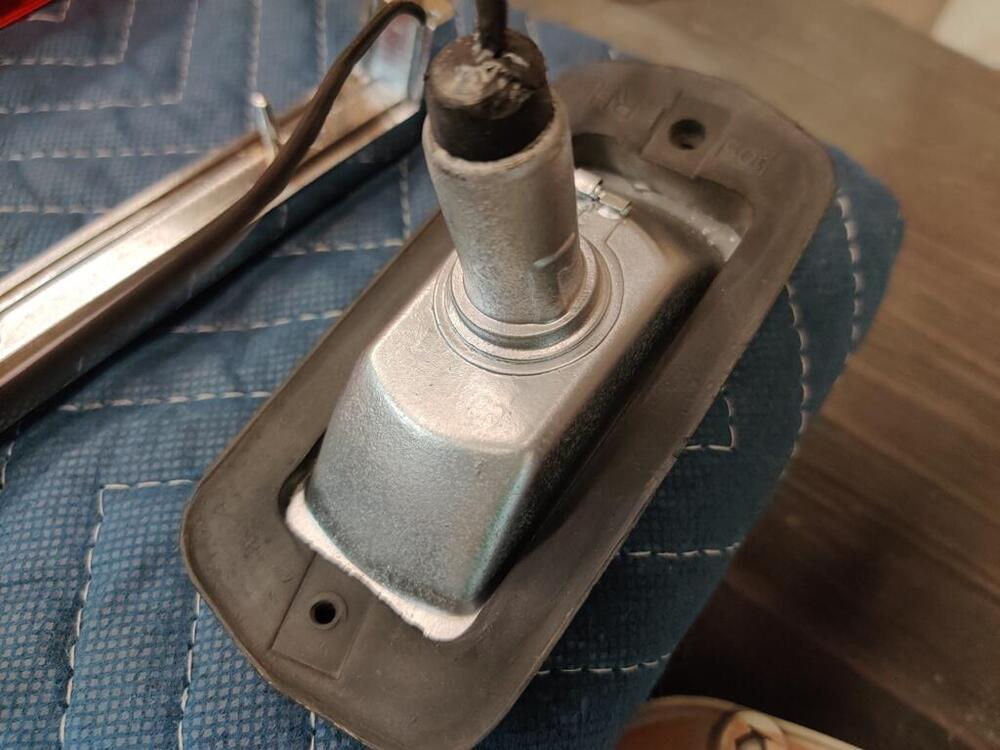

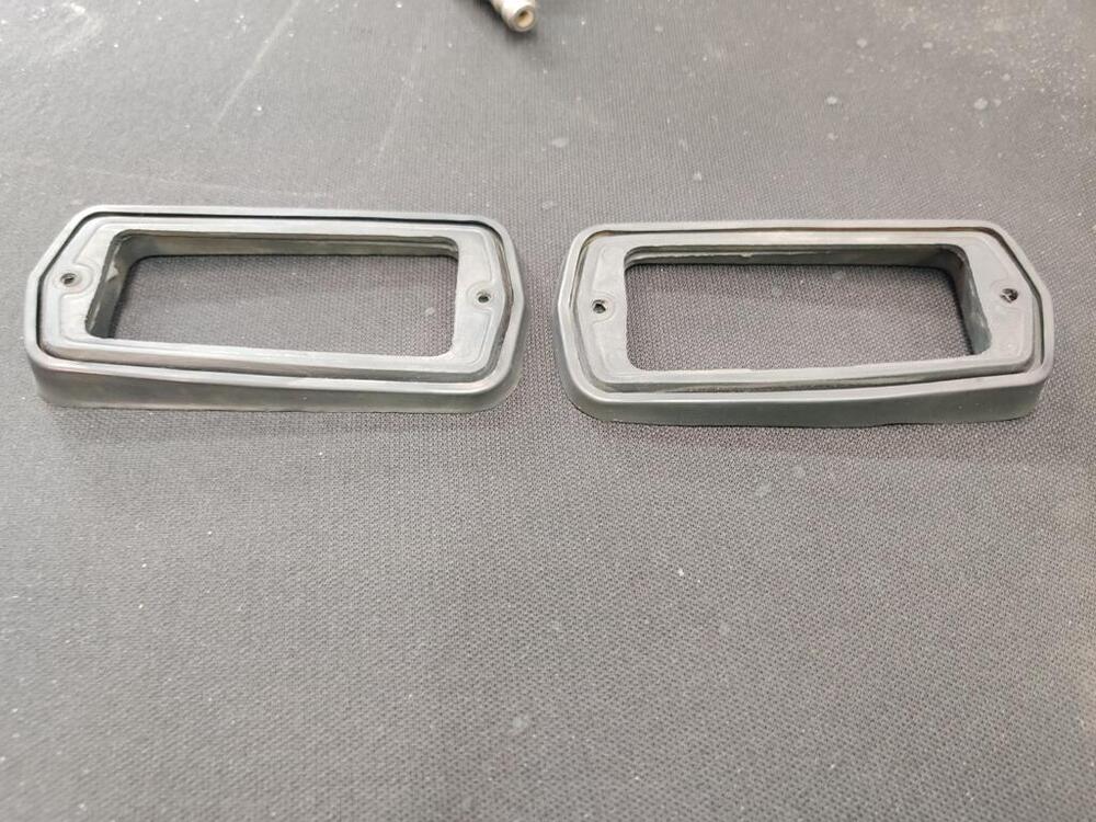

I also took apart all the side marker assemblies this week.  I sanded and polished each plastic lens.  I cleaned each stainless frame, straightened the areas where the screws contact them, and sanded/polished them as necessary to restore luster.  For the front side marker light assemblies, for which, unlike the rear, the backsides are exposed to the elements, I also stole some rubber grommets from Datsun 510 rear side markers that I had on hand.  I used those, as the original rubber seals disintegrated on these front assemblies long ago.  Without these, water comes inside through the bulb socket backside.  I used black silicone to ensure sealing of the transplanted seals here.  And, I lightly glass beaded the backside of the front side market assemblies, primed and painted them silver to protect them from future corrosion.
My preferred method for removing old paint from side marker gaskets is using the glass bead cablnet.

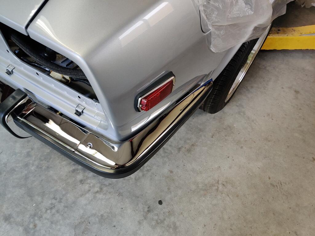

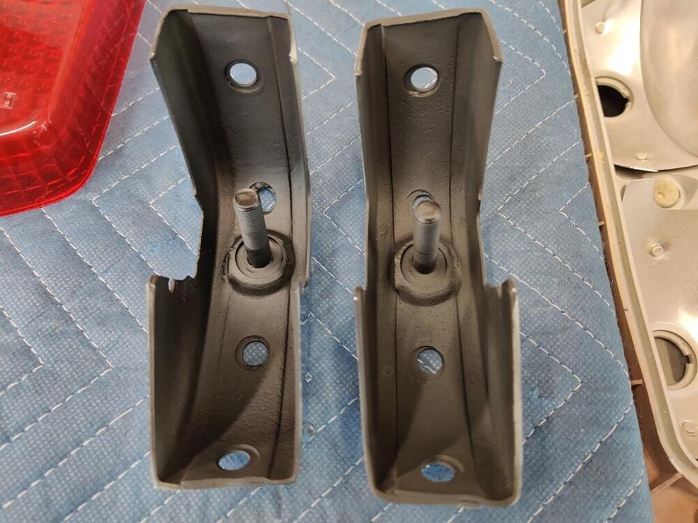

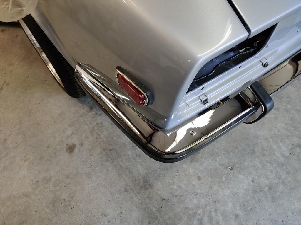

It took a lot of time to get the rear bumper together and on the car.  On the backsides of the bumper ends and over riders, I used primer with zinc in it, and followed with a light layer of black.  The backsides of these pieces were glass bead blasted before I sent them off.  However, there is something about the plating process which causes rust/corrosion.  It was very light, and only in a couple of spots, but I don't want it to be a foothold for more.  So, hopefully the zinc primer and paint will keep further corrosion at bay.  OEM chrome bumper bolts from the Z doctor were shorter than the originals (third pic here).  That said, the originals are much longer than they need to be.  I polished the originals a bit and reused them.
Rubber strips for the over riders are aftermarket - some of the few parts on this car that are not genuine OEM parts.
