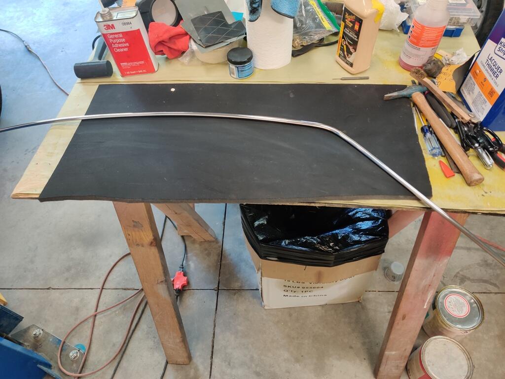

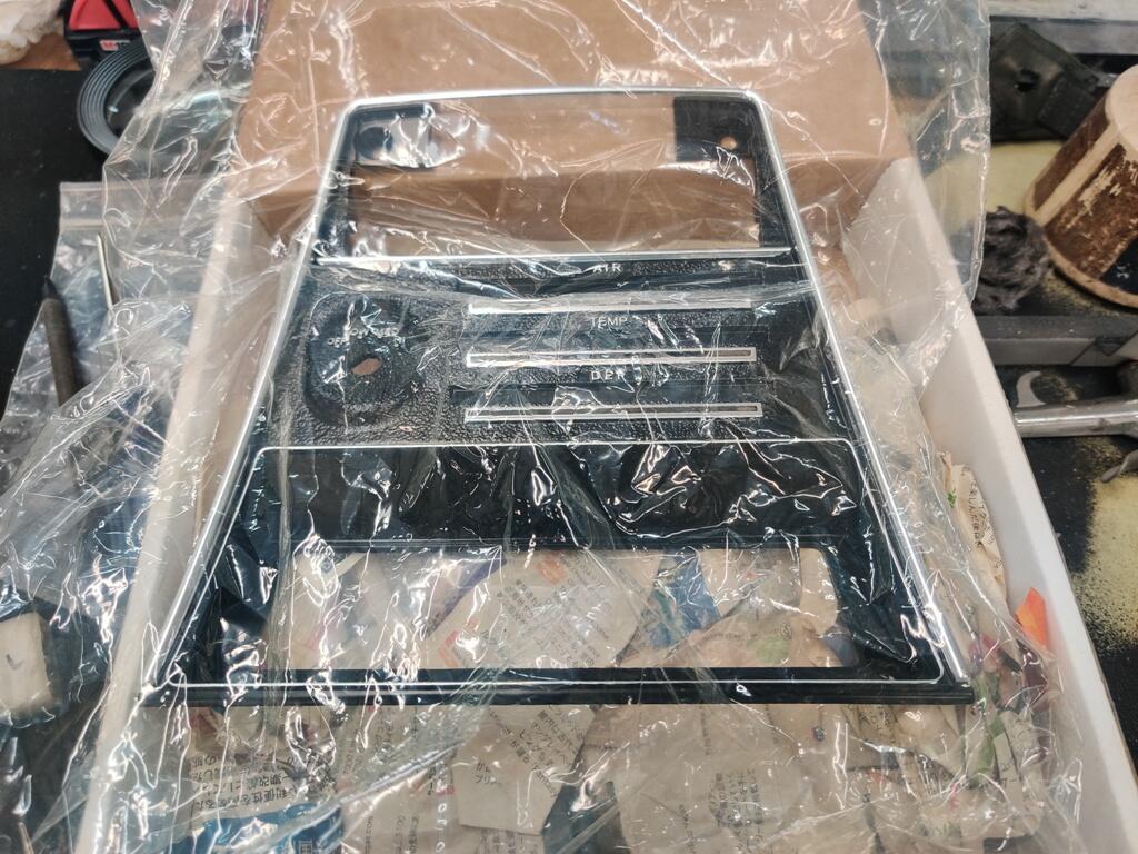

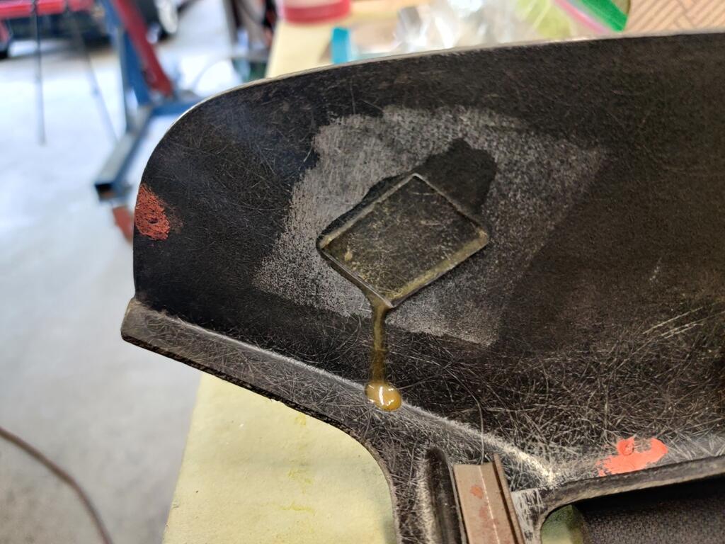

Indeed, that looks perfect.. Does it stick really well? i mean is it very sticky and does it get off very difficult when you found it was not good enough? Does it have the exact width or did you have to cut it in size?
It will have to prove itself if it stands time.. but for now it's looking good.
It is very sticky.  For most of the failed attempts, the tape and adhesive came off together.  On one failed attempt, I didn't realize that some of the adhesive had stayed behind, and when I put a new piece on, it showed underneath the new piece.  Removal of the adhesive using 3m adhesive remover was difficult.  The 3/8" width I bought is perfect.  Where I did not apply it perfectly straight, you could see a tiny sliver of extra tape off of the edge of the part that is supposed to be silver.  I trimmed that by running an X-acto knife like this along the edge and then pulled the sliver of excess off.  I only needed to trim one of them for a span of a couple of inches.

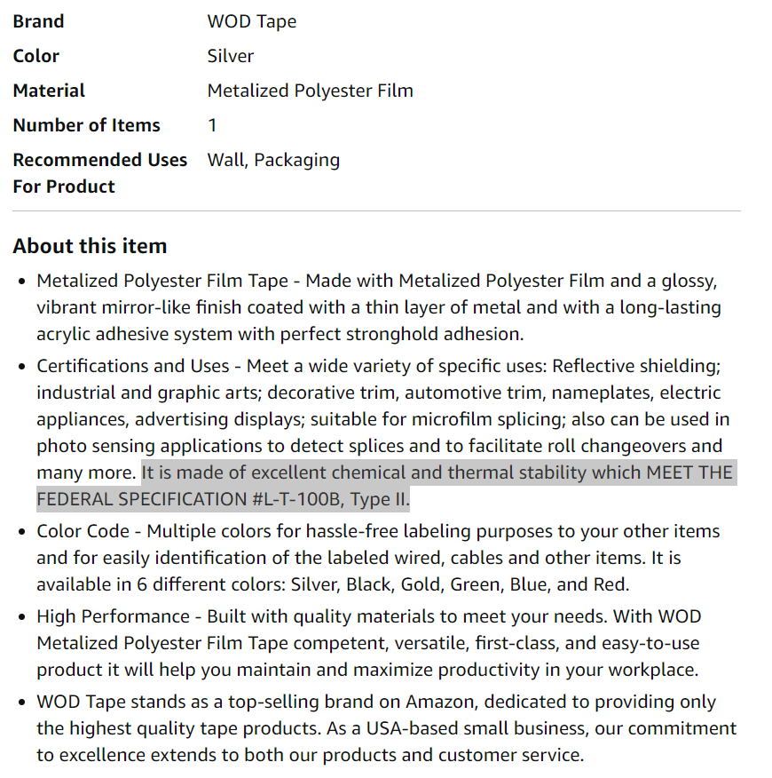

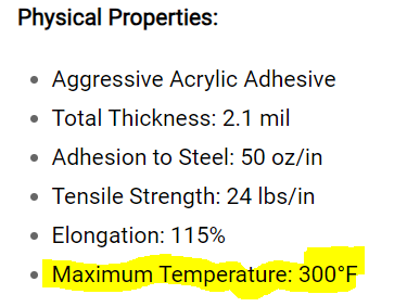

I found some more information about the tape.  It appears it may be able to handle hot car interiors:
https://www.amazon.com/dp/B079C5PYV9?ref=ppx_yo2ov_dt_b_product_details&th=1
This product appears to be the same: https://store.tapesandtech.com/mylar-polyester-tapes/mmyp-1-metalized-polyester-film-tapes.html

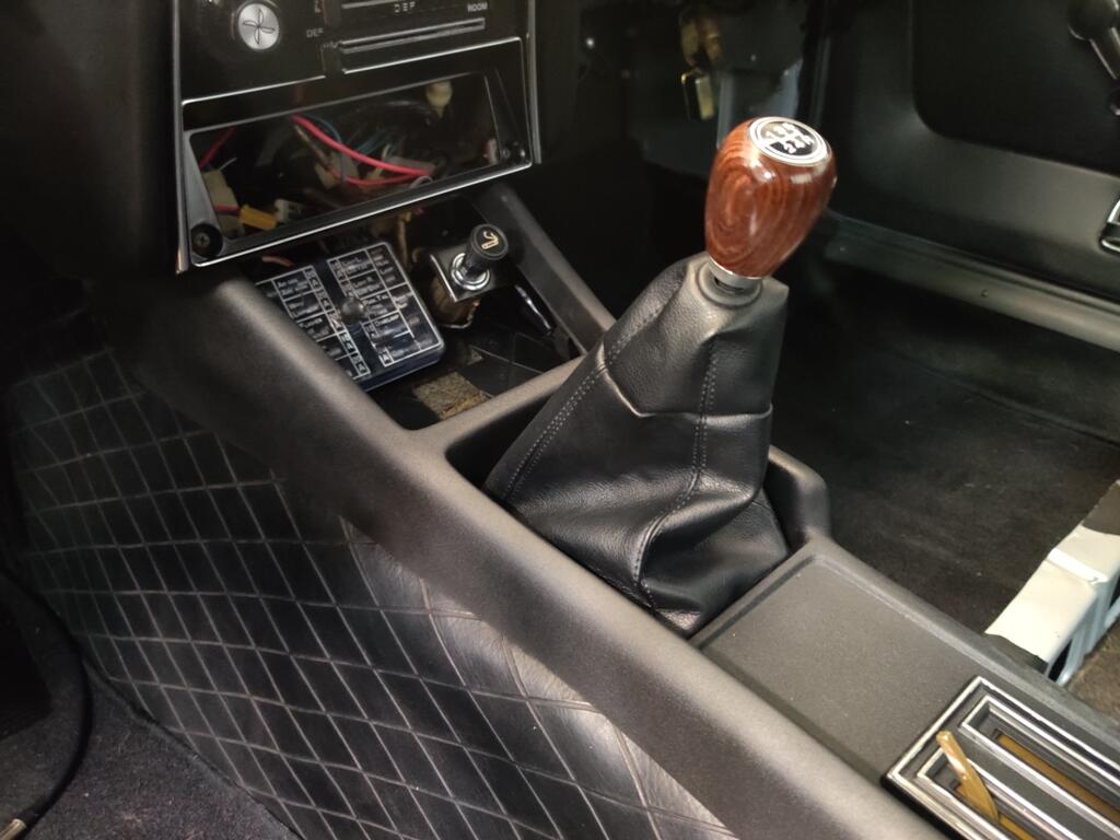

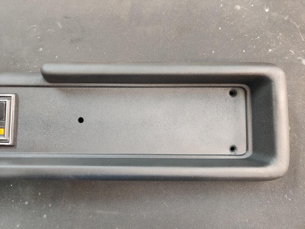

I didn't have much time this weekend to work on the car. Main accomplishment this weekend was getting a suitable shift boot installed.  I didn't take pictures, but basically I used a stock 240SX rubber shift boot and a metal ring to seal up the hole on the top of the transmission tunnel.  The 240sx transmission fits nicely in the car, and places the shifter in the stock location (unlike the 280ZX transmission).  To seal the tunnel opening, which I left stock (uncut), all I had to do was bend the metal sealing ring at the edges.  The diameter of the boot and the associated ring is wider than the top surface of the tunnel.  So, by bending the metal ring on the sides, it folds those downwards.  It took a while to get it shaped properly.  To install it, I drilled holes in the top of the tunnel sheet metal and installed rivnuts. This is one of the very few (and insignificant)sheet metal modifications on the whole car.  However, removing the 240sx transmission and installing the stock boot, etc. can easily be done.

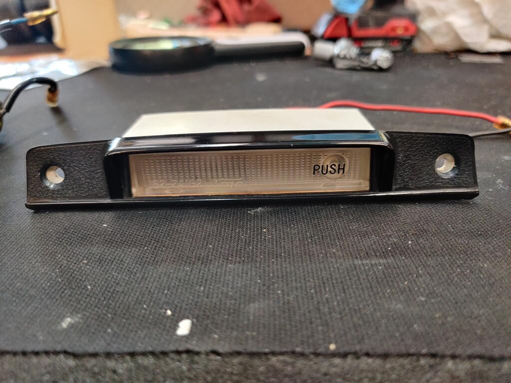

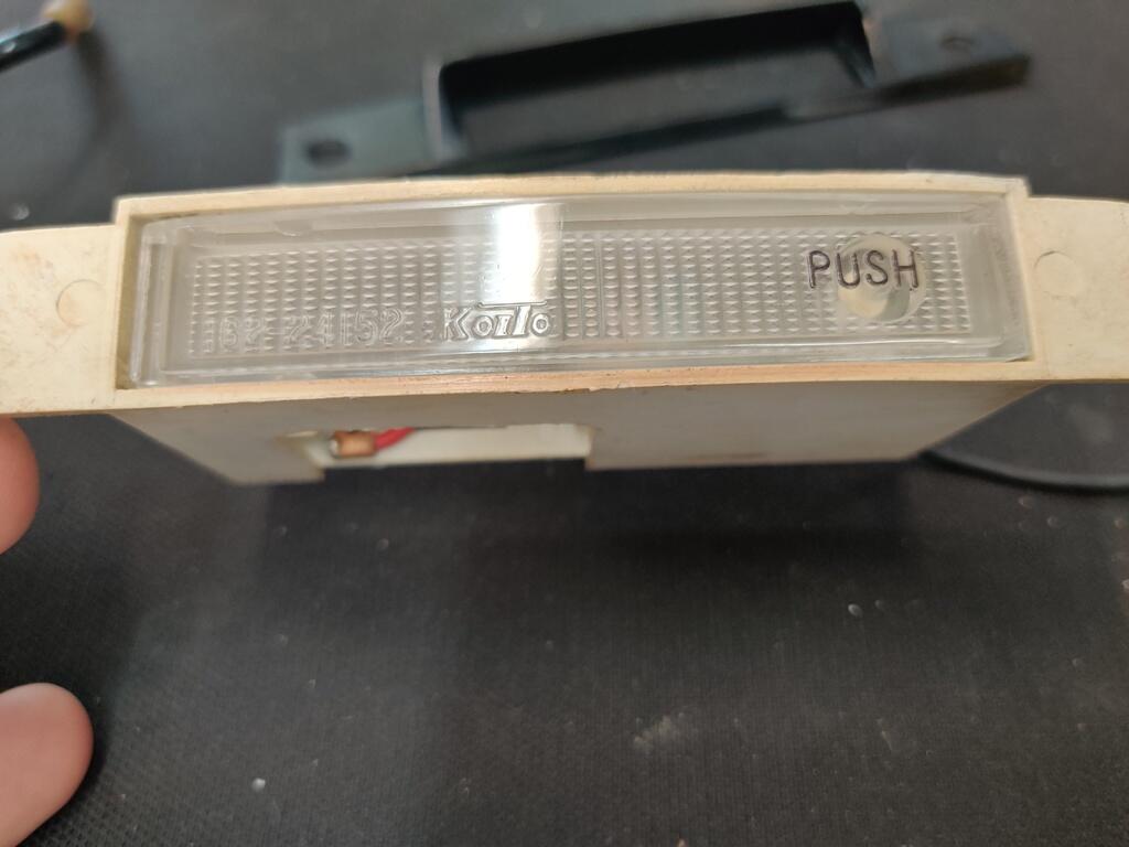

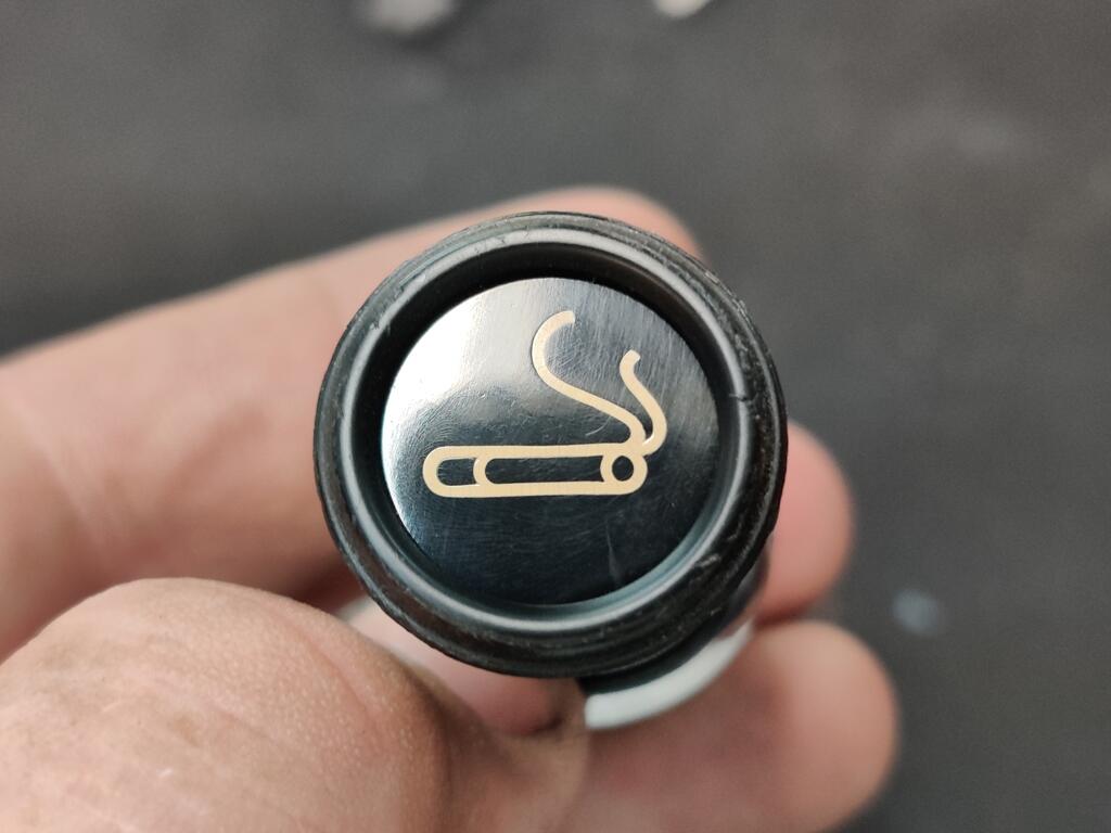

In addition to finishing the center console, I am in including some pictures from earlier work restoring the map light and cigarette lighter.  Interestingly, the little picture of the cigarette is not painted on.  If you remove the little disk from the lighter, you will see it is two pieces of plastic, one white and one black.  The cigarette with smoke rising off of it is actually part of the white backing piece.  So, you can sand and polish the disk without worry of "erasing" the cigarette.  I also polished the map light lens.  The map light as disassembled, electrical parts polished, and then reassembled.

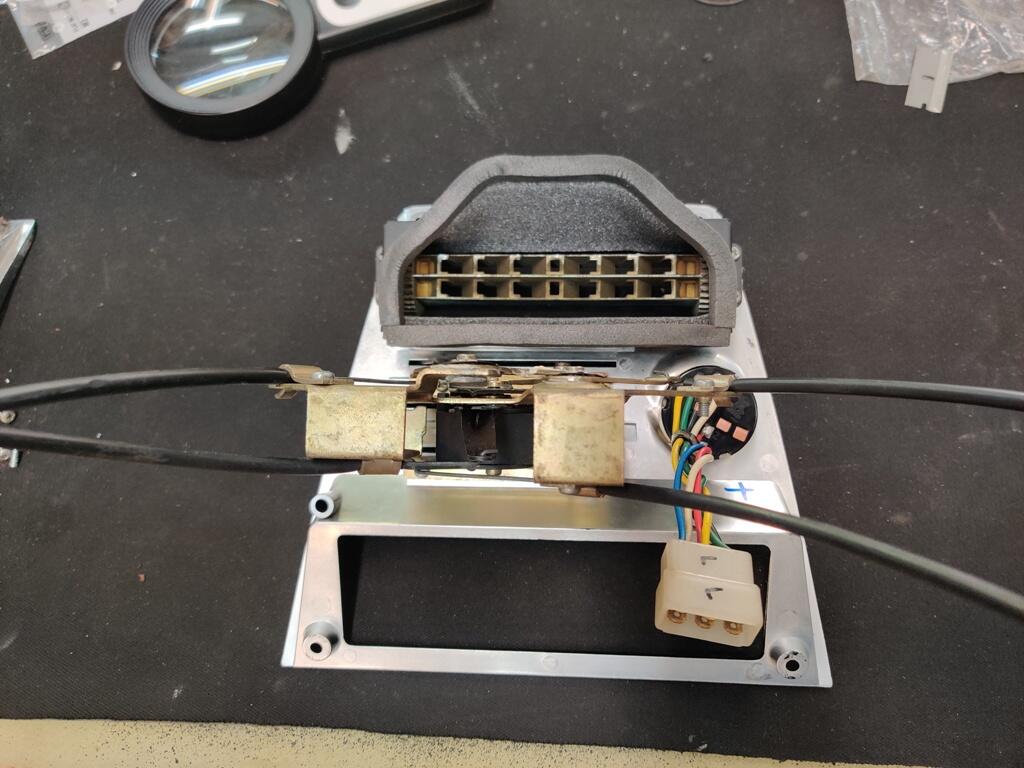

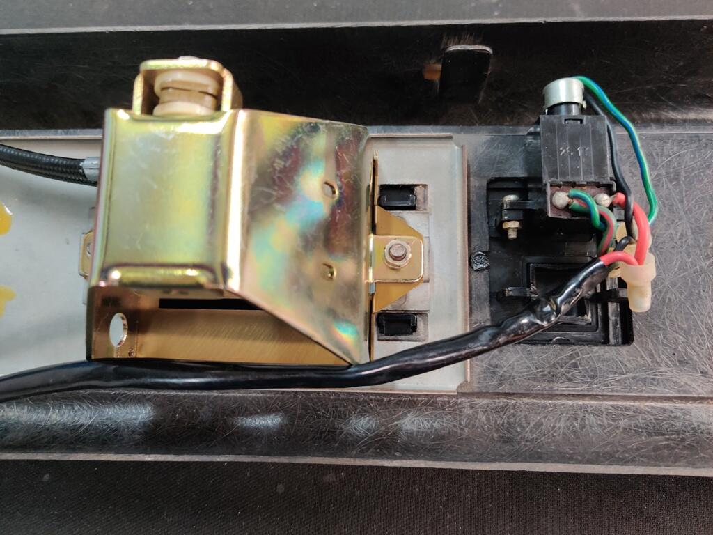

I took apart the center dash controller, cleaned and lubricated everything, then reassembled it.  For all of the cables, I removed the metal wire from the plastic sleeves and straightened any kinks, polished the wire, and reassembled them.  Center panel is an aftermarket reproduction part.  I found that I had to file the opening for the fan switch a bit (off of center) from its original location to get the fan switch to align with the off, low, med, and high settings.

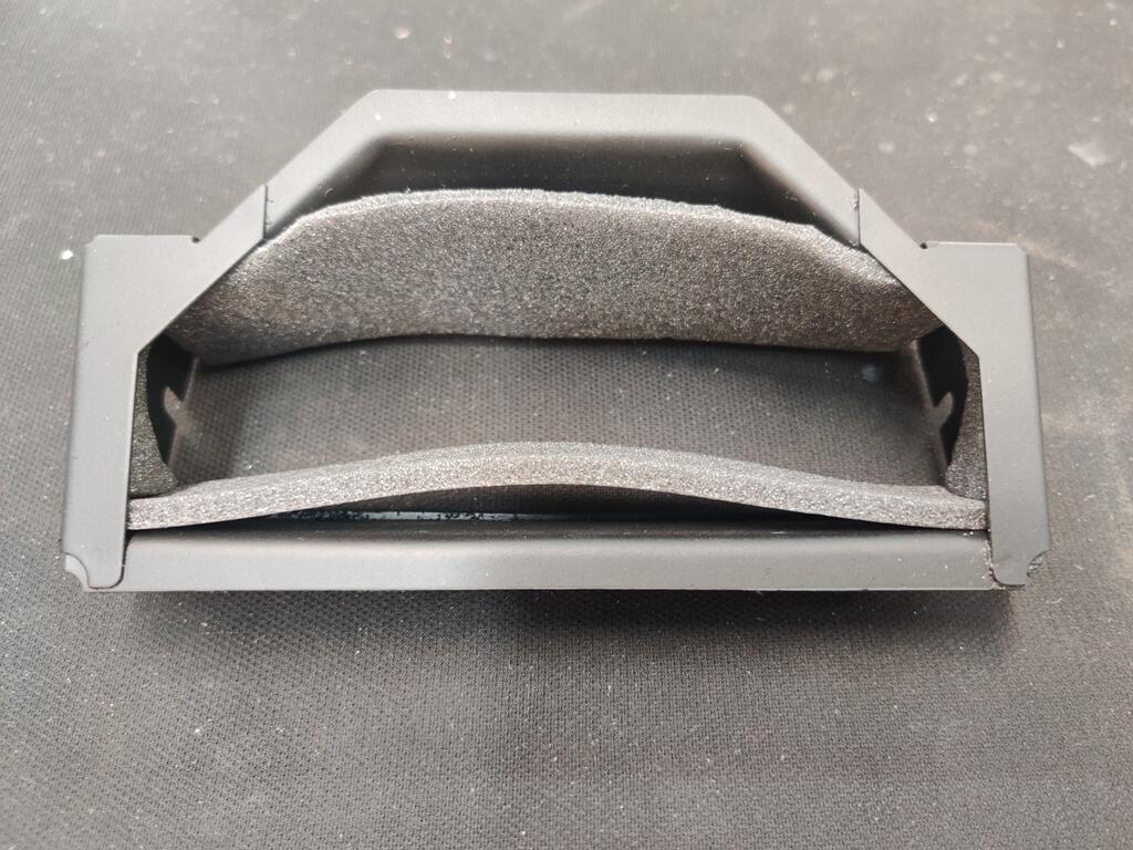

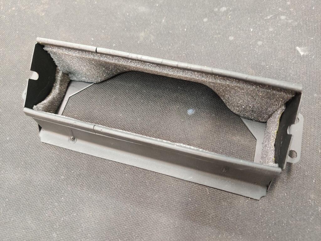

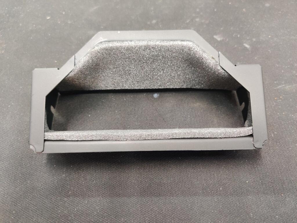

Stripped old foam and paint off of this piece, cut new foam and glued that in place.

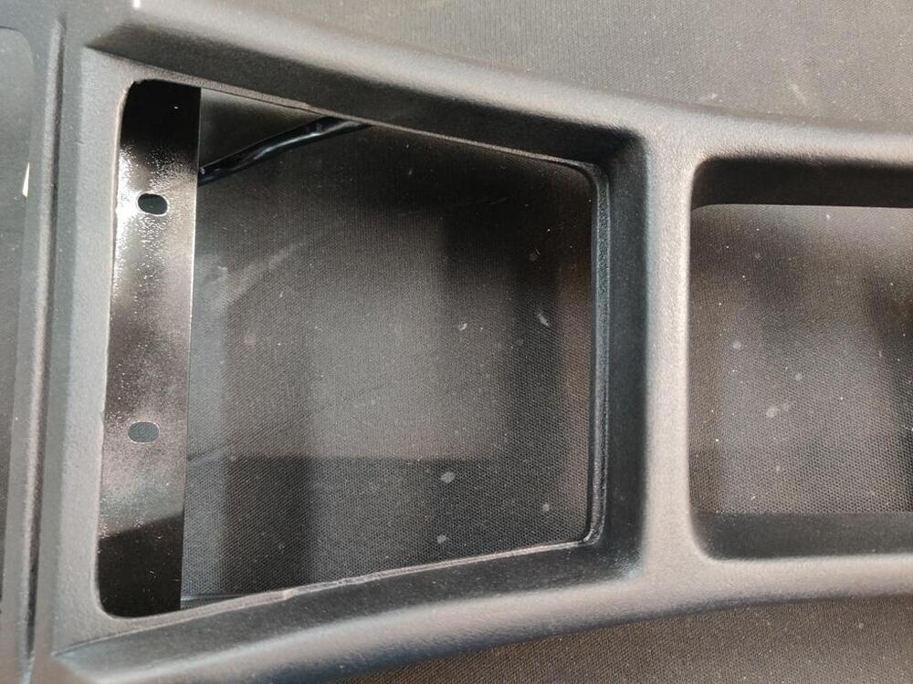

There is a metal strip that gets glued to the center console on the front inside surfaces. The old glue was still present and helped me "locate" the strip in the correct location after I glass bead blasted and painted it. The glue I used was a 2 part epoxy (which incidentally has a similar appearance to the glued used originally).

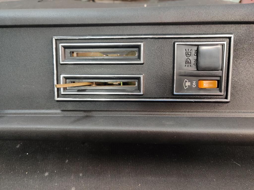

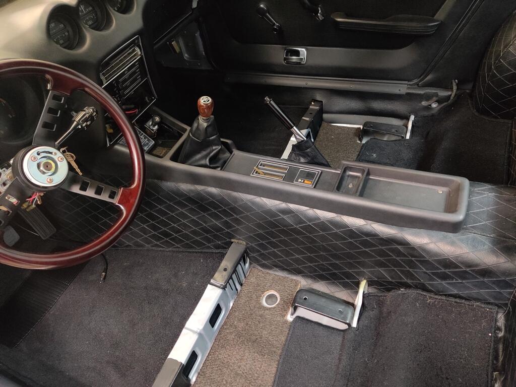

The console fit nicely when I finally installed it today.  I didn't get any pictures showing the installation of the reproduction shift boot, but that fit well.  It looks stock, which is nice.  The center console was one of the big projects left to do and it feels good to have that done.
Edited by inline6
Here are a couple of pictures of the restored center console after installing it.

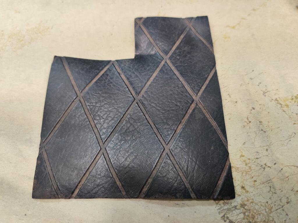

Anyone recognize this piece of vinyl and where it goes?  I am thinking it is glued to the top of the transmission tunnel under the ash tray?

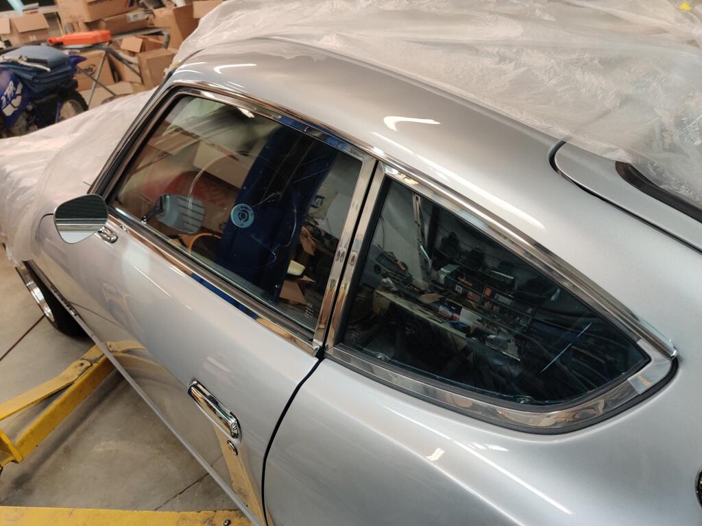

I started working on stainless trim today.  I was able to polish the rain rail pieces without too much trouble.  To polish them, generally, I used 1000 grit, then 1500 grit, then 2000 grit, then 2500 grit, followed by a soft rag and some metal polish.  All of that was done by hand.  I did both sides and installed them.

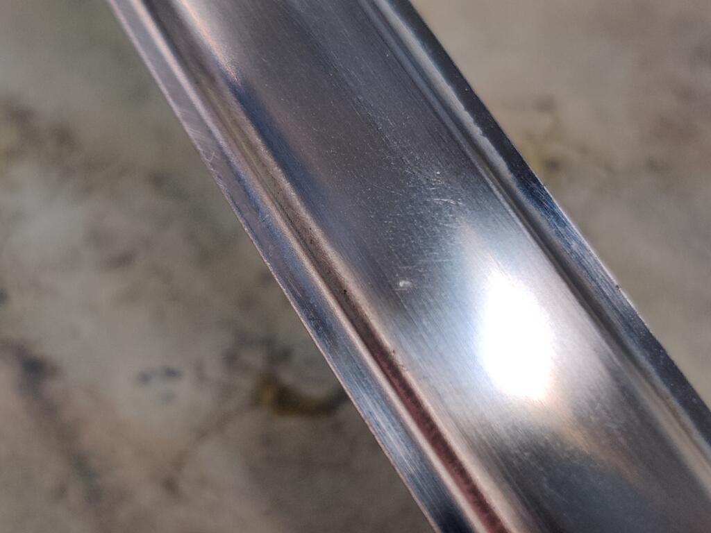

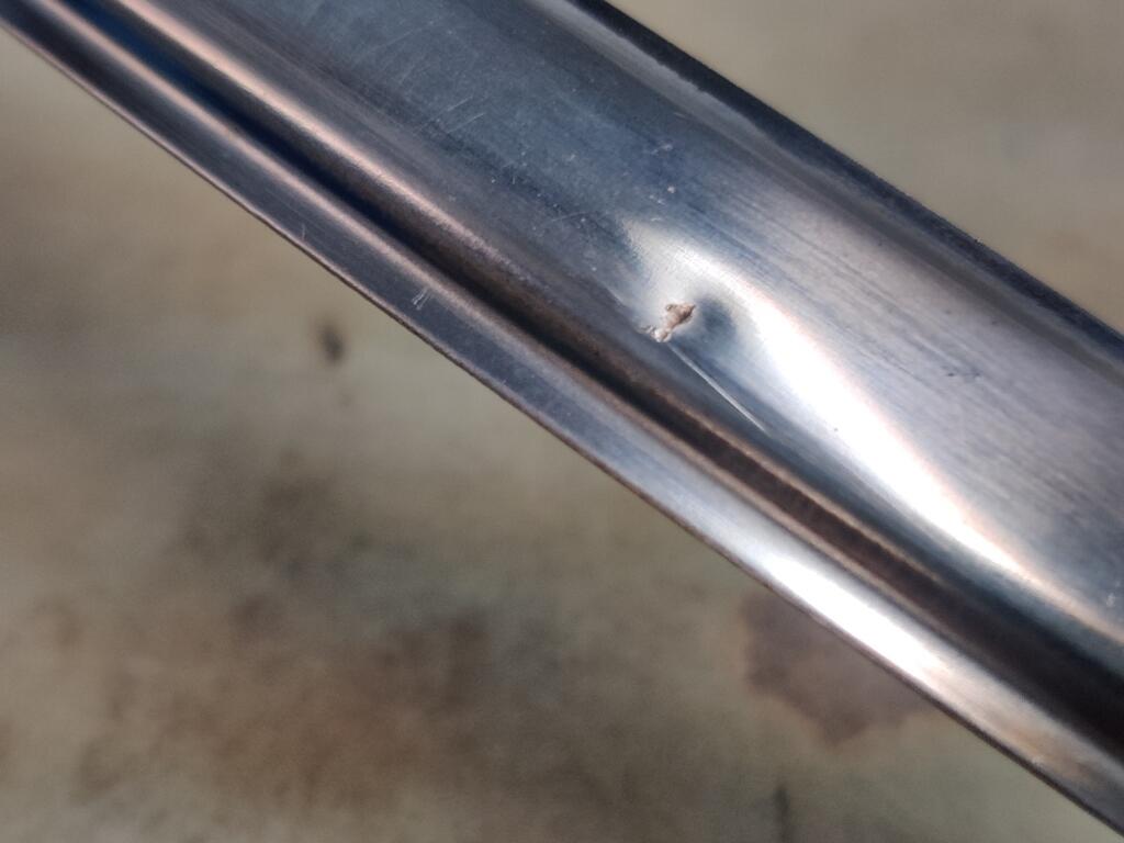

Then, I moved on to the front windshield stainless trim.  There were some rock hits, like this one in the trim pieces:
To address these, I used a small metal hand punch and a hammer to push the dents out from the backside of the trim.  Some experimentation with amount of force assists you with figuring out how aggressive to be.  Once I confirmed that I had pushed the metal slightly outwards instead of inwards, I used 320 grit on a paint stick to "mow down" the high spot I had created.  If you look closely, you can see when the 320 grit has leveled the high spot.  From there, I double checked my work by using 400 grit, then 600 grit.  At that point, I took another picture of the spot above:
You can see the tiny nick still present, but there is no longer a dent.  From here, I may try one more time to raise that nick and go with 320 again.  Or, I may just move on to 800, 1000, 1500, 2000, 2500 and then polish.

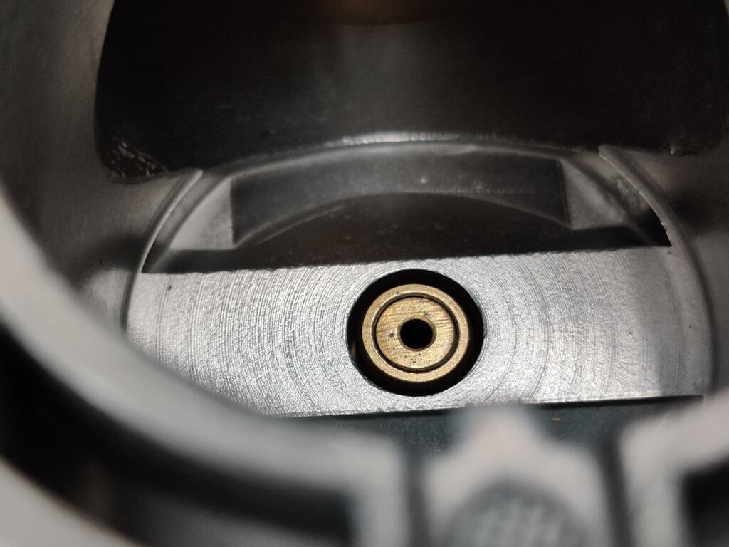

Started to check everything on the carburetors today.  They were rebuilt by Paltech - I think they are out of business now.  And one of the things on my list to do is to check the basics before attempting to fire the car up.  Unfortunately, I ran into and issue.  I screwed the mixture screws all the way in on both carbs:
Front carb - and back carb respectively:

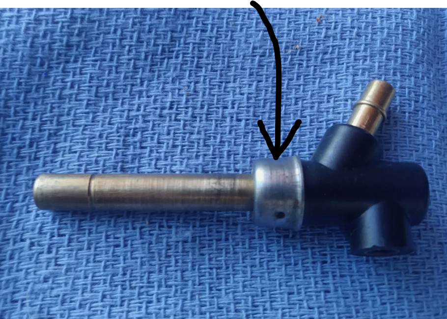

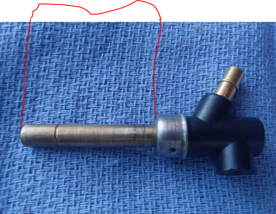

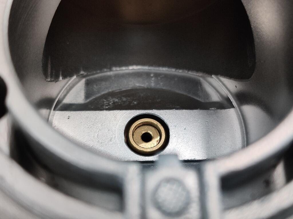

The top of the nozzle on the front carb looks odd.  It has a slight angle/chamfer that you can see in the pic. But more importantly, with the mixture screw all the way screwed in, the top of the jet nozzle is not flush with the "surround" - whatever that piece is called.  That is not good.
I removed the jet nozzles and measured their lengths - this length.
The measurements are front: 1.405" and back 1.445".  These are 4 screw SU's.  Can some folks measure the lengths of any nozzles so I can compare with what I have?  I am going to take a closer look at my nozzles.  But, I fear someone ground the end of the front one down or something.
  • Agree 1
Working on the car today was not fun.  I put in about 8 hours.  First problem I ran into was the SU nozzle issue above.  When compared the nozzles side by side, interestingly, the shorter of the two had not actually been shortened. The nozzles have a little groove around the circumference.  You can see it in the picture below.  Aligning the grooves on the nozzles, the distance from the groove to the top of the nozzle was the same for each.  I decided that the nozzle was going to have to be replaced.  But, I couldn't set it aside.  I had to mess with it.  So, I ended up removing this crimp collar (using a hammer and flat punch, it came off pretty easily.  image.png
After that came off, I was able to remove the brass nozzle portion from the plastic portion.  From there, I experimented with putting the brass nozzle piece back into the plastic, but not as far in.  And then I pressed the collar back in to place.
It took me 3 tries (remove the collar, adjust the height of the brass portion, reinstall the collar) before I got the 'short' nozzle to be the same length as the other one.  It seems to be held in place very well when the collar is put into place.  However, I don't trust it.  My guess is that with heat and use, it may "drop" down further into the plastic portion of the nozzle.

From there I worked on the rear hatch glass stainless steel trim.  I removed more small dents and stepped my way through 320/400/600/1000/1500/2000/2500 grit sand papers and then used metal polish on them.  Each one took a lot of work.  Then, I TRIED to install them.  I had no idea it was going to be so hard.  Literally impossible with all my expertise and tools on hand.  I ended up cutting/slicing/gouging the rubber hatch glass gasket in so many places that it is trash.
I am so frustrated.  I really thought that it wouldn't be that difficult.  So, now what?  I have to remove the rear hatch glass and replace the seal.  While it is out, I can try to put the trim in place and then reinstall the rear glass.  But what about the front windshield.  I don't want to destroy that seal... and I don't want to take the winshield out.  What am I going to do?  How am I going to get the new stainless trim I bought from Japan installed on that one?
