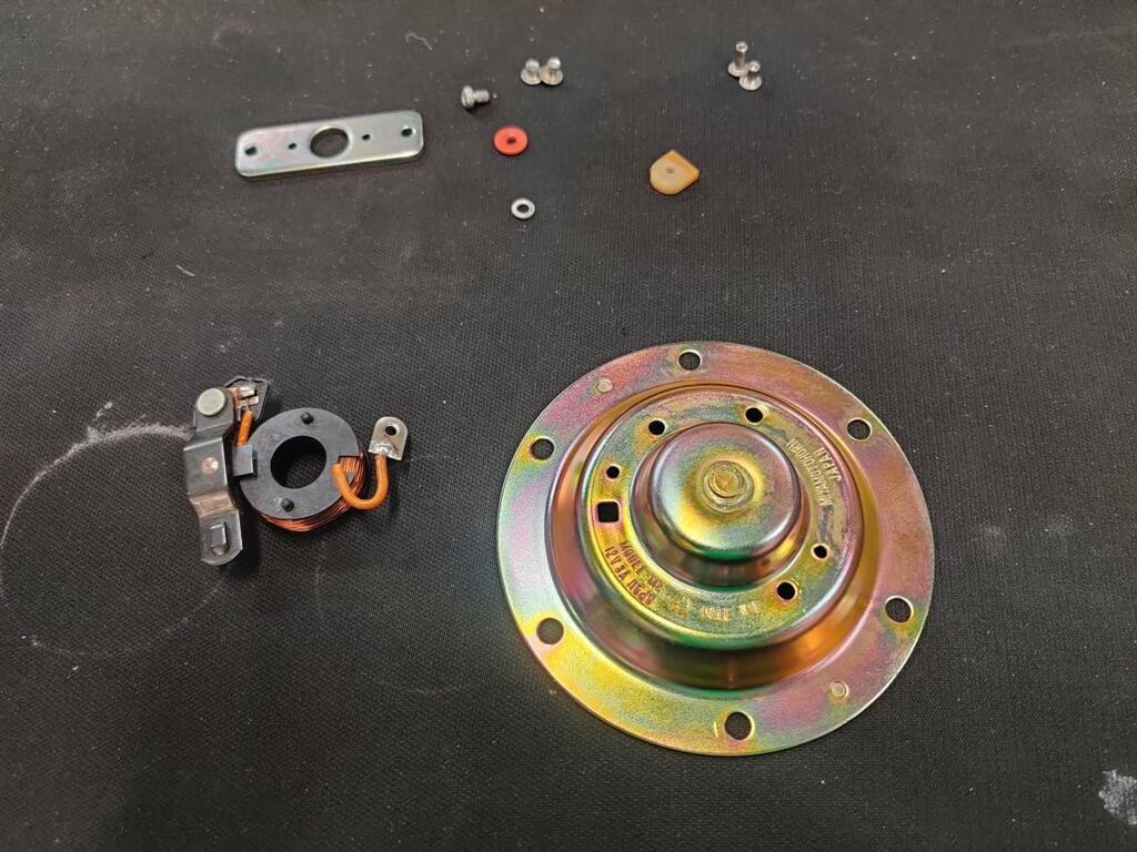

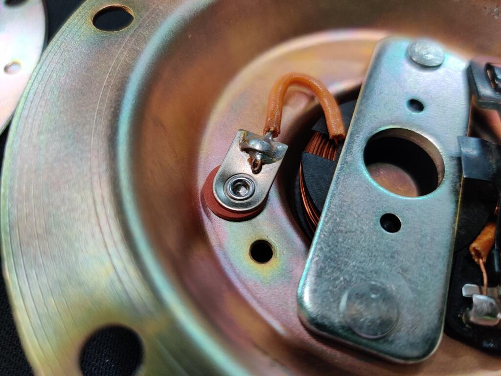

Recently, I sent off a small box of hardware for plating.  Unknown to me, the place I sent the parts to had gone out of business, and my box got hung up in the UPS/USPS system for quite a while.  But, I was successful in getting the box of parts back finally, after many weeks.  I found another plater, and sent the parts off again.  He got them done literally over a weekend and got them back to me already.

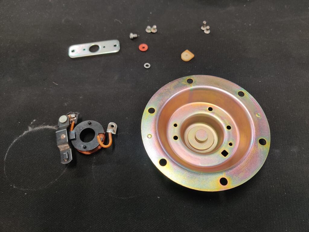

For the horns, the first plater I sent them to wouldn't do them.  So, this time, I drilled out the rivets holding the electrical parts to the back plate and sent the back plates off for re-plating.  I had to order "semi-tubular" rivets and "rivet curling punches" to set the new rivets.  Today I experimented a bit with those.

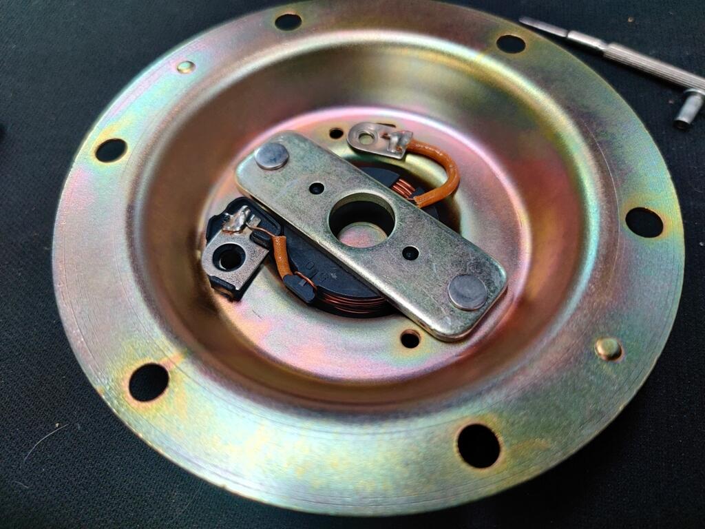

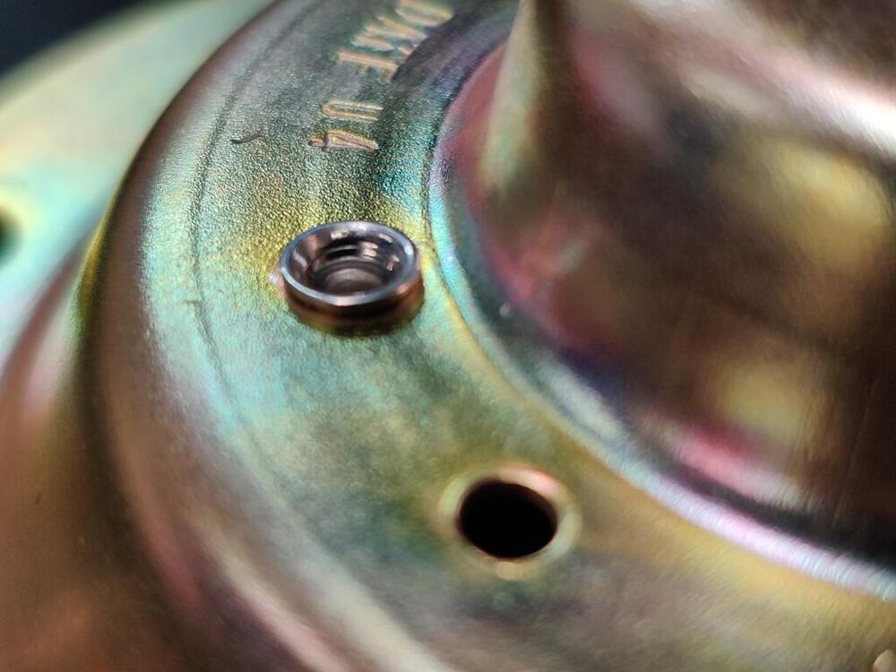

The rivets for the "bridge bar" need a bit more work, I think:

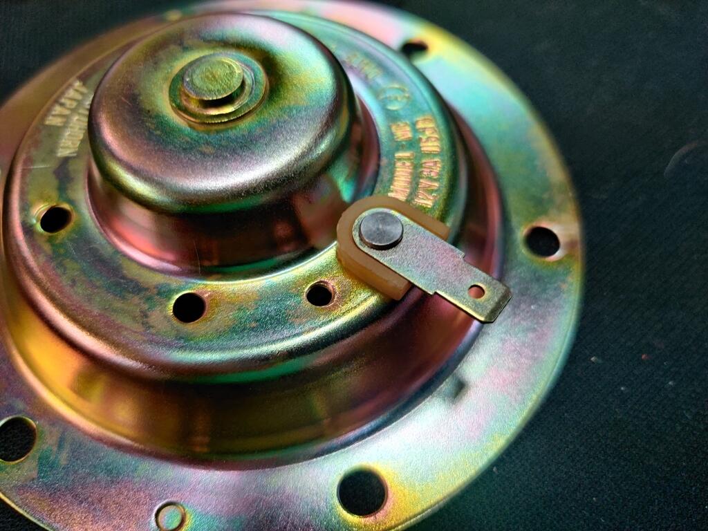

The rivet for the spade connector looks perfect:
Didn't have much time to work on them tonight, but should be able finish them up this weekend.

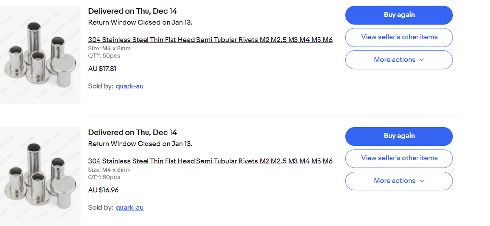

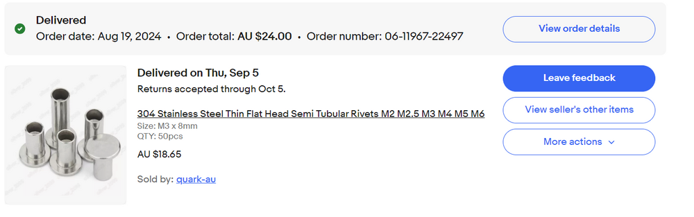

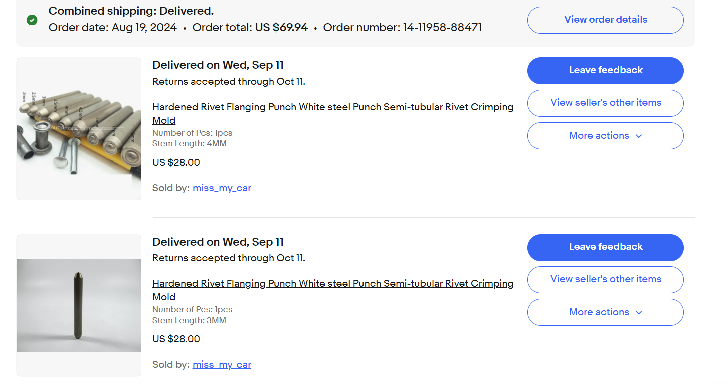

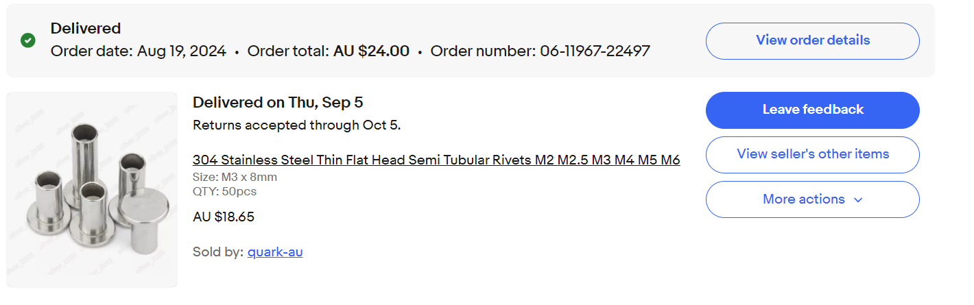

links to the rivets you bought and tools?
