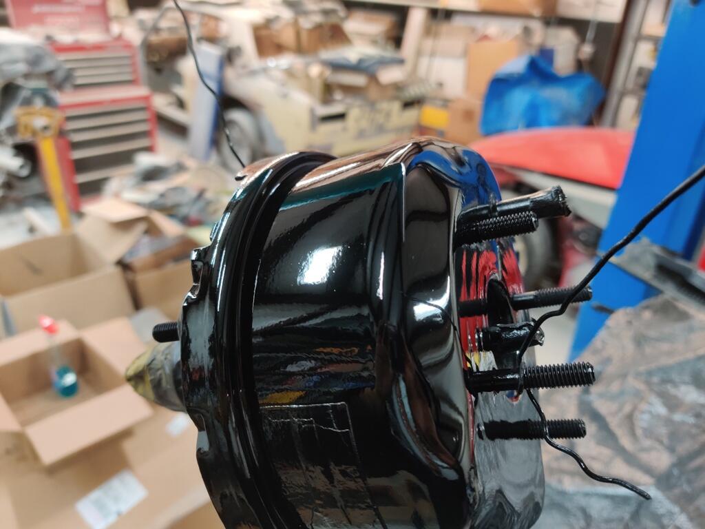

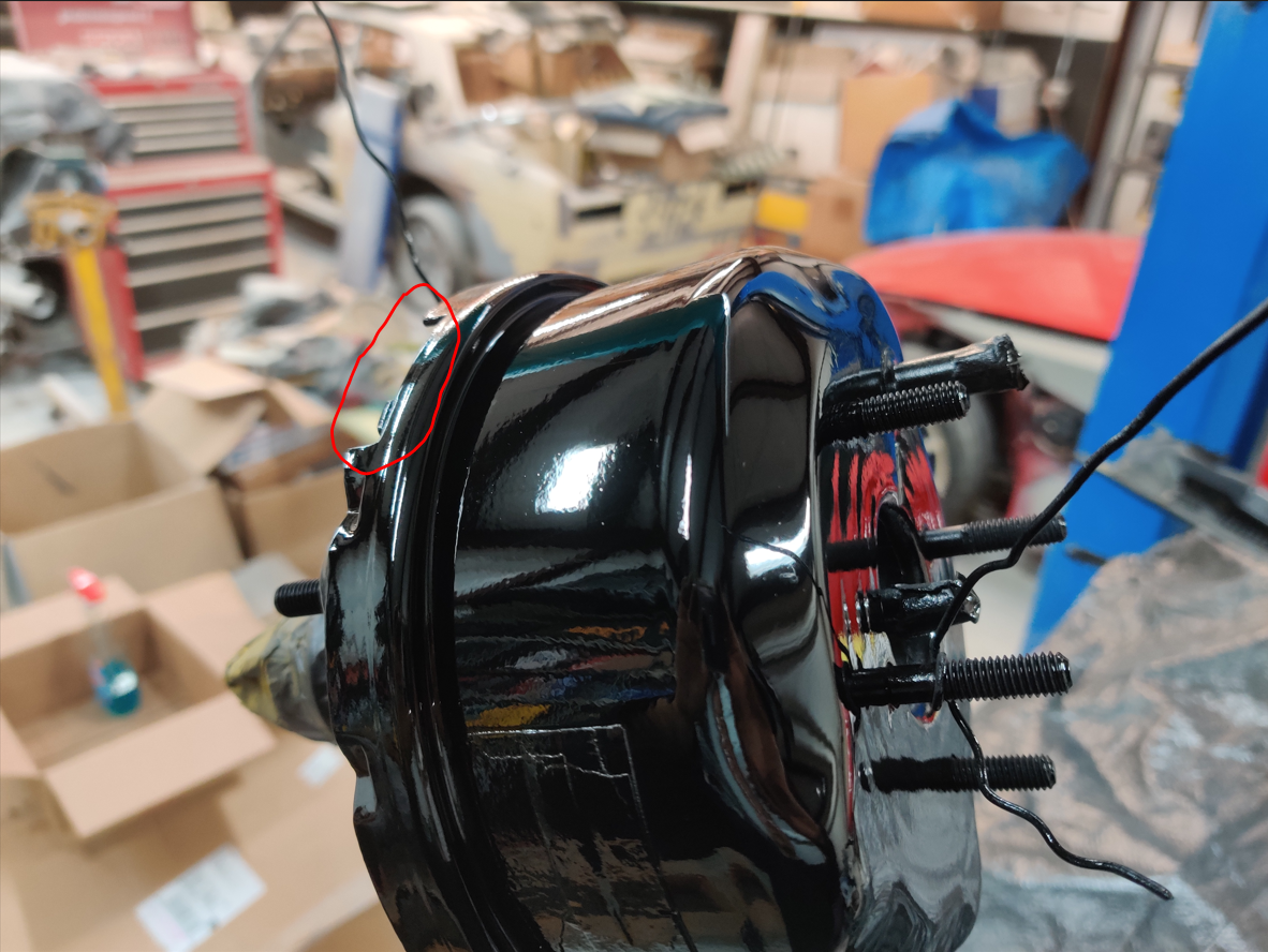

I bled the brakes and clutch again today.  Brakes function, but the booster is not boosting 😉.  This 7" kit is available from Zcardepot: https://zcardepot.com/products/power-brake-booster-rebuild-kit-7-inch-240z
It looks like the right one to me.  Anyone buy and install one of these?
My booster looks like to be the rebuildable type that they mention (note red circled area):
They are in Missouri, so stuff from them usually shows up where I am in Georgia within a few days.
