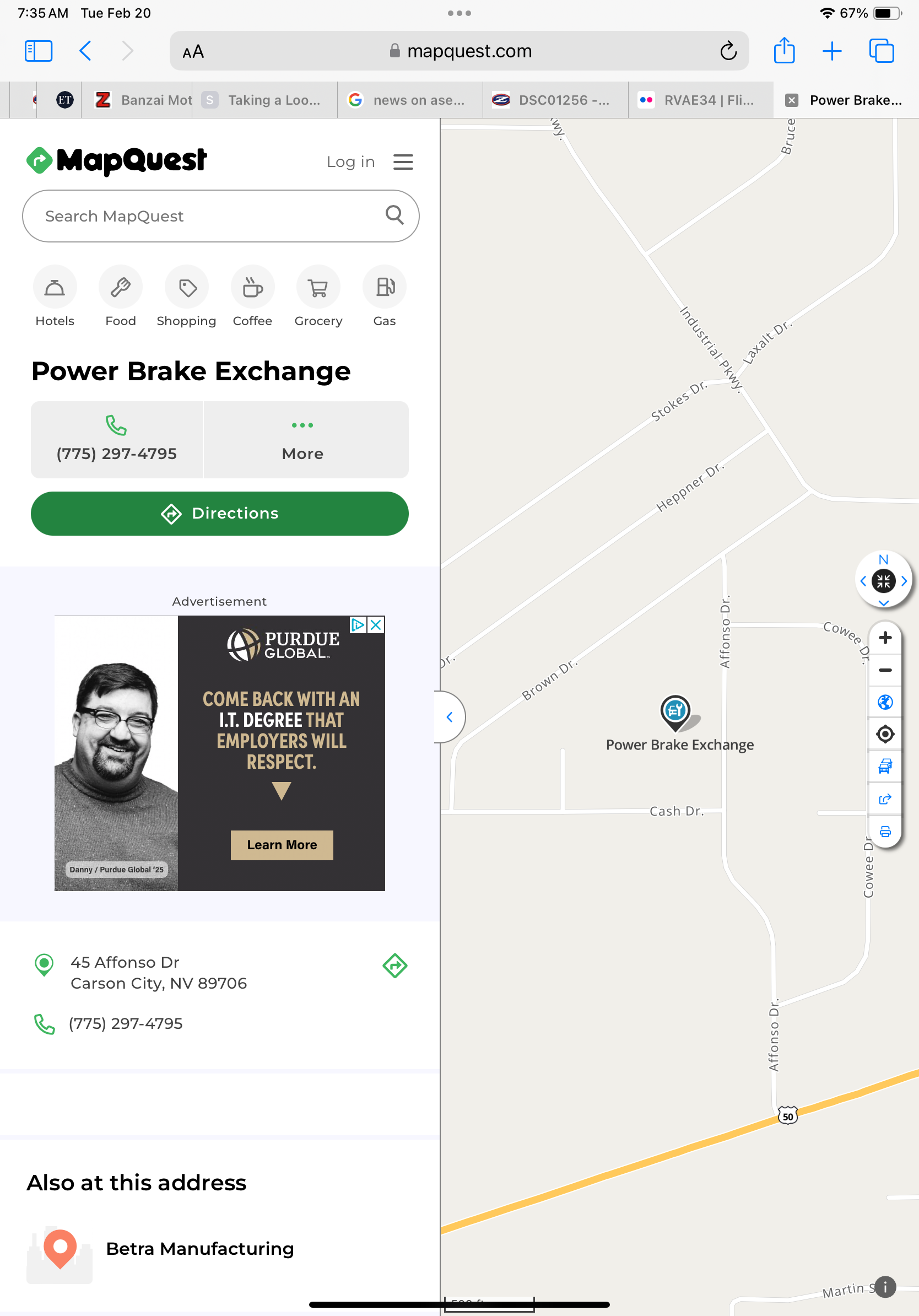

IMHO, seems to me if you sent those carbs off to Z Therapy to install new floats and valves it would be a cheap fix to know it’s done right. Just kind of sounds tricky to start modifying floats by drilling and screwing stuff in them. Why God created money. Power Brake Exchange built a couple boosters for me…..beautiful work.
Edited by Diseazd
  • Agree 1
Power Brake Exchange is a great company that has terrific customer service. Thought the booster they rebuilt for me was not working correctly. They had me ship it back at no charge. Checked it out and after it was all said and done I had installed the check valve backwards. On the 78 280 the arrow points towards the intake. I had it backwards. Long story short the booster works perfectly.🤦‍♂️🤦‍♂️🤦‍♂️
