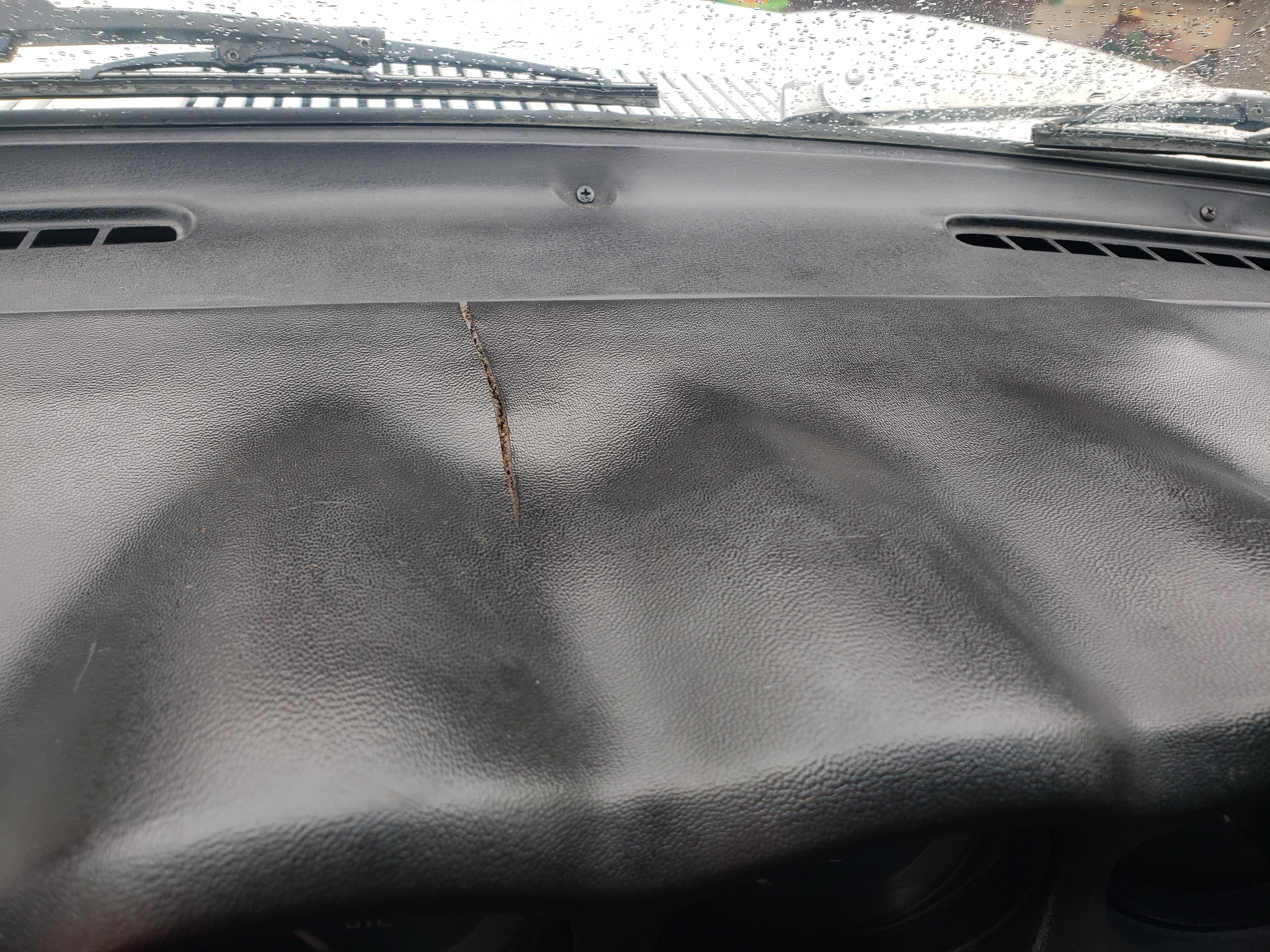

Fixing small dashboard crack on my 240z
3 hours ago, psdenno said:
You may want to consider drilling a "stop crack" hole to stop it from getting longer.
Dennis
As a follow-up, drilling a  "stop crack" hole was done often by my C-130 maintenance guys during the SEA Conflict last century.  Seemed to work well as long as the crack wasn't on a fuel cell area.  ?
Dennis
