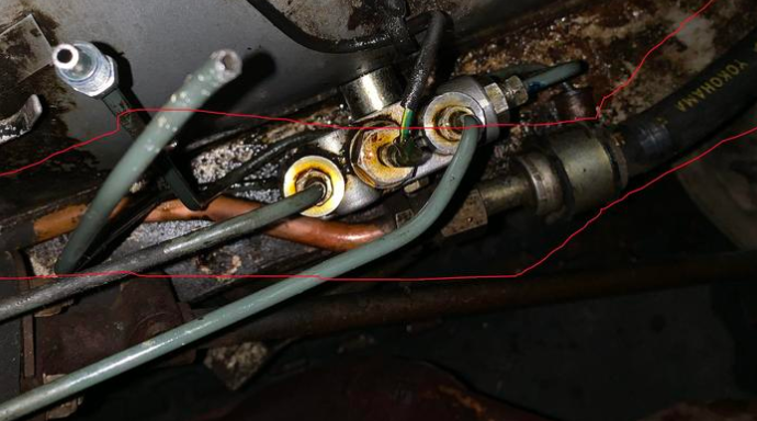

You might have a brake fluid leak.
Yeah, when we picked it up, all the seals were blown on the brake master cylinder (made roading it home terrifying and slow for the friend who helped). Replaced it and 2 of the brake lines that had taken up permanent residence the master cylinder (picture shown is half way through the process). Cleaned up the area after and sprayed it with the locktight rust converter. Will never use that stuff again. Converted the rust okay, but it seeped under the tape a little bit and converted the painted surface to rust. Very impressive how fast it worked. ?

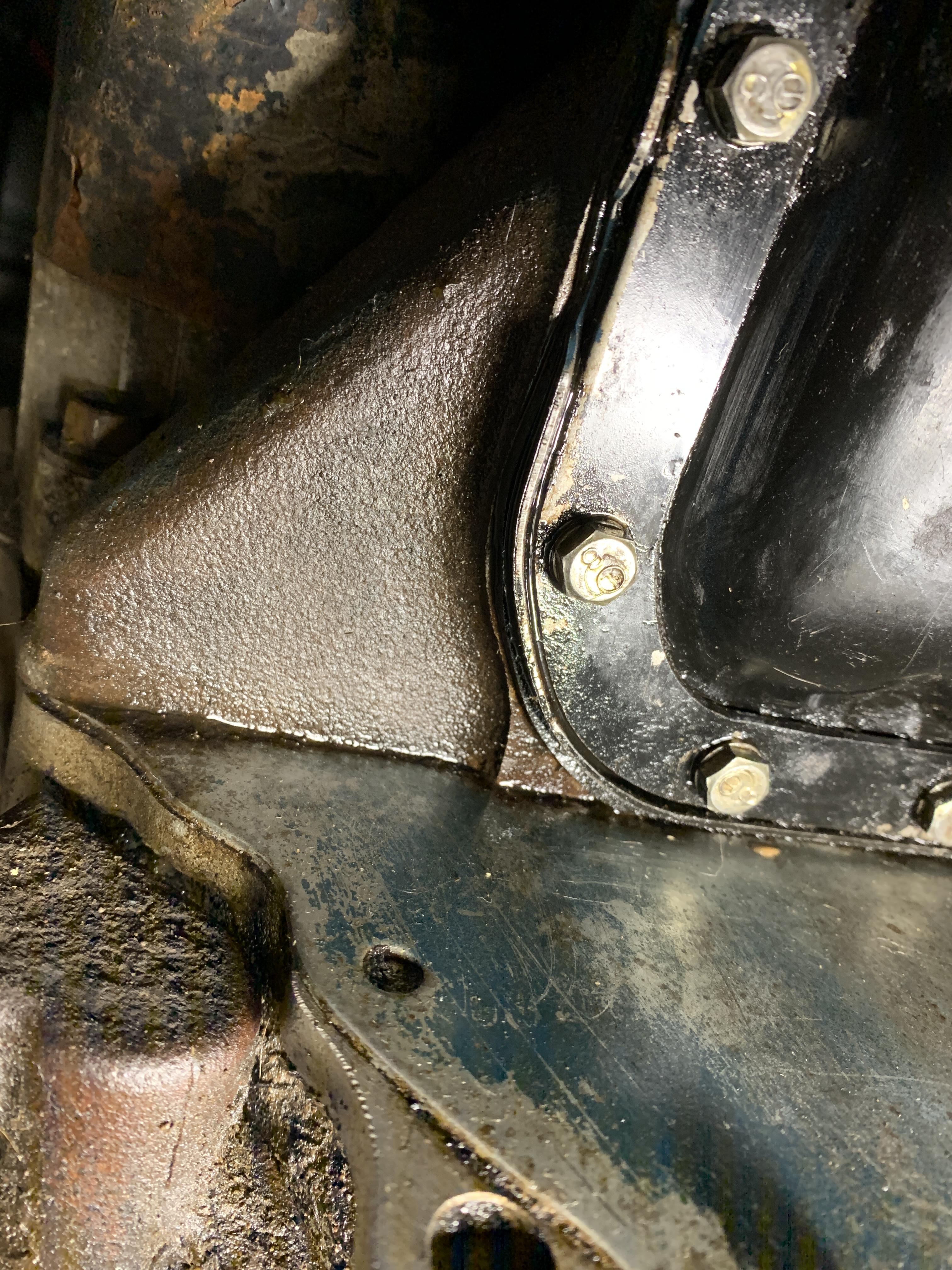

Update: cleaned off the oil pan yesterday and covered it in paper towel. Came back today to find this new oil next to the transmission (Shiny line, middle left of photo). Guessing this means the rear main is shot?

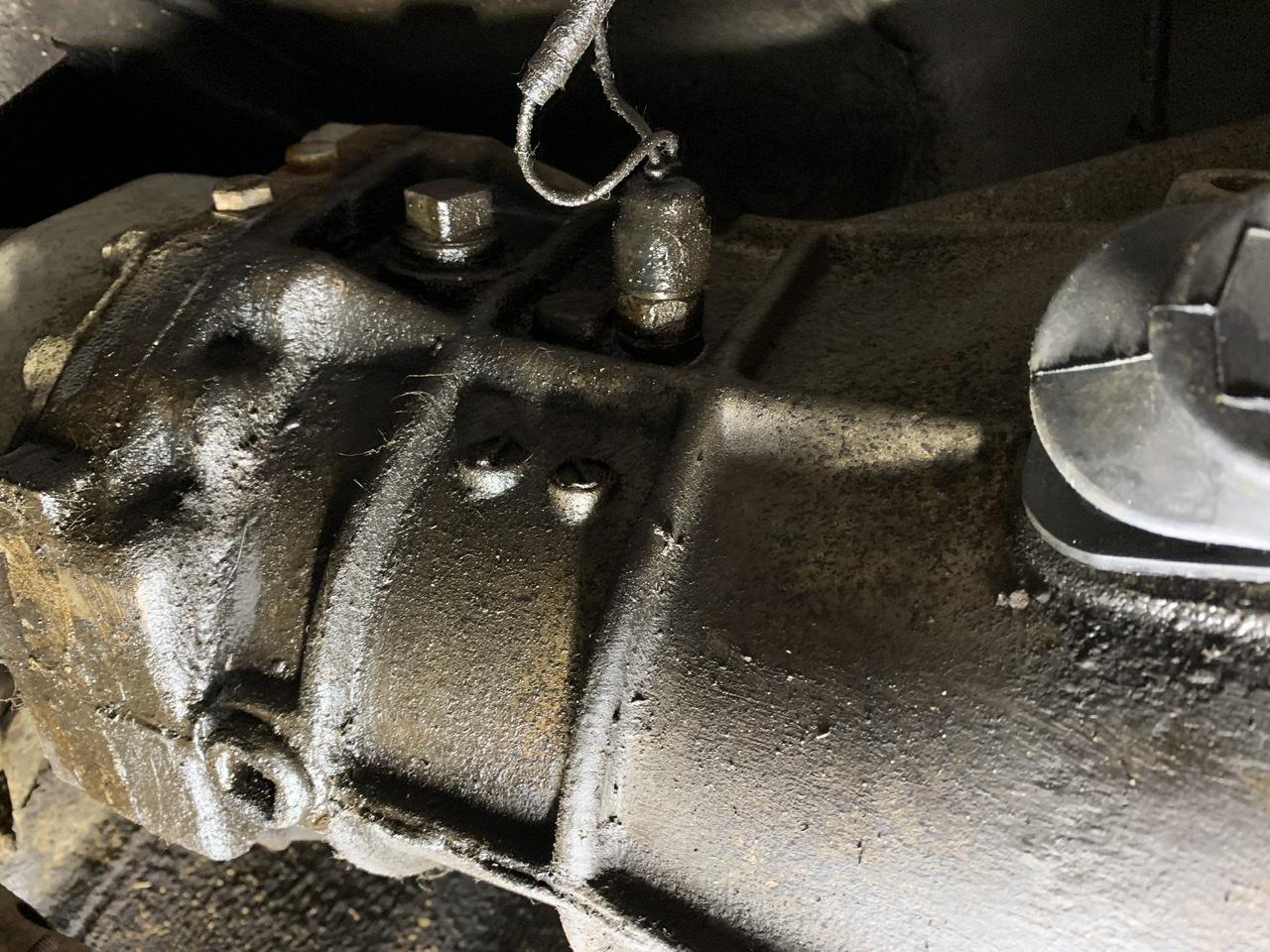

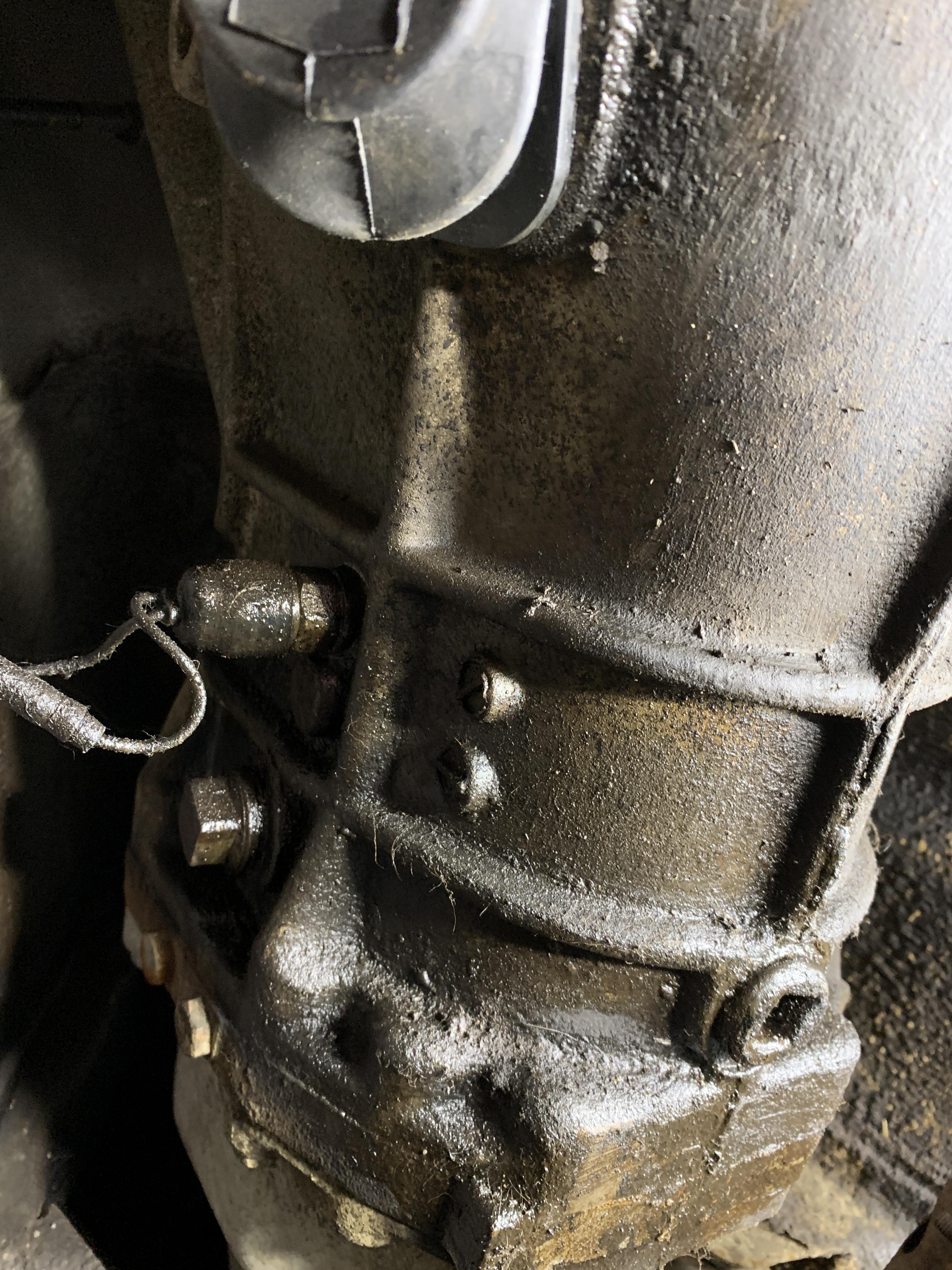

Also, saw some fluid (assuming transmission) coming from the sensor in the center of the photo. Is there a seal there? Or do these come lose over time?E98B4D8F-C5F0-47F0-9DE5-F67087809856.jpeg
31 minutes ago, grannyknot said:
Main seal most likely
*Long sigh* welp, going to get a lot of garage time this winter. ?

It might just need tightening but sometimes old units weep where the wire exits the housing.
Glad to hear that its nothing to worry about. When I pull the trans for the main seal, will clean up the transmission and dab some silicone for the weeping.
