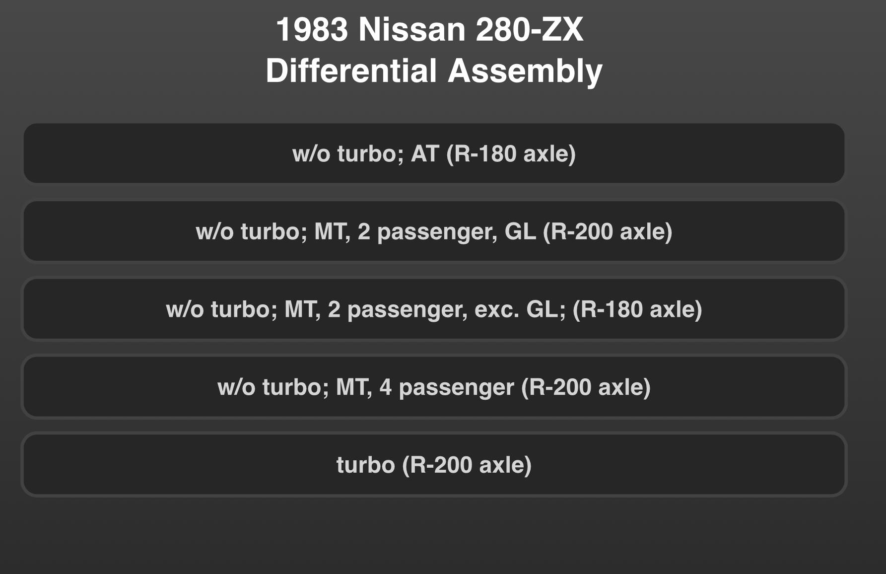

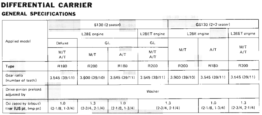

This are the options you have to choose from.  I called the guy and he said the computer shows different differentials for the 2 and 4 seater and both are R200.  Could be an error.
All of the NA MT's should be 3.9.  But, the FSM is not always right.  Just check your ratios before buying.  They're stamped on the ring gear.  You'll want to pull the cover anyway to look for damage.
Might also be that they are including  the type of axle in the part number.  The 2+2 83's came with CV shafts. So, if they removed the CV's the diff will be "empty" of axles.

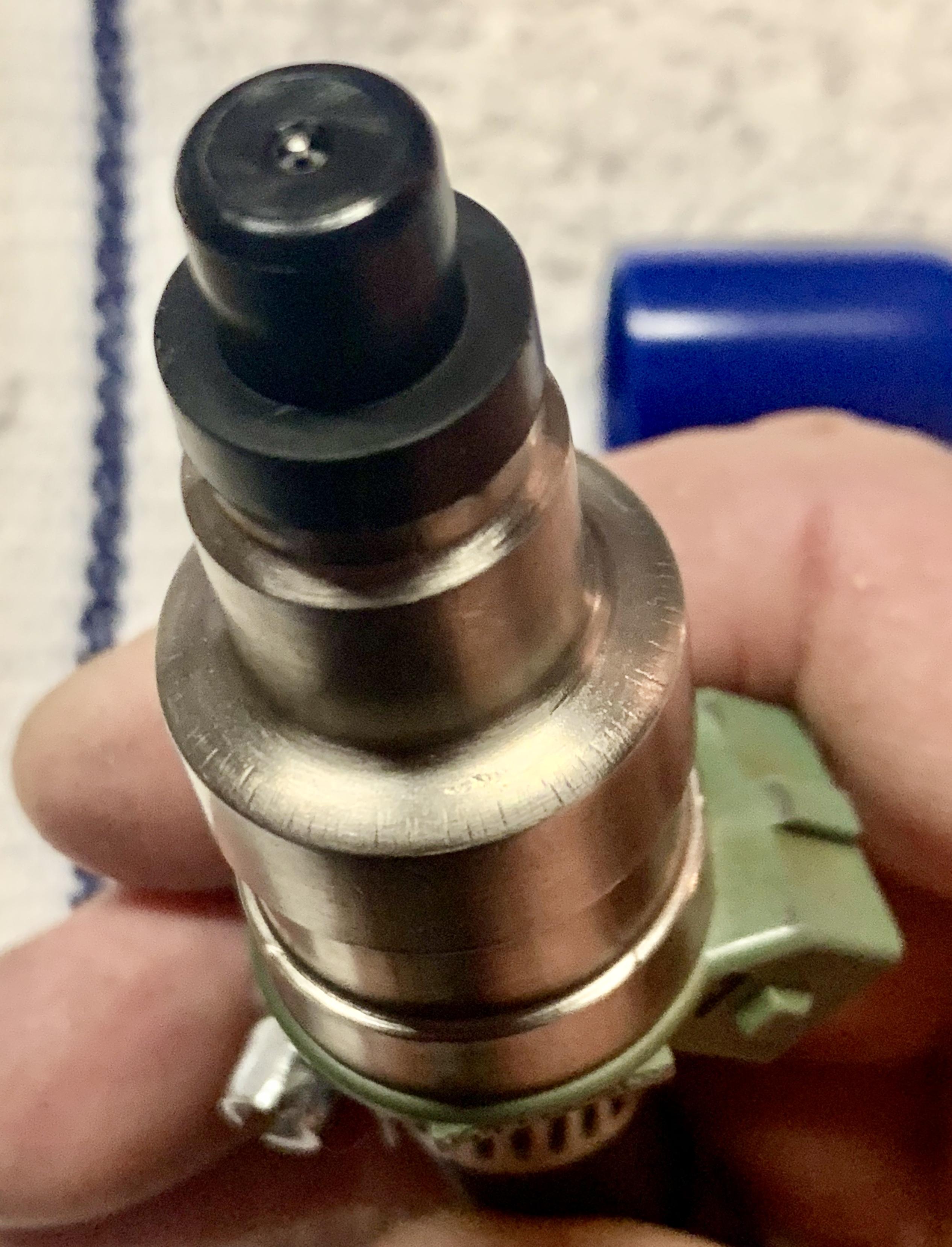

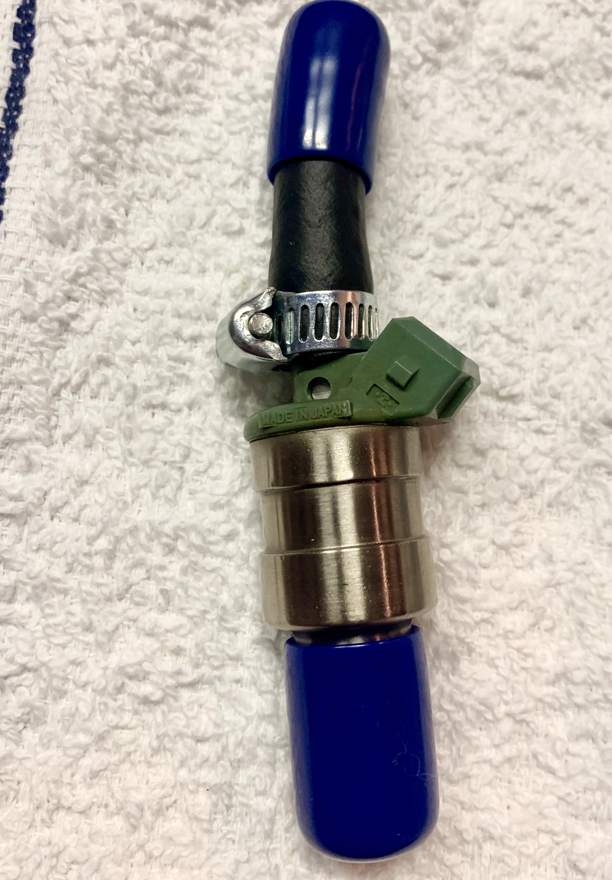

So before I left for this work trip my refurbished injectors came back from Motor Man,  they look really good, actually new.  The only thing I don’t like it the clamps he used.  I’ll upgrade the to stainless injector clamps.
