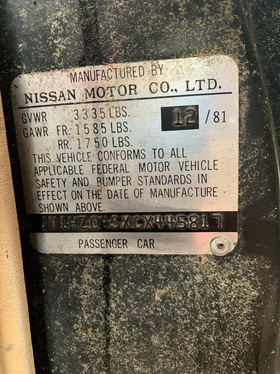

So I selected the 5 speed transmission and differential today after landing this AM.  A short trip to the JY and  I looked at all the mileage and years and picked an 82’ with 226k miles.  There was one with 186k but it was a 79 or 80 and I was worried it had the older 5 speed. (I couldn’t open the door to check the  tag but it had the dizzy with the e12-80, the and older ZX tail lights so I figured it was an early one)  The differential assembly was $120.  I also checked at least ten 300ZXs to see if there happened to be a LSD...no luck.  There was only one 88 turbo anyway.

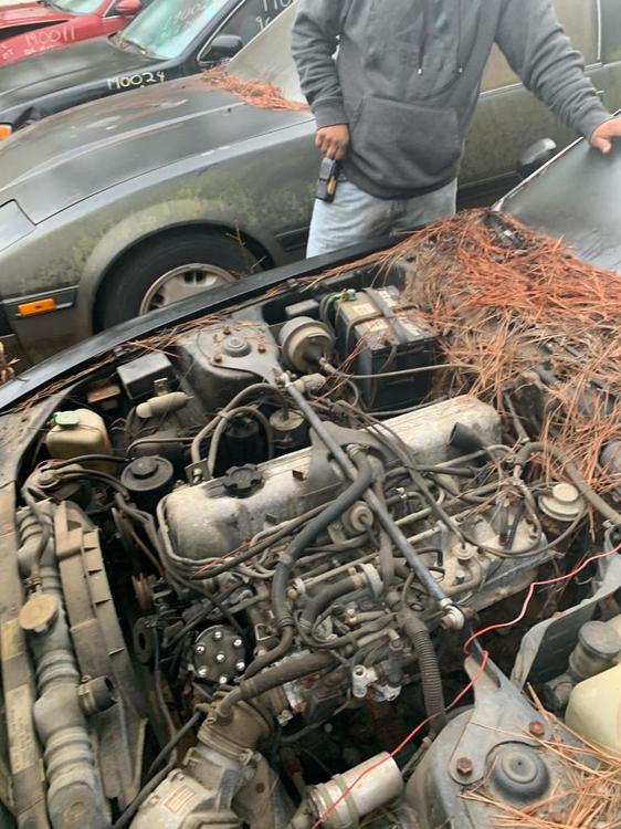

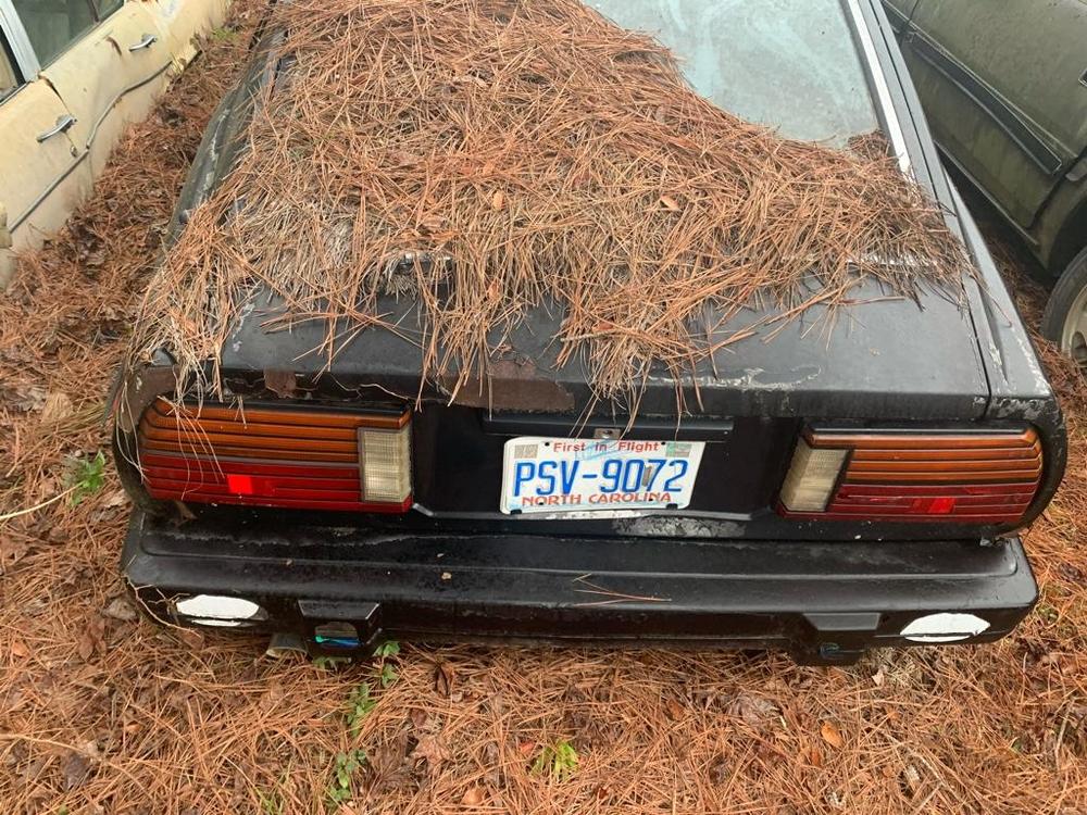

So, on the drive home I stopped by another JY to get a part for a member on here, while there I  found a new Z I haven’t seen before. Engine and transmission are gone but in generally good shape for a car in a junkyard.
John ... not sure if you know this ...  does the transmission you acquired have 1 hanger ear on the tail housing or 2 ?   Also the speedo cog, is the bolt at the bottom or top?
The close ratio gearbox has 1 hanger with the speedo bolt at the bottom.

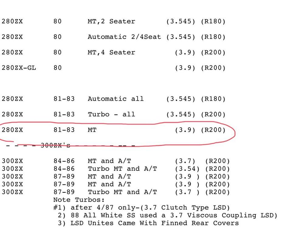

I think that you definitely got the close ratio 5 speed. And odds are very very high that you a got a 3.9 diff, if that's a coupe, not a 2+2.  Can't tell from your pictures.
