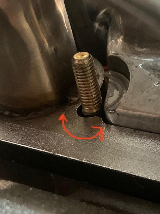

I ran into another problem. The intake manifold lower bolt flange thickness is about double the thickness of the header surface. (One of the shared bolts). This mean when you put the washer on and bolt it down the washer doesn’t even touch the header matting surface. I imagine this isn’t good and would manifest into an exhaust leak. I need a washer that is thicker on one 1/2 of it. Anyone tackled this problem?
Here’s the best pic I could get showing the problem.
I guess I should have researched more before asking.  I knew I couldn't be the first to have this issue.
1. Make my own
2. Call Pacesetter
Looks like another work stoppage!!  AWOP = "Awaiting Parts"  A term used in aviation when you are waiting for parts.
Thanks Bruce, Just measured it there is 6mm difference, slightly less than 4 pennies thickness for a mental picture.
I’m going to call Pacesetter and see if thy can assist. Second option is to cut some washers and stack them in one side. I don’t have a welder (yet).
