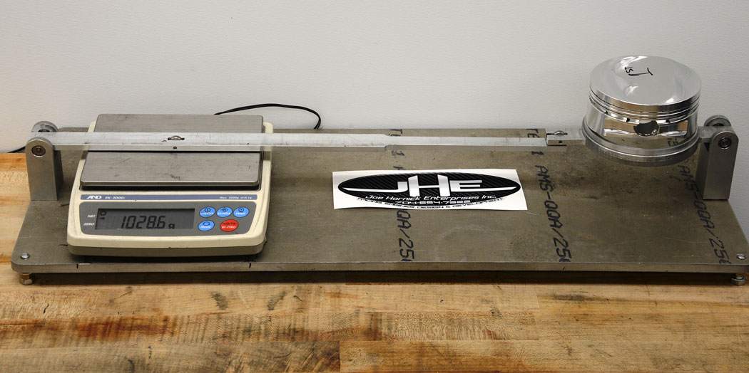

Home Built By Jeff posted a video of him balancing his pistons assemblies. He did it with pistons connected to rods. Down the rabbit hole I go.

You really want to balance the pistons separately if you are going to do it. The rods should be balanced big end and little end. If you are going to do it, I would have the shop separate them for you then heat and reassemble when done. Fairly inexpensive to have done. If you're going to spend the time, might as well do it the best way possible
You could probably come up with a way to separate them at home. a couple of sockets and a C clamp or something but you need to heat the small end to reassemble them.

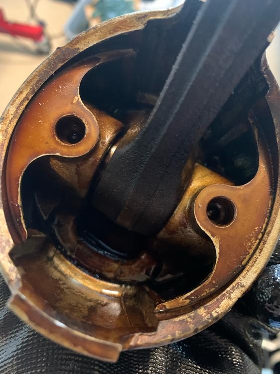

Well, as you guys know I’ve been cleaning pistons all week. Like many of you, I have a case of OCD and I cannot let things not just okay. I know it’s not necessary to clean the underside of the pistons immaculately but I couldn’t leave them nasty looking. It would bother me to leave them like that. Like when Steve Jobs asked his engineers when looking at the iPhone prototype he asked what the screws were made of. When they told him normal steel he wasn’t happy and wanted them to be stainless steel. They said “no one will ever know and it would be more expensive”. He responded “ I don’t care...I will know” That’s the story I was told not sure if it factual but it makes my point.
So I’ve been cleaning the inside of the pistons...if you think the top is hard it’s worse under due to tight crannies and grooves. I’ve experimented with a lot of products this week. Here’s my rating on their ability to remove carbon residue. Scale is 1-10. 10 is best (this isn’t Asia where #1 is best)
WD-40 = 5/10
Acetone = 6/10
Mineral Spirits = 2/10
Sea foam 2/10
Carb Cleaner 8/10
Purple Power 9/10

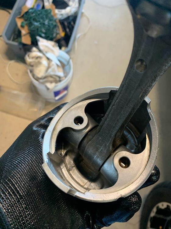

I had a bottle of purple power on my shelf already. Said, what the heck let me try it. Sprayed it on the underside of the piston and walked away for 10 mins. Came back and there was a black puddle under the piston. This stuff is amazing. No scrubbing, no wire brush or scotch brite. Wipe clean with a shop towel and hit with a blast of carb cleaner and....boom spotless!!!
Check it out below.
10 min soak and 5 min to wipe clean and hit with carb cleaner .
Unbelievable!!
